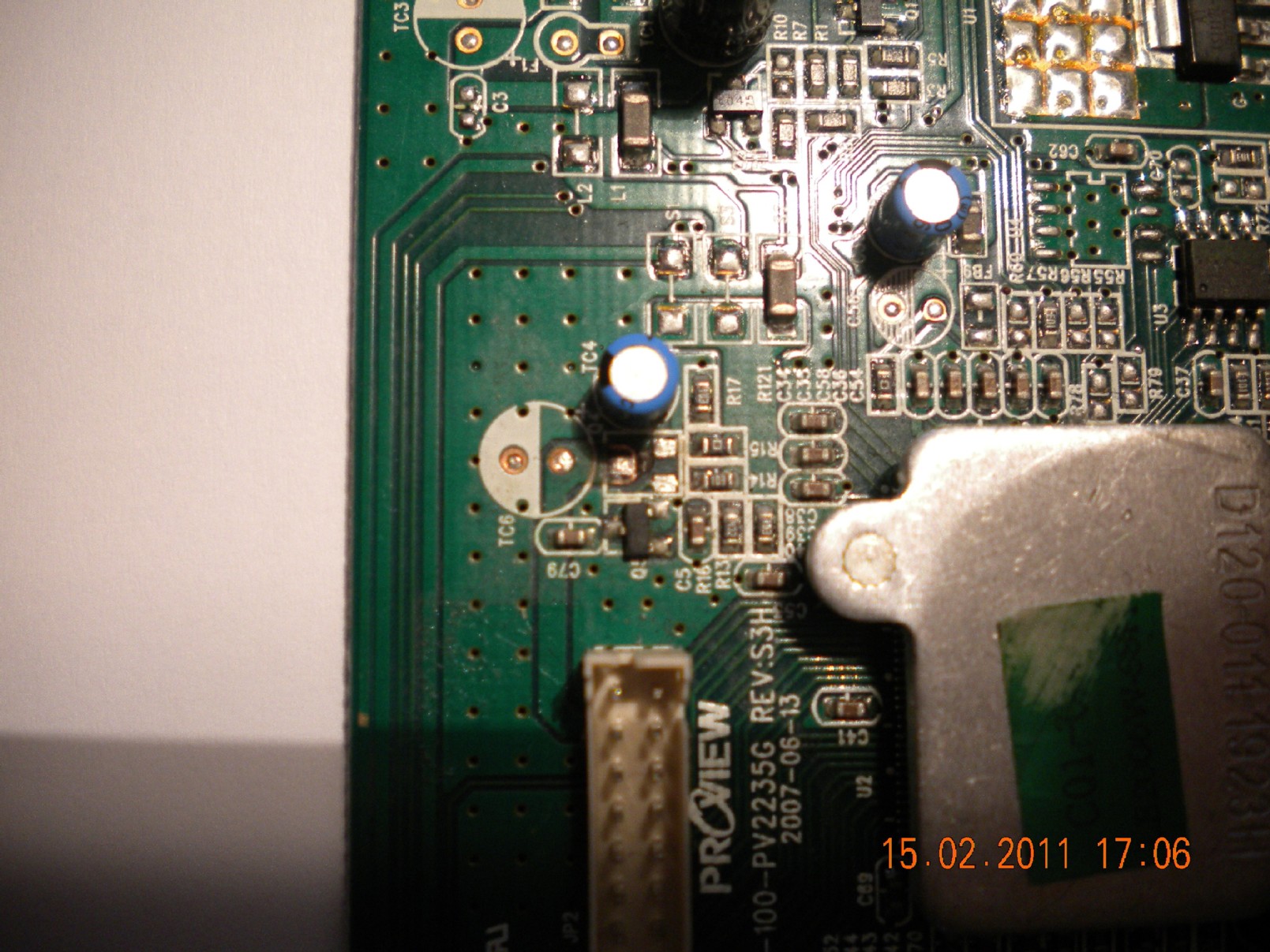

    My Proview LB2006W monitor went blank after a slight smell of smoke.
    I found that on the logic board, transistor Q4 was burned out.
    As it was an SMD, it was impossible to read anything on the burned body.
    It is the second transistor to the right of connector JP2, the first being Q5 (t04 on it) than Q4 and after that TC4 a 10u/16v electrolytic capacitor.
    Just above Q4, there is an empty space for an electrolytic capacitor TC6.
    Is there anyone on the forum who knows what transistor the burned one can be replaced with?
    The monitor has been waiting for this for about a year or so, but it would be nice to have it fixed as it is a wide screen monitor.
    Thanks for any assistance with this.

      Re: Proview LB 2006 W Monitor
      Hi Alexanna,
      Thanks for the quick response and the burned transistor is on the logic board and not on the power supply, but for the problem it is just the same.
      I'll add a picture of the board and hope that the resolution is good enough.
      I had to reduce it or the file would have been too big.
      This is the area where the burned transistor used to sit.
      Regards, Joseph.

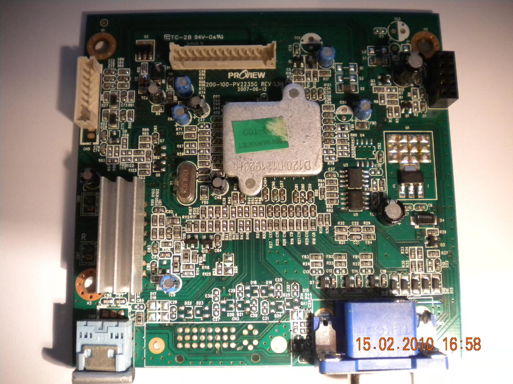

          • Joseph67
            • Feb 2011
            • 37
            Thanks for the fast response.
            About the panel being faulty...I was afraid of something like that as the connector is indeed the one to the panel.
            Still, what is the T-con?... the panel controller board?
            As for a picture of the entire board, please see below.
            I had to reduce the size or it would have been too big.
            Apart from this board, there is only the power supply and that seems to be fine.
            I'm afraid that it might be the problem as "mbates14" mentions, but it would be still worth to try with a new transistor.
            If it burns again we know that it is the panel controller and indeed in these small panels it is not a separate board as in the TV sets.
            I'm in to try a transistor but...what type?
            Any suggestion is welcome.
            Thanks.
            Cheers, Joseph.

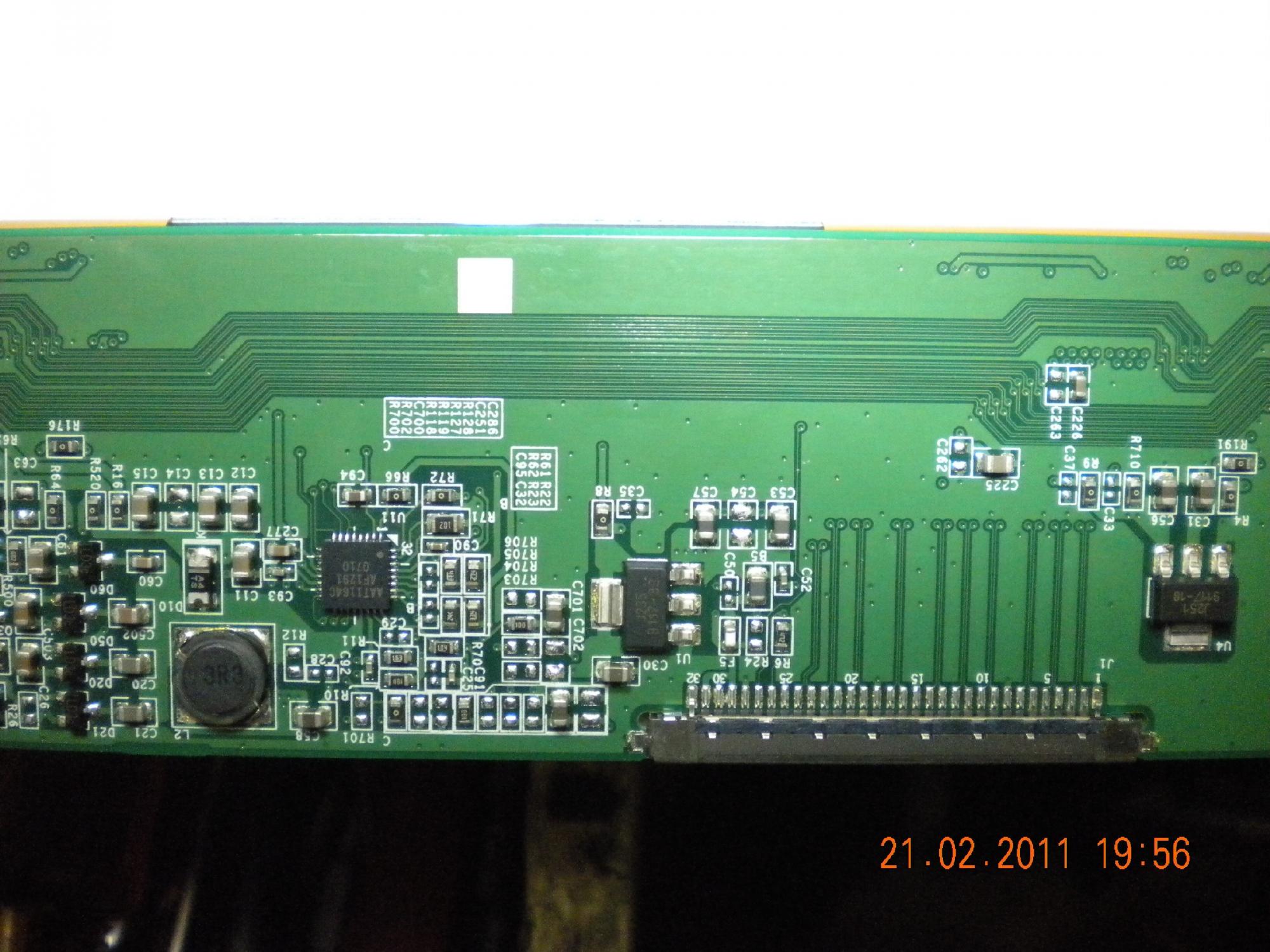

                      • Joseph67
                        • Feb 2011
                        • 37
                        Hi Momaka,
                        I do realize that the board I posted the picture of is the video board, but as the burned transistor tracks lead to the connector that goes to the t-con board, it might help to follow this track to the connector and than on the t-con board from it's connector to the short on this LCD control board. As soon as I dig it out of the stack of stuff sitting under my work table, I'll make a picture of it and post it on the forum.
                        Thanks for all the help.
                        Cheers,
                        Joseph.

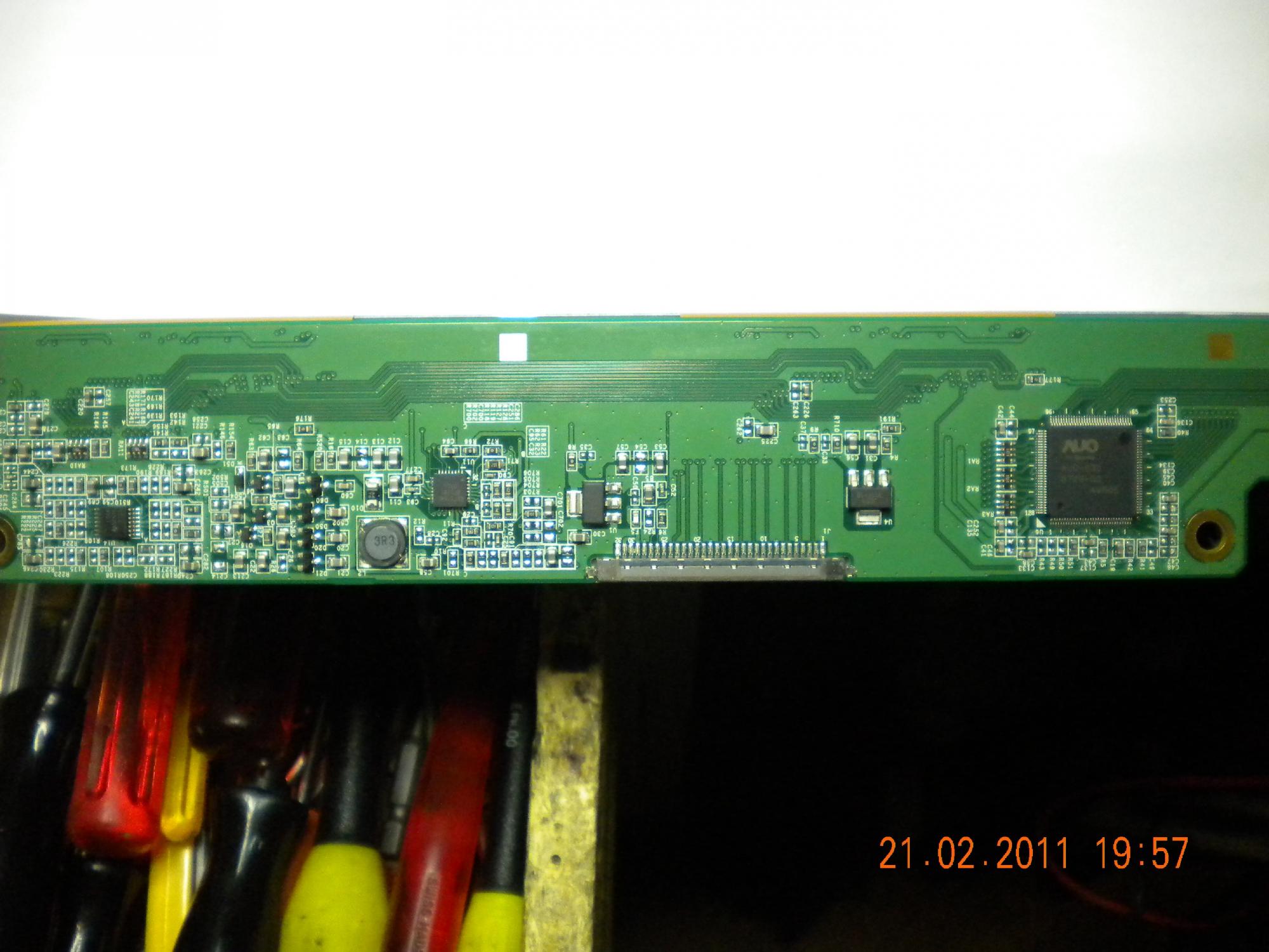

                        • Joseph67
                          • Feb 2011
                          • 37
                          Hello again Momaka,
                          After all it was not that bad to find the bits from the monitor between the mess underneath my work table.
                          Following the track of the burned transistor it did lead me to the second last pin on the connector to on the t-con board( pin 31 and joined to pin 29).
                          This pin's track goes directly to a fuse F5.
                          Fuse 5 is OK and the components around this fuse don't show 'heat' effects and are not in short.
                          The pass true on the board is a test point on the back of the t-con board 5v1 so obviously in correct working conditions one should be able to measure 5v on this test point.
                          It looks as if the burned transistor was providing the +5V to the t-con board.
                          I have made about 15 pictures and discarded most of them as the flash would make the picture useless. The 2 that I made without the flash are the ones I'm attaching.
                          Perhaps I should apply +5V to the pin on the connector and see what happens or check what is getting hot if not smoking.
                          Still I'll wait for your opinion as you obviousle have more practice with these things.
                          Thanks and best regards,
                          Joseph
                            Excellent pics, exactly what I needed.
                            At this point, this is not such a good idea. The t-con board is very likely multi-layer, and if a trace in between the layers burns, you won't be able to fix it. Fuse (F5) also might blow. We may provide the monitor with external 5v later on, after we've verified that everything is in order on the t-con board.
                            Fuse 5 is OK
                            I'm assuming you tested the fuse for continuity with a multimeter, not just a visual inspection, correct?
                            Precisely. The t-con board uses the 5v rail to produce several different voltages - usually 3.3v via a linear regulator, as well as a main boosted voltage rail of around 12v. The 3.3v is used by the data/video processor. The 12v rails is used by the buffers and also to produce two more voltage rails - one negative around -5 to -15v, and another positive one around 15 to 28v. These two are used by the LCD panel.
                            In the case of your t-con board, there's two linear regulators - U1, a 3.3v reg. and U4, a 1.8v reg. These very rarely fail, so we'll leave them alone for now.
                            To get a good idea about the rest of the circuit, though (and to aid with the troubleshooting), I suggest you get the AAT1164C datasheet. This IC (U11 on your board) is responsible for the main boosted rail as well as the other two boosted rails derived from it. Page 2 and 14 of the datasheet show a typical circuit.
                            In your monitor, the main boosted rail starts from the cathode of diode D10 (the side marked with the white stripe). Based on what I've seen, many times one of those small multi-layer ceramic capacitors will fail and go shorted (or near shorted) in either the main boosted voltage rail or in the two secondary boosted rails.
                            So with that said, do the following measurements and post the results here:
                            1) check resistance between ground and either terminals of fuse F5
                            2) check resistance between ground and the cathode of D10
                            3) check resistance with (-) probe on cathode of D10 and (+) on fuse f5
                            4) check resistance with (+) probe on cathode of D10 and (-) on fuse f5
                            For items 1) and 2), put the (-) probe on ground.
                            For all 4 measurements above, use 2000 Ohm scale if your multimeter is manual ranging.
                            Item 1) is to see if the 5v input is shorted while item 2) checks whether the main boosted voltage rail is shorted. Items 3) and 4) check diode D10.
                            Alright, it's 3:30AM here so that's all for now . Hope I'm not giving you a headache with that stuff .

                                    I've done all the homework you sent me and first I thought that we hit a faulty capacitor as C504 gave me a reading on both polarity's at just over 1Kohm.
                                    So, I un-soldered this capacitor but unfortunately the reading on the pad's was the same and the capacitor on it's own was not shorted either, so I've placed it back where it came from.
                                    Al these other componentsC21, C20, C502 (C50 has no component and is not in the same area), C60,C61, C503, C213, C504,D21, D20, D50, D60 and all the others in the area don't show any short circuit either.
                                    The only other reading was on C30, in one direction I read 646 Ohms and in reverse 438 Ohms, but that it is probably the circuit and not the C.
                                    I even went back to the video card and checked the capacitors on this 5V output as there are some of these ceramic SMD capacitors as well, but no luck either.
                                    As I was checking with a wire counter as magnifier the text on the transistors of the video card, I found very small traces of solder between the pins of the connector to the panel between the 5V and the ground pin next to it, but is was such a small bit that I find it hard to believe thΓ‘t could have been the reason of the burned Q4.

                                    There is still the question on what transistor to use for the burned one Q4) on the video card.
                                    Q5, next to the burned one is marked as "t04" and there are 5 more of the same on the board one "A4t", 3# "A7W" and one really big-ish one Q2 "74A5Z" as it is using the board as a heat sink
                                    Than by the size of the pad layout compared Q4 with Q5, it looks as if Q4 was slightly bigger than the others but smaller than Q2.
                                    I just wonder if there are that many different SMD transistors anyway as there is hardly space on them to print a code number on them.

                                      Well, those diodes rarely short out. However, the reason I suggested checking them is because they can be used to find bad ceramic caps, particularly because diodes should show a reading in one direction but not in the other (at least when checked with 2 kOhm setting). A bad ceramic capacitor will throw off these measurements and the diode will show a reading in both directions.
                                      Keep in mind that ceramic capacitors don't necessarily have to be shorted to be bad. They could just be "partially shorted". I've had one that was showing ~33 ohms in both directions, in and out of circuit. I'd say anything under 100 Ohms (especially in the positive/negative LDO drivers section) should be considered as suspect. If you didn't get any readings like that, though, then the t-con board is likely fine.
                                      This brings us back to the original question - why did Q4 on the video/logic board burn out? Unfortunately, I can't give you a definite answer on that. This is why I suggested checking the t-con board. However, it could be that Q4 just overheated. Or it could also be that Q4 had a defect from the factory and it took it some time to show up. Many of the ceramic capacitors seem to act that way - they work fine for a while, then they short out.
                                      With that said, if everything checked out "okay" on the t-con board, the next step is to feed it 5v with an external power supply. More precisely, connect everything in the monitor the way it should be, and power it on, then feed 5v to the t-con board. I suggest you connect the external 5v PSU in series with your multimeter (and use it as an ammeter) to see how much current is going to the t-con board. I would guesstimate 0.8A to 1.2A is where it would be - this is based on the current I measured for a 19" SyncMaster. Note, however, that if the LCD monitor's power supply has any labels on it stating the maximum output current on the 5v rail, then the t-con board should not exceed that current.
                                      Lastly, as you feed 5v to the t-con board, have your finger over the AAT1164 chip. If there's something wrong with the t-con board, that AAT1164 chip will get very hot in less than a second - so do beware and be ready to pull your hand if this happens. (This is how I found there was something wrong with the t-con board on one monitor before I knew how to check t-con boards.)
                                      Also, regardless of what the external power supply is, make sure to connect its ground to the monitor's ground (i.e. anywhere on the chassis).
                                      If the t-con board appears to work fine and nothing overheats, you should see the usual start-up image on the monitor, such as "No signal", "Proview", etc. If you don't, let me know.
                                      Once we establish the t-con board is working, then we will worry about finding a replacement for Q4 on the video board.
                                      There are quite a few of them actually. Those numbers are usually just reference numbers. You then use a SMD code book that ties up those reference numbers with the actual SMD component numbers.
                                      Normally I use this:
                                      http://www.marsport.org.uk/smd/mainframe.htm
                                      Unfortunately, this was last update in 2006, so you may not see some components listed.
                                      As for the SMD ceramic capacitors - I just replace them with ones of the same size (I know this is not the best way to go about that, but then again, what else can you do?) This method seems to work fine, though.

                                        On the monitor front I am still digging as the 5V external supply is trying to drink about 2.5A and the diode goes hot very fast (it's still OK) (U11 does not get warm!).
                                        I removed C 12, C13, C15 and R16 and 520 as they are the ones that are directly connected to the cathode of D10 and gave me a reading of about 10ohms over each of these.
                                        When unsoldering R 520, it jumped from my tweezers over my workspace and I spent about 1/2 our trying to find it but no luck.
                                        As it is just a 0 ohms one, I can replace it from a scrap board with a lot of SMD components on it (a t-con board I saved from a broken Medion monitor screen).
                                        It will be a bit of digging as after the resistors, the track seem lo lead to a second or what knows layer.
                                        On one of the pic's of the t-con board you can just see the track from R16 to one of these through holes and the one from R520 is close to it.
                                        Hope to get on with it tomorrow, but it begins to look as a not so easy one.
