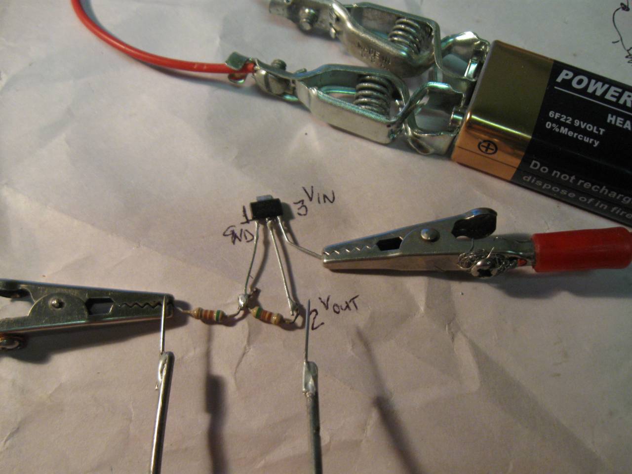

              #86
              Re: Vizio VW42LFHDTV10...Brother Mikes TV...LDO regulator test
              Bill....I'm still not clear on testing these regulators and interpreting the results. Attached my pic shows the layup I ran with 2 resistors and the battery...I tested Vout as the probes show from pin 2 to the battery ground. My battery measures 8.7V, and two identical resistors read 480 ohms each. Vout I get now is 6.5V, whereas it was reading 7.5V without the resistors.
              Is this test correct ?
              And if so, what do these high voltages mean ?
              I got that same 7.5V on the new regulators as those I pulled.

                #87
                As far as I can see, the test setup is correct. The only 'error' is for this part pin 1 is called Adj, not Gnd. The soldering looks like something I would do on a test setup.
                The resistance values are higher that specified, but I'd have to review the datasheet carefully to see if that could be a problem. I wouldn't think so, it implies a great deal of current out the Adj pin.
                Here are a couple of ideas to try. Try adding a 100 ohm resistor as the load. Recheck the solder joints. I can't be the only person who had what looked like a perfect joint that turned out to be open. Hook caps across the input and output. If you have them available, parallel the existing resistors with one more each - this would have the effect of dropping them down to 240 ohms.

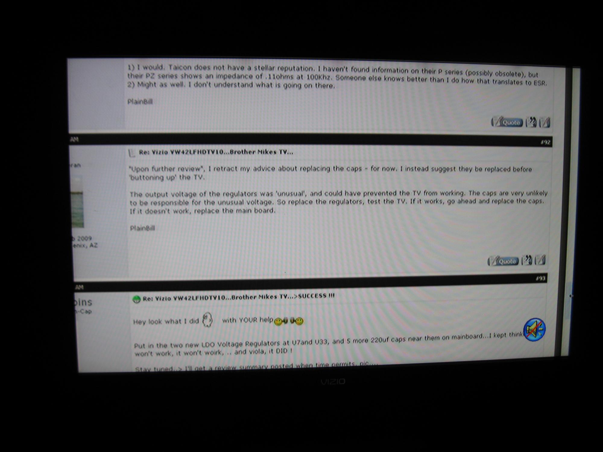

                        • PlainBill
                          • Feb 2009
                          • 7034
                          #92
                          "Upon further review", I retract my advice about replacing the caps - for now. I instead suggest they be replaced before 'buttoning up' the TV.
                          The output voltage of the regulators was 'unusual', and could have prevented the TV from working. The caps are very unlikely to be responsible for the unusual voltage. So replace the regulators, test the TV. If it works, go ahead and replace the caps. If it doesn't work, replace the main board.
                          PlainBill
                          • kingofcoins
                            SaveOnGreen-Cap
                            • Jan 2010
                            • 162
                            #93
                            Re: Vizio VW42LFHDTV10...Brother Mikes TV...>SUCCESS !!!
                            Hey look what I didwith YOUR help
                            Put in the two new LDO Voltage Regulators at U7 and U33, and 5 more 220uf caps near them on mainboard...I kept thinking it won't work, it won't work, .. and viola, it DID !
                            Stay tuned..> I'll get a review summary posted when time permits, pic....

                            • Dgtech
                              E. Technician
                              • Apr 2009
                              • 1462
                              • Steeler
                              #94
                              Nicely done!! Congrats!!
                              It feels good, doesn't it? You saved yourself a good bit of money and you had fun with it too, I'm sure. I'm a huge plainbill fan myself as well. Good luck on your next project.
                              Hey, enjoy the big game next weekend.
