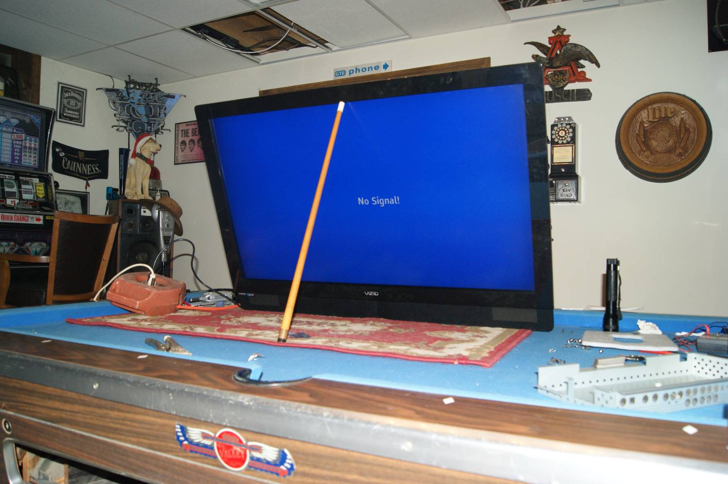

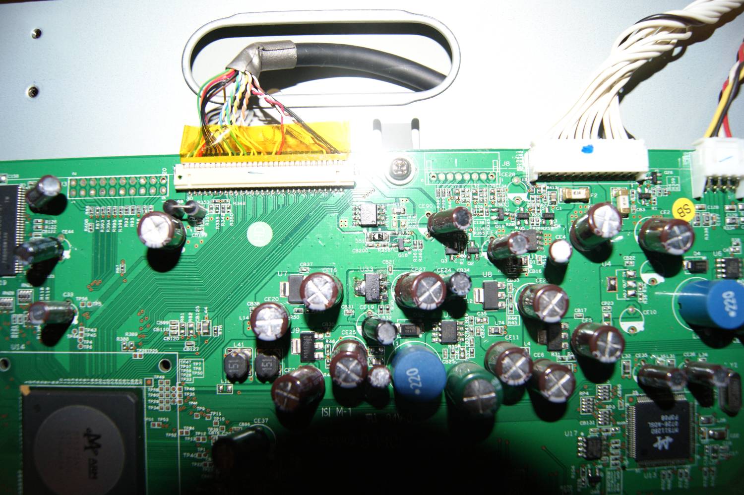

      Re: Vizio VW42LFHDTV10...Brother Mikes TV...
      5:19 pm
      Got the parts in and purchased some flux, just got the old regulator off and to be honest, I'm taking a break. It was quite a chore and I want to clean up the mess I made. I would suggest getting some braid to "suck" the old solder off as it was dificult for me to heat up all 4 points and pry the old one out of the way, patience required to say the least. Interesting the board is labeled ADJ/OUT/IN . Turns out my old soldering iron was better then the new one from Radio Hut.....I'm getting ready to clean the board with a Q-tip and place the new part. I want to be sure no specs of solder have wandered off into the board. Hope I'm not boring you but to me, this is like surgury!
      5:43
      I seem to have lost the old part somewhere! I note the new part is labeled 16AB over N03A......
      6:08
      After installing the new part which I have enclosed my terrible job, standing the tv up, found the old part, power on,
      YAY! No Signal!
      Kudos PlainBill! & Retiredcaps! So Happy, and my Mom will be too! Can't thank you guys Enough!
      Ps, I know the soldering job is poor, I' might try to wick some off.

        The Vizeo has died again. I dont think it's the same problem. This time the screen froze. Other syptoms are about the same except I dont see any inverter lights.
        U33 2.08 3.34 5.19
        U2 1.48 2.39 5.19
        U7 0.03 1.29 3.34
        U8 2.07 3.33 5.21
        U9 0.00 1.52 3.34
        Back to the drawing board or perhaps the recycle bin.
        • retiredcaps
          • Apr 2010
          • 9271
          #184
          Originally posted by Paul J
          U2 1.48 2.39 5.19
          Check the readings and report the part number for U2?
            AMC1117 over F0734J
            1.48 (2.36 - 2.40 ) 5.2
            Am using an old Krista Meter and the middle pin value seems to fluctuate.
            I do have a replacement left from when I changed out the U33 I bought two. marked
            16AB over N03A from digikey
            I guess that is a little low, should be 2.73 on Pin 2. You think that is enough to be bad?
            Thanks RetiredCaps
              #186
              The regulator U2 is defective, or one of its output capacitors is.
                  Yay! She is up and running once again! Thanks retiredcaps and tom66!
                  This time I removed the regulator by loosening the big leg first enabling me to get a "grab" on it, then quickly heating up the 3 pins. I destroyed the bad one, it broke apart on removal, too much heat from the iron I guess. I did not add any solder this time, simply held it in place and tapped the legs. It is a little crooked but the best I can do. The blue inverter light fired up and I knew it was good! Thanks again. If I had the patience I would replace all those as I'm sure another one will happen.
