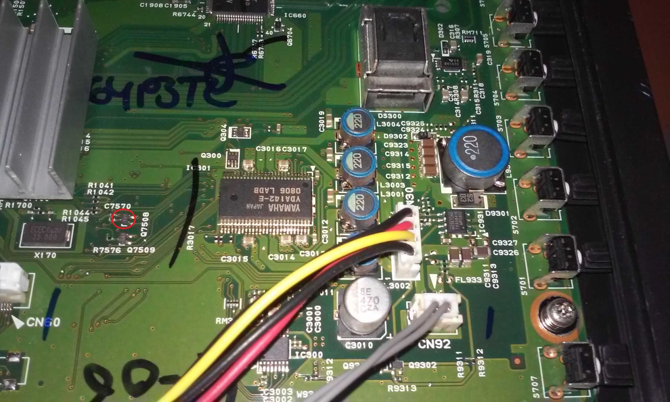

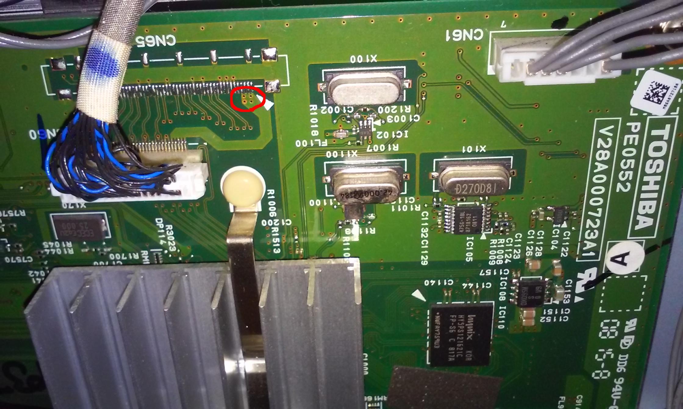

hey bud can u do me a favor? where exactly on the board am i supposed to put the probe? there is a big green trace next to cn65 with 2 little copper choles in it and then theres also the solder pads next to them but they are not the same. so can u pin point exact location i put the probe?Comment
http://www.badcaps.net/forum/showthread.php?t=24809Comment
Re: Toshiba 37" inverter board failure
ok good that has been what i was using i just had to verify... also like in the other thread am i looking for 3 pin and 8 pin or am i going to test everything?Comment
Try the 3-pin and 8-pin first, it should not be very far from the pad I marked.Never stop learning

on the first thing i probed the top 3 legger by c7570 i get 1.2 ohm and meter resistance is 1.0 now so that means that 3 legger is giving me .2 ohmsComment

actually bud i have multiple giving me the same reading i already found 5 of them and im sure there will be more.. are u sure the vias is the correct testing point?Comment
Yes, they are on that big copper trace to handle the current, that is why I am surprised when I see the picture of that small device.Never stop learning

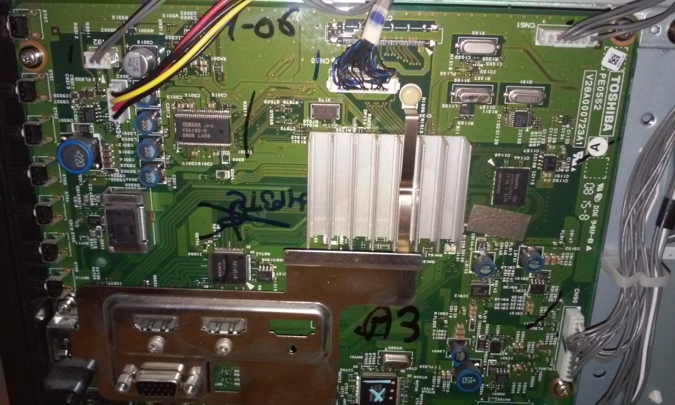

ok here are the first 4 with tv on
the 2 three leggers where i circled are 3.3 single leg 0v dual legs on both
ic931 8 pin bottom side 9.8 18.3 9.1 0 top 3.4 7.8 1.9 .8
ic 108 8 pin bottom 1.8 3.3 3.3 .9 top .9 .9 .9 0Comment

IC901 looks promising, Can you get the P/N? Also pin is connected to those Vias?Never stop learning
ALSO IC921 Part# MP1591DN http://pdf1.alldatasheet.com/datashe.../MP1591DN.html
voltages are BS 8.9V, IN 12V, SW 5.3V, GND 0V, REF 4.9, EN 4.9, COMP 1.1, FB 1.2
PAD = GND CONNECTED TO PIN 4 ALSO WITH OHM METER AT 200 I GET 1.2 OHM ON PIN FOUR - 1.2 = O OHMComment

update to post 53
ic901
Z1017aI 8 pin
FB .7v AGND 0v PGND 0v VIN 12.3v
LX.5v LX 5v EN 3.1v COMP 3.1v
both of this chip pins agnd and pgnd give me 1.3 to the vias in 200 ohm setting so reading is .1 ohm
Apparently the gnds are connected to the trace by CN65 on both chipsLast edited by whatusername; 05-27-2014, 12:23 AM.Comment
