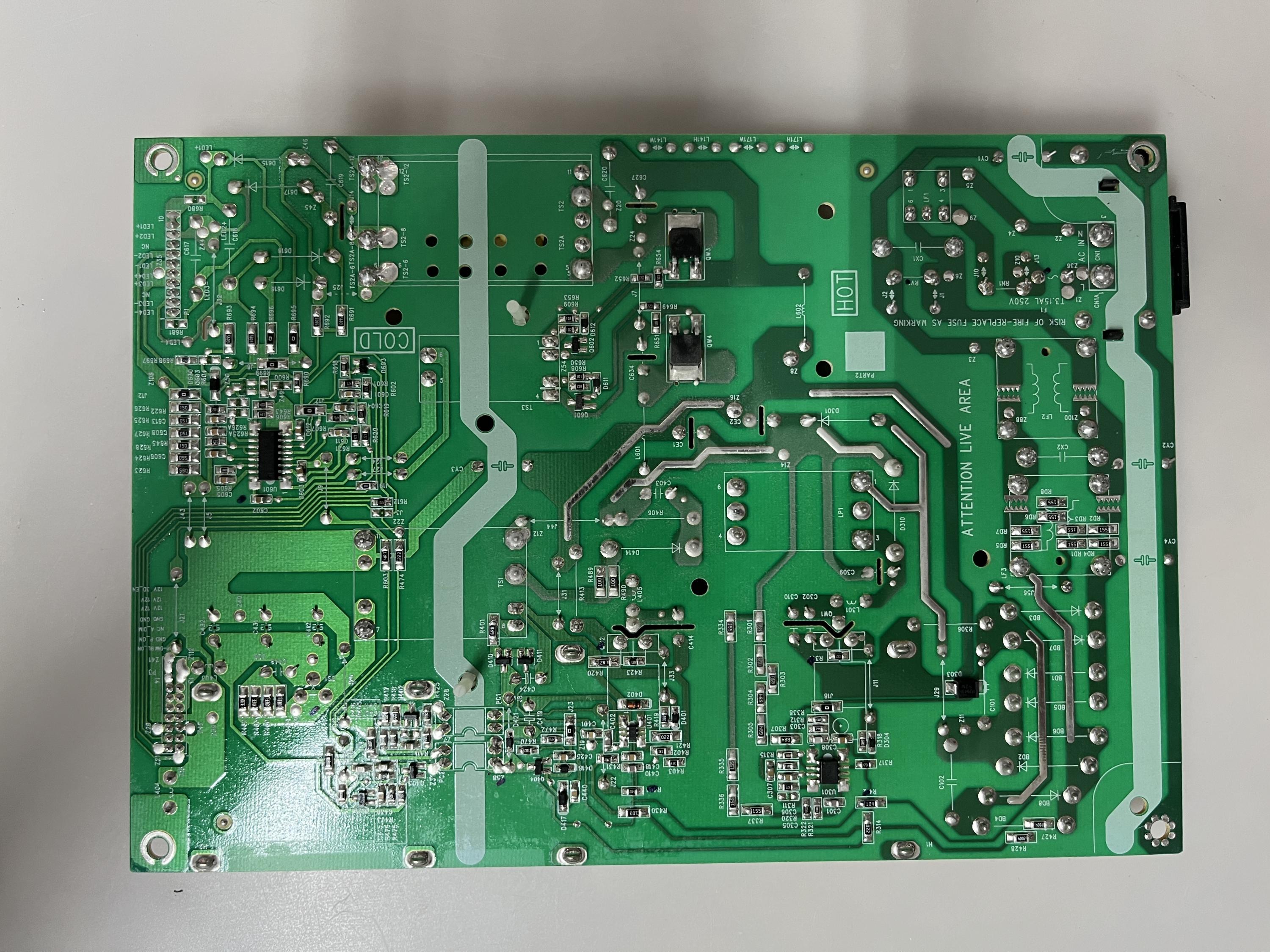

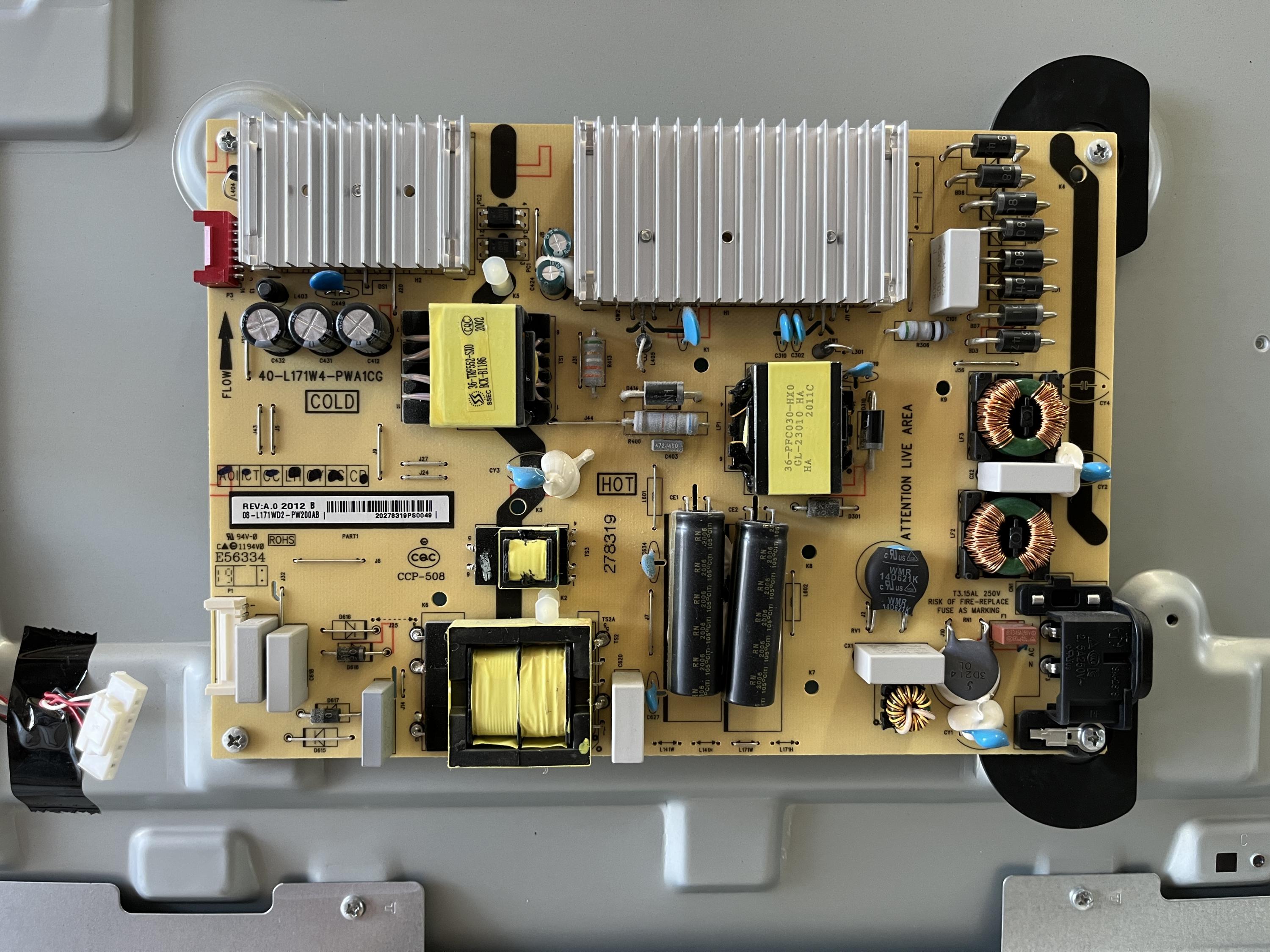

    TCL 65S421 No Backlight
    I can see an image on the screen with a flashlight. Is P_ON at 2.6v acceptable or does it need to be 3.3?
    Main Connector
    1- 3.3 - BL_ON
    2- 3.3 - P-DIM
    3- 2.6 - P_ON
    4- 0 - GND
    5- 2.6 - A_DIM
    6- 0 - NC
    7- 0 - GND
    8- 0 - GND
    9- 12 - 12v
    10- 12 - 12v
    11- 12 - 12v
    12- 12 - 12v
    13- 0 - 3D_EN
    14- 12 - 12v
    I see no voltage on either side of TS2 or TS3. Is something else causing U601 to not drive TS3?

            • m4a2t0t
              • Mar 2013
              • 279
              Re: TCL 65S421 No Backlight
              It looks like LED2 is bad. The tester stays at 330v when I probe the pins. Thanks
              • EazyBone
                • Jun 2023
                • 1362
                • United states
                Yup that's your answer. Next time on these Roku TVs with same problem, just skip right to testing LEDs, then if they are good then look at PSU
