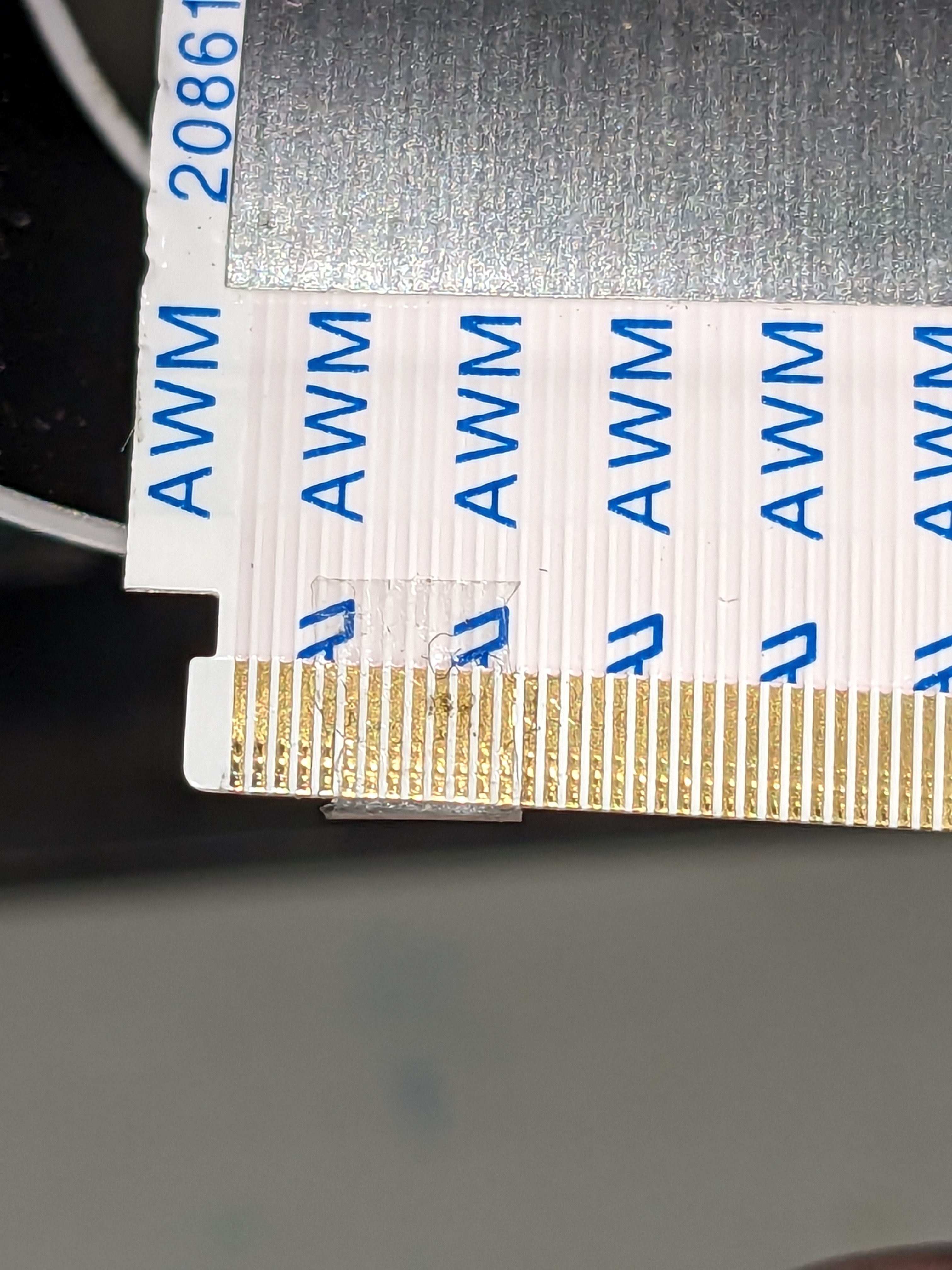

            lotas
            I'm going to reattempt the tape trick tonight and I'll take a photo of it for you. I'm hoping I can find a bad component on the scaler to fix the issue rather than the tape. If I can FIX it the image will be perfect, but the tape trick will likely cause some lines or something.
            • x_orange90_x
              • May 2015
              • 702
              #46

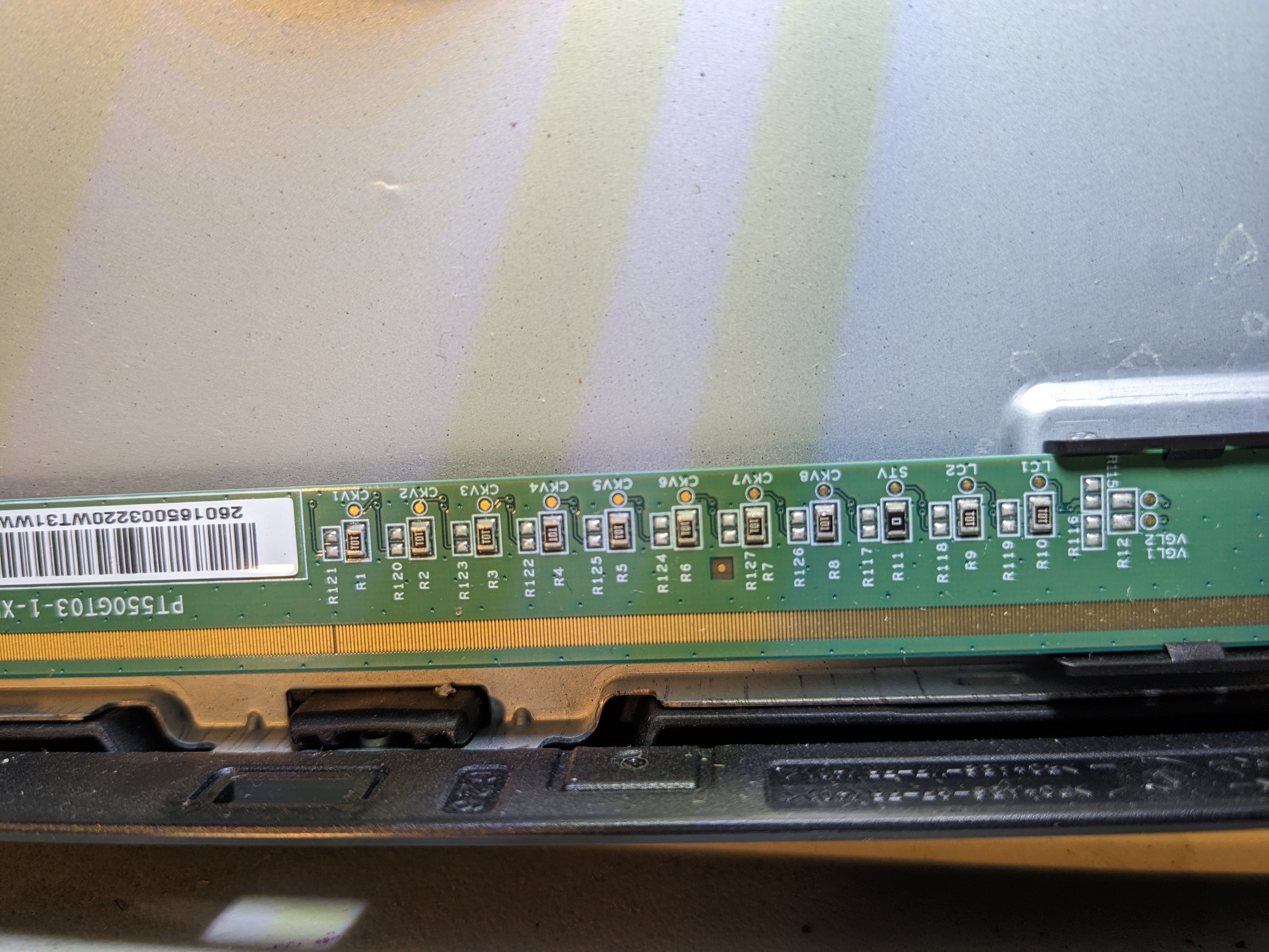

              Originally posted by lotas
              If none of the capacitors have low resistance (in Om), then they are fine, show where you masked the contacts.
              Attached is a photo of the lines I blocked off. The 4th line is STV, then CKV 8, 7, 6, 5, 4, 3, 2, 1 in that order from left to right. I checked continuity on them to find that's what they are via the test points over each of their resistors. With the tape in place I rechecked and the first untaped one (STV) still has continuity, so I know I blocked off ONLY the clock lines.

                #47
                Check also VGH, VGL, 3.3v..., there are many more control points there

                      All ribbons attached, no tape, and power on:
                      DVDDI = 1.83V
                      HVAA = -3.8mV
                      VAA = -0.376V
                      VCM1 = -0.363V
                      SPI_DI = 120.6mV
                      SCK = 120.3mV
                      SPI_CS = 3.25V
                      SPI_DO = 3.27V
                      VGL1 = -3.0V and increases toward 0
                      VGL2 = -8.93V
                      AVCM = -.362V

                        I noticed my labels are quite different from what would be expected. The only one that sticks out to me is DVDDI. Should be 3.5V and I'm under 2V. What do you think?
                        • x_orange90_x
                          • May 2015
                          • 702
                          #52
                          I checked the left side voltages with the right side ribbon disconnected and get the following:
                          DVDD1 = 1.83V HVAA= 6.73V
                          VAA= 15.32V
                          VCM1= 4.19V
                          VSS1= -5.03V
                          VSS2= -8.91V
                          AVCM= 4.19V
                          Notice the left has VSS instead of VGL. So clearly I'm missing voltages on the right. If I check the left side with the right ribbon connected I get almost the exact same readings as the right side, so the right side brings down the left when it's connected.

                            maybe check all the resistors on the right side.
                            • x_orange90_x
                              • May 2015
                              • 702
                              #54
                              I previously did a resistance check on all of them and they read correctly. Should I check them another way? I don't understand how blocking the clock signals gives me grey on the right and image on the left, but uncovering just one makes the whole screen black again.

                                      I revisited the tape method and successfully found the clock signals, blocked them, and the end result looks great! I can't see any anything wrong with the picture!
