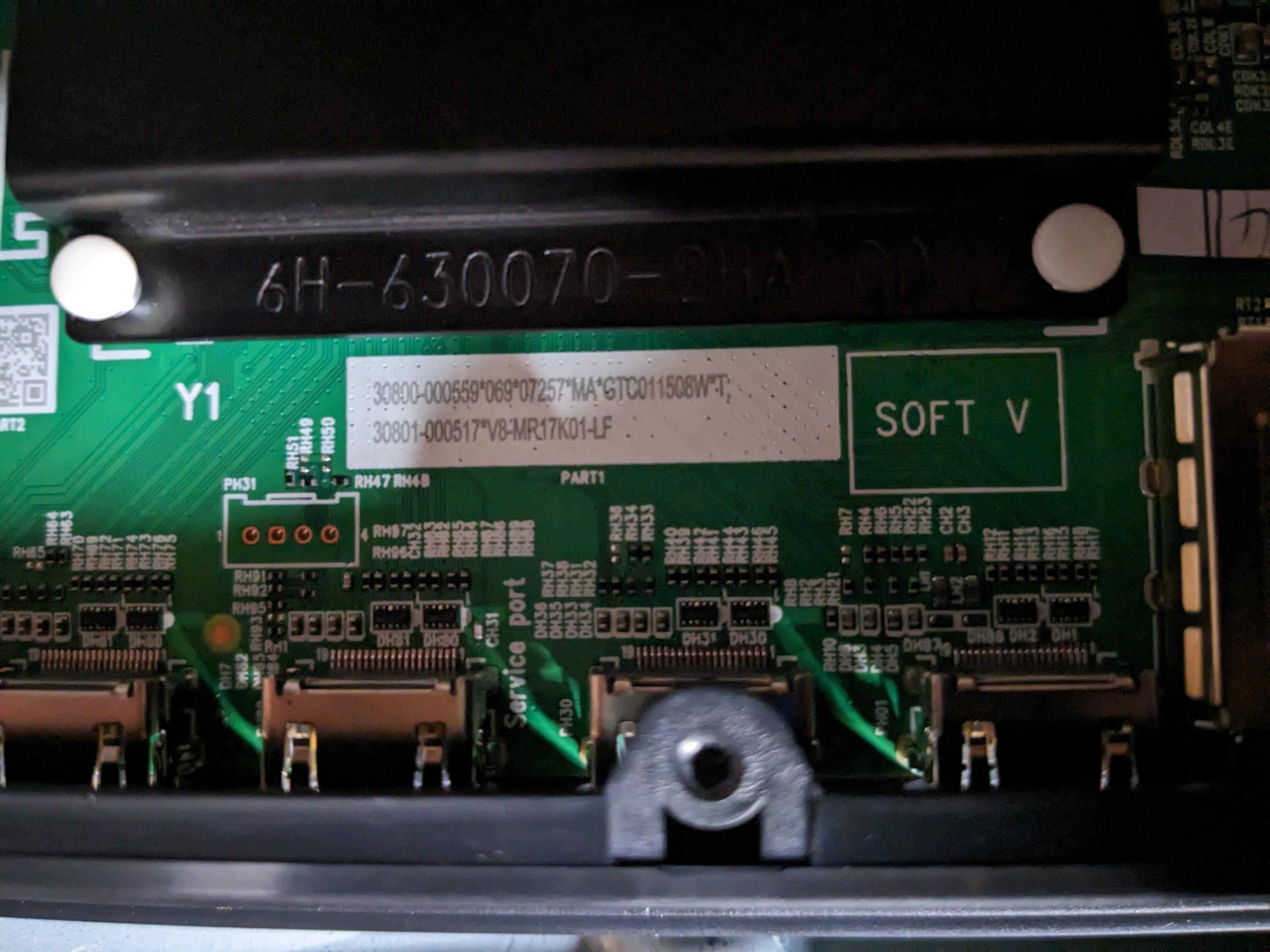

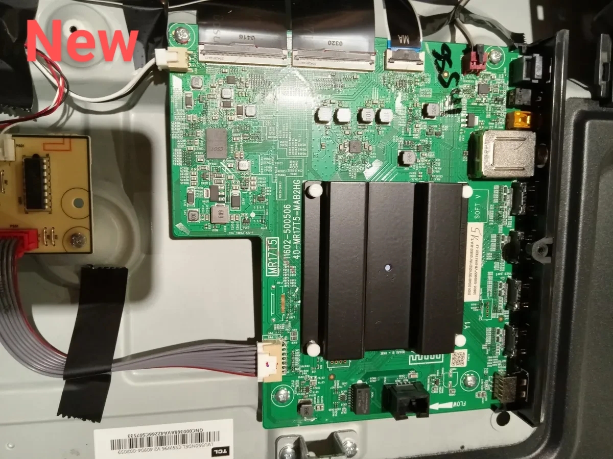

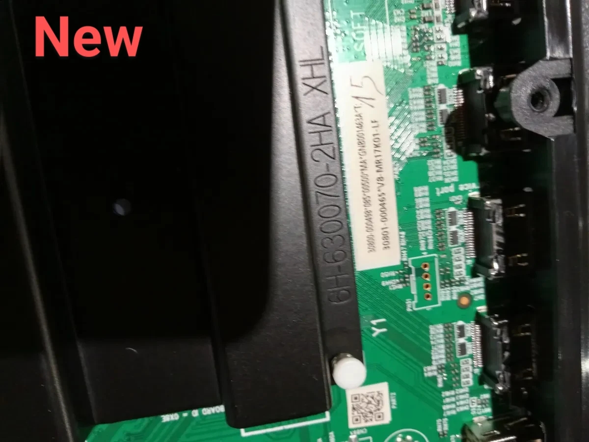

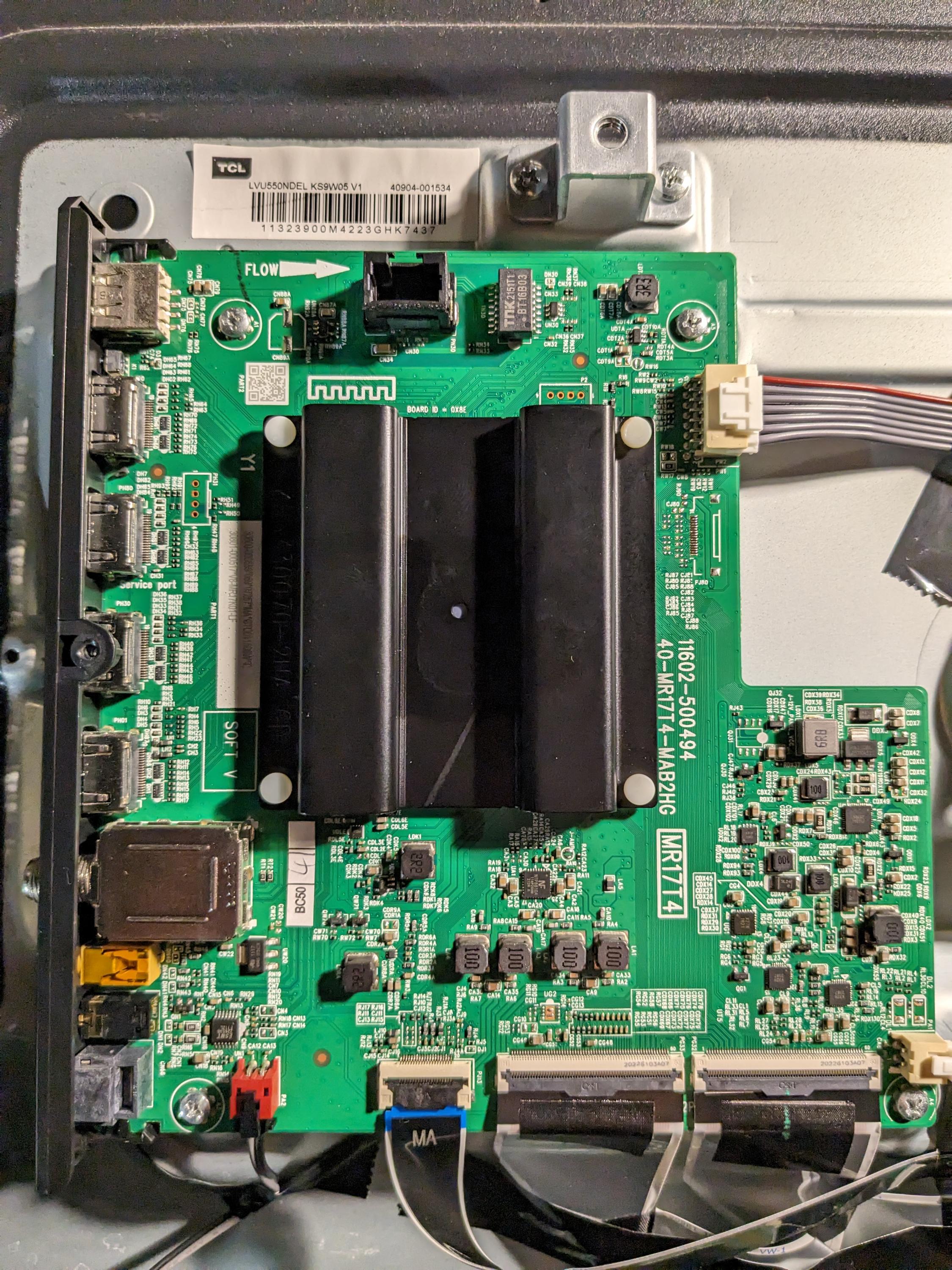

    I picked up a 55" TCL 55S451 last week that is not displaying any picture. When it powers on the screen lights up but there is absolutely no picture on it. I can move around the Roku menu with the remote and I can hear it moving around and selecting things. I tried the RESET button on the main board dozens of times as well as the remote bottom combo to reset the tv.
    I ordered a replacement main board and power supply from eBay and put them in last night but STILL no picture. I get exactly the same results. The main board in my tv is 30800-000559 40-MR17T4 and the board I received from eBay is 30800-000498 40-MR17T5. I don't know what the technical difference would be, but visually there is a very slight difference. The T5 has an IC that isn't on the T4. I've read that these boards are largely interchangable between this series so I'm a little confused. The power supply board is the exact same model number as mine despite a different PCB color and slightly lower voltage caps.
    Is this replacement board not compatible or possibly bad? It's suspicious that I get EXACTLY the same results with both boards. This tv doesn't have a TCON. There is only the power supply board and main board, so replacing both should fix just about anything, correct? The panel itself still looks brand new and the backlights are functioning fine. No cracks, scuffs, nothing. I just don't get a single line of video.
    I notified the seller that they sent me the wrong board and they are going to send me the correct one, but I can't help but think there's something else going on.
  • x_orange90_x
    • May 2015
    • 727
    Re: TCL 55S451 Blank screen

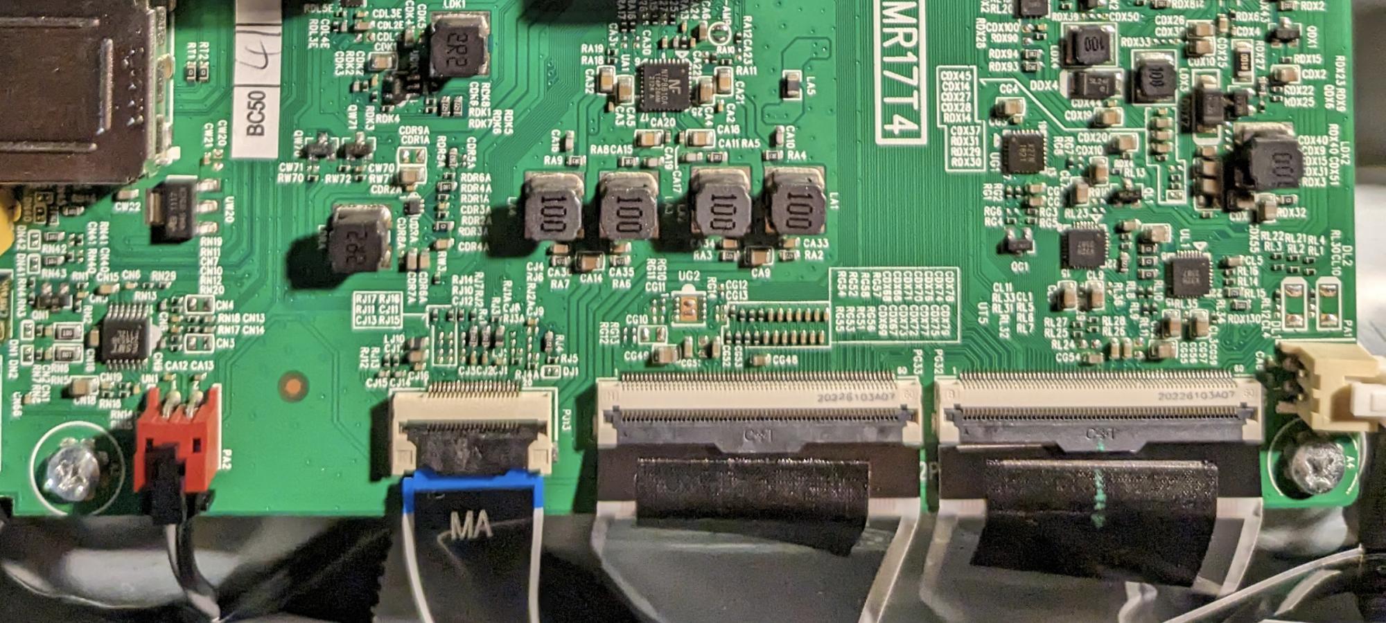

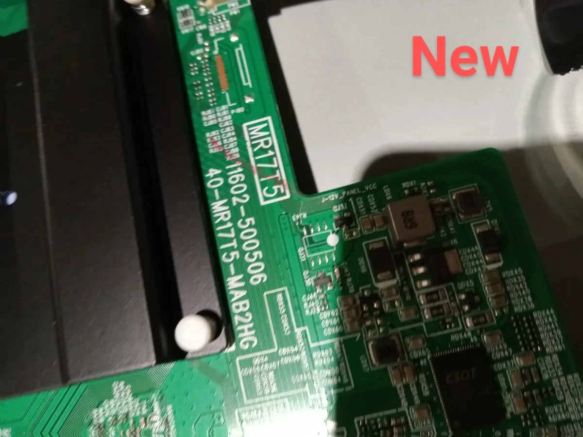

    Here are pics of my original board and the New one, labeled New. I looked closely at the label on the panel in in the seller's pictures and compared it to mine. They are also different.
    My panel is:
    LVU550NDEL KS9W05 V1 40904-001534
    Seller's Panel is:
    LVU550NDEL CS9W95 V2 40904-002059
    Perhaps the main board I received ISN'T compatible with my V1 panel?

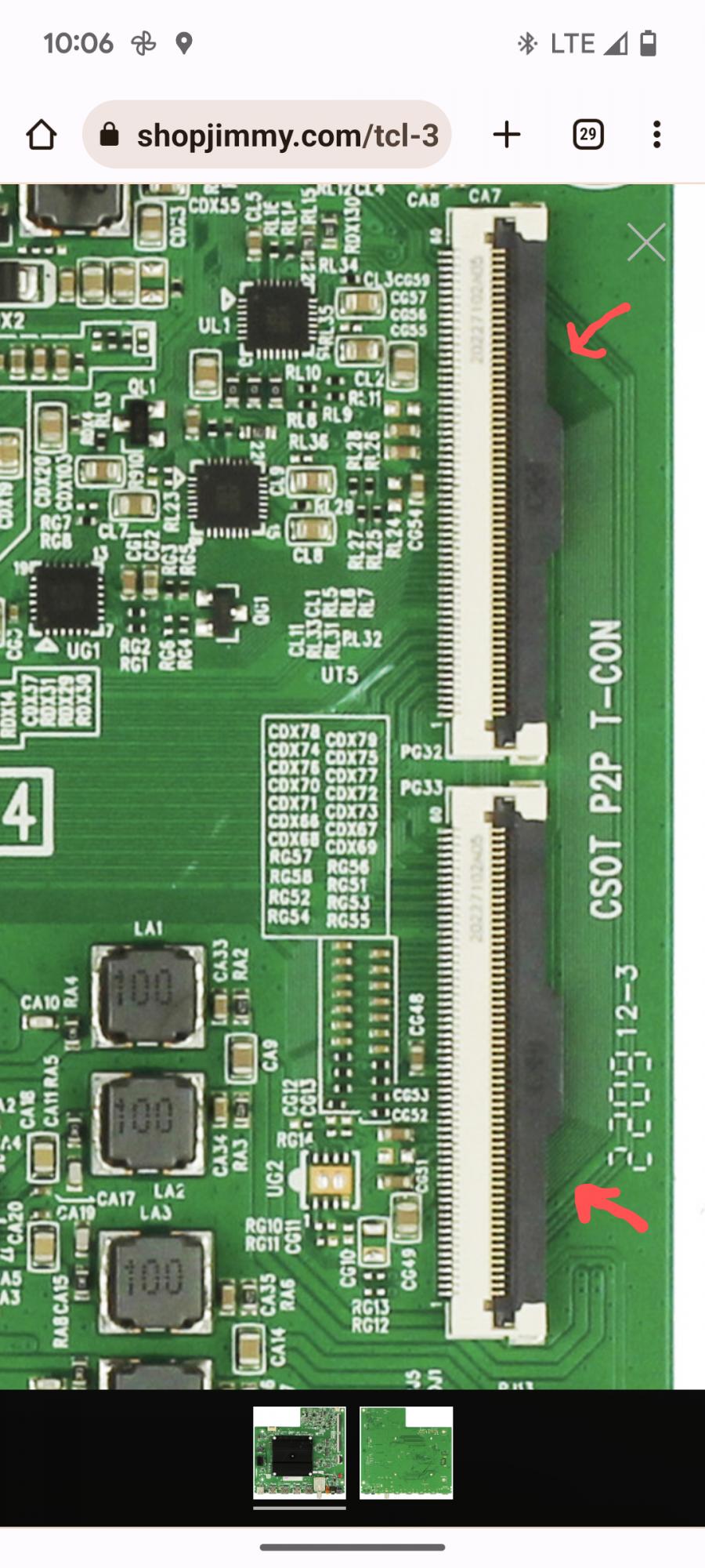

      I've had similar symptoms with this type of TV and it was the panel in fact. Panel shorts, turn screen on you get Backlight and sound but no picture. Google fixing TV with tape and try that, then you will rule out the panel. New boards won't fix it if it's the panel.
      • x_orange90_x
        • May 2015
        • 727
        Thanks for the reply. I have tried disconnecting each of the two panel ribbons separately which SHOULD show something like white screen, lines, half image, etc. but I still get the same backlit black screen. I found a thread on Roku forums of this exact issue with various brands and sizes of Roku TVs that apparently received a bad update and they acknowledged it.
        https://community.roku.com/t5/Discus...ay/td-p/830524
        I'm hoping it's not the panel because that would just suck. I'd expect to see SOMETHING on screen even if the panel was bad.

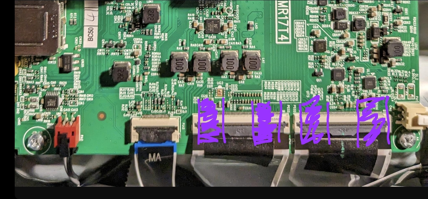

          Orange, if you disconnect one at a time, it Should show a picture, but not always. Sometimes I don't get a picture until I put some tape around. You may expect it but sometimes it doesn't happen. But yes it would suck lol. I just try it because it takes 5 minutes to move tape, plug in, repeat few times on each side and then I move on. BUT if you got a wrong board, might as well try that as it's coning

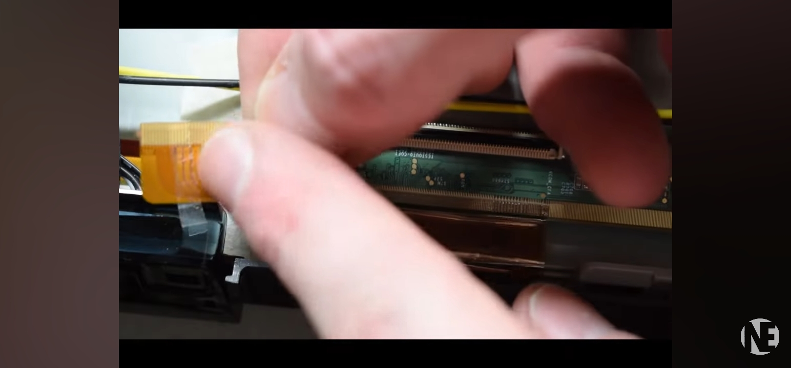

            I have nothing to lose trying the tape method. Can you give me since instruction on where to put it? Would it be on the outside edges of the ribbons or the insides? Cover just a few pins? I've seen it done on YouTube but no one ever really explains what they're doing exactly.
            Also, what side effects are present after successfully doing this? Is the screen flipped, mirrored, lines, ghosting, etc.?

              Here's a picture. You can start by covering the same or double the amount of pins like he is doing. He is doing the driver board ribbons. Can use scotch, masking, thinner is better. If you put it in the correct spot and reconnect it (all ribbons connected) the screen will fully turn on, depending on how much tape you use you may see lines in-between full picture or color discoloration but it will show like the actual Roku logo/home screen. It won't just show like vertical lines, if it does just show vertical lines the screen might be suspect then. In the end, if you get an image at all, then maybe it's the correct track. I'd try with the original main board though, since you feel you may of got wrong version.
              It may do nothing at all and give exact same results.

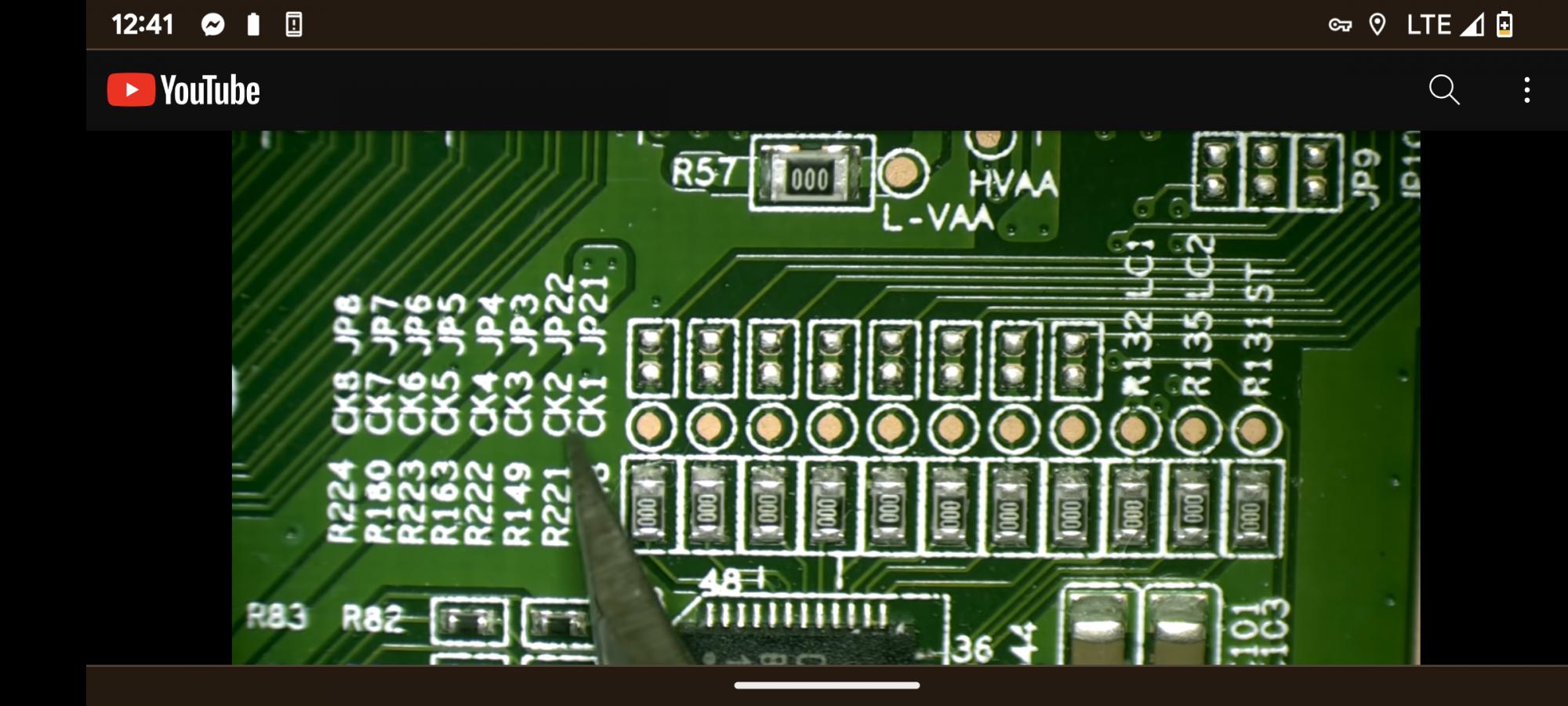

                I just watched the following video and it was extremely helpful, however I still don't know what to do in my case.
                https://m.youtube.com/watch?v=pfrRhw7-ZII
                Because the tcon is built into the main board on my model, the labeling of the traces is different. They do not say CK for Clock nor do they terminate quite the same as in the video, which looks very straightforward.
                Check out the pics of his instruction vs what my board looks like.

                  Just pick random spots. I do this with Samsungs and they have no tcon either sometimes. Just make sure unplugged before moving any cables always

                        I got the correct main board and put it in. Still no image. Exact same problem. Backlights on, sound, but no image. I tried putting a sliver of tape on some random spots on one of the ribbons but no change. With either one or both ribbons disconnected I still have a black backlit screen.

                            Use tape to cover like 8-12 pins. Start all the way on left and move over 3-5pins at s time. This does not mean it's going to work because both sides could of shorted at the same time. This may not work at all, it's not a guarantee but it does help.
                            Also no, generally you get no results until you hit the shorted spot. Once you do, the screen will turn on both sides, or with Samsungs at least will stop the boot loop.

                              Could you markup the attached picture of which areas your talking about? I was focusing on the inner sides (right edge of left ribbon, left edge of right ribbon)
                              Edit:
                              Okay so I hadn't really looked beneath the connectors until now and I THINK I may have found the clock lines or at least where they're located. I believe I read somewhere else that clock lines connect between the left and right connects. Check the second attached photo and see what you think.

                                Since you don't know which side you have to do one side at a time. Generally when I do this test it's always where the purple is. I haven't had a short in the middle of the ribbons yet, so just move the piece of tape around covering roughly 8 pins all in the purple area (just a estimate in drawing). Try pins 1-8 then if no go try pins 3-11 then try 5-13.
                                Nothing at all may happen, but at some point when you plug it in you would get a picture of there is a short on one side of the screen. Just keep moving the tape, take 10 minutes and do quickly. Hit power if it didn't work, unplug do next. It doesn't always work.
                                If you ain't getting anywhere with it then just move on to next tests you may want to try. It could be shored on both sides, it could be some screen damage you also don't see. I have got many tvs where the person said their son threw something at it but the glass isn't broken.
