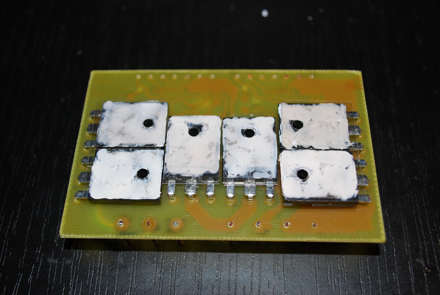

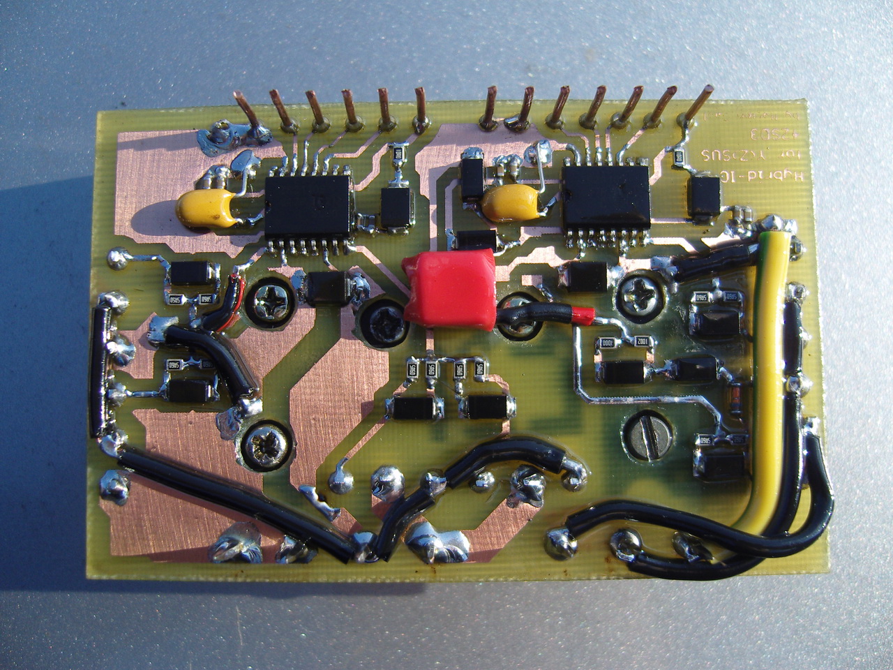

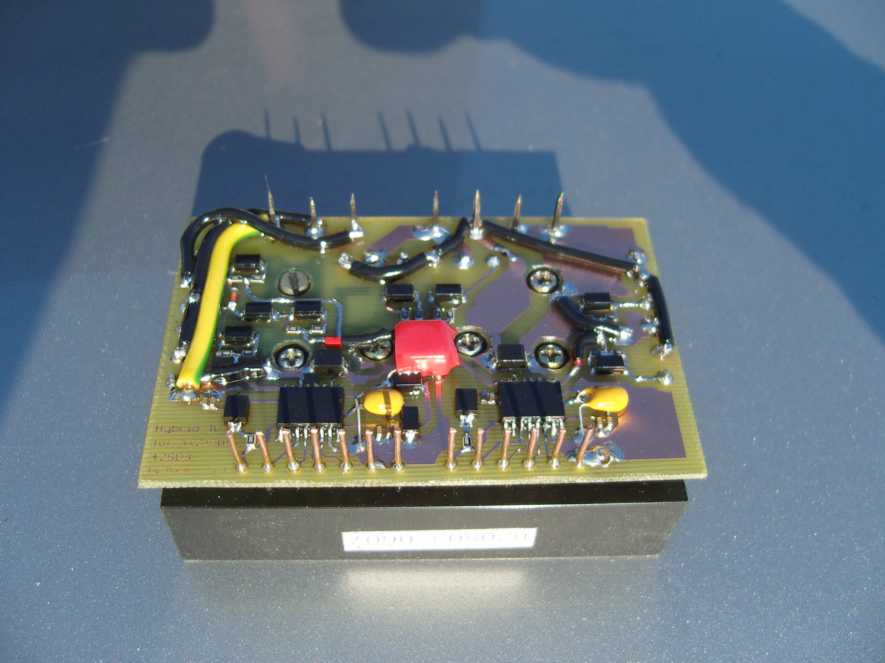

    >>Sadly, i must build new hybrids, this will cost me cca. 70€. <<
    Build?!?!
    How the heck do you rebuild all that?
    It's not problem rebuild that hybrid. Here is the PDF file, the board layout, everything. It's 100% working.

        Are you doing your own board etchings or having them made?
          I do everything myself.

            Some good news, i'm done with these hybrid replicas, next week i will install them into the Z-sustain board. I'm very curious, i hope, it will work...

              Wow! That was a lot of work. Very nice indeed!
