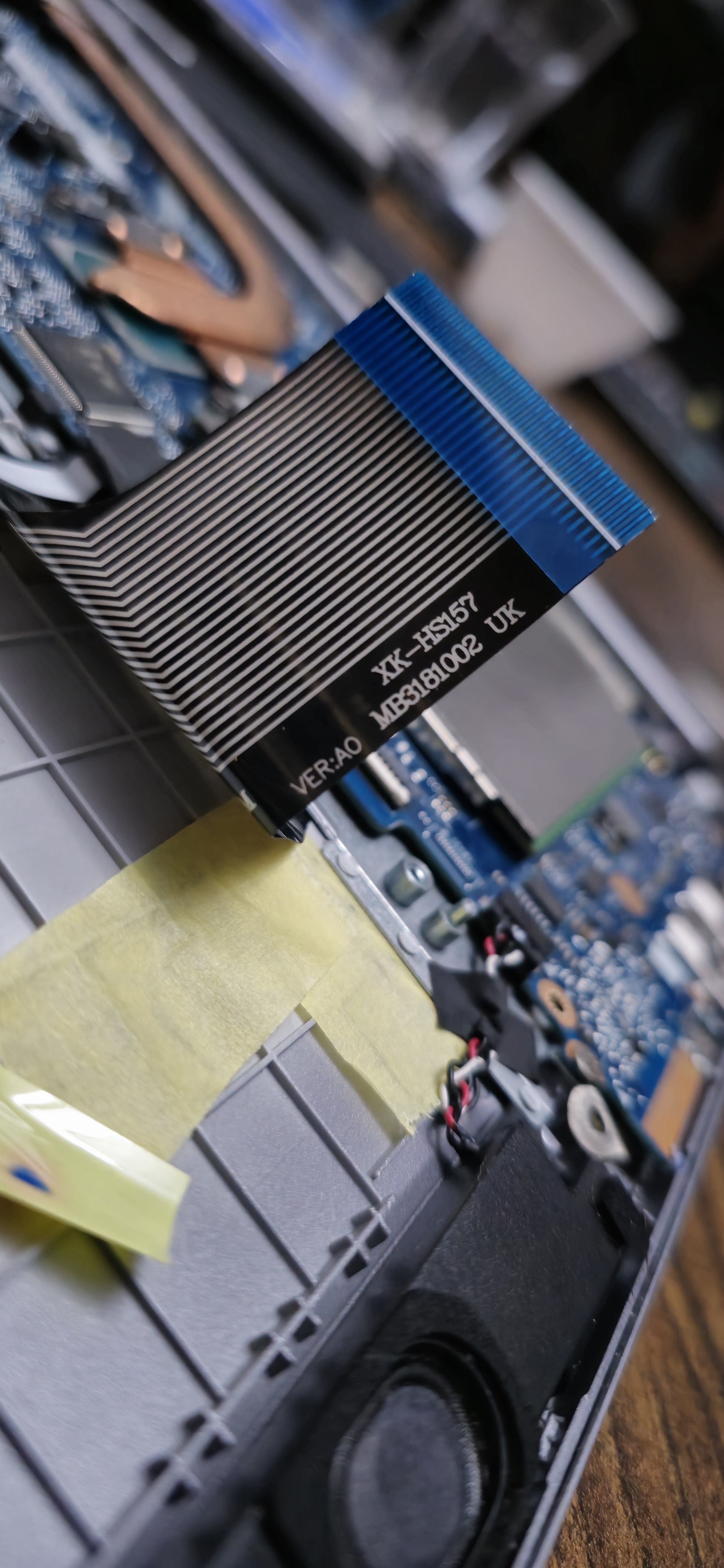

    Hello, I have a problem with a Medion notebook.
    https://www.medion.com/de/service/pr...etail/30030203
    MEDION AKOYA S15450 (MD 63650) A-DE N MSN: 3003 0203 with Windows 10 64x

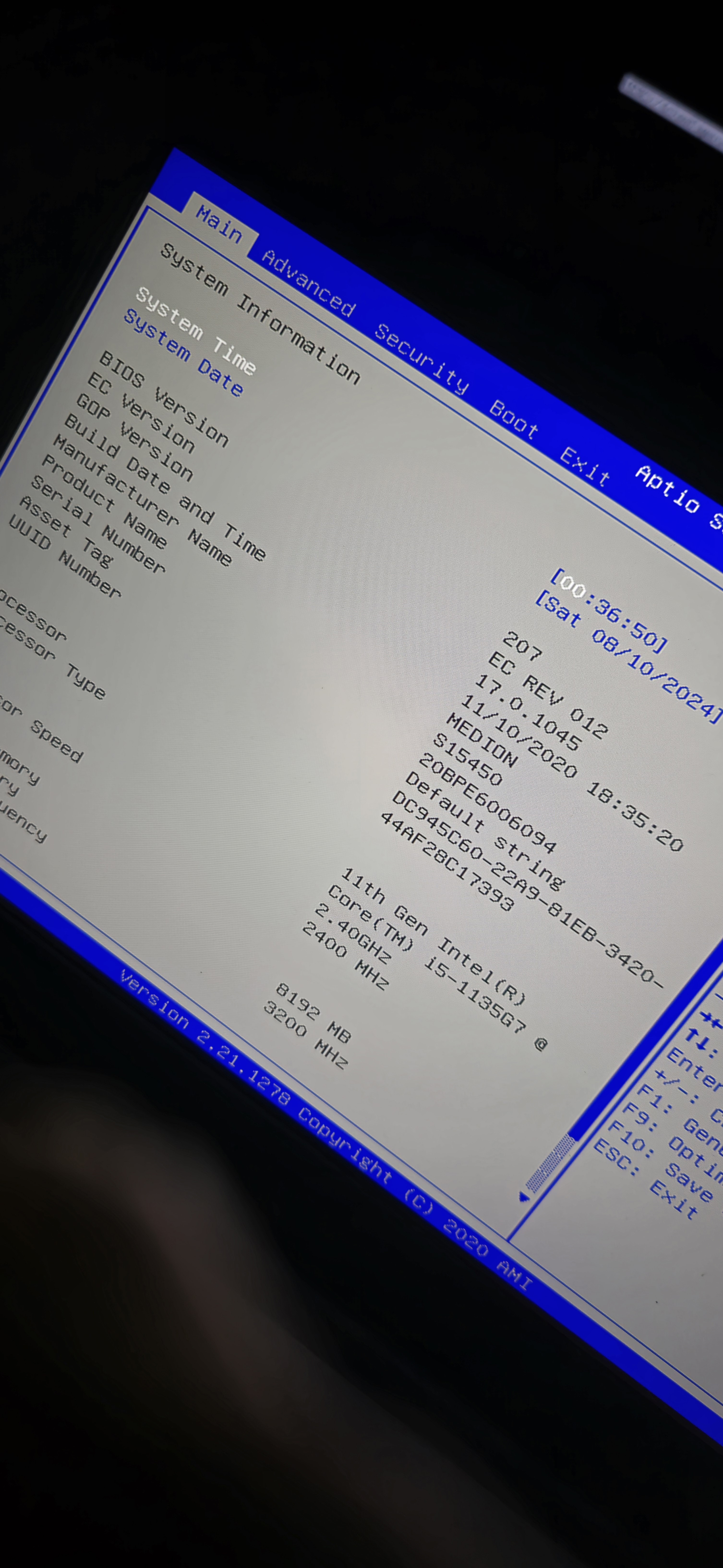

    The keyboard makes random entries and I don't seem to be the only one. Someone on this board has the same problem. I had BIOS version 207 installed and the BIOS version that Medion Support offers here as 209.
    https://community.medion.com/t5/Note.../104097/page/2
    Bios Version from Andys Post
    http://cdn.medion.com/downloads/trei...44x_s1545x.zip

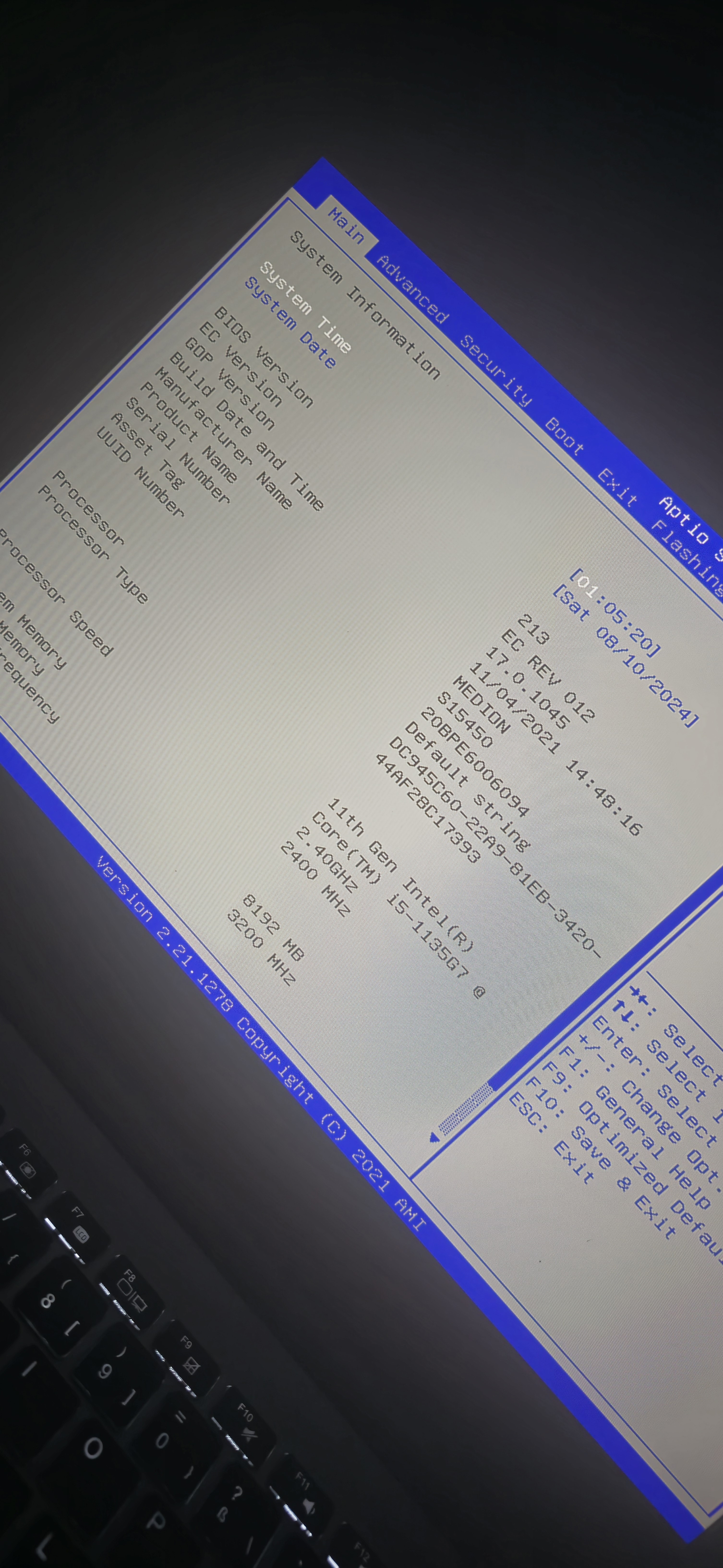

    The notebook updated the BIOS without any problems, but I have now installed BIOS version 213. Unfortunately I didn't make a backup before the update. I hope someone can help so that my notebook keyboard doesn't malfunction anymore.
    I assume that the error appeared due to a Windows Bios update. Maybe someone can tell me where Windows stores a backup in bios updates, then I could try to flash the version before 207

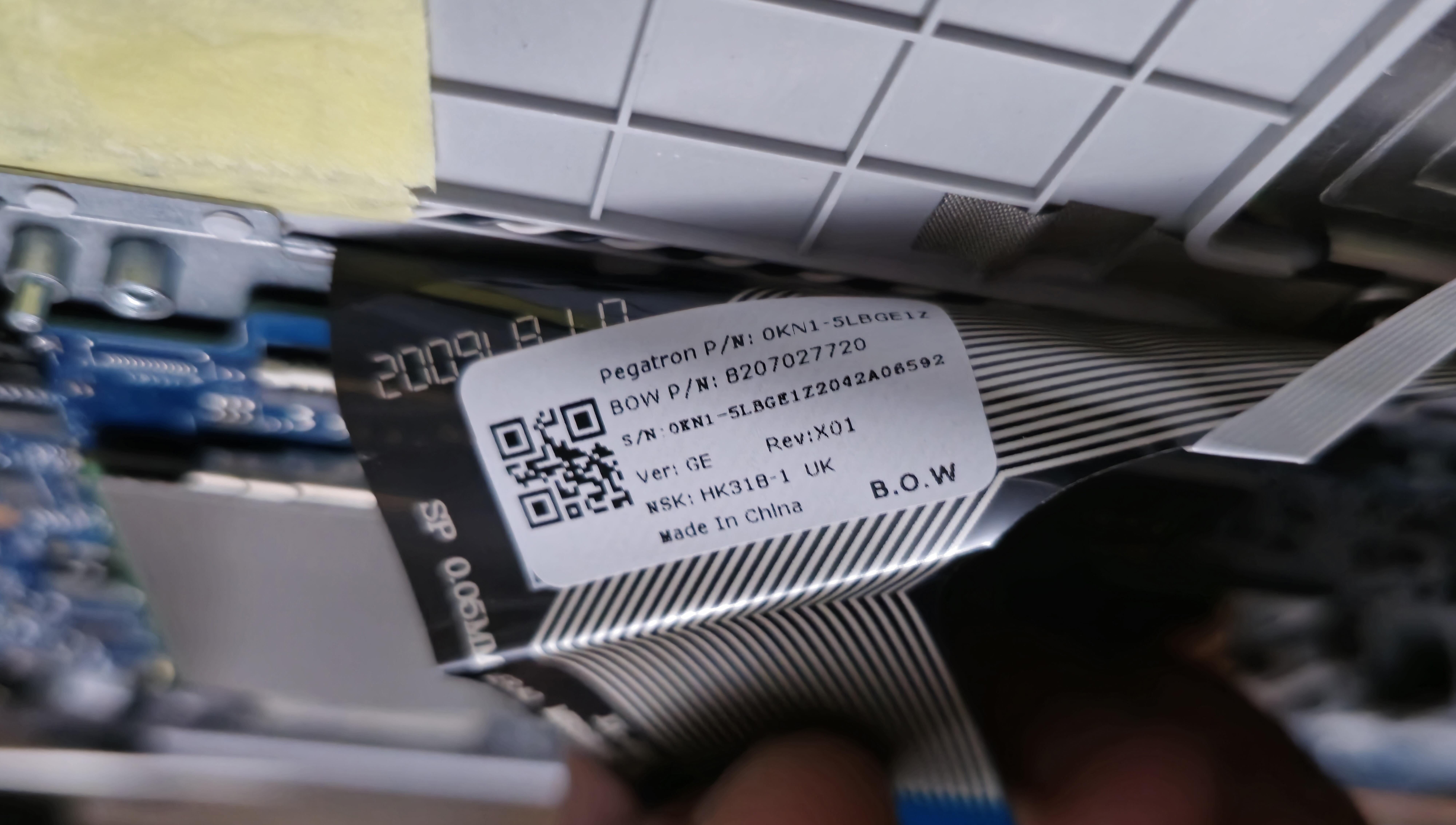

    I've added pictures of the keyboard's ribbon cable, in case that's helpful
    Thank u
