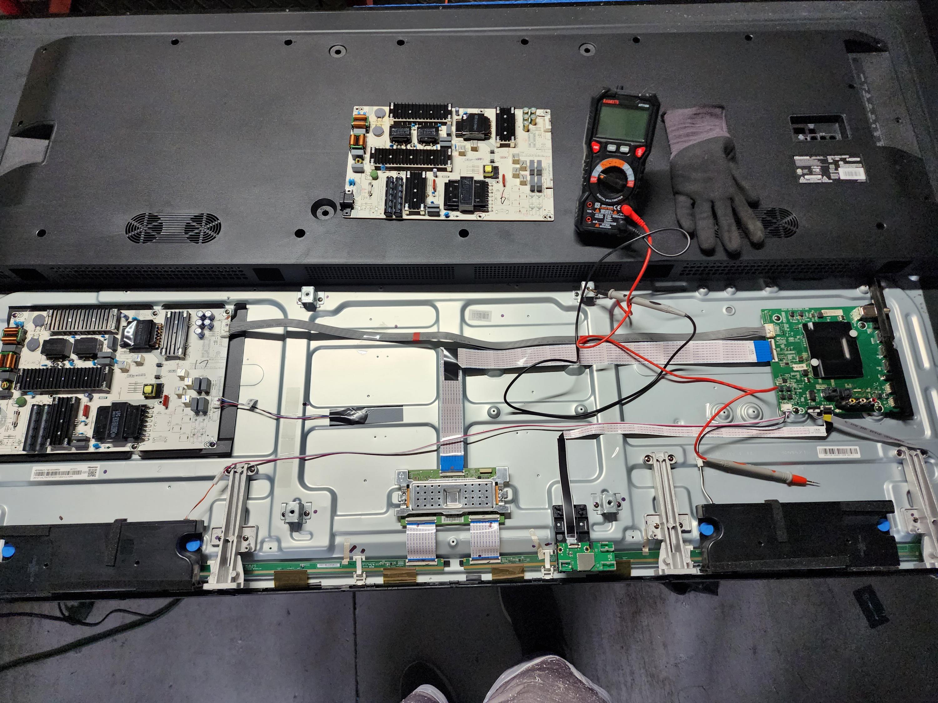

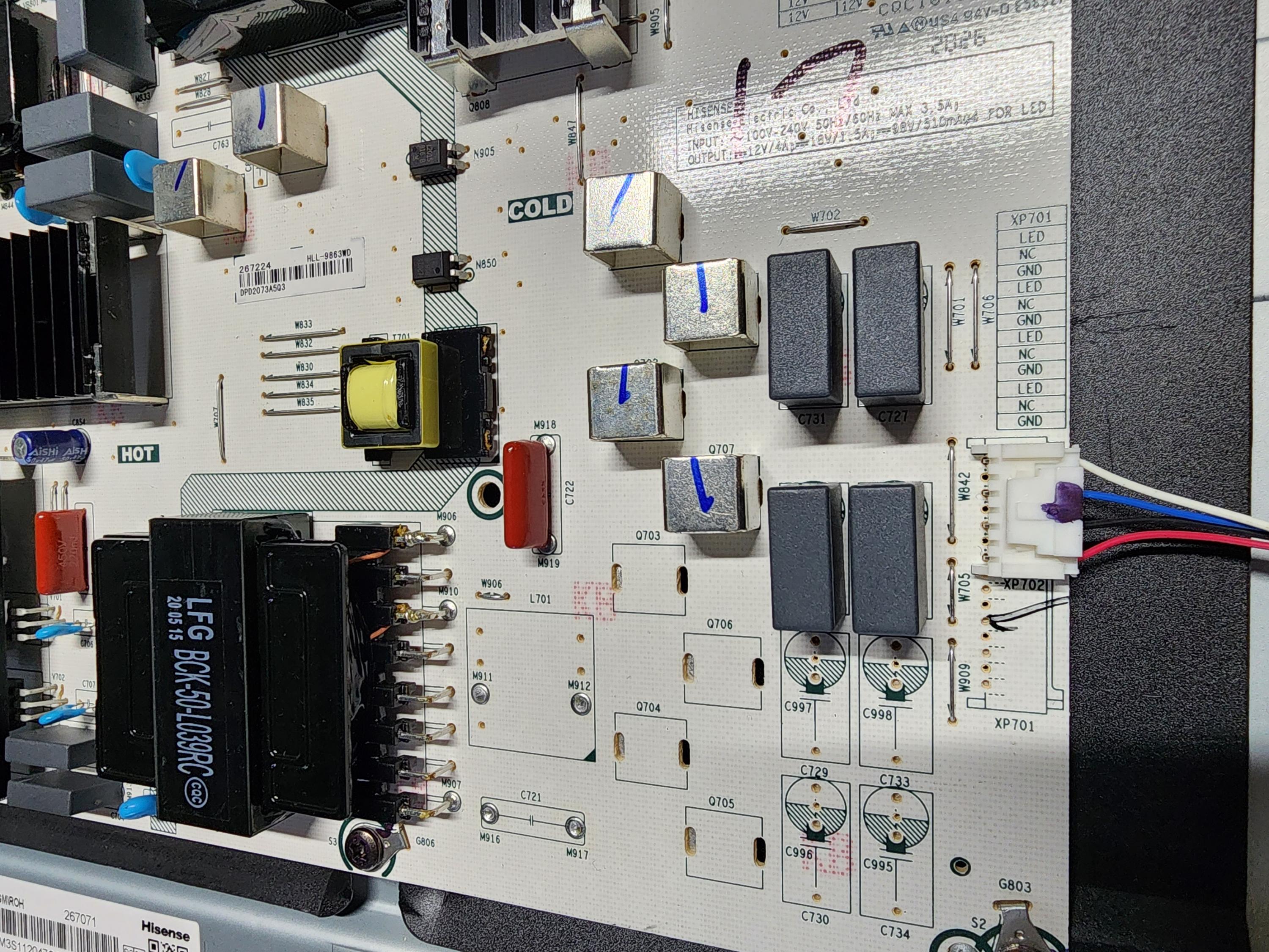

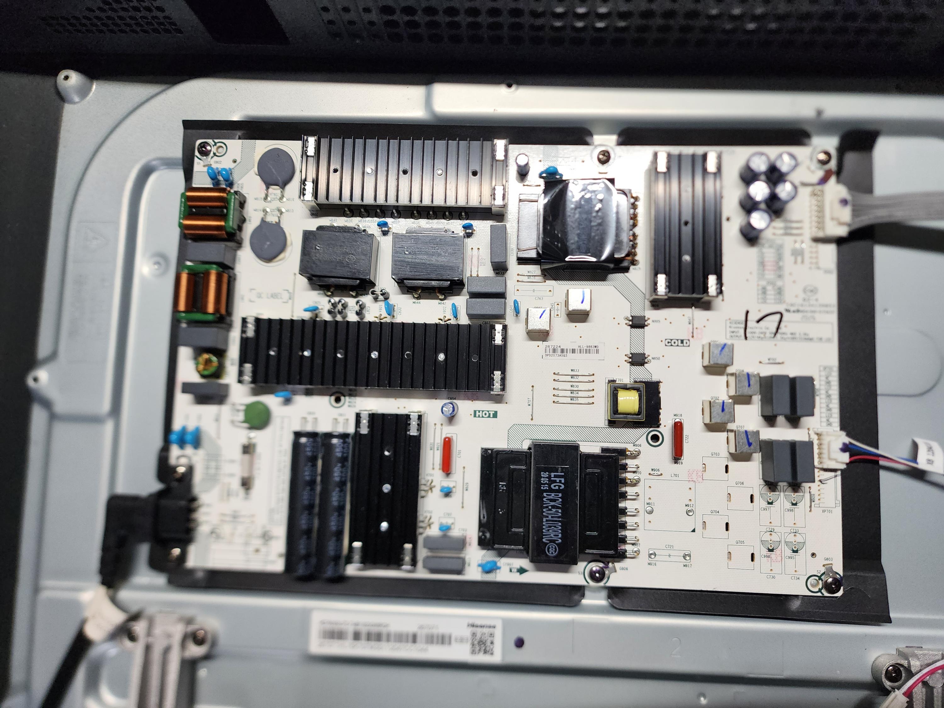

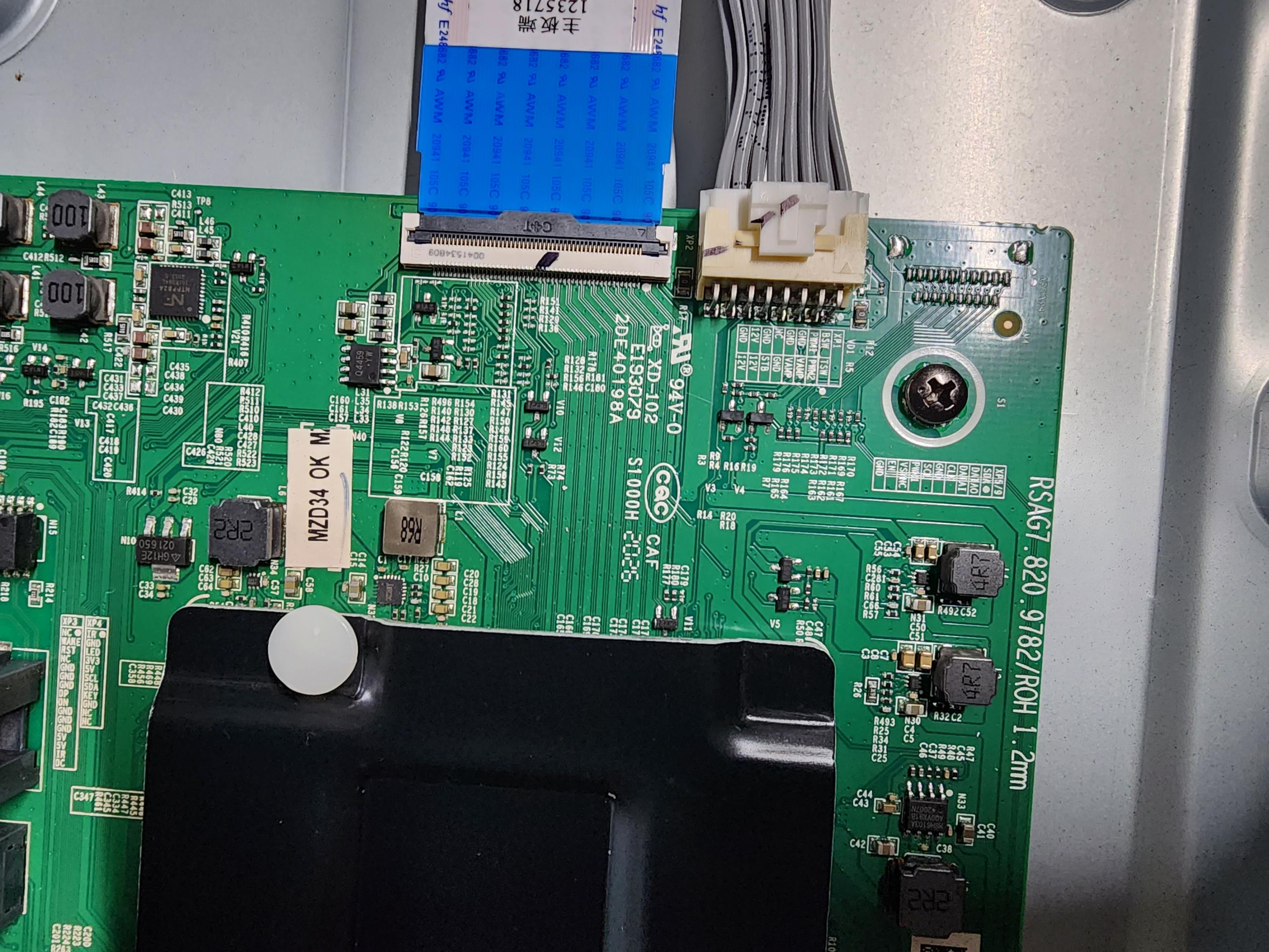

    Picked up another free one. The original owner replaced power board to try and fix them gave up gave to me
    Problem: Red led standby light blinks once every 5 seconds repeatedly for ever.power button does nothing. Nothing turns on.
    PSU, 12v are all 12v to main, 18v are all 16.6 stby is 2.6
    Disconnect main and 12v is 10.5 and 18v become 14.4.
    This is the same for BOTH psus.

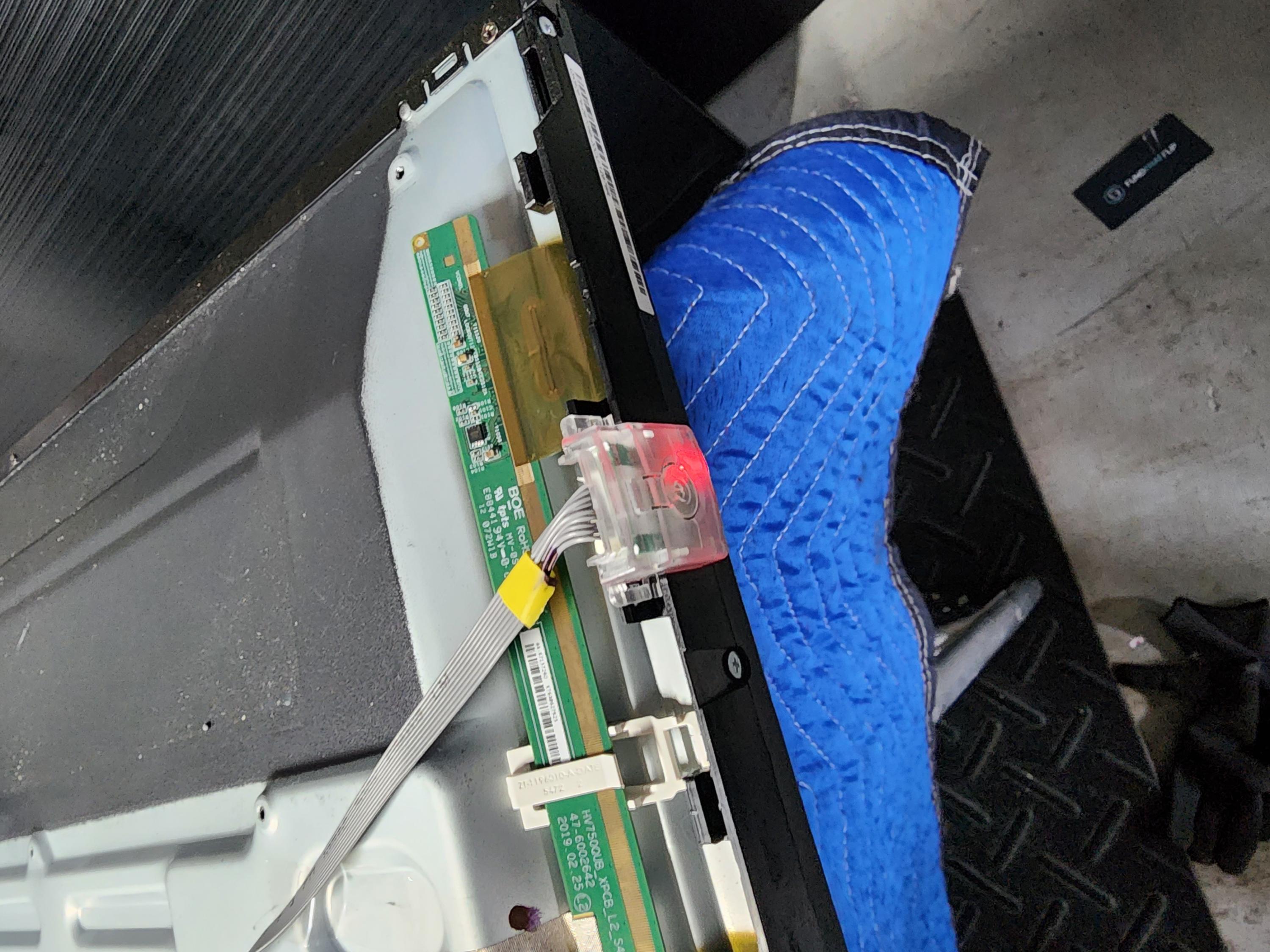

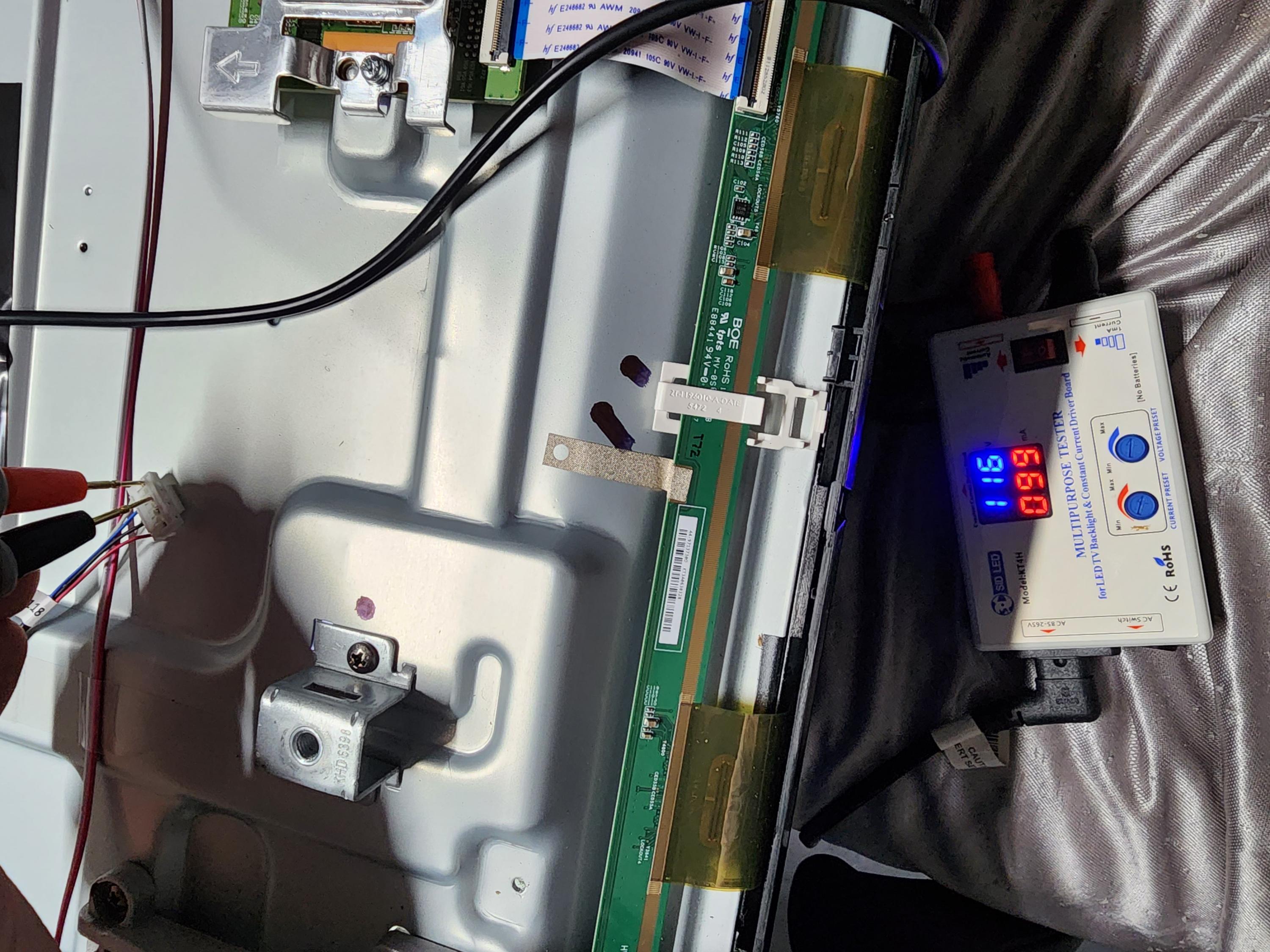

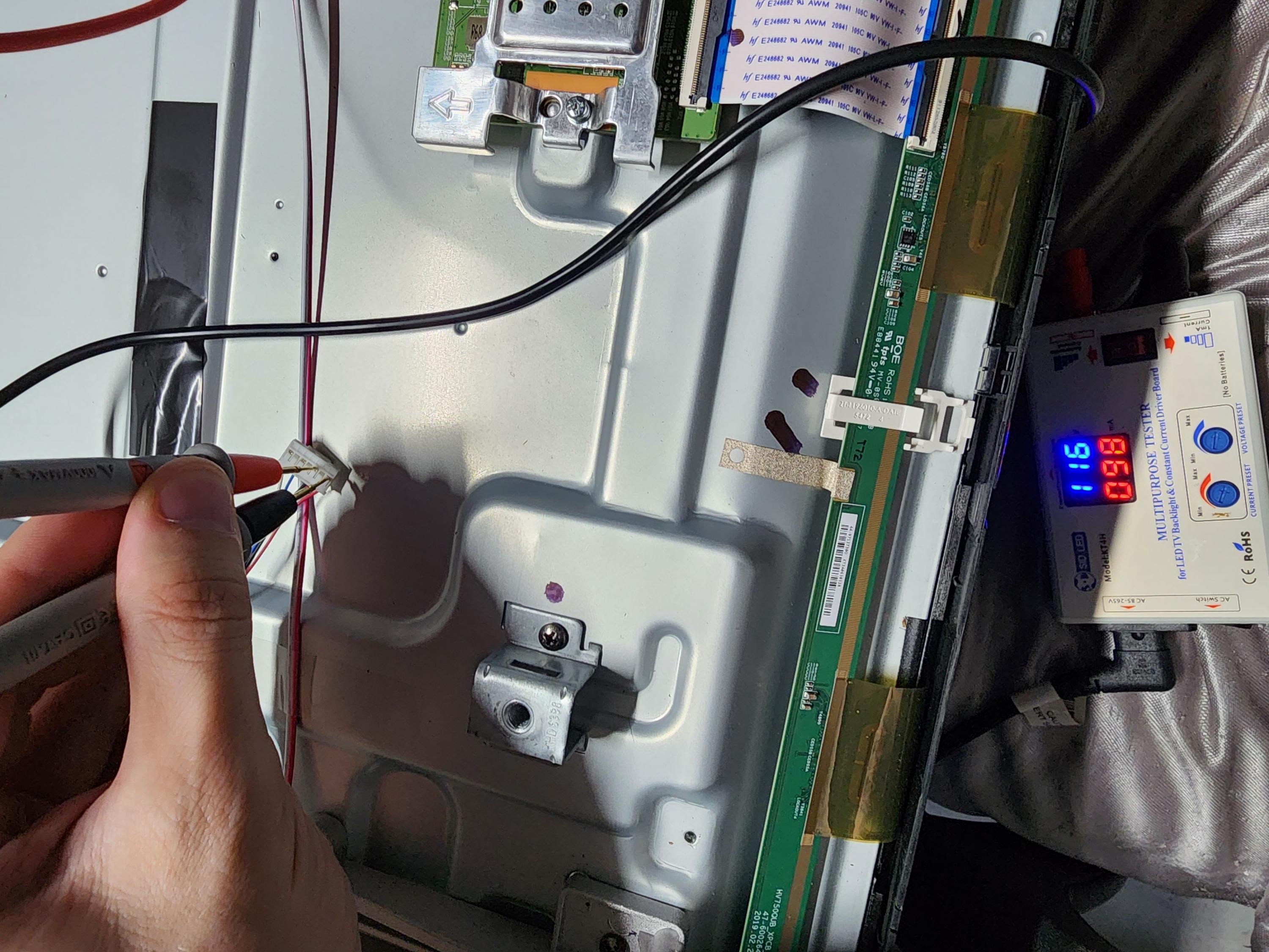

    Backlight tester turns on backlights at 105v each strand and work properly.
    I cannot get ANY voltage to backlights on either power supply. They remain zero always.
    I am stumped. I put pictures. Is there any way to jump this on or does anyone have any insight. The main is getting some voltages as it should.
    Does the main tell the PSU to turn on backlight voltages? Should I have some sort of voltages at the PSU for LEDs? Help lol

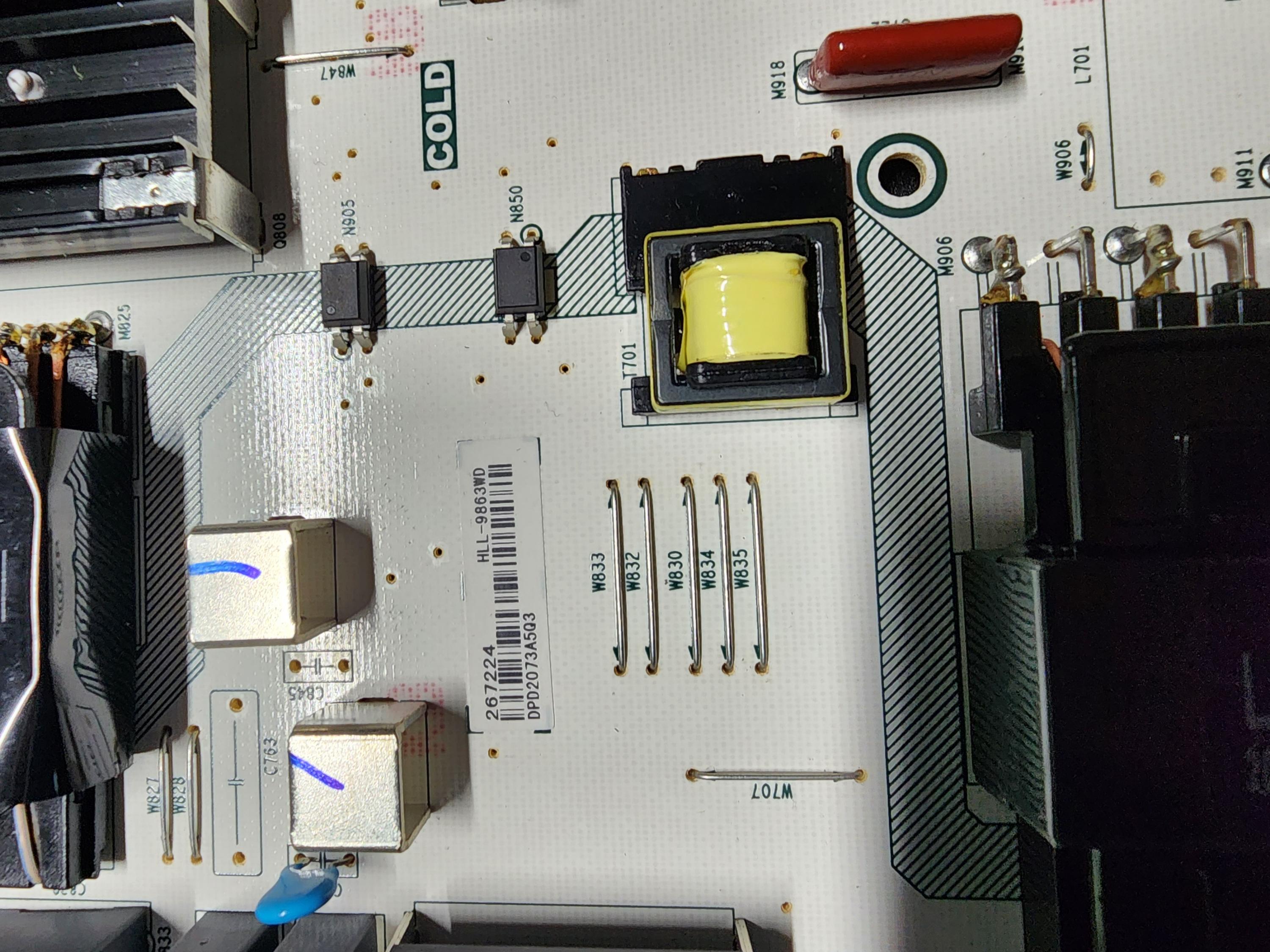

    As a note w833,832,830,834,835 are all at -5v (checking in DC with chassis ground) and start and -5 and drop all down to zero, if that means anything.

      Check XP901, voltage on the BRI pin, check it in standby then power on tv, what voltage do you get in both situations?
          Bri is 0.151volts, mashing power button does no change as TV won't power on at all.
          BSW is .105v, mashing power button jumpers it to .109 and right back down immediately, that's all that's happening.
          PSON never gets any volts

                    Sony the LEDs both have 105v and do turn on with tester

                        so you have step down circuit on MB.. work on it,, and check if u have spi on it if it shorted

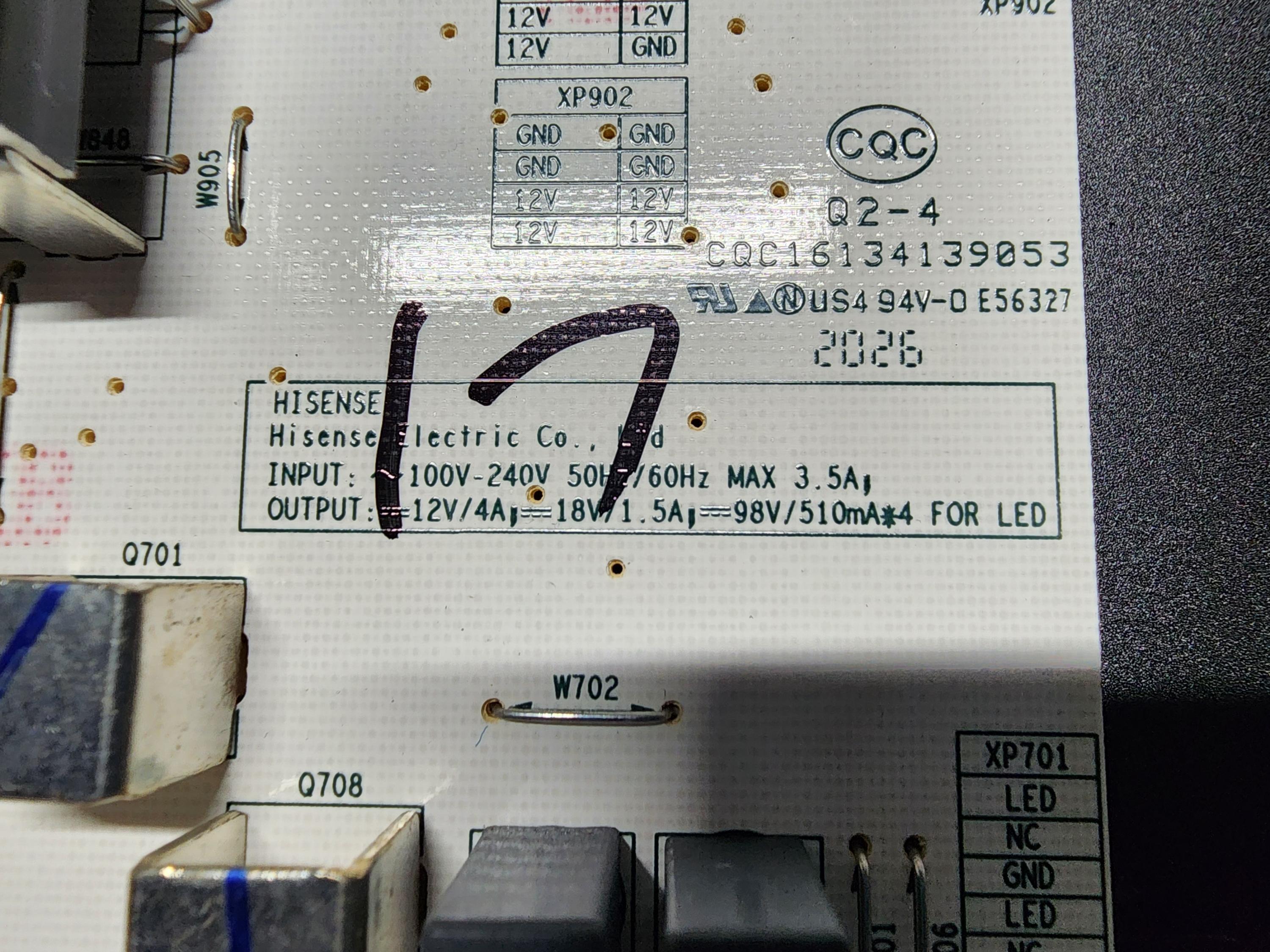

                          Like Diah said 105 seems quite low for a 75 inch tv, does this powerboard have a label for expected backlight voltages? not sure tho, maybe it's normal if it's edge lit.

                            Re: Hisense H6750G stumped on this
                            I really don't know what this means. I tried to look up step down circuit. Don't know what spi is either.

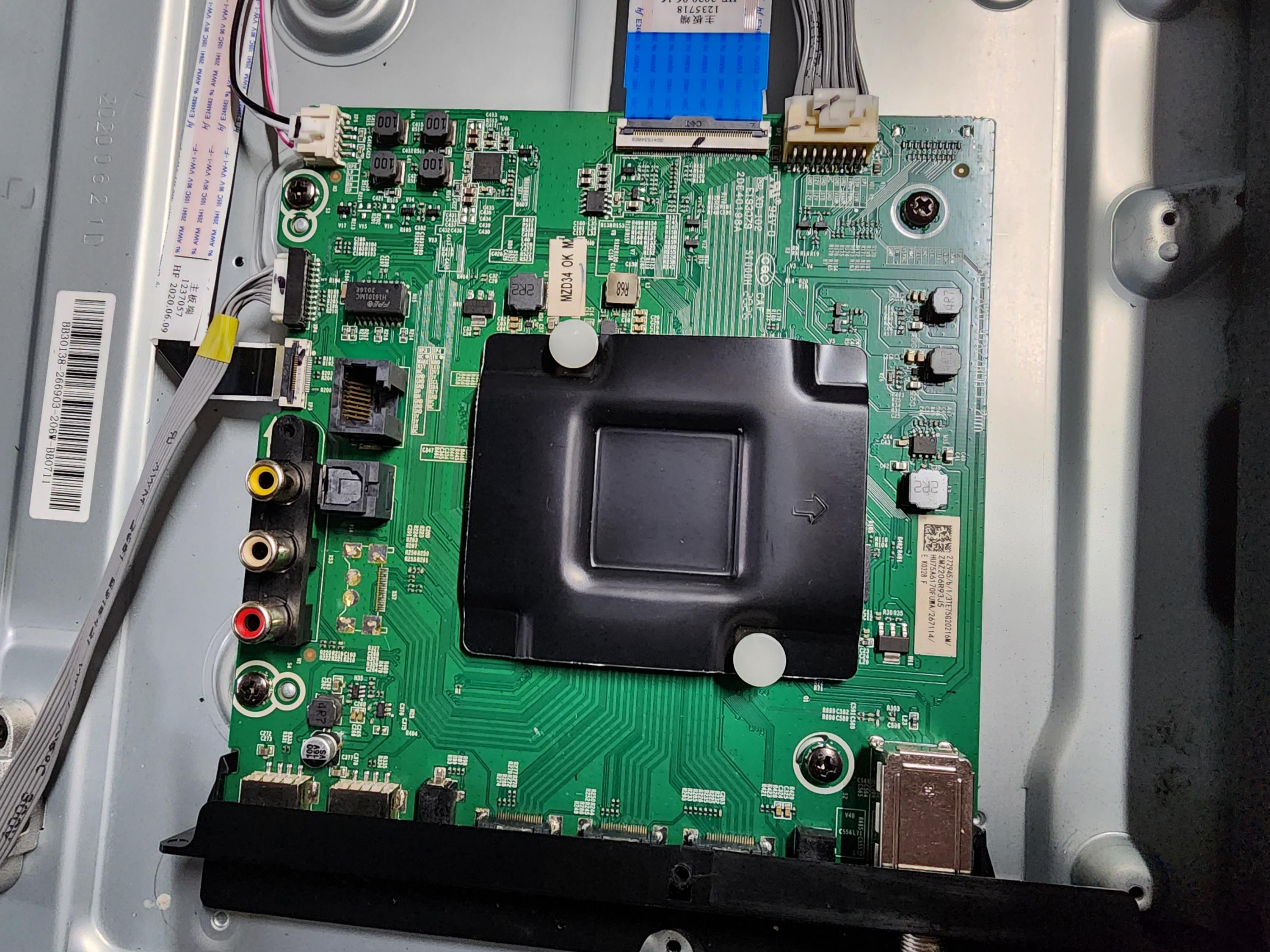

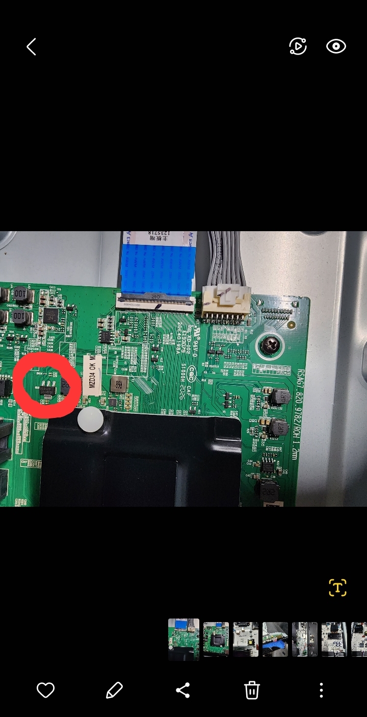

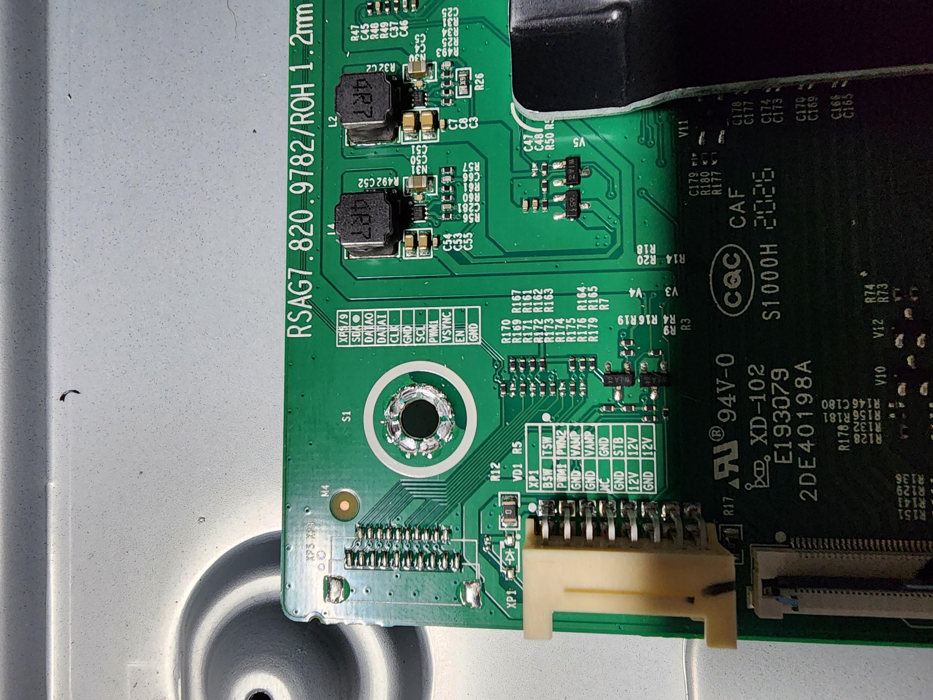

                            Here are some pictures, one component gets 220degree fahrenheit which I circled on MB.
                            And here are some pictures of it.
                            Sony, they are not edge lit and for some reason my last Hisense was only 2.5 v per light and looked dim. So 105v for 2 sets. Also here's the expected voltages picture which says 98vAre we thinking this is a MB problem?

                              disconnect the blue LVDS cable from MB side and turn n see if backlight come on
                                No backlight, nothing changes
                                Edit, the backlight voltages come up to 0.200v and drop to zero.
                                This is with everything connected and MB lvds cable disconnected
                                Also with lvds cable connected the voltages come up and down like that now also, must of missed this earliwr

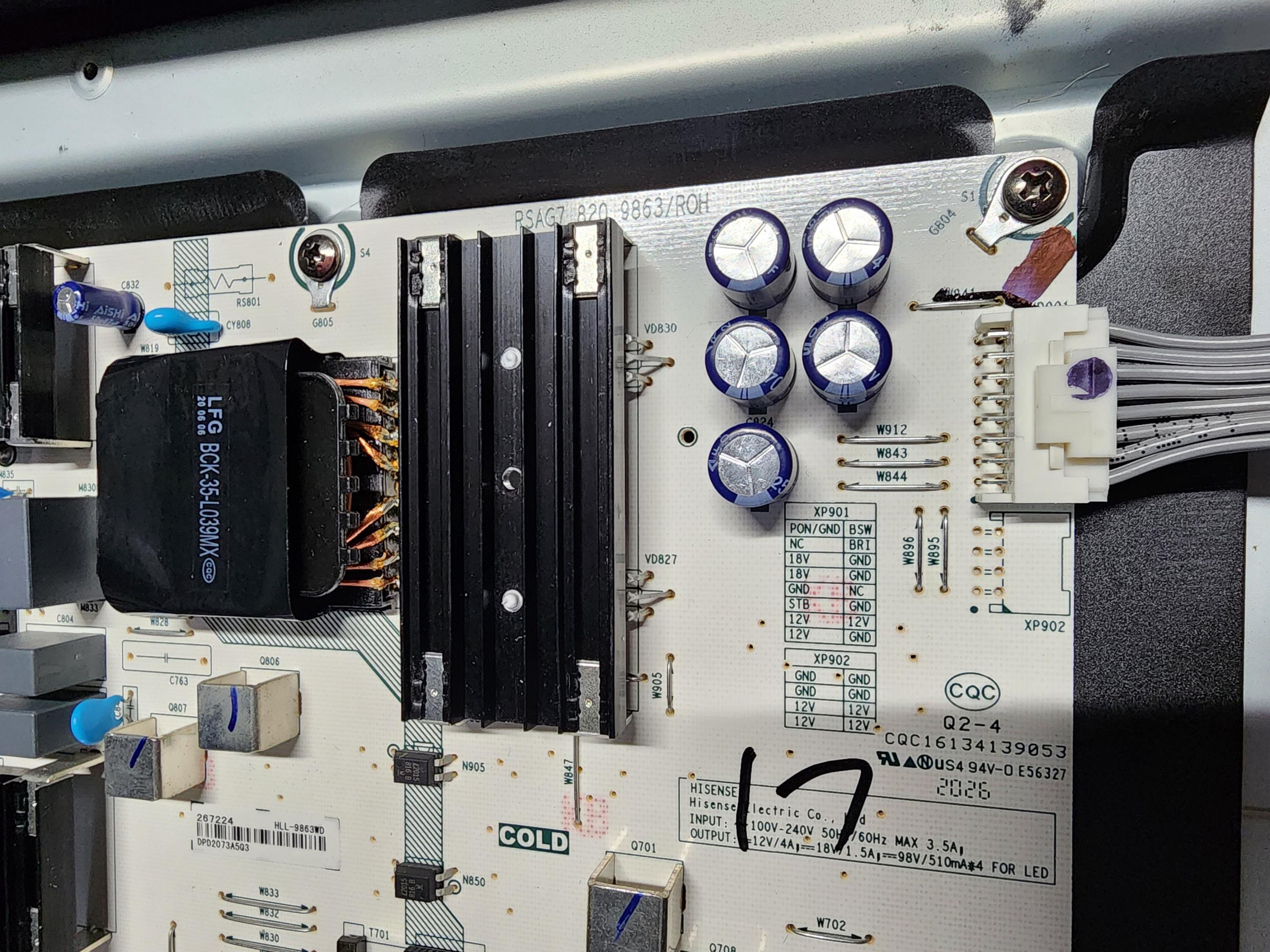

                                  The led supply voltage for this power supply is 98V@510ma. You could have a bad led in the panel causing the problem, your led tester likely only provides about 10ma, when the led draw a higher current they can fail.
                                  Using W842 as ground, check the voltage on W702 as you turn on the tv, see if this voltage comes up and drops, It may be tough to check with a meter.
                                    All these jumper wires are in the primary (hot) side of the power supply, you can NOT check these points using chassis ground.
                                        I can hit about 100ma, and they still turn on. Not saying this is wrong but is what I got.
