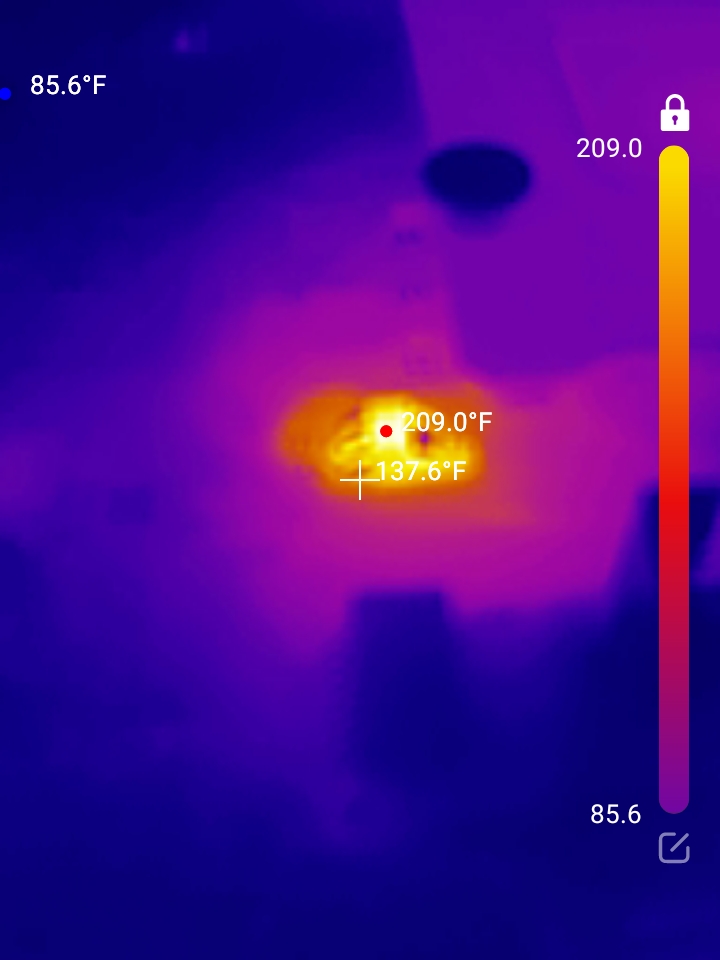

      Re: Hisense H6750G stumped on this
      That does seem very hot for a voltage regulator, check those little caps right by it, are any shorted, also what do you get measured in ohms?
      None shorted ,
      C33/34 26.1 ohm
      C32/29 38 Kohm

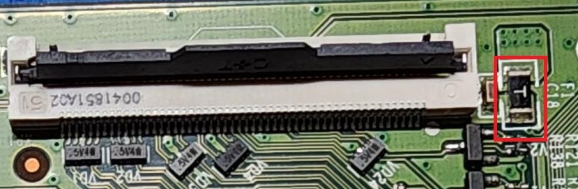

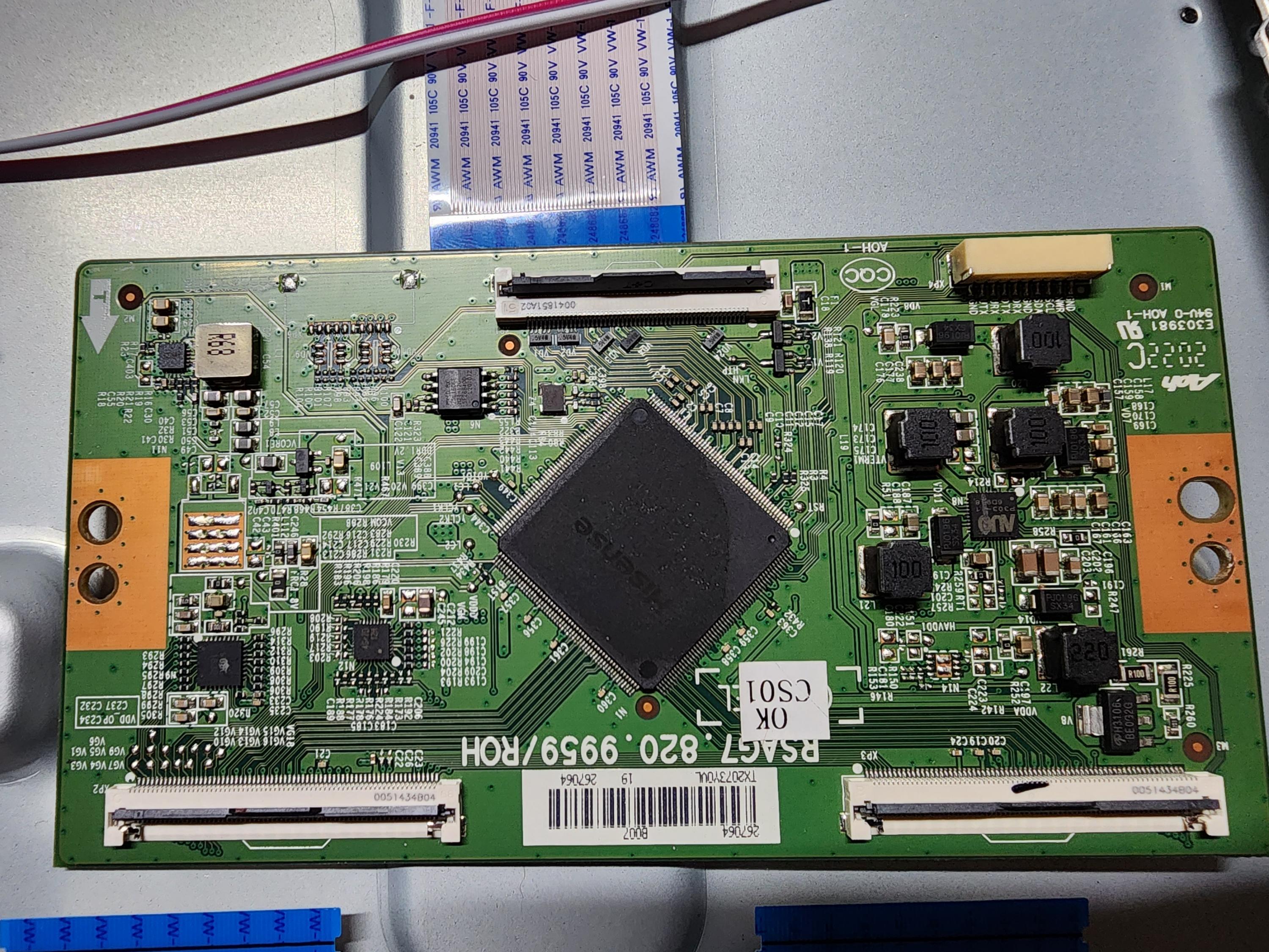

        Here's tcon, I normally seen fuses lol can someone point out where the fuse is? I don't see one at all
        • Diah
          • Feb 2013
          • 6445
          on the right side the black on with T written on it as called on print F1
            Lol I did this and it worked lol. Saw red and green and bunch of colors. Well I need practice pulling apart a TV for the 1 millionth time lol so yea.

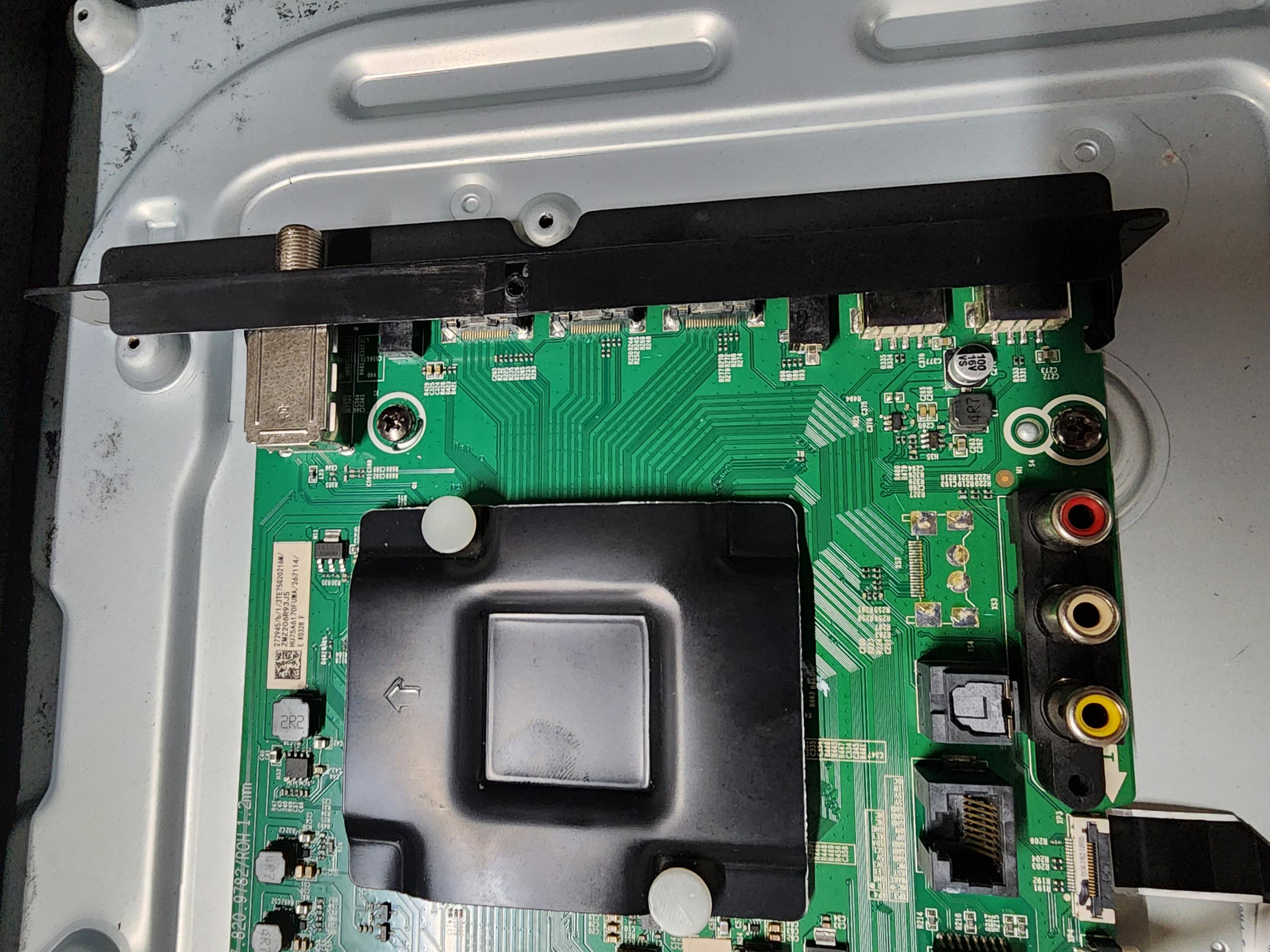

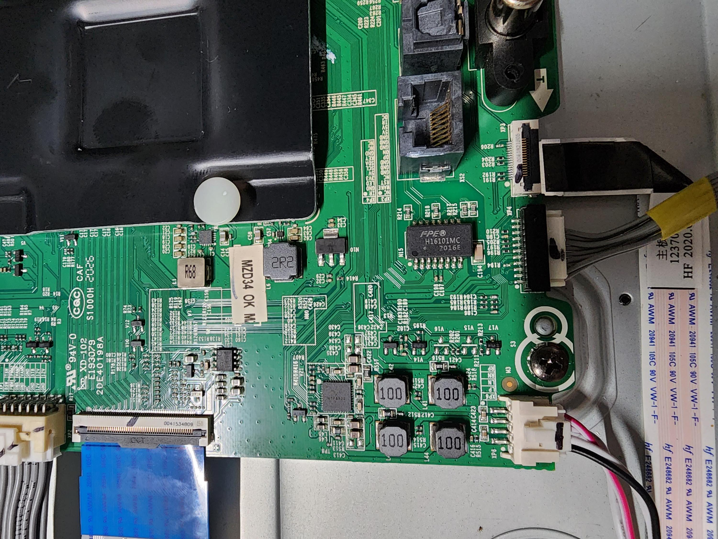

                    #29
                    Here's MB pic, I can't find anything wrong here. No shorts that I find. Is there some area I should look at? They don't have this MB online anywhere. Crazy

                      #30
                      you need to check
                      1- LVDS connected.... check if T-CON fuse F1 have 12V from both side... if no V.
                      then disconnect the wifi / BT module from MB and check again. if still no V
                      you need to check the Regulator you said before its go hot read the V on all pins Ref to chassis
                      i think you have Service port on the side between USB port and HDMI , if this service port need to capture the log at start up the tV
                      also from ypurs post the 18V rail it read 16V... slide out the wire of it from PSU side. and turn on check the pins of it if it go high to 18V.

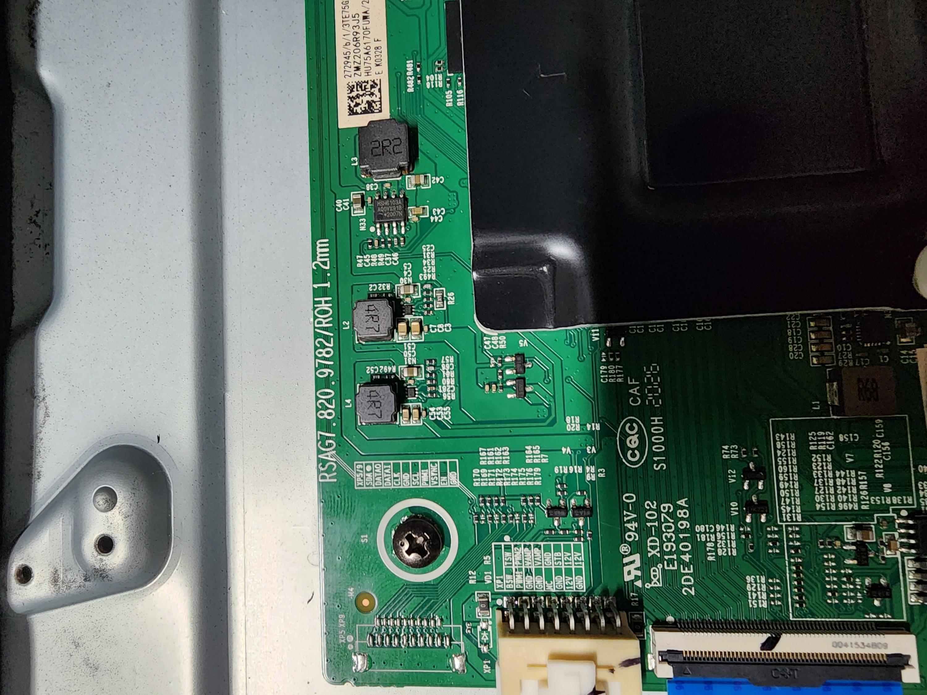

                        #31
                        Yep, check GH12E voltages, don't think it should run that hot.

                          #32
                          Great pitures bytheway, these detailed pictures are a fine example of what's needed by the helpers.

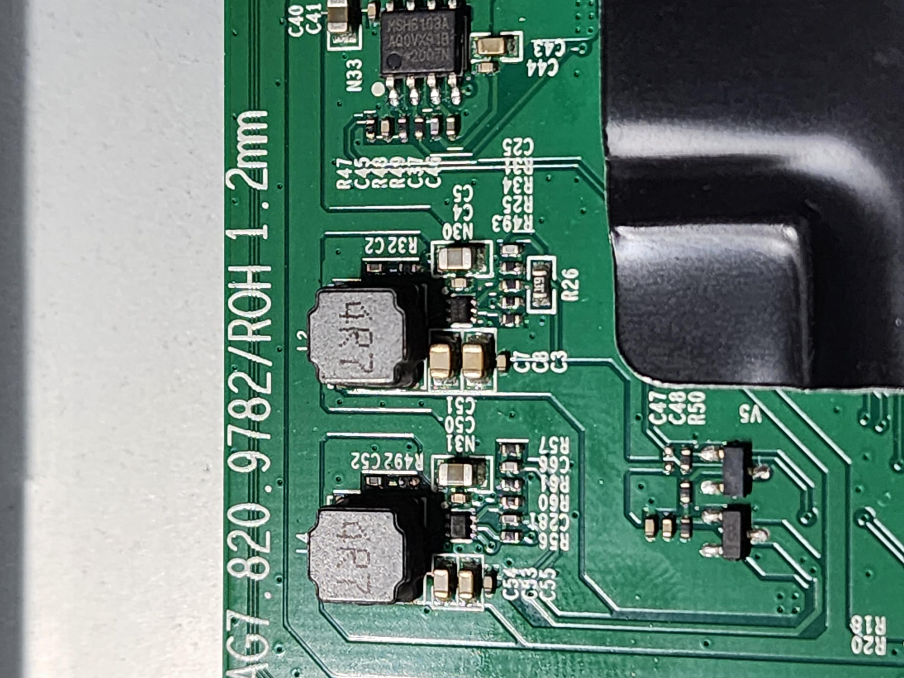

                            #33
                            Gh12E gets 0v, 3.28, 5.1 and opposite side gets 3.28
                            TV won't turn on but Tcon doesn't get any V to fuse on either side, with or without WiFi disconnected
                            I don't see a service port, there's a headphone jack between HDMI and USB
                            Yes 18v reads 16.6 actually . I don't know what you mean slide out the wire and check for 18V. Do you mean disconnect it from the harness as a single wire?
                            Here's some pictures Sony lol

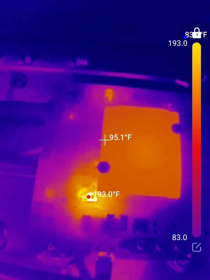

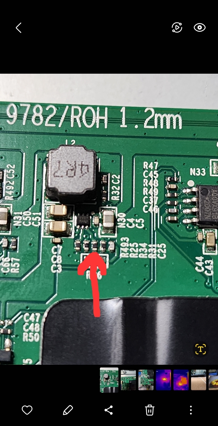

                            • EazyBone
                              • Jun 2023
                              • 1355
                              • United states
                              #34
                              Update 2 seconds later Lol
                              I touched this specific cap to test voltage out of the other area that's getting hot and when I did the backlight flickered and then turned on. I didn't have time to check other voltages, but I was able to check one 18v pin and it had come up to 16.8v before I realized I did something. Help now???? Lol
                              Now the TV red standby light doesn't come on anymore lol and voltages are now back to main disconnected from mb voltages
                              Now everything is dead lol. I shorted something touching that exact area or something.
                              As a note the 4R7 component was getting hot and is the other hot spot seen in thermal. Only 115F but still hot compared to other 4R7

                                #35
                                disconnect MB from PSU and check which V you have on the socket
                                • Diah
                                  • Feb 2013
                                  • 6445
                                  #36
                                  by the way the marked part you touched are R not C..... if you shorted with chassis possible one of the R get Open

                                    #37
                                    They are 12v (is 10) 18 v (is 14)
                                    Hisense 272945 is board and literally no one has it lol. The luck
