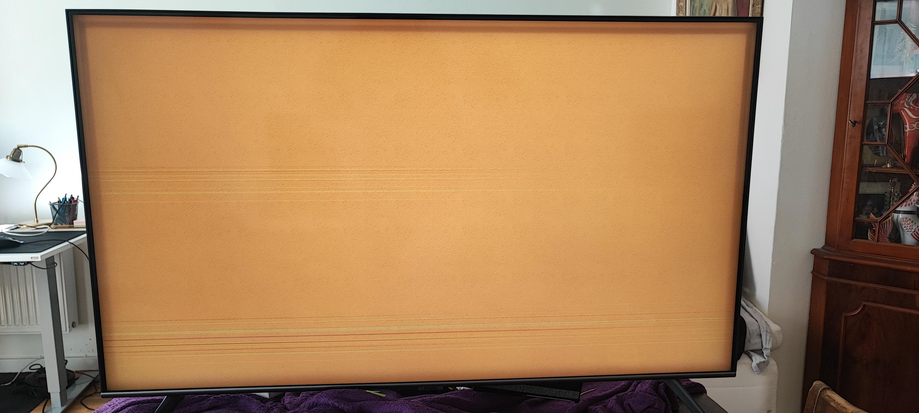

                        Post a picture of the lines, different type lines can mean different faults.

                            Re: Quick question about the ribbon
                            Here are a picture of the lines. The lines are not solid, at least not all. Some change color and some disappear. Changes happens like every other second.

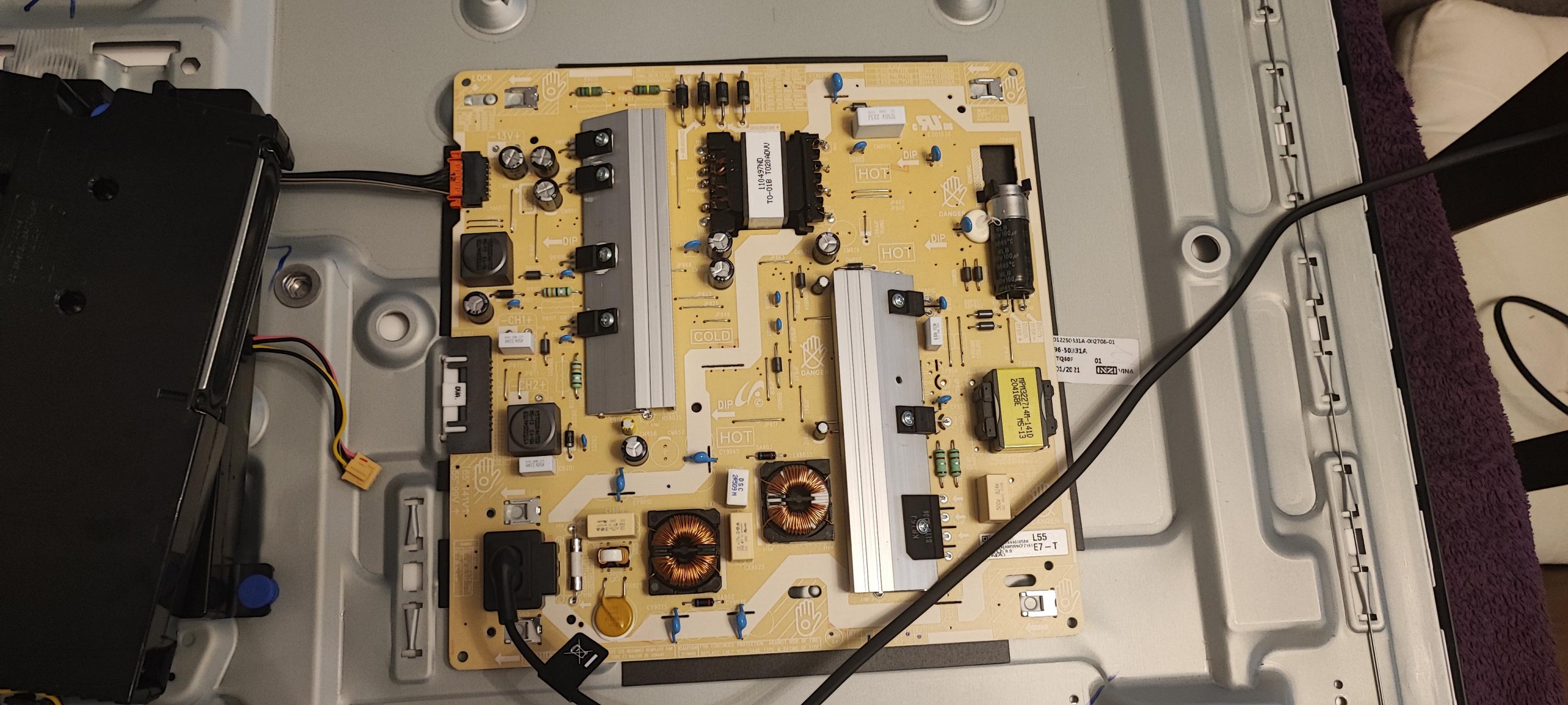

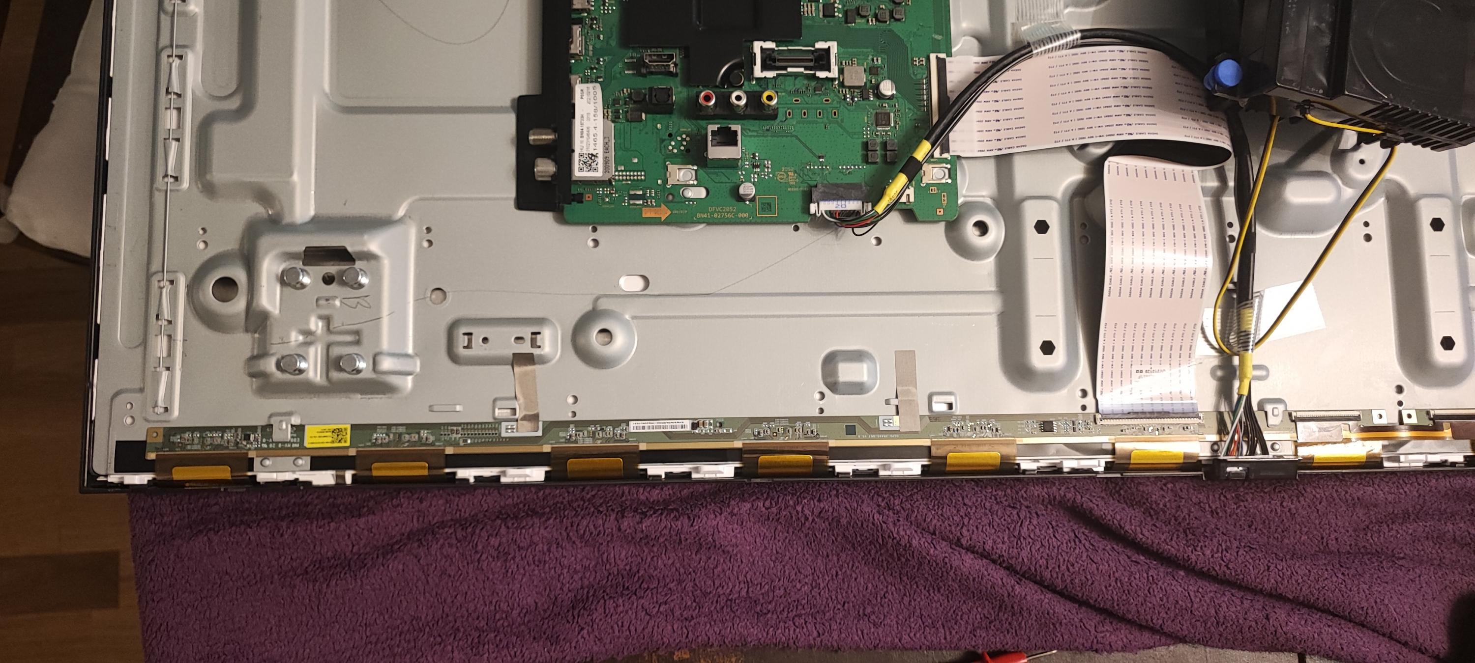

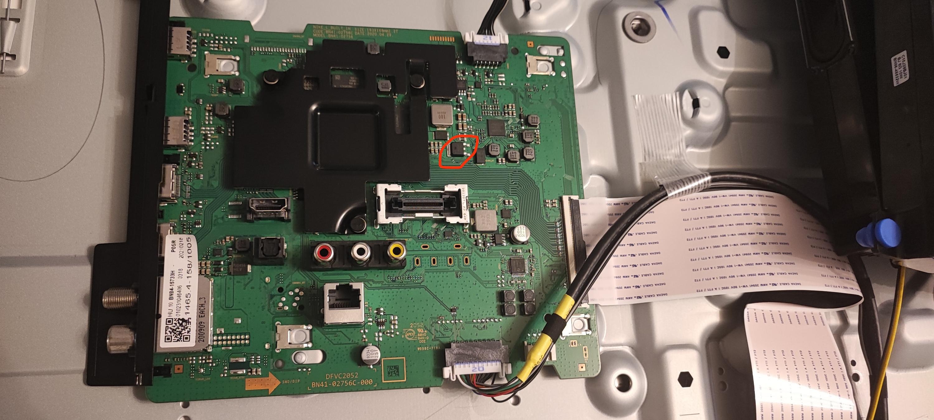

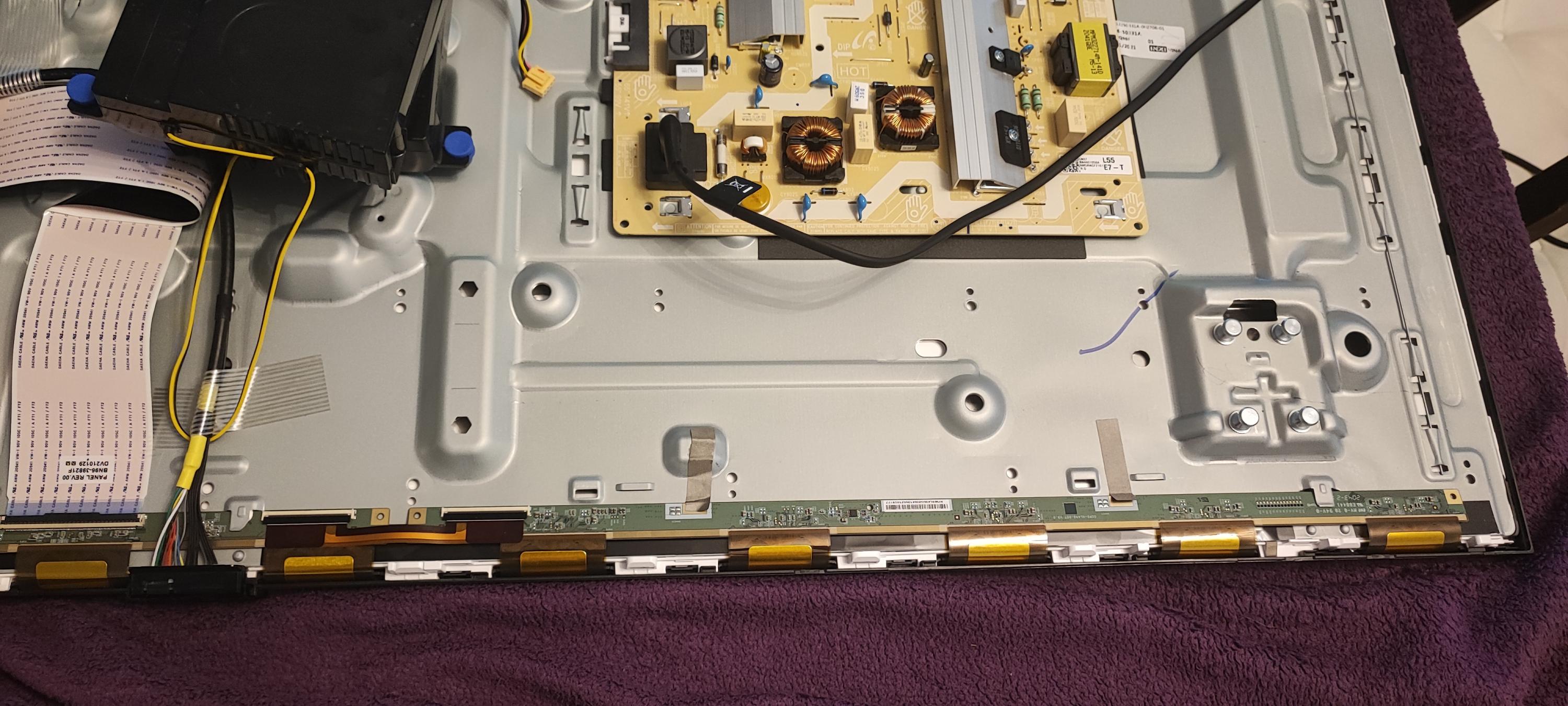

                              This is what I have to work with. I have the power board, the mainboard and the other long board going from end to end.
                              Only Voltage Regulator I've found is on the mainboard circled in red but that can't be true? Where should I put my focus? On the mainboard or the long board?
