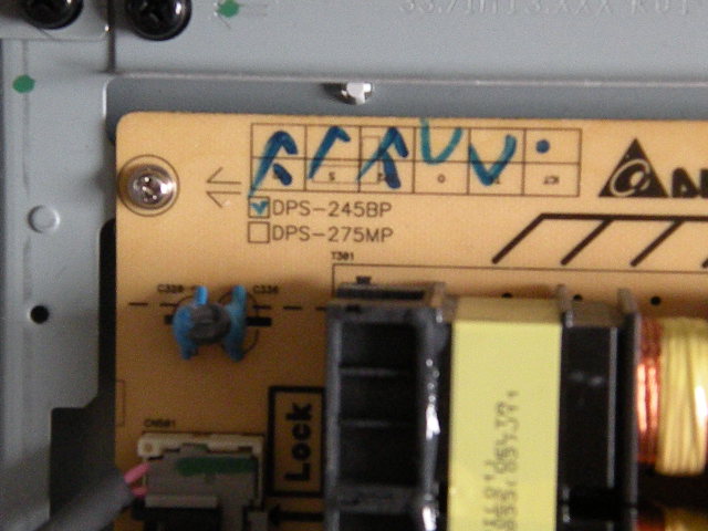

                              Re: Sony KDL-40s4100 No Picture/Sound/Backlight
                              I alos came across one of those Sony tv and have also the same issues, no pictures, so sound and no backlight.
                              powering the tv up, the Green led is lit and steady.
                              i have taken the tv apart and took the power supply out and put it back in and reconnect all the harnesses and the problem was still there.
                              took my voltmeter and took some voltage around the T301 area. at the output? 0V. at the input? over 70 Volt
                              Could it a bad Relay?
                              CN501 also had no power
                              Cn503 have all the power and proper signal
                              i don't think the T-con is the issue as i am looking more towards a bad power supply unless i am wrong.
                              any feedback or ideas will be greatly appreciated.
                              Thank you
                              • selldoor
                                Slow Learner
                                • Dec 2010
                                • 7870
                                Based on your description we know the main fuse is ok and that is about all.
                                We can help a lot more if you please post good clear pictures of the whole chassis, and then pictures of each board, front and back and close up of connectors, (max resolution 2000x2000 and 2MB) using the manage attachments button, which is found by clicking "go advanced" under quick reply.
                                Examples of what is needed
                                https://www.badcaps.net/forum/attach...1&d=1290283049
                                https://www.badcaps.net/forum/attach...7&d=1280167246
                                It will be useful if you can say a bit about yourself - skills tools etc.

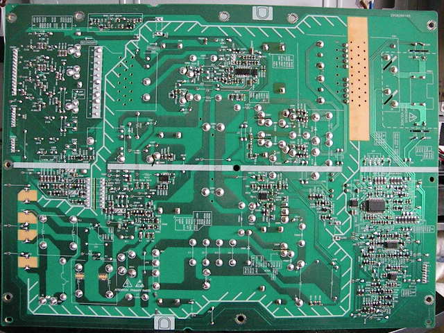

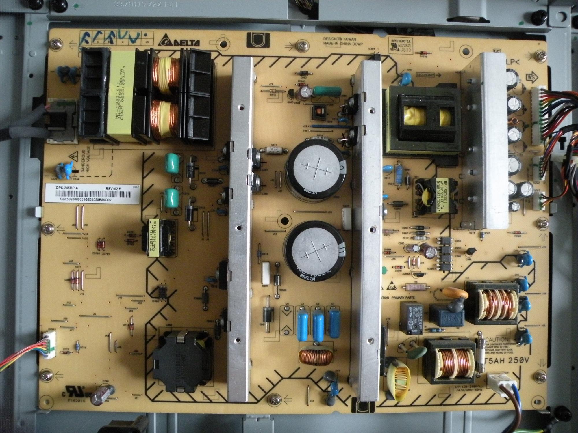

                                  this is the Power supply off the tv
                                  i don't have the botom side of it, but i did inspect all the welds and look good so far, no Extra flux laying on the board.
                                  As for my experience:
                                  well i graduated in Audio video repairs like over 13 years ago, so technology sort of got over me, but i still grasp the concept on how they work as i usually try to keep myself up to date with new machines.
                                  i do have the basic tools for repair like the soldering iron, flux and etc. i usually buy new equipment whenever i need them to complete the job.
                                  Been rebuilding Xbox, Xbox 360, Ps3 and Apple computers for quite some time as i can repair them with my eyes closed now.
                                    Picture is not really sharp enough for trouble shooting - I also asked that you did not post inline or host offsite and you have managed to do both. I asked this as some of our members wont look at threads with pictures posted like that.
                                    You need to give us more detail about what you are doing - we dont know
                                    CN1 from CN3 Please retest and post as follows
                                    CN1
                                    Pin 1 12v actual 12.1v
                                    Pin 2 5v actual 4.2v
                                    and so on for each connector. Use a corner ground screw near the connectors for the black probe.
                                    On the primary side there are 3 small capacitors can you say what values they have and the board numbers - One will be a startup cap perhaps 47uf or 68uf 50v.
                                    Please can you also post a picture of the main board and try for a sharper pic of the
                                    PS so we can see the board numbers.
                                        k here it goes
                                        on the primary side
                                        There are 2 capacitors of the same size at 100uf at 50Volt, locations
                                        C609-C909
                                        there is also a smaller one at 22uf at 50Volt location c905
                                        all of them from the Primary area.
                                        As of CN1 is the main power source reading more or less 114-120 volt ac.
                                        Cn3 not found and couldn't found even in the schematic manual that you guys provided as a PDF file for that model.
                                        Here are some clearer pic directly to this site
                                        Now some reading at Cn503
                                        pin 1 "12V" reading 11.5 V
                                        pin 6 "n/a" reading 10.2
                                        pin 7 "n/a" reading 10.2
                                        cn301:
                                        pin 1 "15V" reading 15.6v
                                        pin 5 "6.5v" reading 7.1
                                        pin 7 "3.3v" Reading 3.3v
                                        pin 8 "3.3v" Reading 3.3v
                                        pin 9 "3.3v" Reading 3.3v
                                        pin 13 "12v" reading 11.5
                                        Cn302
                                        pin 3 "3.3v" reading 3.2v
                                        pin 4 "3.3v" reading 3.2v
                                        CN303
                                        pin 4 "n/a" reading 3.3v
                                        Now also found something weird. i disconnected cn 303 and the backlight is flickering like a strobe light. If i reconnect it? i am back to black.
                                        All readings were done with the unit Powered ON, not on stand by
