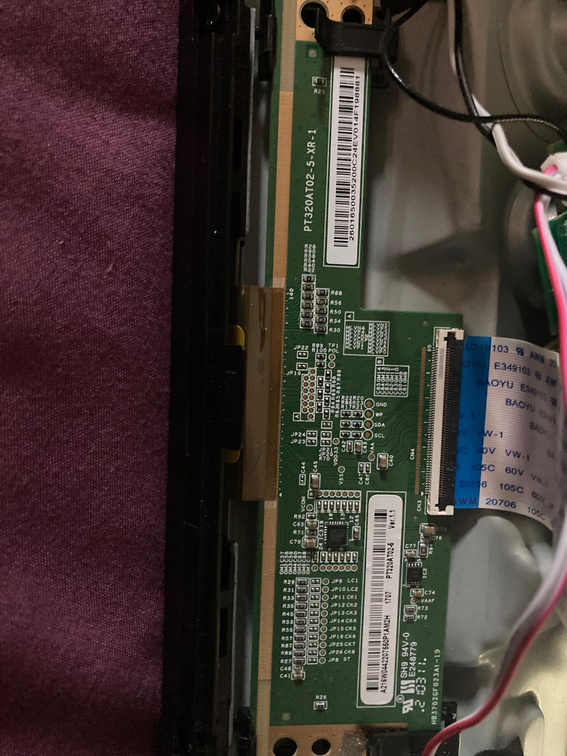

    Good day gentleman
    I hope someone can assist.

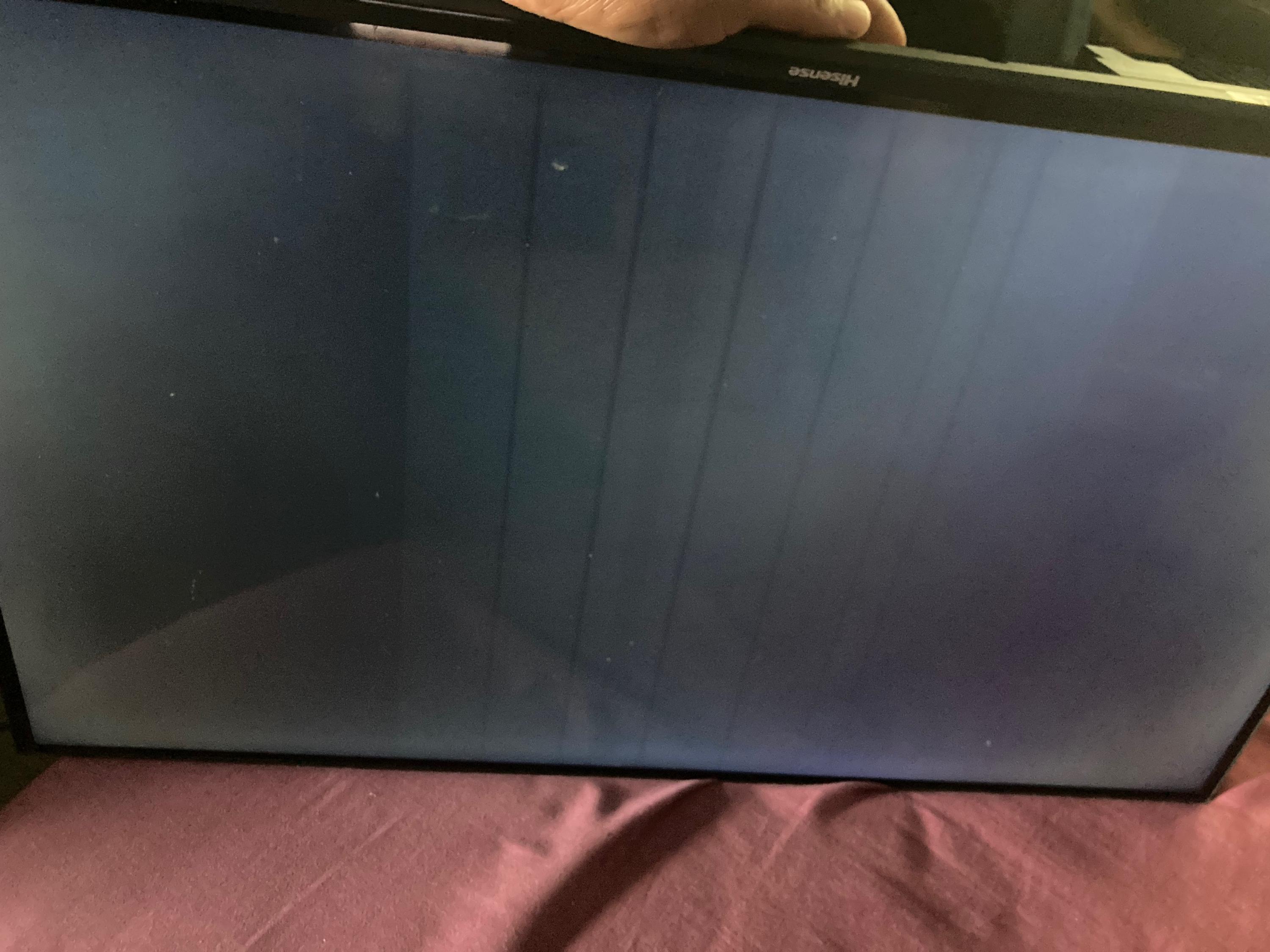

    I have a Hisense Vidaa tv that only shows dark screen, no picture. It started with vertical lines moving in from the left and would fade away after 5 minutes.
    Currently only show black screen, with sound. Backlights fully working.
    Any help would be highly appreciated.

    Most likely a bad panel , Check voltages see if you get 12 volts to the tcon or the panel Board, Next check on panel board vgl , vgh voltages see if they come on briefly when you power on the tv , if they do and then go away , its the panel thats faulty most likeyl

      Hi Sigmeyer
      I get 12v on mainboard flex without screen board attached.
      With screen board attached 12v value change to -1,8v as soon as switched on.
      Other voltages on screen board is:
      VAA 11,8v
      VSS -07,94v
      VCOM 6,25v
      VDD 3,29v
      HVAAF 5,72v
      WP 0v
      SDA 3,29v
      SCL 3,29v
      Thank you

          Couple things to check, check the little mlc caps on panel driver board for shorts or very low ohms, check the resistors, look up the datasheets for those two IC's, see what kind of voltage you're getting on those.
