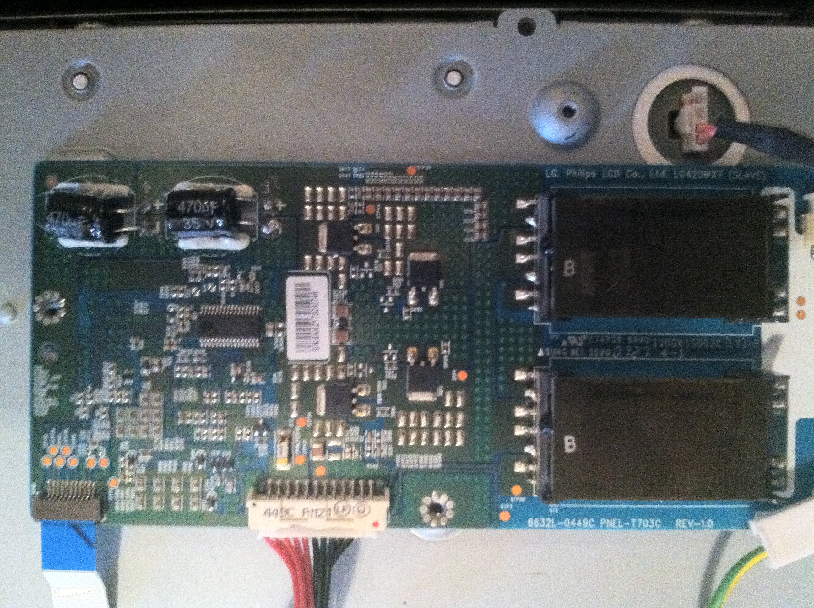

        I am having issues with my 42 in rca tv and seeking some help. I have replaced some capacitors and one fuse. I have no picture or sound. When I plug my tv in and I power it on, one green light shows up and stays on, then an additional green comes on for approx 5 seconds then turns off. Immediately after the second green light turns off a blue light comes on for approx 3 seconds. I am out of ideas and have attached pics of my boards. Any help would be appreciated
