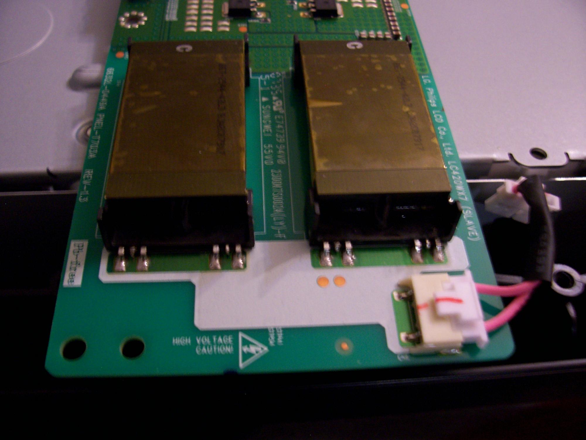

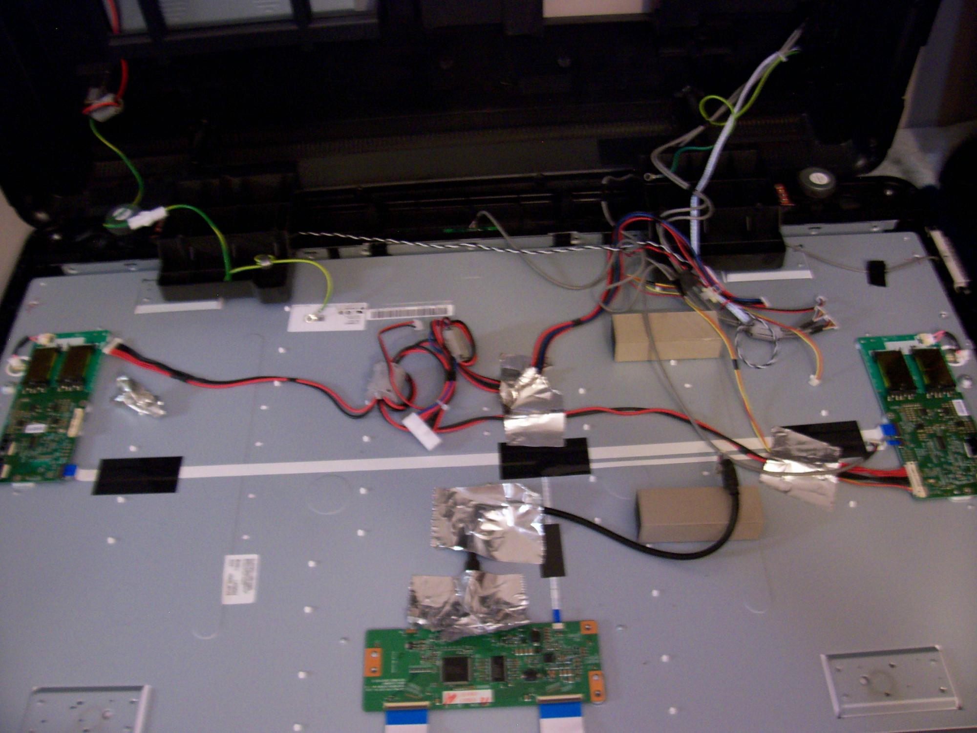

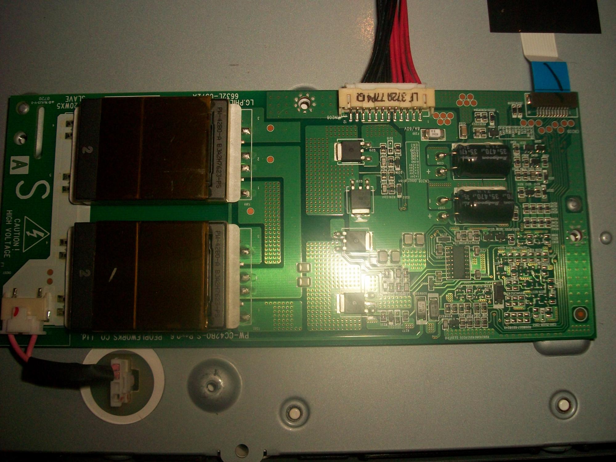

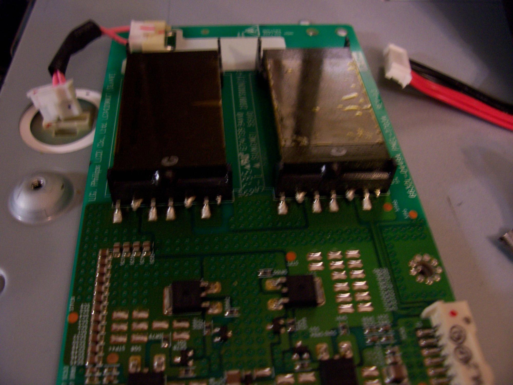

    Hi PlainBill,
    I have attached some hopefully better pictures for you.
    In regards to the pins you labeled with the (A) designation, they are not soldered to the board. In my previous testing I left those alone, and only tested the soldered connection. I labeled as it shows in the manufacturers link.
    http://www.bujeon.com/project/front/...r&menu_idx=546
    As for the right side of the transformer, it doesn't see that any of the pins are visually connected together.
    I will do the testing you asked for and post the results.

      The next step is more complex. Set your DMM to the resistance scale. Put one probe on point 14 - one lead of the output connector. What are the resistances to points 5, 6, 7, 8, 9, 10 ,11, 12. If any of these read open (greater than 1 megohm), repeat using point 13 as the reference.
      I measured using your diagram and formula. My readings across all pins were 0.1 ohms.

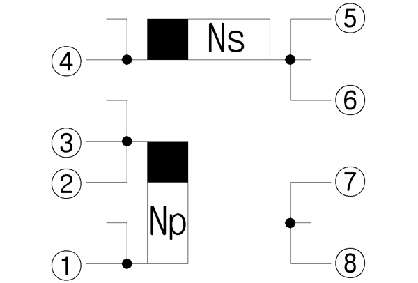

        The second picture makes that obvious. Right now my brain is spinning like a top. I guess this may make sense. Two inverters, running 180° out of phase. Less chance of a short in a transformer.
        The link to the pin numbers seems to be broken.

          Here's the diagram from the vendors site.

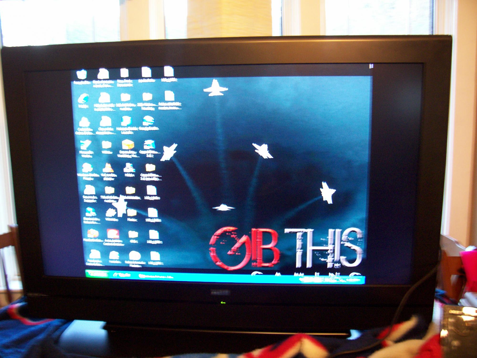

                          Hey hey!!
                          After waiting a month for customs to do their job.... the parts arrived.
                          Installed new inverters... is working!!
                          I would like to thank all of you that have helped me along the way. It is greatly appreciated!

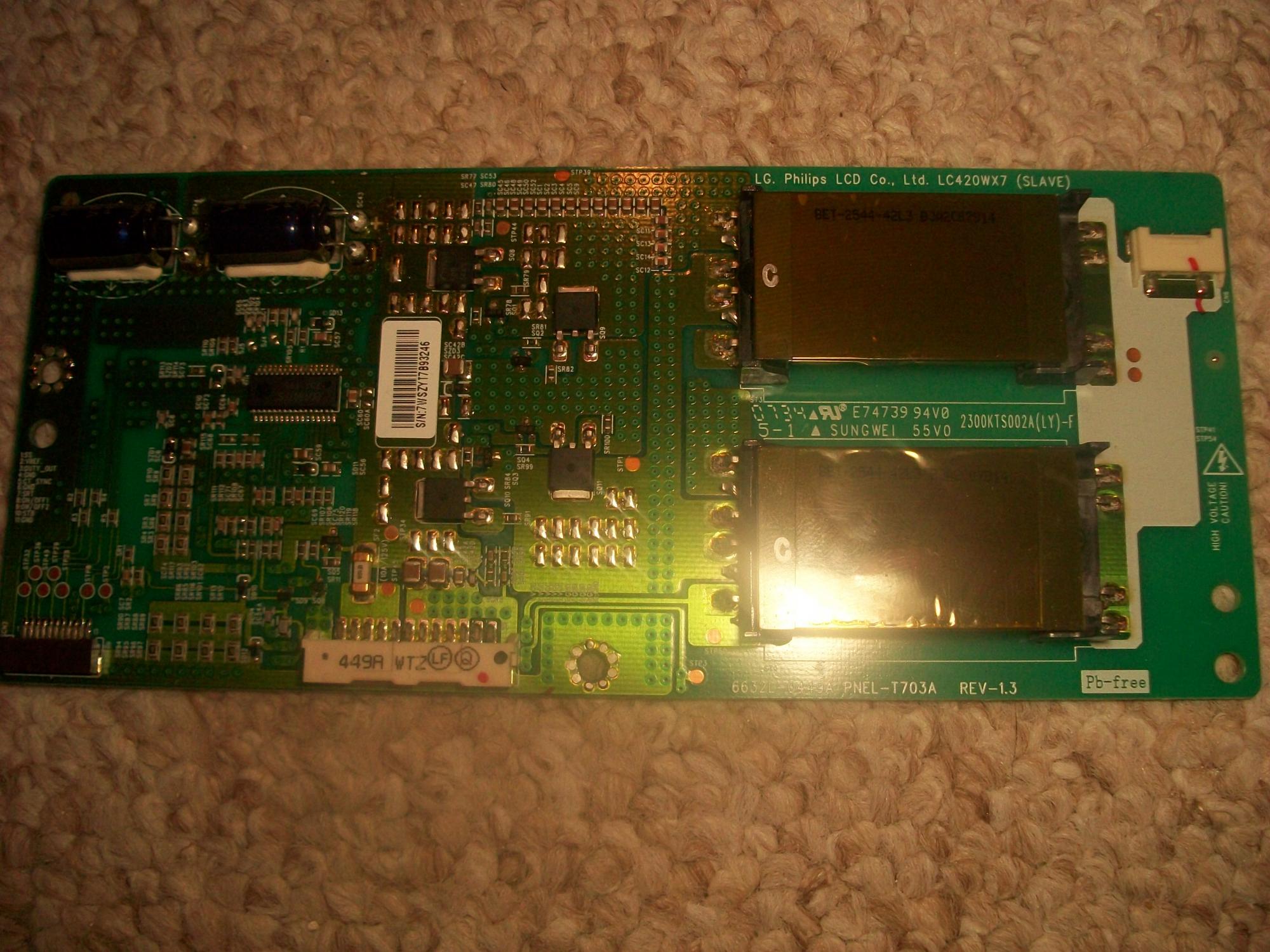

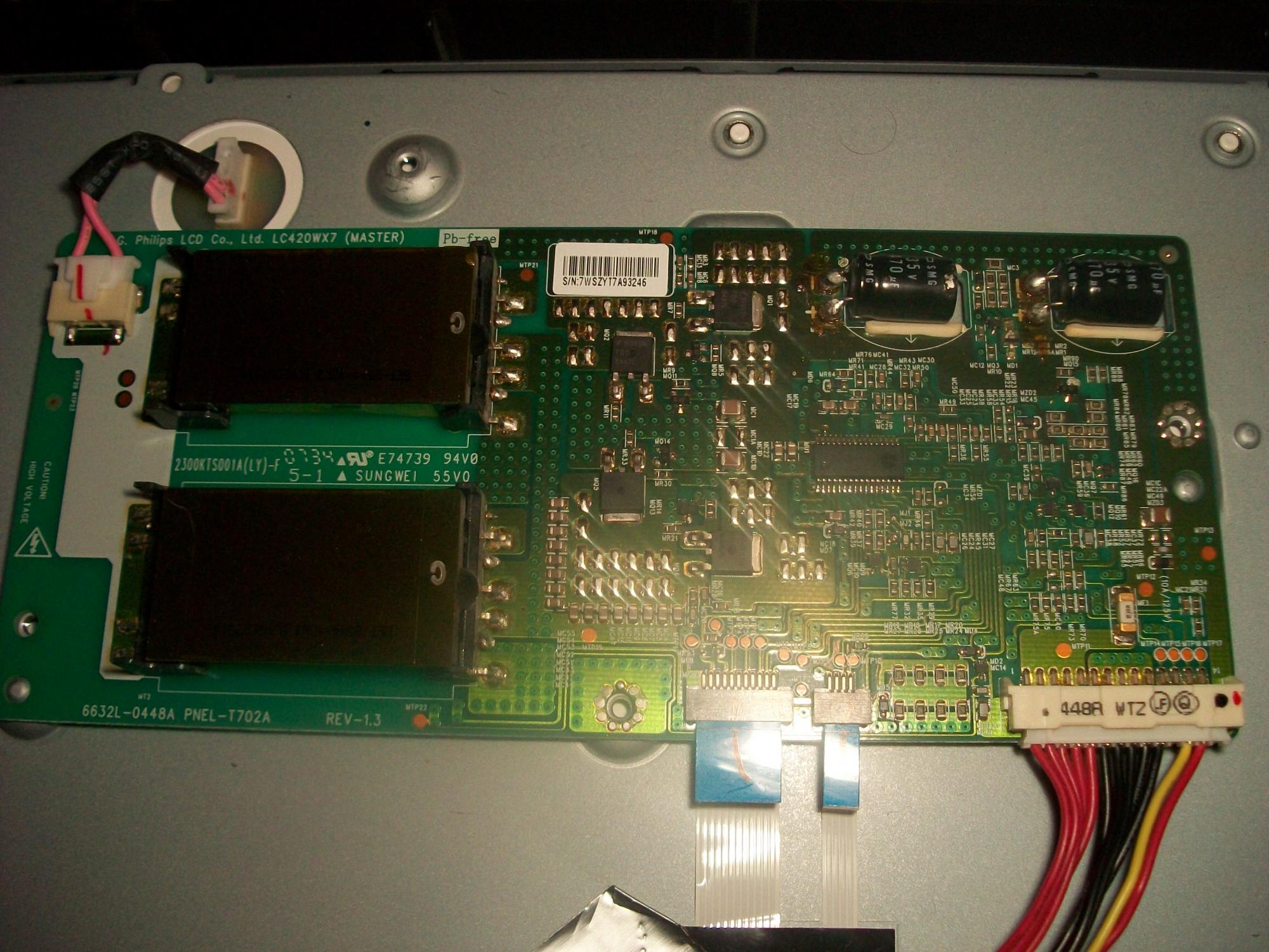

                            I ask because I've got the same TV and am experiencing the same problems (LCD has image, but backlight won't come on). I used a multimeter to test the inverter boards, and on the slave board I discovered that the transistors had differing values both from each other (on the slave board), and from the master board (all four transistors on the master board had the same value, or close to it). In addition, there's a small component that I think is a fuse on the slave board that has high resistance (1+ MOhm), but its analog on the master board has a very low resistance (0.1 Ohm). The transformers on both boards had values of ~16 Ohms between the same pins on all four transformers, and 1+ MOhms between the others.
                            I ordered a replacement slave inverter from shopjimmy that arrived today, but when I installed it I got ... bupkis. The board layout is different from the original (at least to my untrained eye), and some of the measurements are different, too.
                            I'm kind of at a loss - can you help?

                                I'm not sure. Do you have a camera? Are you capable of following the links in my signature (post #43) and providing good quality pictures (top and bottom) of the master and slave inverters?
                                  PlainBill
                                  I sure hope so.

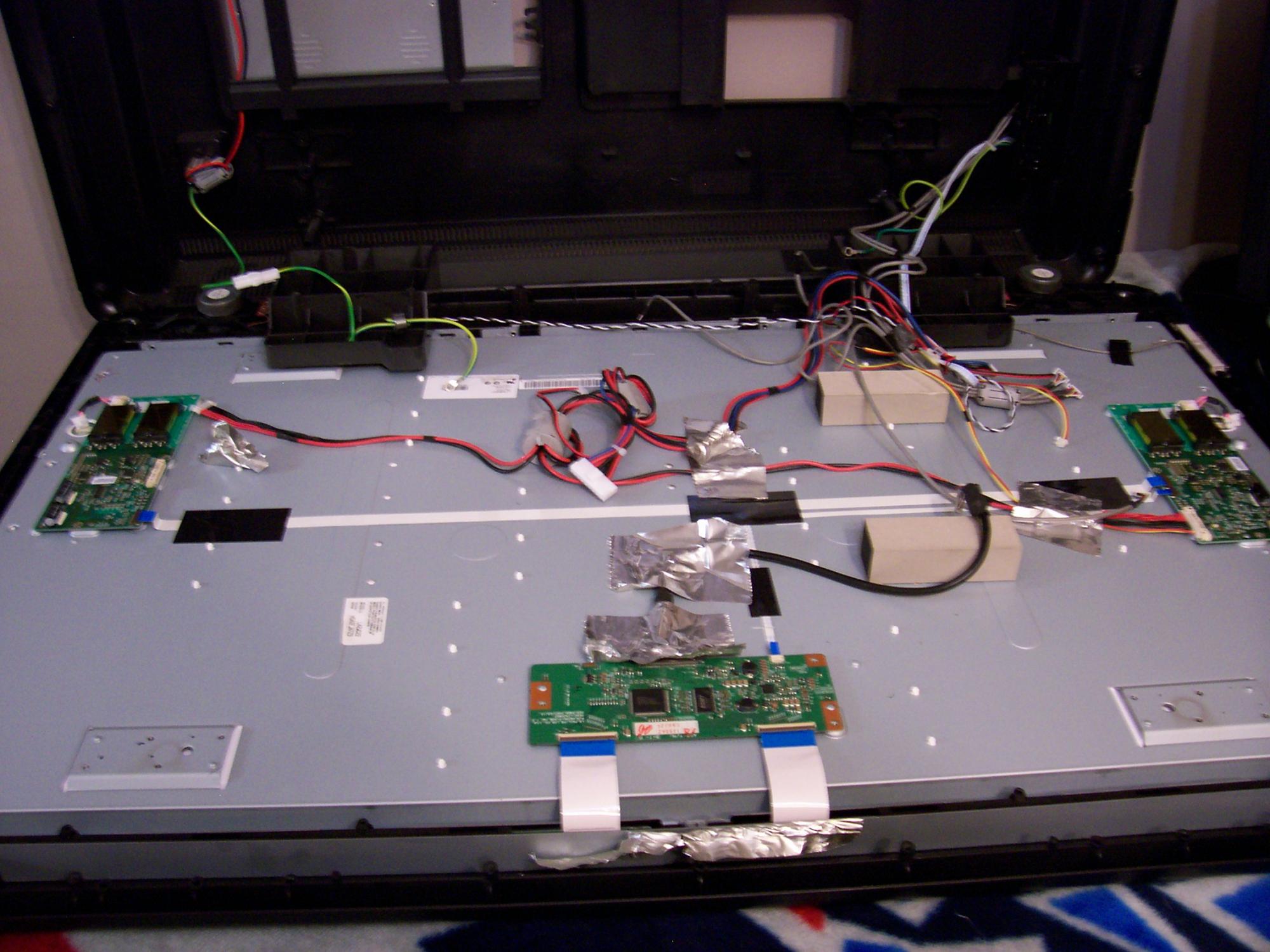

                                  Attached are photos of the tops of the boards.
                                    #57
                                    Re: RCA L42WD22 No Picture
                                    As I look at the pictures, I notice that not only are the layouts of the two slave boards different, but the fuses are different too - the original was 10A @ 125V, but the new one seems to be 8A @ 60V. Is this normal?

                                      Well, it's hard to be sure because the camera angle obscured the part numbers, but those appear to be two different boards (LC420WX7 vs ????WX5). The glare doesn't help either.

                                        Sorry about the photos - I'll try again when I get home and can put the boards under better light. I'll also get pictures of the undersides.
                                        The replacement board came from shopjimmy, and the website claims that it's the compatible replacement board. Looks like the website's picture, too.
