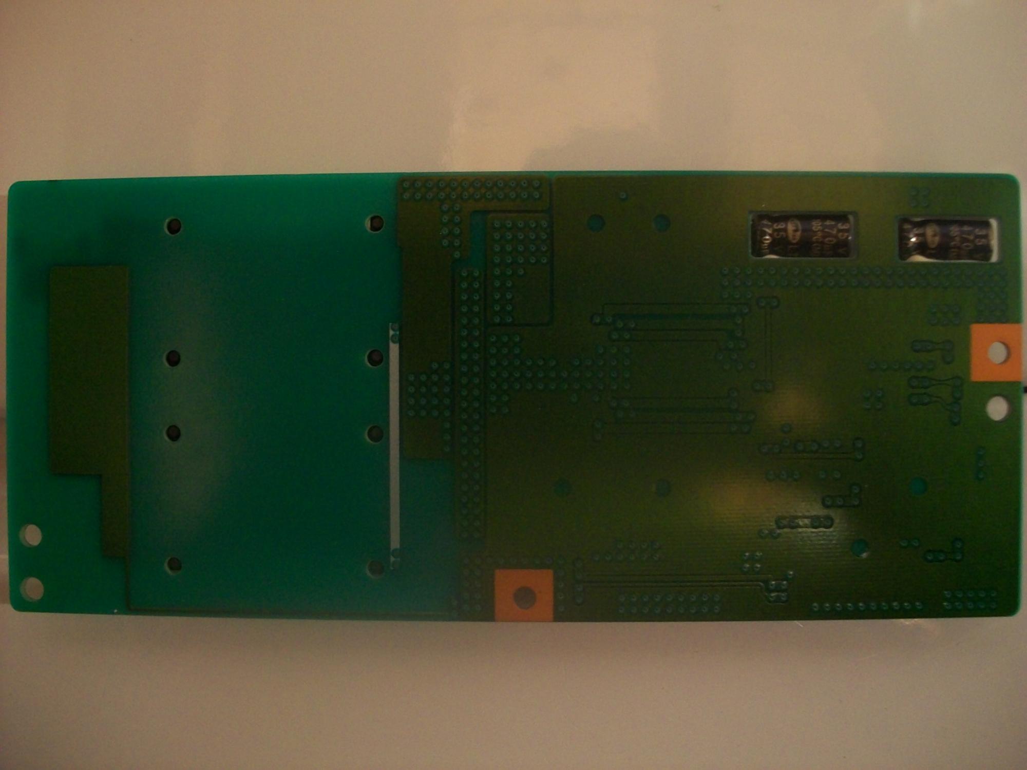

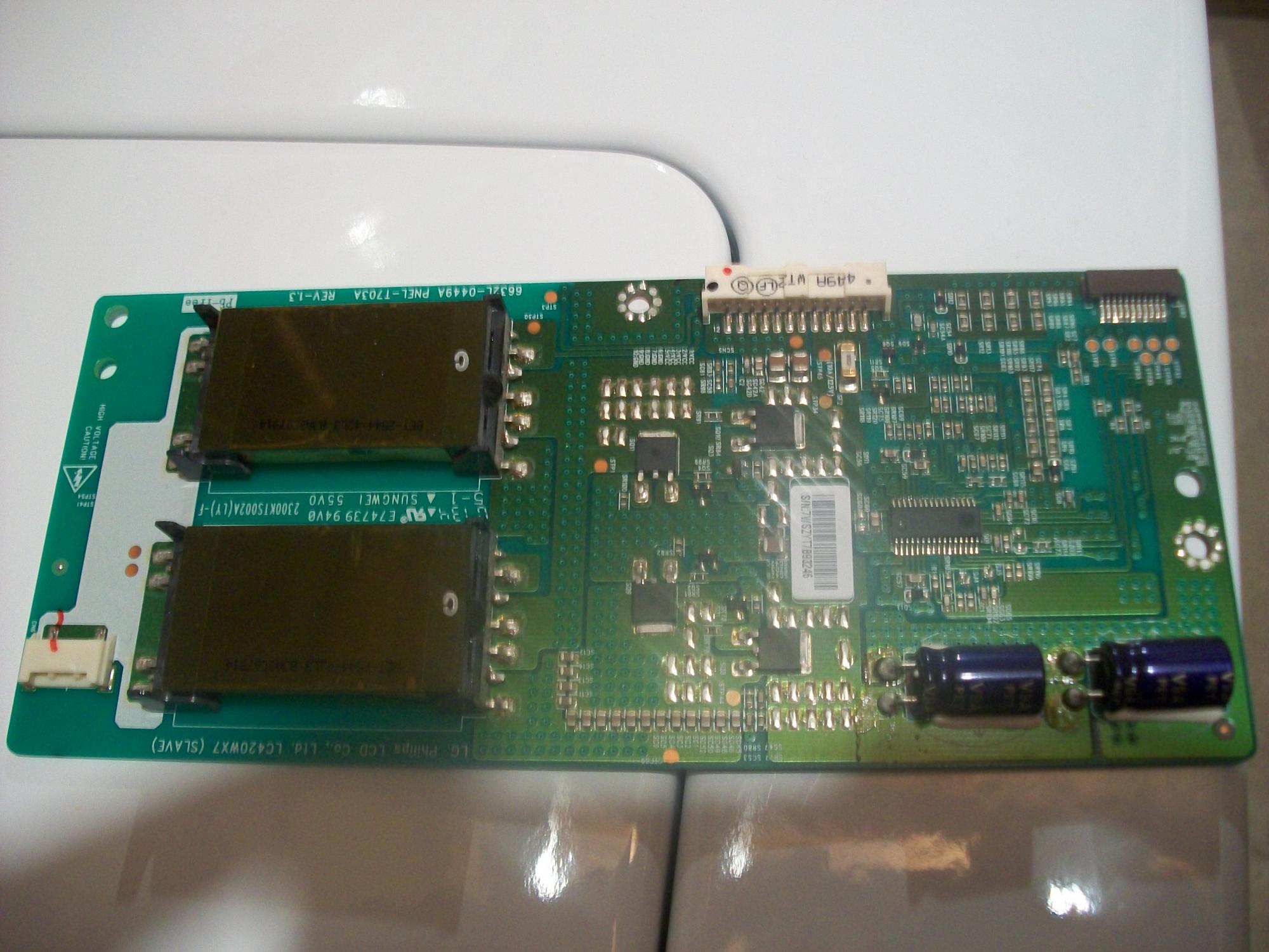

      Re: RCA L42WD22 No Picture
      Attached are some photos that I hope are more helpful. If not, let me know and I'll try again with a different camera.

        Ah. That sheds some light on things. I hope I don't have to replace the Master board, too, but that's a more desirable outcome than having to give up on the TV entirely.

          Here is some information that ties in with my earlier post.
          The board you received from Shopjimmy was a 6632L-0372A. According to Electronica USA that is for a L42WD22 (among others).
          The original board was a 6632L-0449A. Again, according to Electronica USA that is for a L42WD22YX6 (among others). Note the difference in model numbers.
          According to an eBay auction, the boards must be used in matched pairs. And another eBay auction has the repair kit for $18.
          I would NOT recommend buying a new master to go with your slave; get the correct slave, or repair the one you have.

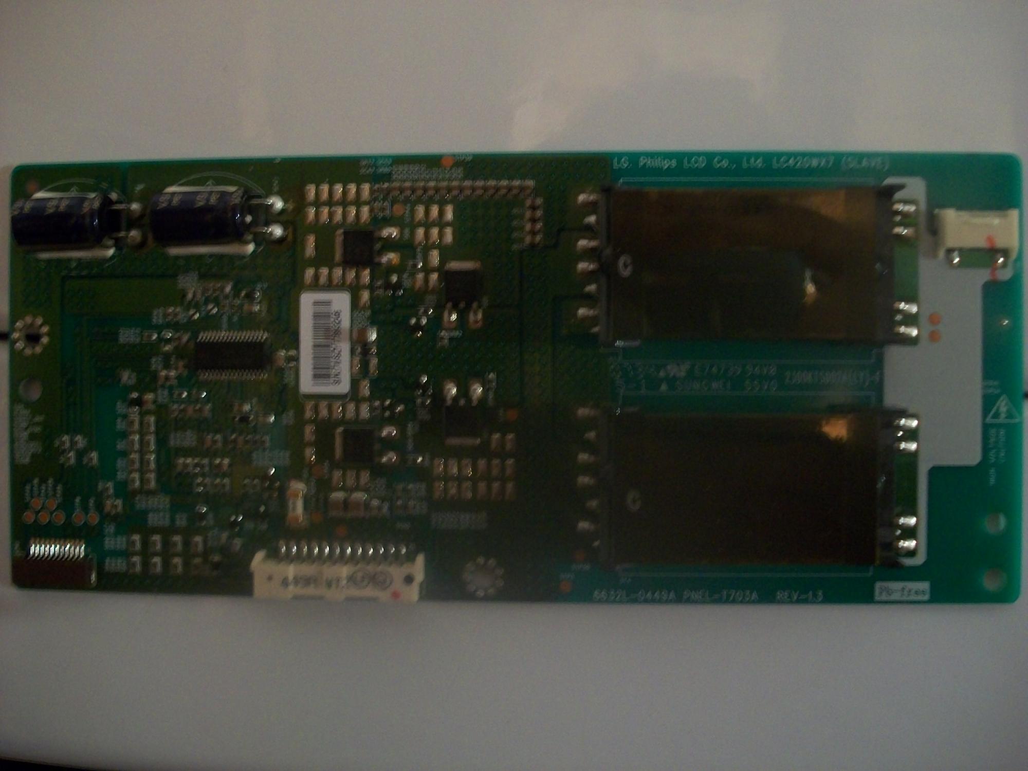

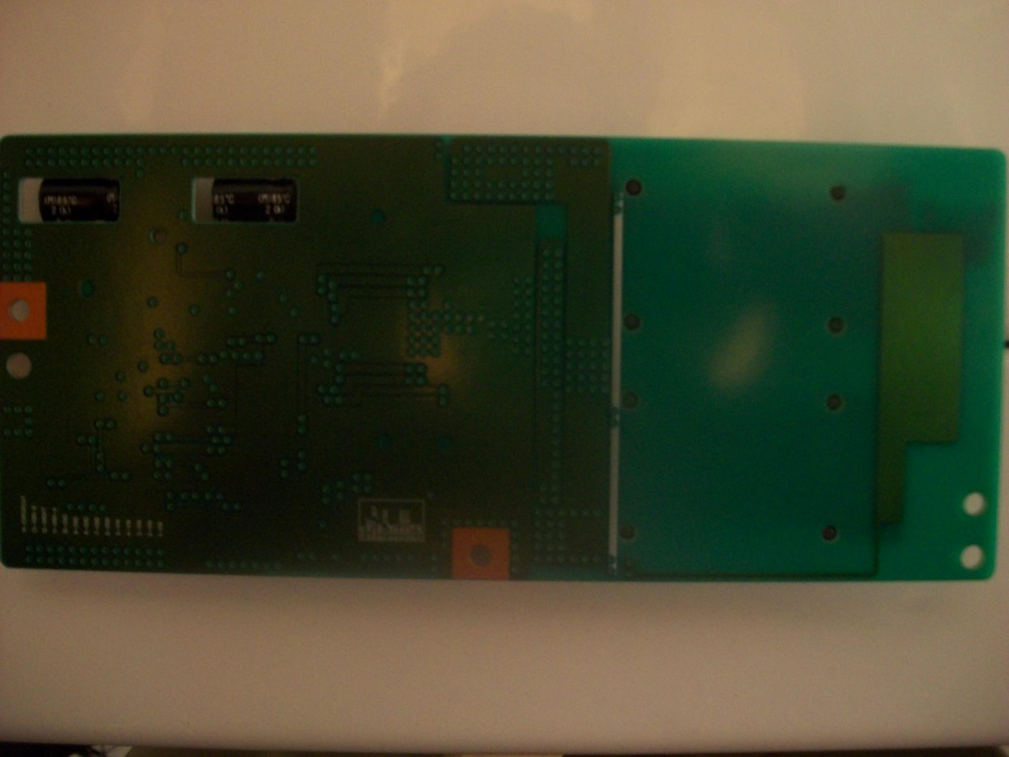

                                      Sorry for not getting back I had to leave on a business trip.
                                      I decided that I've been too busy as of late to just buy the replacement board from shopjimmy. It seemed to work however I have a feeling I may have put something together wrong or not tight enough. (yes the model # on the new board matched with the older busted one)
                                      Do these symptoms sound like my mistake in reassembling or possibly a part.
                                      After using the TV turning it off works fine, turning it back on the green power light comes on and nothing happens - attempting to turn it off with the remote just flashes the green light as if its receiving the signal but nothing else happens, light stays on.
                                      Upon unplugging and plugging it in the green light comes on (i think its supposed to temporarily) then does not go out.
                                      I unplugged it over night and plugged it in in the morning, the green light came on temporarily then went out, then turning the TV on works.
                                      The other variable I'm not sure of is the power cord. I have several computers power cords laying around and I honestly couldn't tell which was from the tv after returning from my trip, could using the wrong one be the/an issue?
                                      Thx,
                                      Mark

                                        Those look like inverters from an AU-optronics panel.
                                        My 42 had a bad mosfet on slave inverter and bad ccfls (3).
                                          #80
                                          Sometning went wrong with my last post.
                                          Those are inverters from an au-optronics panel.
                                          Mine had a bad mosfet on the slave inverter and 3 bad ccfls.
