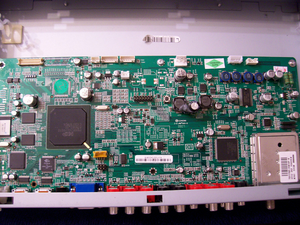

    I was given a 42" LCD L42WD22 from a friend to see if I could fix it... I have had no luck thus far. Here's the breakdown.
    Symptoms
    - No Picture at all (black screen) when TV is turned ON
    - No clicking or hissing noises when TV is turned ON
    - TV powers ON (Green LED Constant)
    - Sound works
    - No standby LED when TV is OFF (not sure if this model has a standby light)
    Tests I've Run
    - Visual check for bad capacitors was negative (no bulging or popping)
    - Visual check for cracks in circuit board was negative
    I am very new to LCD repair and only attempted this because I have successfully repaired my Samsung LCD by replacing the bad capacitors I found.
    I am going to be checking for bad solder (cold solder) joints but I'm not sure where to focus my search.
    Has anyone else had problems of this nature?

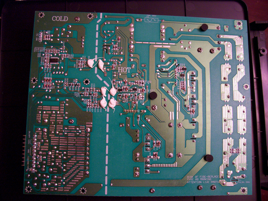

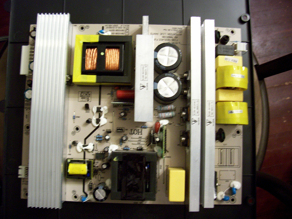

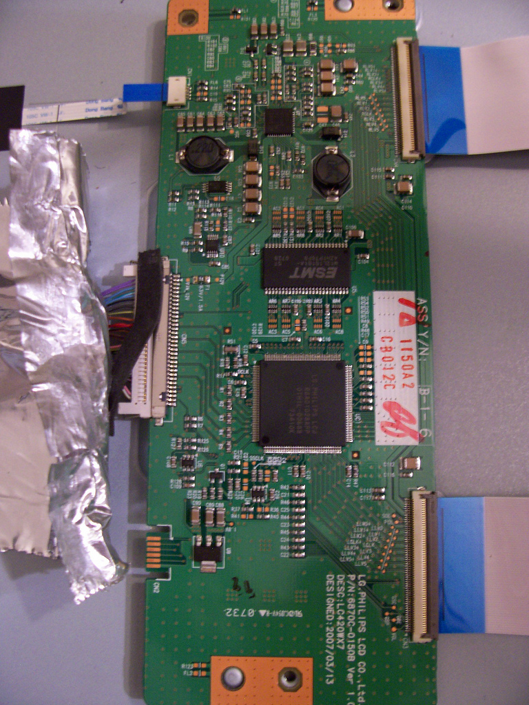

                                    Re: RCA L42WD22 No Picture
                                    I apologize in advance for the shite photo's.

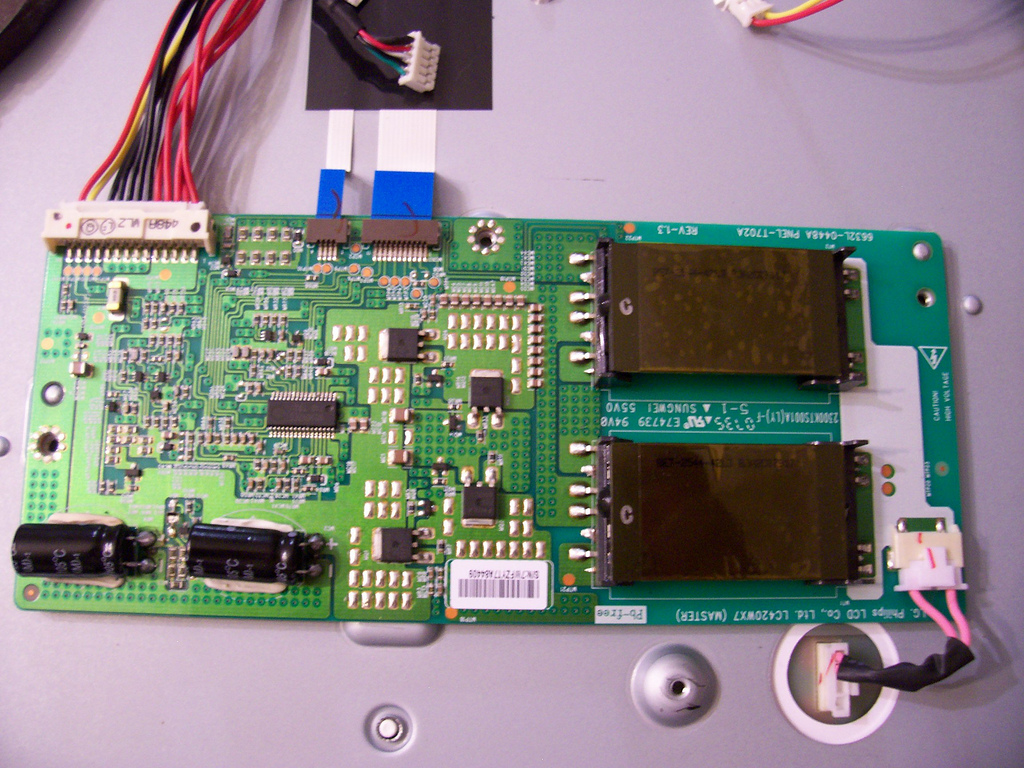

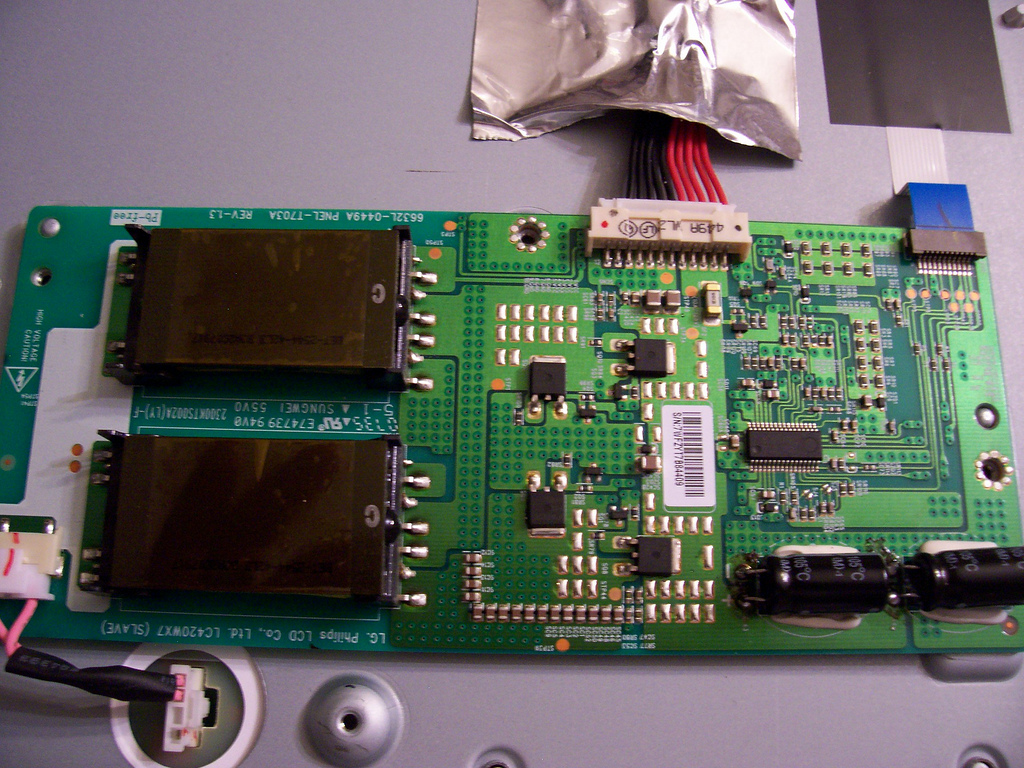

                                      Forgot to take pics of the inverters.. here they are prior to replacement.
                                        ring the transformers.if ok one has a bad bd9897 chip.
