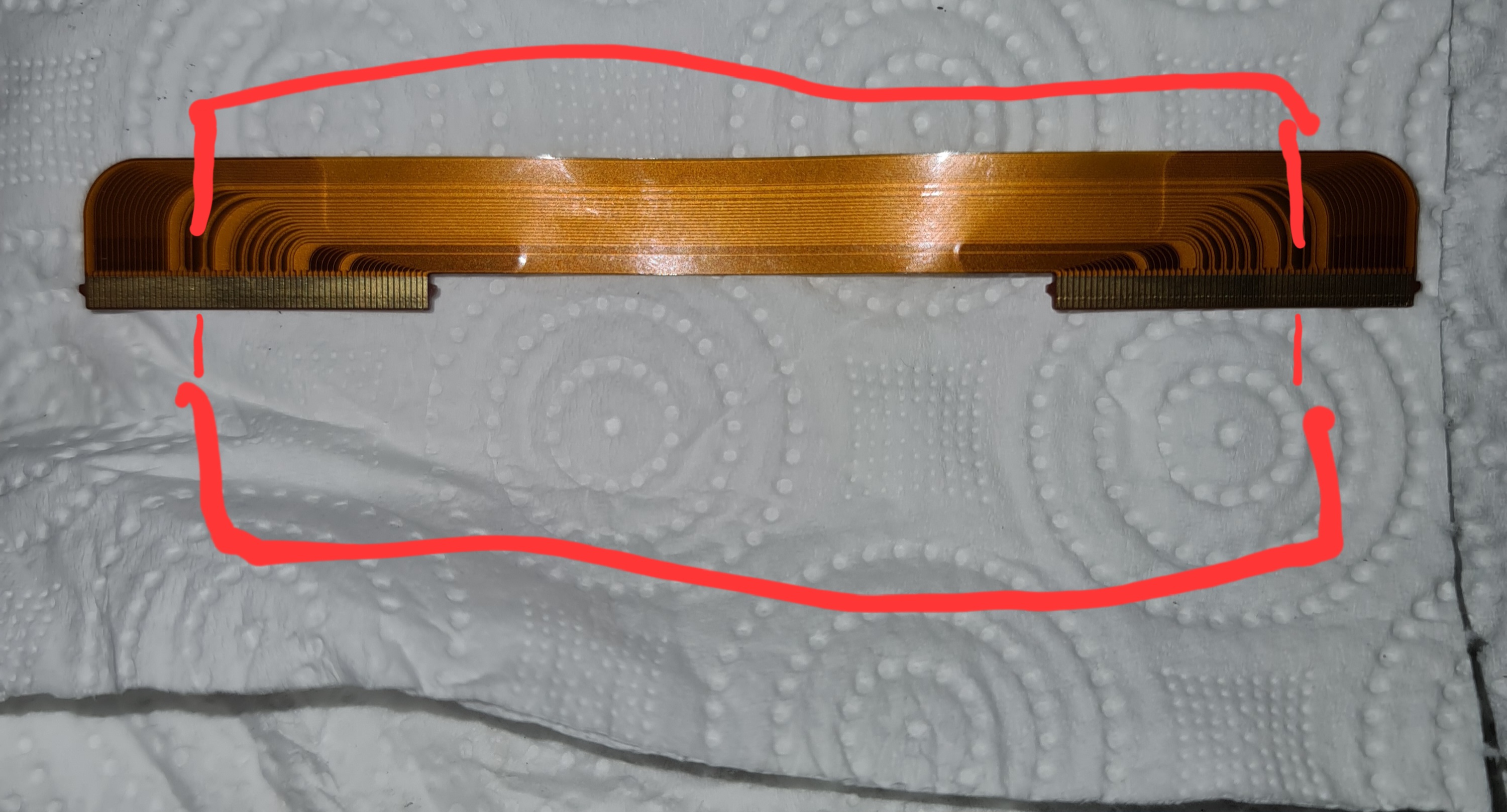

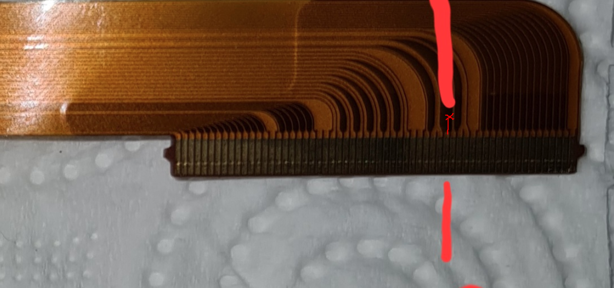

    #41
    Re: Samsung 65" UE65TU7000KXXU VER:02/UTU7000 TV Blue screen
    Update: The lvds is perfectly fine, I have tested it with the beep test (continuity) every pin.
    What I have found out is that on both of the ribbon stripes CSF01, the pin highlighted in the picture did not pass the beep test, on both of them there is no continuity. Could this be it? Please see the photo.

        #43
        Originally posted by gbbradshaw
        Is this the right way to do it? Please check the picture
        I know that if the caps beeps when I use the multimeter, in most occasions its a bad capacitor.
        I also know that if I set the multimeter to 20k to check the ohms and the value is not going from 0 to higher, that's also a bad cap.
        Correct / guide me if I am wrong please. Thanks

          #44
          But the photo shows that this pin is a dummy, there is no conductor.

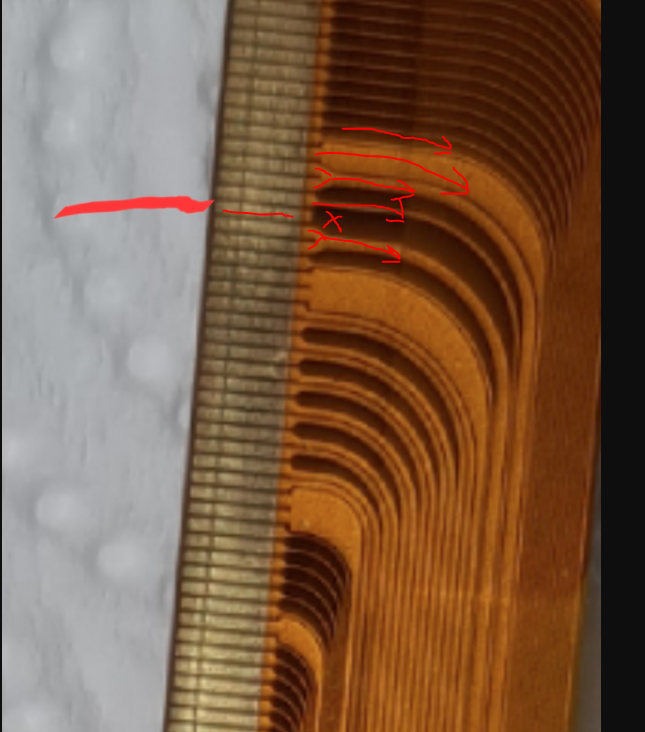

              #46
              Is it really? I am no professional so I might be wrong. Can you confirm looking at this picture please? Thanks

                  #48
                  This photo also shows that this pin is a dummy, there is no conductor. (copper conductor inside yellow)

                    #49
                    I thunk you are right. Since none of the cables (lvds, u ribbon) seems to be damaged, I have taken the risk and bought the pcb board off ebay. I will update this post as soon as I get it changed and hopefully fixed. Thanks to all for involving and helping.
