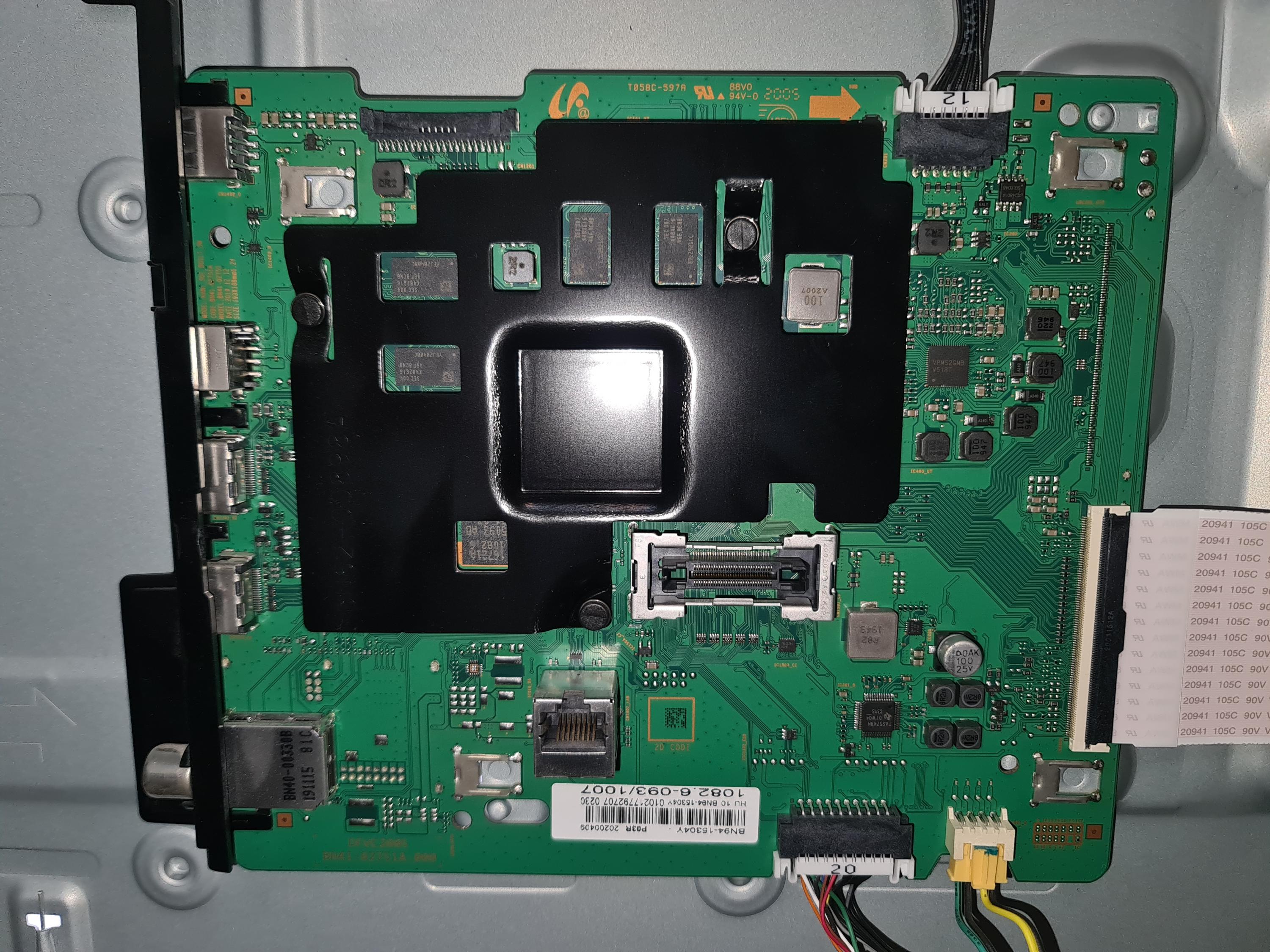

    Samsung UE65TU7000KXXU VER:02/UTU7000 tv pcb board cap
    The problem on my Samsung TV Model: UE65TU7000KXXU VER:02/UTU7000 is more likely to be a bad capacitor (smd?) On the pcb board. The local tech has recommended to buy a second hand pcb but he isn't sure if this will eventually sort the issue. I have a blue screen with sound working.
    Is there any way I can check the capacitors myself before taking the risk and buying the pcb that might not work?
    There is a picture of the board. Thanks alot!

      Can’t say 100% without and kind of troubleshooting. But these “TU” series TVs have had a lot of panel failures/ problems.

        I have tested with the multimeter for continuity (beep) and also tested by setting it on 20k ohms and some of them are charging while some are not showing any value.

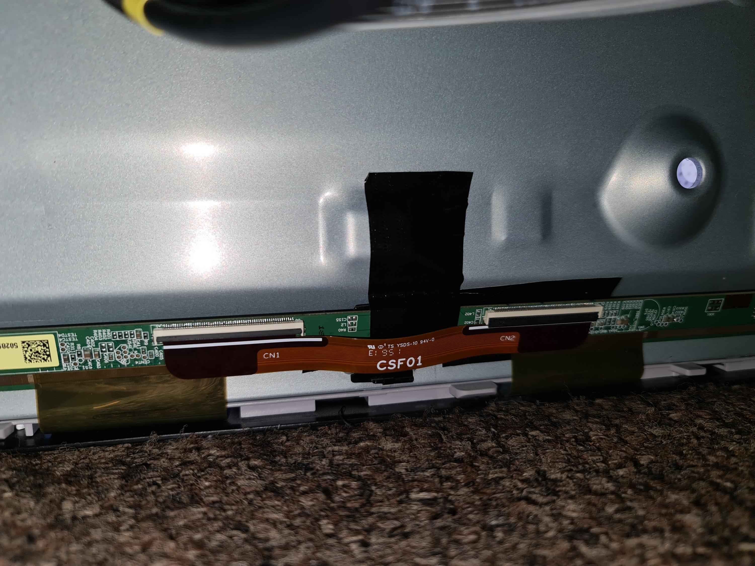

          My theory is that while he was checking the tv, the tech has "played" with the ribbon cables that connects the bottom lvds stripe and that's why the next morning he announced me that the screen is blue. I've only found out later that these can cause problems by not connecting them back properly, so there's too late to complain about it now.

            post straight on clear pictures of each board and one of the whole back, as to see how everything is connected.
              I will certainly do that once I get home, thank you!
              One thing, it appears that the pcb has a heating shield on it which has thermal paste on. The reason why I am mentioning this is because there are more capacitors under the heating shield but I am not sure if I should take that apart.

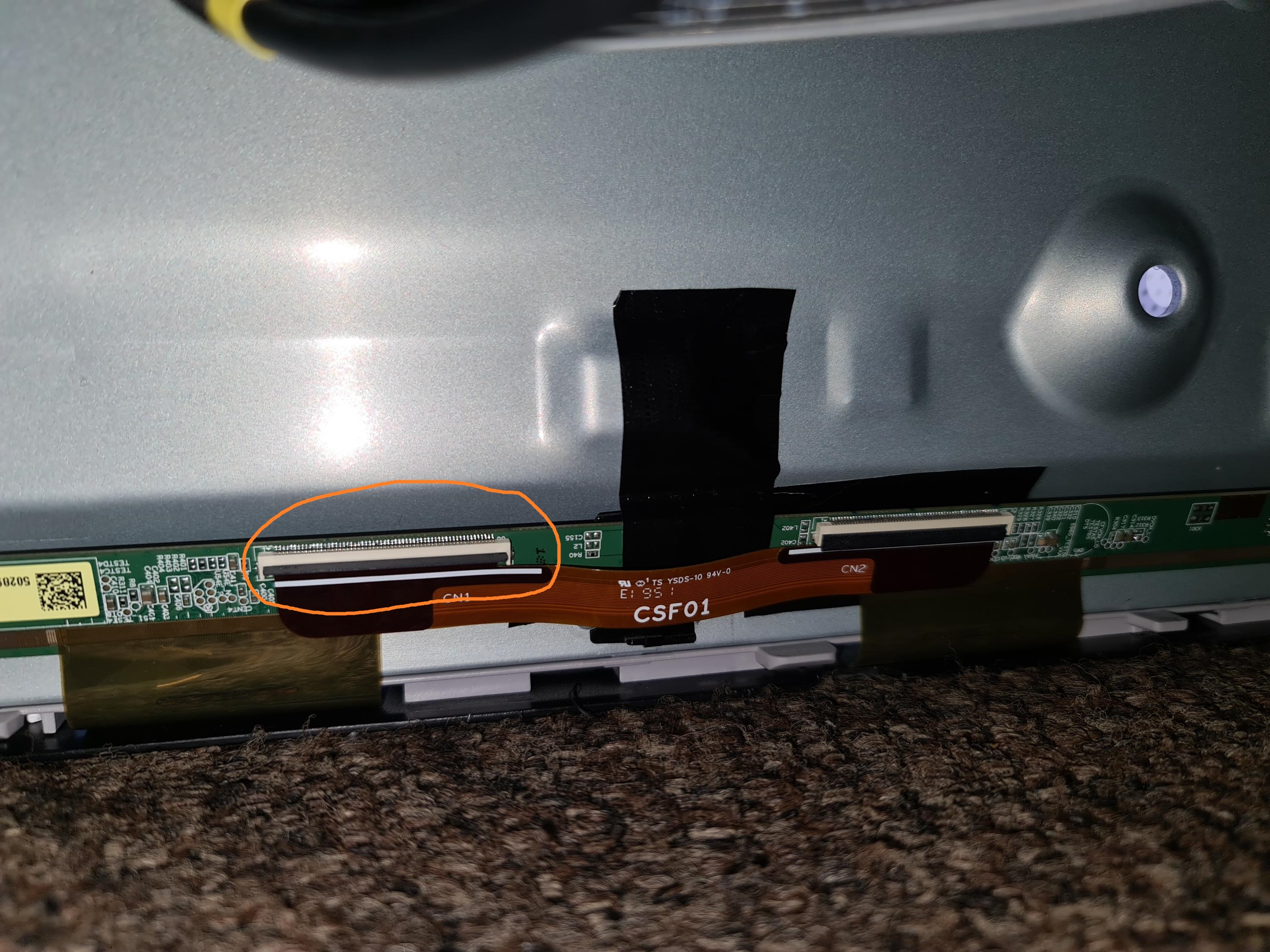

                  Re: Samsung 65" UE65TU7000KXXU VER:02/UTU7000 TV Blue screen
                  Is CN1 closed correctly?

                      yep, make sure those cables are positioned correctly, can clean them too: https://www.youtube.com/watch?v=aOCLpJub2l0

                          I have already did that last night just to tick this off the to do list. No success with that. One thing I have to mention, removing the white lvds cable , the long one, does nothing. But with it connected, when I switch through the tv channels I can see the screen light changing from dark blue to lighter. Which mean somehow thr pcb board is not sending enough signal to the display.
                              Yes , everything was cleaned with contact cleaner and put back together as normal to the lines.
