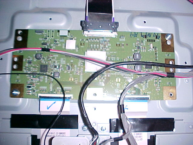

    Hi There,
    When this set developed this fault a member of the family passed it on to me,while they bought a newer set.

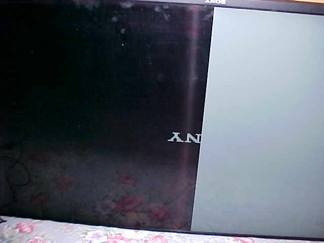

    On power up via the separate 19v SMPSU, a dark screen,backlights and sound OK.
    On removing the rear cover later, I checked the TCON board and ordered a replacement just in case.The replacement board made no difference.Prior to replacing the TCON board,I cleaned all 3 ribbon cables with iso prop alcohol.

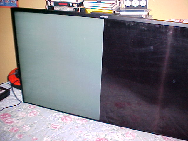

    Disconnecting one of the two LCD ribbons going to the LCD/Gate driver boards,managed to get half a working RHS screen with half the SONY logo "NY"
    I have ticked the working LCD cable and crossed the non-working LCD cable.
    One connecting only the other ribbon cable showed a faulty half screen with a white RHS half screen.I have attached 4 photos to show results.I have yet to check the LHS LCD/Gate driver board, have read about surface mount capacitors going short circuit which may cause this fault.I dont have a milliohm meter but do have an ESR meter,the Dick Smith electronics kit I bought years ago.
    Would also be interested in the "tape trick" and which side of the ribbon cable to isolate?, all input/help appreciated,Regards Steve.

    looks like the right side is ok if you are looking at it from the front, tape cut-off method/tapetrick may work, try blocking the first 15 or so pins on the left ribbon cable, see what you get, try left side of cable, no joy maybe try right side of same cable, no need to mess with right cable that side appears to be ok. Figuring out just which ones to block can be very tough, may have to play with how many and which ones get blocked, video example there, this tv wizard only had to block one line, but sometimes more is needed, depending on the short: https://www.youtube.com/watch?v=pfrRhw7-ZII

                usually just one side has the contacts, about any non-conductive tape will do, don't want it too thick tho because you need to latch the connector back down.

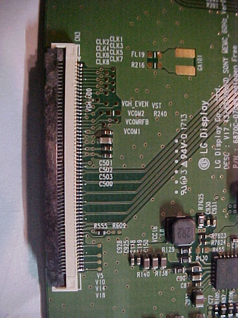

                        There appears to be 60 pins per TCON output ribbon cables
                        • Jackplug 123
                          Retired tech
                          • May 2016
                          • 65
                          • United Kingdom
                          Re: Sony KD-49XE8396 49" Bravia LCD TV
                          Just spent a while mapping the 60 pins
                          starting from the left hand side
                          pin1
                          pin2 clock 1
                          pin3 clock 2
                          pin4 clock 3
                          pin5 clock 4
                          pin6 clock 5
                          pin7 clock 6
                          pin8 clock 7
                          pin9 clock 8
                          • Jackplug 123
                            Retired tech
                            • May 2016
                            • 65
                            • United Kingdom

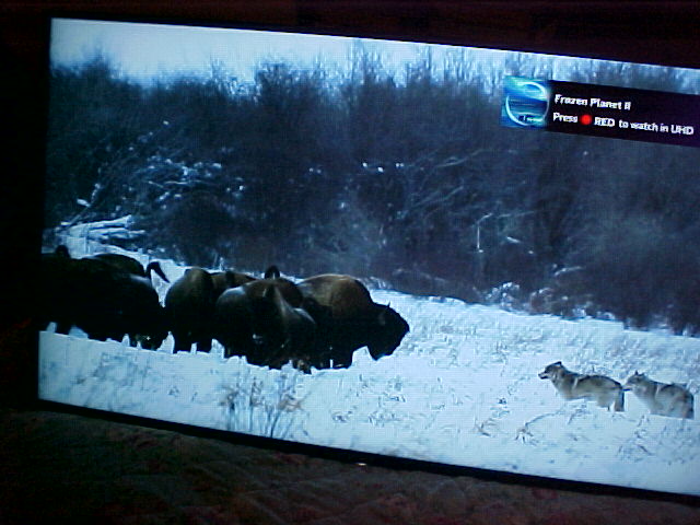

                            Finally took a chance and isolated first 9 pins of left TCON ribbon cable ie all 8 clock pins with some hi tech sellotape.
                            Result full picture.
                            Saved checking the LHS interface board to LHS of screen.
                            Now comes the tricky fiddly bit,isolating the faulty clockline.
                            Am gonna need a bigger magnifying glass!
                            Picture seems OK but yet to test HI resolution mode on TV.
                            Thanks to Nomoresonys for his help,especially the sticky tape fix link.

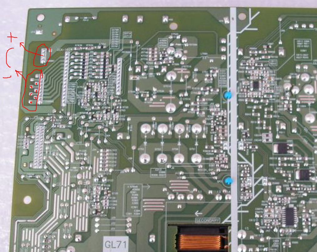

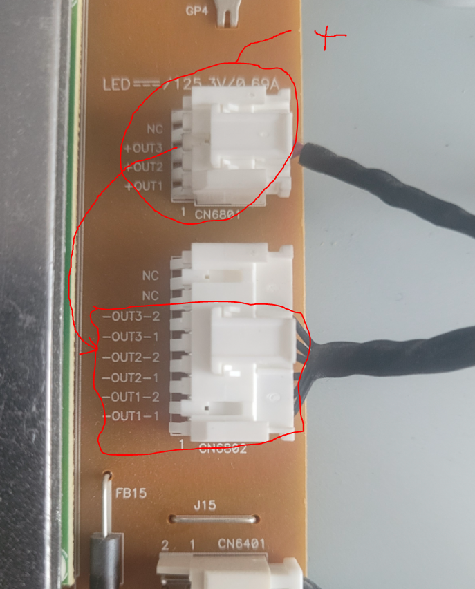

                                Got a 55xe8396 with 6 blinks fault replaced the backlights but still no backlights will light up
                                Voltages on led legend
                                Cn6801 +out3 =79v
                                Cn6801 +out2 =152v
                                ​​​​​​Cn6802 no voltages
                                But the minute I connect the tcon board up the TV goes back into 6 blinks fault
                                      Cn6801 +out3 =79v
                                      Cn6801 +out2 =152v
                                      How do you even measure the backlight voltage (between the common ground)? You need to measure between the common + and the six channels - .
