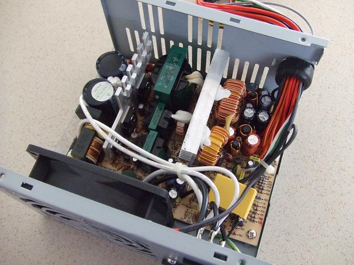

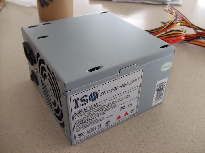

    ISO. Ever heard of them? They like to come free with foxconn cases. Some of these cases can be had for cheap, so lets see how good these are, are they fixable, or are they another leadman with no hope? Here I have the ISO-400, sounds like a 400W, but is really a 300W. Tricky tricky. Anyways, here is a overall shot:
    Plain grey box. Thats ok, I got this for free from a friend who is building a computer, the case was $30.

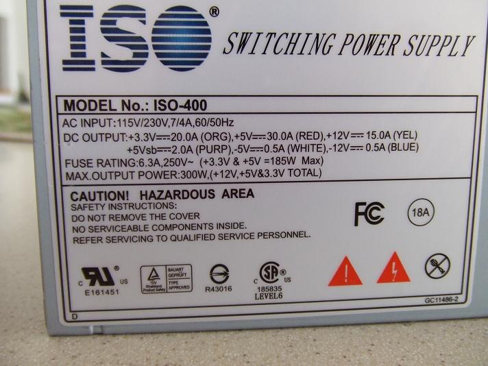

    Here's the label, UL number leads to Channel Well Technologies. No surprise, ISO is known as channel well's budget line. Budget line...that is not usually a good thing to hear, but Channel Well is because they can build some pretty good units.

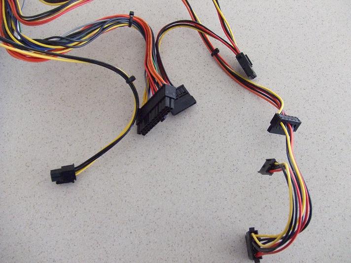

    Here are the connectors. Not too many here, a 20+4 pin connector, 4 pin cpu connector, 2 molex, 2 sata (one missing the 3.3v wire,) and a floppy connector. All wires are 20 gauge, with 22 gauge on the floppy connector.

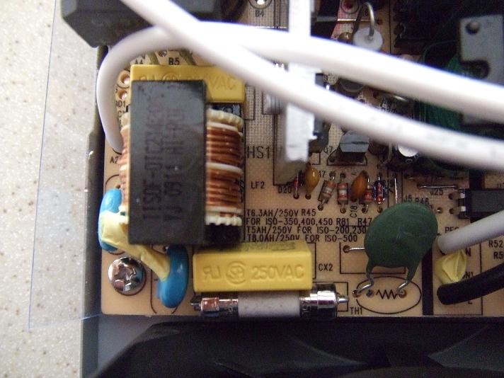

    Well, here it is. First impressions are ok. Better than the usual "450W" off brand psu. I see a full input filter there, with a .47uf cap on the ac receptacle, 2 .1uf caps elsewhere, a coil, and 2 Y caps. Real 4A, 500V bridge rectifier, real 35 sized transformer. Fan is provided by Jamicon, rated at 32.52 cfm, and 27.8 db. It is relatively quiet for running on 12v constantly.
    Better view of that, note the ceramic fuse.

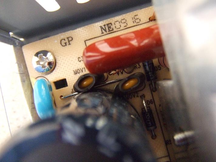

    A commodity generally missing from cheap psu's. MOV's. Nice. Brand of those caps are Jun brand. Same color, series, and cursive font as the FHY brand found in my, now junked, CWT 235W built Broadway 550W. The FHY and Jun caps have the same series as Asia-X.

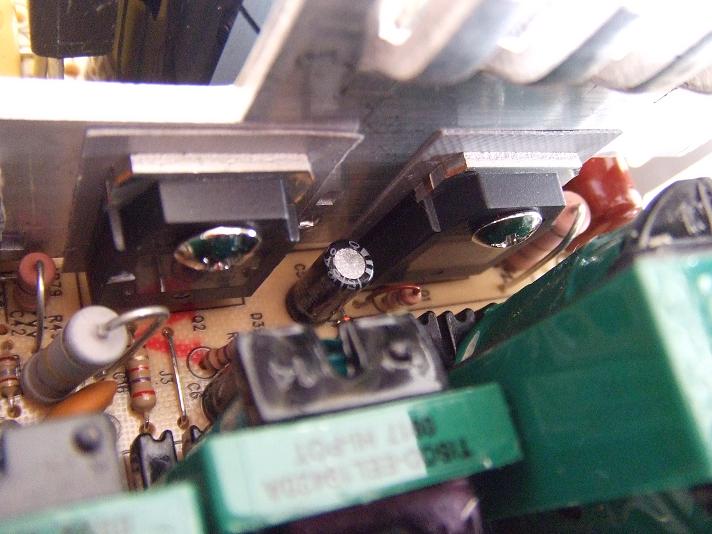

    Here are the primary switchers. Two fairchild E13009L's, not off-brand parts or no-name parts generally seen in cheaper ones.

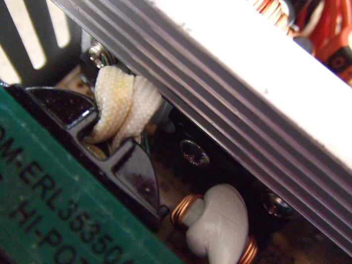

    Secondary silicon. 5v is in the middle, rectified by a 30A, 45V ST part, 3.3v on the right is a 20A, 45V ST part, and the 12v is a 16A, 200V Philips part.

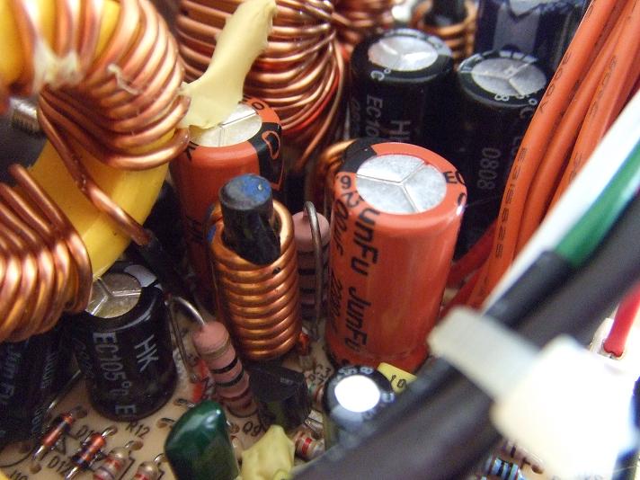

    Secondary caps in all their glory. JunFu and Fulltec. All suspiciously use the same series, HK, and have the same vent stamping, all similar to Asia-X.
    Heres how the caps break down (only measurements of diameter, height not much of an object here):
    12v : 1x fulltec 16v, 330uf 6mm, 1x fulltec 16v, 2200uf 10mm
    5v : 2x JunFu 10v, 2200uf 10mm
    3.3v : 2x JunFu 6.3v, 2200uf 10mm
    5vsb : 1x Fulltec 10v, 1000uf 10mm, 1x JunFu 10v, 470uf

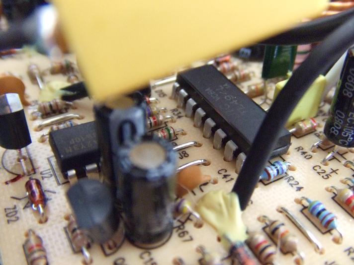

    A standard TL464 is used here, along with a TPS3510P, which provides OVP for 12v, 5v, and 3.3v, UVP for 5v and 3.3v. Still no OCP.
    Overall, it seems pretty honestly rated. If you had no other choice and needed a psu to temporarily power a low-power computer, I would say go for it.

    Looks like it'd be pretty decent for a low power computer after a recap. Much nicer than my "480W" Powmax!

      I have that in one of my computers, it came with the Foxconn case, seems pretty good except the fan is too loud and too few connectors. Did you test its efficiency?

          I don't do any testing of any sort, other than seeing if it powers on really. Maybe one day, but for now a visual rundown will have to do. I would imagine that it is the usual 70-75% efficiency that you can expect from most cheap half-bridge designs. But, Channel Well's own units, not the one's they OEM, typically will run their ratings, and I am 99% sure this one would. Only problem is, it will keep running past it's ratings until it blows up with no OCP.
          no PFC circuit!
          Unfortunately in the US PFC is not required. I wish it was, it would really help ween out some of the cheaper companies. This model is available in PPFC according to the silkscreening and the that huge notch cut out of the primary heatsink to make room for the PPFC inductor.

            Looks pretty decent, actually. The primary switches seem big enough to do 300 watts. No OCP, so I guess that answers your question wheather or not it will blow up if you exceed its ratings.

                    Sorry to dig up an old thread, but I load tested a 350W one of these. It made it up to 350W, but it exploded when I pushed it higher.

                              Well, sparks came out. So it's safe to say that the switchers died.
                              A working TV? How boring!
                              • c_hegge
                                • Sep 2009
                                • 5219
                                Re: Iso-400 300w
                                Was definately the primary switchers. Both of them had burn makes under them after the explosions.
