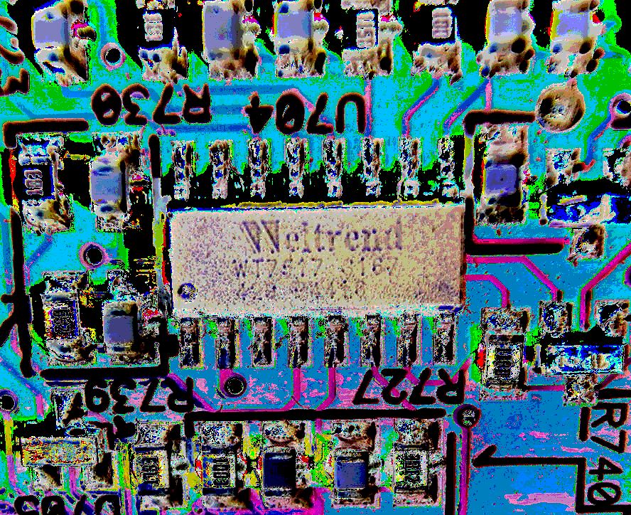

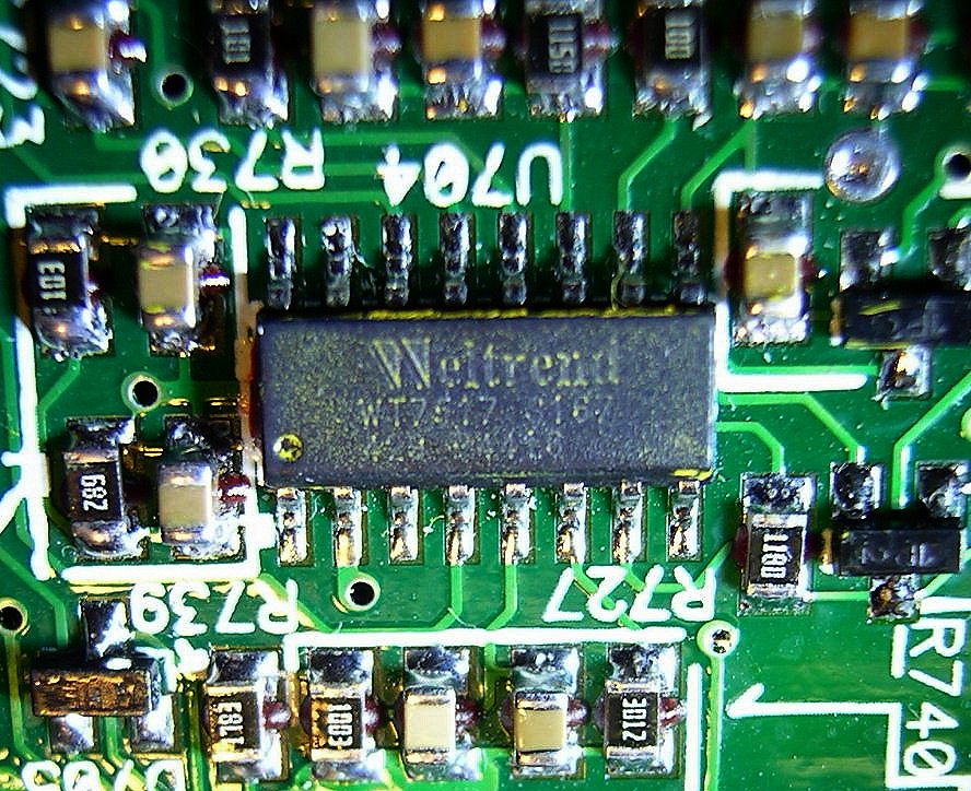

                • vsp900
                  • Nov 2010
                  • 11
                  #68
                  Re: LiteOn PA-6601-1A (600w) blows its TOP
                  Does anyone know what U704 is? I'd like to be able to find a data sheet on that component. I can see where a part number was on the chip, but the surface looks bubbled and there's no way I can read it.
                  If someone could give me a part number, I would greatly appreciate it.
                  • Toasty
                    • Jul 2007
                    • 4171
                    #69
                    OV / OC Supervisor chip for 3.3v, 5v, 12v.
                    FYI - *NLA*
                    Weltrend, WT7517 S167
                    Toast

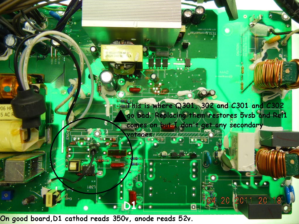

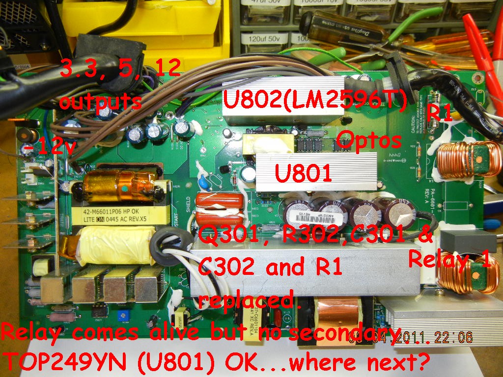

                        OK... new F1, Q301,Q302, C301, C302, good C303 restores +5vsb but no +12vaud, 3.3 or -12 on P1. Anyone have any ideas where to look next?

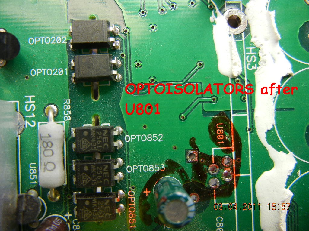

                            Have had mixed results when U801 blows. I was able to get two supplies going by replacing U801 (TOP249YN), C852 (47uf/25v), Q856 (MMBT2907A) and OPTO851. All are available... Mouser's one place. Still looking for ideas on the other problem when F1 goes. I have had three come back to life but have reached a wall lately on the rest.
                            Good luck and let me know if that gets you going again!

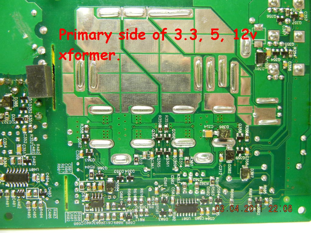

                              #74

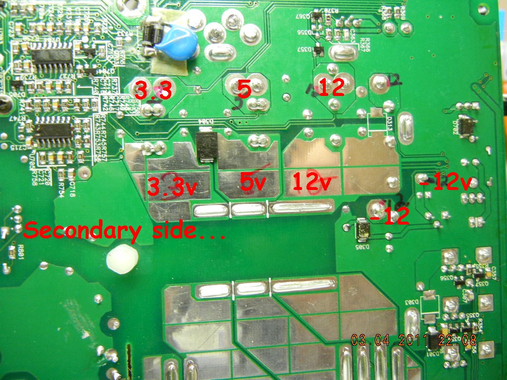

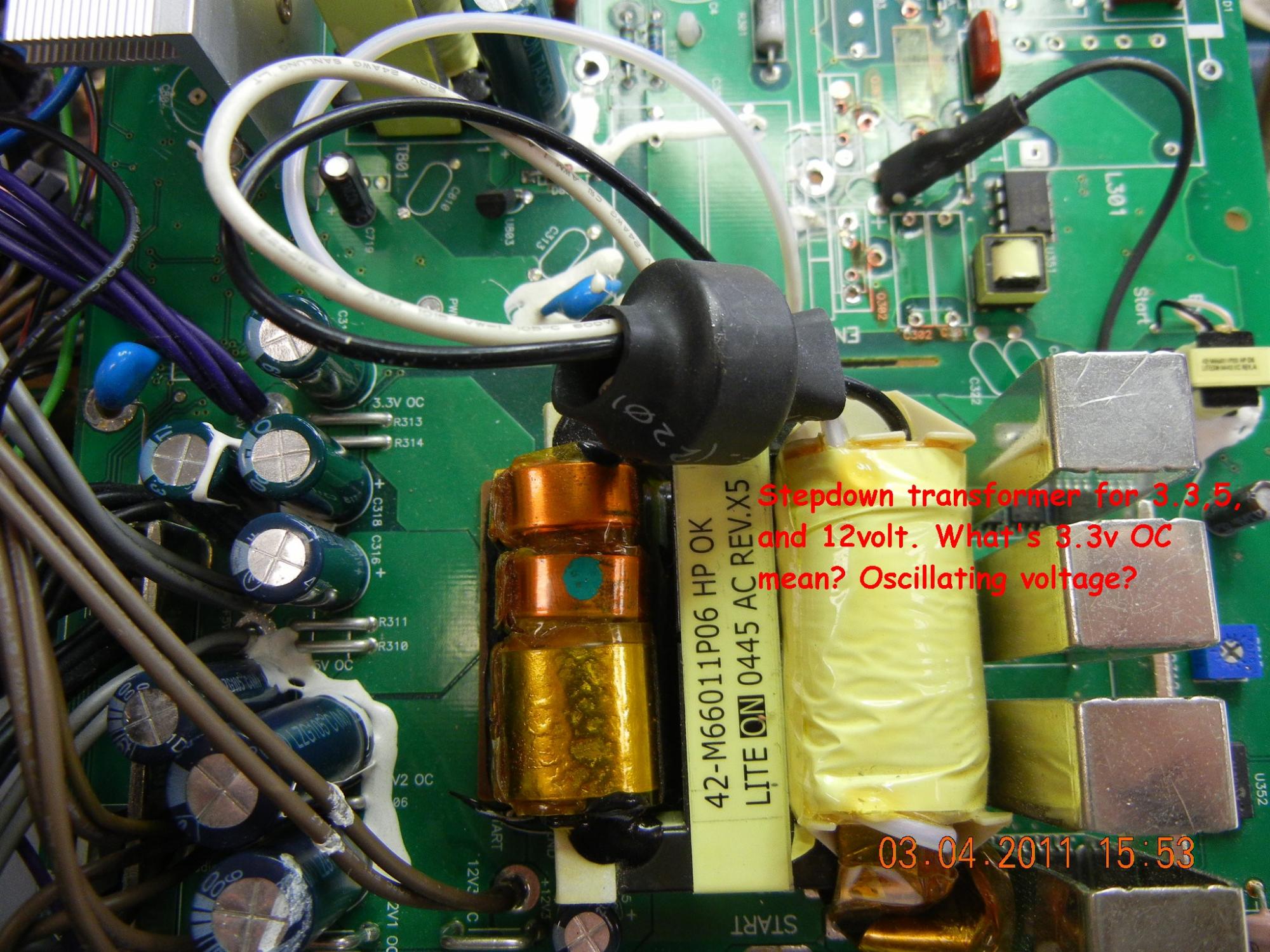

                              Back banging on some of these supplies. Have included pictures this time. Would like some ideas on where to look next after the already mentioned components have been replaced. Anyone have any ideas? Thanks

                                3.3OC are the sense bars for over-current. Same for 5, 12v1, 12v2, 12v3.
                                How did you determine the OPTO was bad?

                                  Have a huntron which will sig them... but really had replaced everything else on one supply with no luck so I tried the 851 (It had worked on a blown U801 once) and got everything back. Basically shotgunning at this point cause board has me confused.
                                    Attached are two more pixs of the primary side. On a good supply, I see 350v on the cathode side and 52v on the anode. On a bad board with F1, Q301, C301 and C302 and R302 all replaced (obvious damage to all), I still don't get any voltage at D1. Source seems to trace to L4981AD shown on solder side picture. Is there a safe way to read it????
                                    PS... Toasty, that last post about the opto (#76)... it fixed a board where U801 had blown. So far they are the easiest to fix.

                                      As I only have 1 to play with, I shelved this for the time being. I bought it just to see what I could determine, but also reached a wall where it sounded like it was going to fire, but doesn't.
                                      Other, easier fixes are making money, so this will sit for awhile.

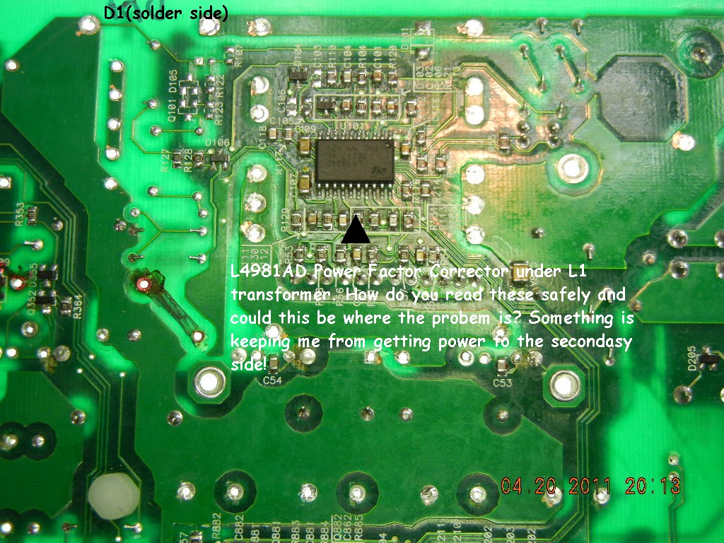

                                        Toasty -- I can appreciate that. The blown TOP is an easy fix but the other is (F1, etc) tough. I think the problem is in the mains and may be the power corrector. I'm tracking a working one, printing out data sheets and hope to find something soon. I finally have a "spare" working supply I can make a mistake with and not worry about. As always, thanks for the input!
