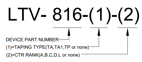

    I'm troubleshooting a power supply board and one opto coupler seems shorted. It's a through-hole, marked with 3 lines:
    1223
    816A4
    W
    I'm not sure what replacement to buy for it. It resembles LTV-816 (https://www.tme.eu/sk/en/details/ltv...output/liteon/), but I'm not sure it's 100% that. The data sheet shows multiple sub-types like 816M, 816S, but 816A is not there.
    I do have other functional pieces on the same board, so I could do some measurements on those, but I'm not sure what to check.
    Any idea appreciated.

    When you desolder optocoupler from board, so it is off circuit, check in diode mode between leg#1 and 2, an later betveen leg#3 and 4 on optocoupler in both direction.
    Whats is readings?

      0 resistance between 1 and 2, that's why I wrote it's shorted. My question was more to what could I replace it with.

        I dont know for sure. Some standards are 817, so may or may not be critical for choosing 816 instead by design.
        Here is compare, a few point is different.
        https://www.utmel.com/compare/HCPL-8...V-816--4824806

          I think you are misinterpreting the datasheet.
          LTV-816 comes in a DIP (page 2)
          LTV-816M is a wide lead spacing package
          LTV-816S is a surface mounting package
          "A2" is the rank (page 3),
          Rank mark "A" denotes a CTR (current transfer ratio) of 80 - 160. (page 10)
          https://www.tme.eu/Document/5aee6f35...fd/LTV-816.pdf

            You're probably right in that, but there is no way to order specific rank as far as I can tell, so that seems puzzling. Anyhow, I ordered that LTV-816 from TME and what arrived is labeled 816B. I put it on the PCB and the issue is gone now. So I consider this a success, knowing well it's too soon to claim any victory here.

              The ordering information is towards the end of the datasheet.
