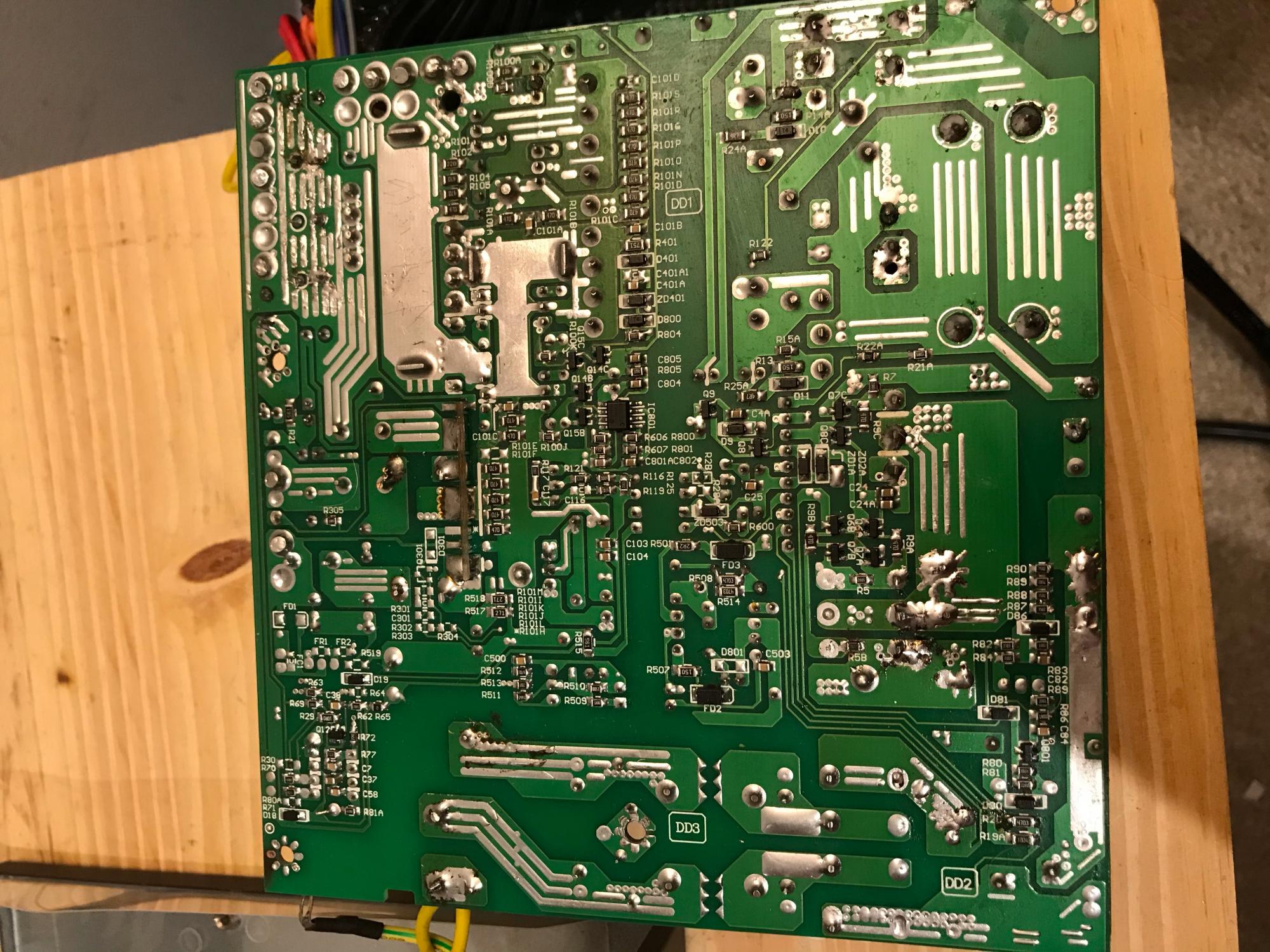

            And we really need more pictures of the PSU. I know the thing is packed and hard to see anything in it, but I'm really troubleshooting in the dark here.

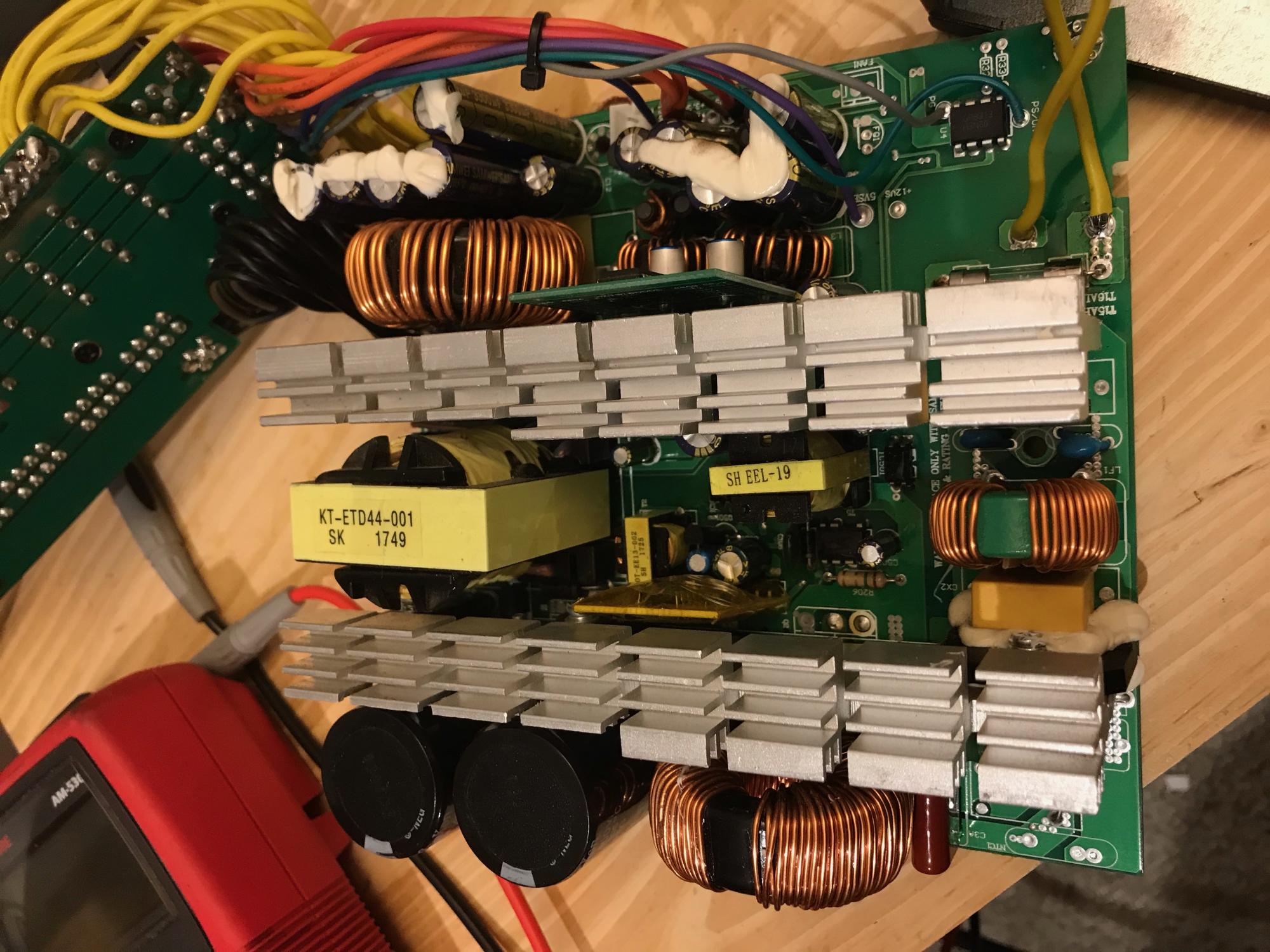

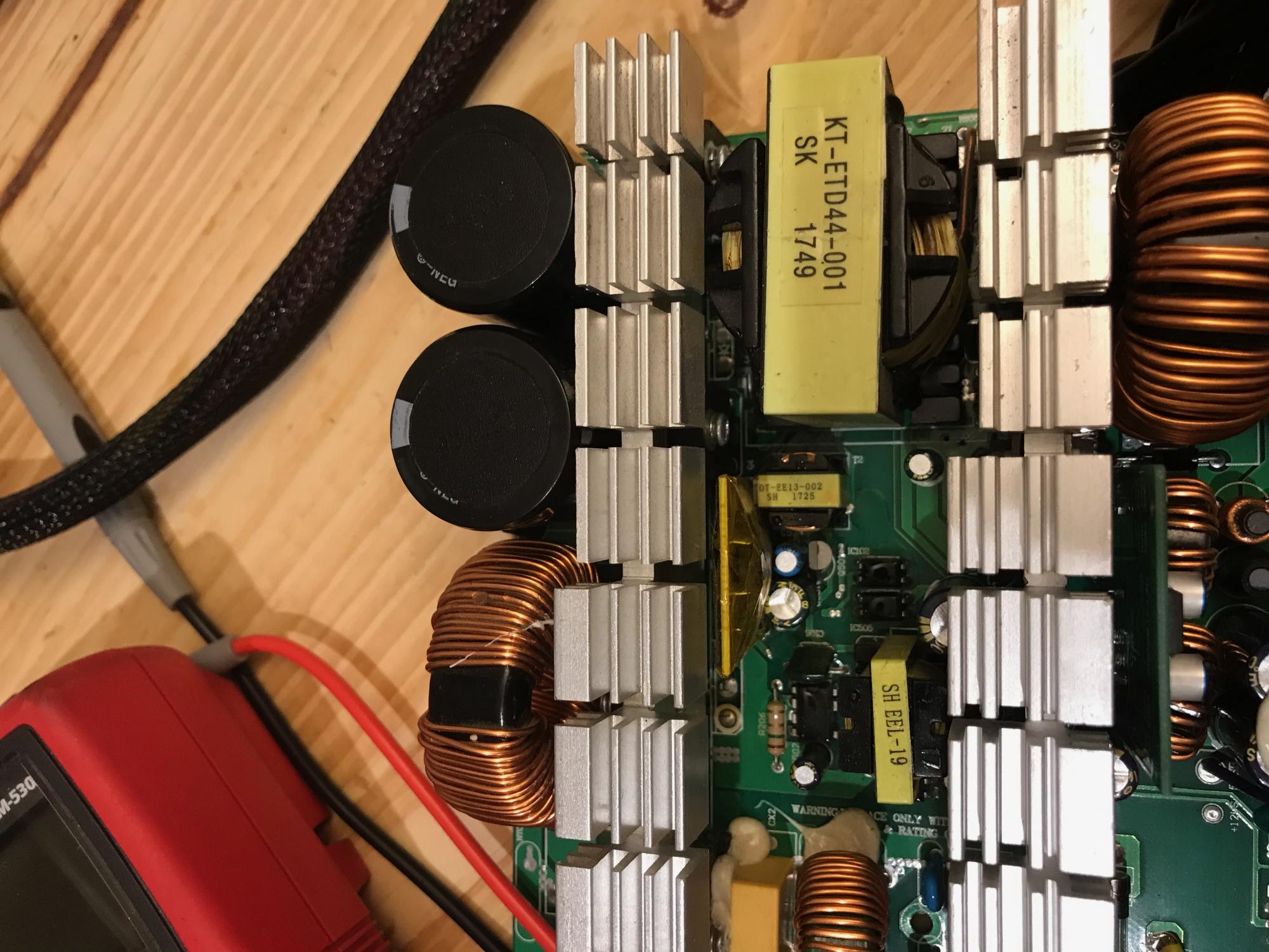

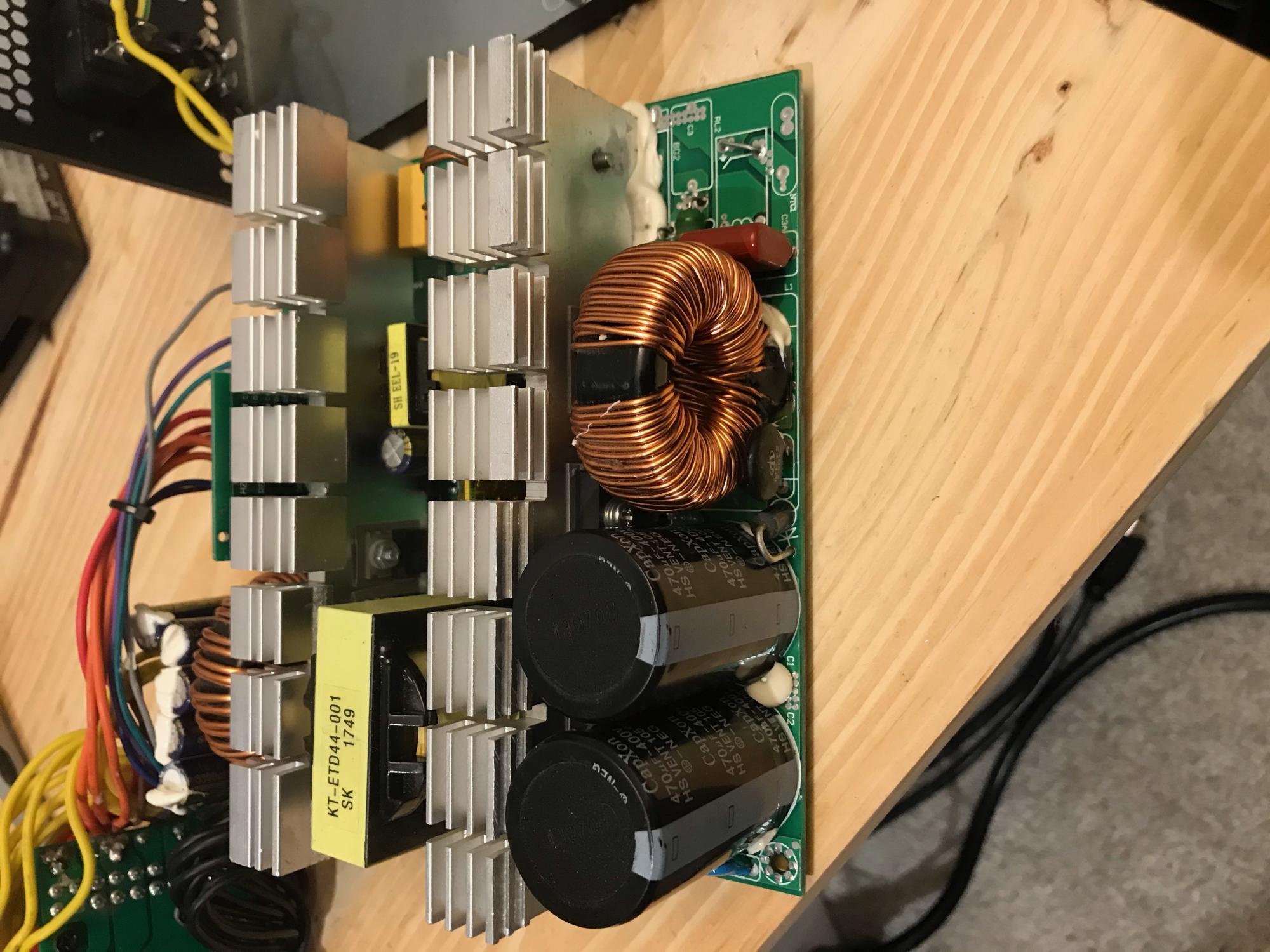

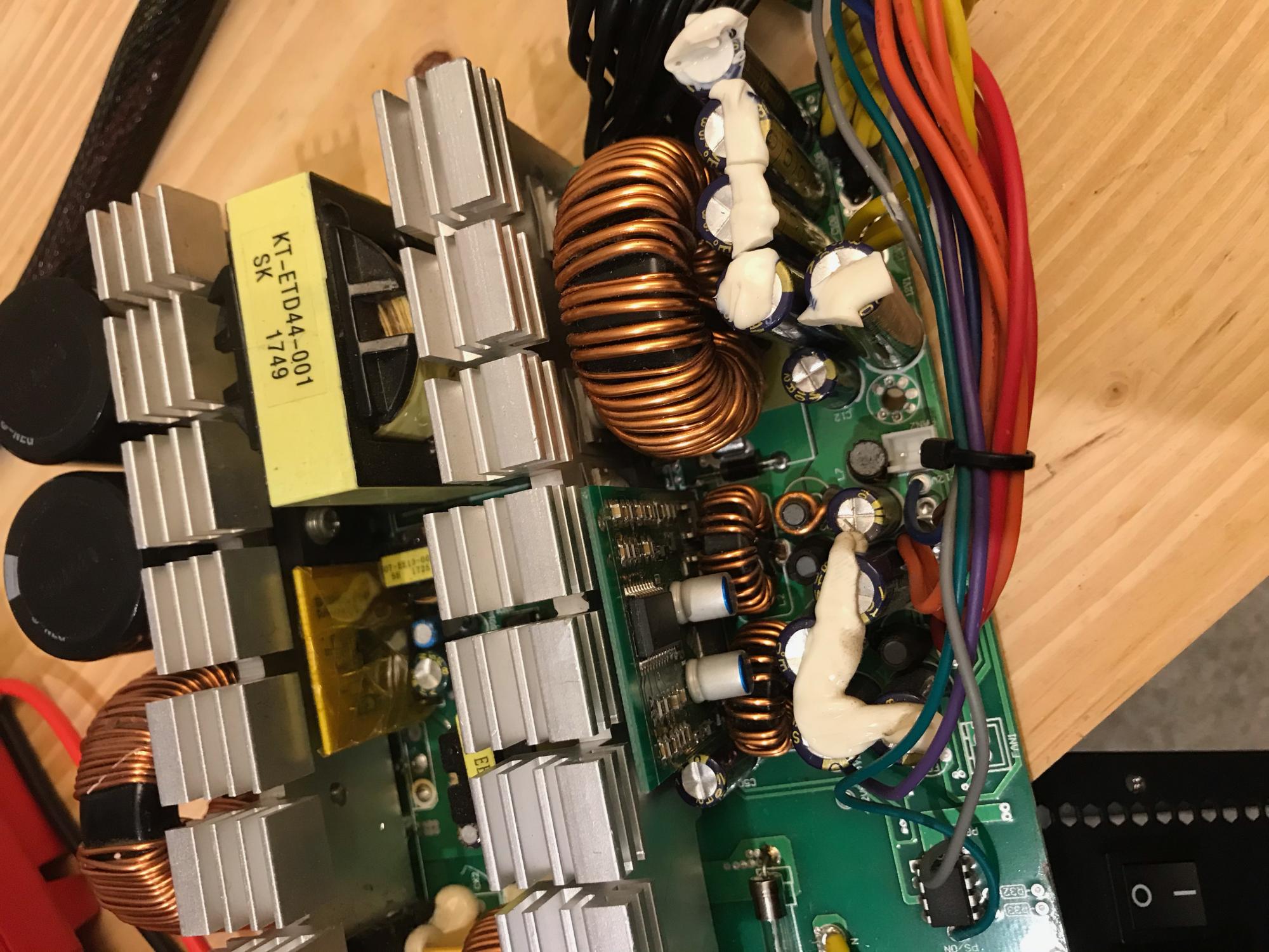

              meh so after swapping to the 150W something weird happen. im certain i didnt short anything by accident but now im only getting .4V on my mains.
              at the point of when i noticed i was probing and around the ps-on chip there. labeled GR8313 8pin dip in the corner there.
              no shorts found yet
              heres some pics.

                well you need some new opto-isolators!!

                  Re: 1300W PSU - Help with replacement mosfet
                  stj, that could be just a picture artifact or conformal coating.

                    #49
                    Mains?
                    As in, AC-side on the primary before bridge rectifier or DC-side on the primary after the bridge rectifier... and by that, check the voltage both right at the bridge rectifier and across the main caps. You should have about 160V DC on either (for 120V mains.) If not, check fuse again, as well as NTC thermistor (located between APFC coil and the 1st primary-side 400V cap.)
                    Once you have confirmed you have about 160V DC on these parts, check 5VSB again. Better yet, my suggestion is to plug in a small 12V light bulb on the 5VSB output, so that way you can get a visual that the 5VSB is working. This will come handy when testing the PSU - particularly when you short PS-ON to ground. When you do that, and regardless of whether the PSU turns ON or not, is the bulb hooked to the 5VSB output continuing to glow? The idea is to be able to verify that the 5VSB is running at all times as long as the PSU is plugged in. Then we can go troubleshooting further. Please report back what happens with the following tests/suggestion I made above.
                    Maybe artifact / reflection from flash/light, but I don't think this PSU has conformal coating. So O/P should indeed check what's the deal with those optocouplers - any sign of bubbling, bulging, or discoloration on them should get them removed from the board and checked.

                        #51
                        Look at IC102 and IC506 about in the middle of this picture here:
                        https://www.badcaps.net/forum/attach...3&d=1616974045
