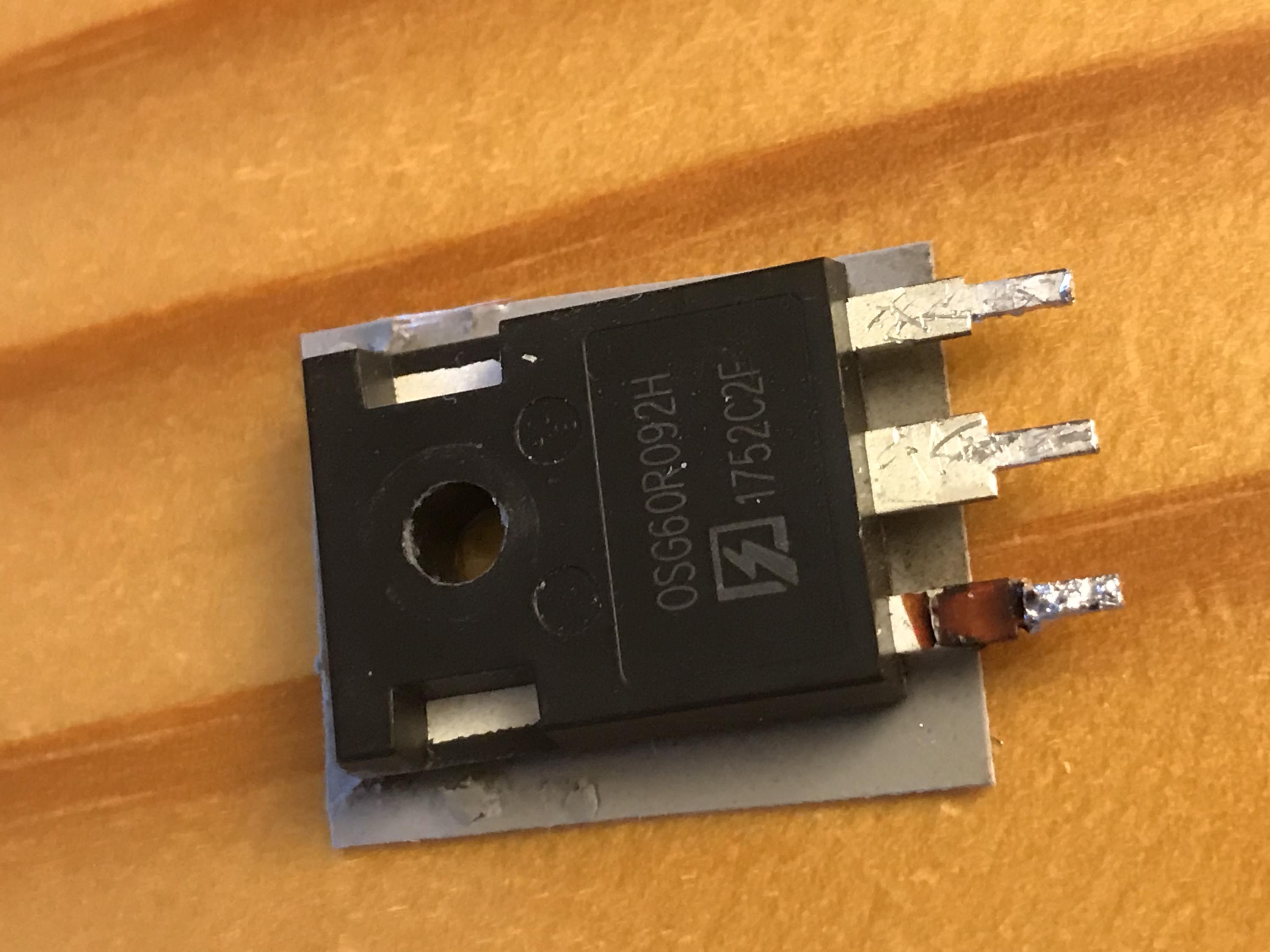

    Hey guys,
    had this 1300W gigabit PSU with a blown fuse ( i actually have two with the same problem.)
    I found a shorted power mosfet and diode and some low Ohm resistors that measure 0Ohm.
    I cant find the data sheet on this mosfet at all. need help finding replacement.
    any help would be great.
    I was able to find this on the mosfet but thats all
    https://www.aliexpress.com/i/32967081176.html

    Re: 1300W PSU - Help with replacement mosfet
    Here is the datasheet
      Thank you so much. hopefully replacing them with the other things brings these back to life. Got em for free and theyre fully modular so would be sweet.
