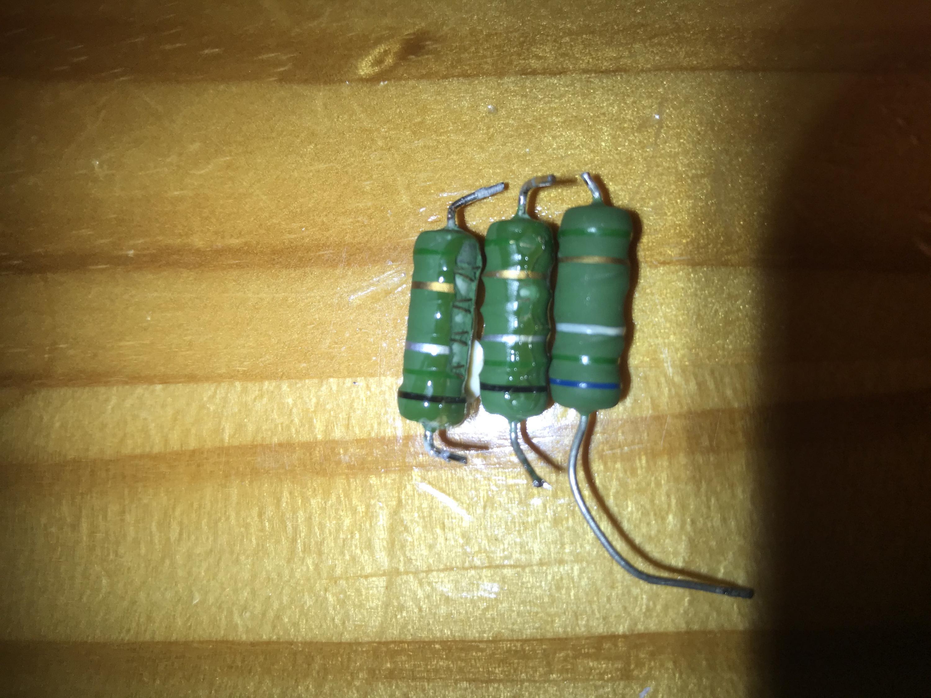

      Actually can someone help me identify the specs of these resistors?
      I really suck at this for some reason
      they seem like metal film 2watt
      2x 5.8ohm.05%
      1x 65.9ohm.05%
      What do you all think?

        Re: 1300W PSU - Help with replacement mosfet
        You technically already did. The specs are as such indicated by it's color bands.
          Well what if im color blind?? :P
          I guess im just looking for reassurance before i order. im just guessing on the 2 watts too does that sound about right?
            The resistors are likely ok based on your first post?
              But they measure very low about .03-.04ohms
              • R_J
                • Jun 2012
                • 9606
                They are very low values, resistors very rarely go down in value. When I first looked up the values they came to 0.05Ω
                Using the 4 band color code, they read 0.05Ω 5%
                  well why do they have 5 bands then? its confusing which is why i asked in the first place.
                  Whats the point in having such a low resistor there? does it act as a fuse?
                  If you did measure them as 4 band they would still measure lower then spec
                  which leads to ask do i replace them with 4 band spec or 5 band spec resistors?

                    #29
                    Here is the answer to your question
                    https://www.digikey.com/en/resources...tor-color-code
                    Use the calculator for 5 and 6 band selection and you see what each band is for
                      master hoarder
                      Sometimes there are 4-band resistors with a 5th band that stands for "reliability", IIRC. This is different than regular 5-band resistors, where the first 3 bands are the value of the resistor, the 4th is the multiplier, and the 5th being the tolerance. In this case here, I think we are dealing with the former.
                      Current sensing + fuse.
                      Despite its low resistance, a significant voltage rise can appear across that resistor when a very high current is passed through it momentarily, thus allowing ICs in the PSU to gauge how much current is passing through a given circuit.
                      These resistors are also typically metal-oxide flame-proof and fusible - that is, if overloaded severely, they will open like a fuse and will not burn down (something that regular carbon composition resistors may actually have trouble with.)
                      I suggest not to replace them, like R_J said. Indeed when resistors go bad, they don't go lower in resistance but always higher. The fact that they did not go open-circuit means they survived whatever fault there was in the PSU, again, since they are fusible type. I'm also a bit confused on their color band rating as well. The two with Black, Green, Silver, Gold, Green bands don't seem to fit any standard ratings, as black can't be a first color band (unless it's brown that has turned very dark - in which case, these should be 0.15 Ohm resistor, I think) and if rad the other way, Gold doesn't make sense as a 2nd color band either. The 3rd resistor also doesn't make sense to have a value starting with Blue (6) and Green (5) color bands, and the other way around has same issue as above with Gold as the 2nd band.
                      *EDIT*
                      According to the Digikey resistor calculator that Sam posted above, the resistors with color bands Black, Green, Silver, Gold, Green show up as 5.8 Ohms, 0.5%... and that's assuming the 3rd (middle) band is NOT actually Silver but rather Gray (calculator has no selection for Silver.)
                      And the other one (Blue, Green, Gray, Gold, Green) comes up as 65.8 Ohms.
                      Now that appears to be a match with your measurements in post #22, so I think they are OK indeed.
                        Thank you for your time and detailed explanation.

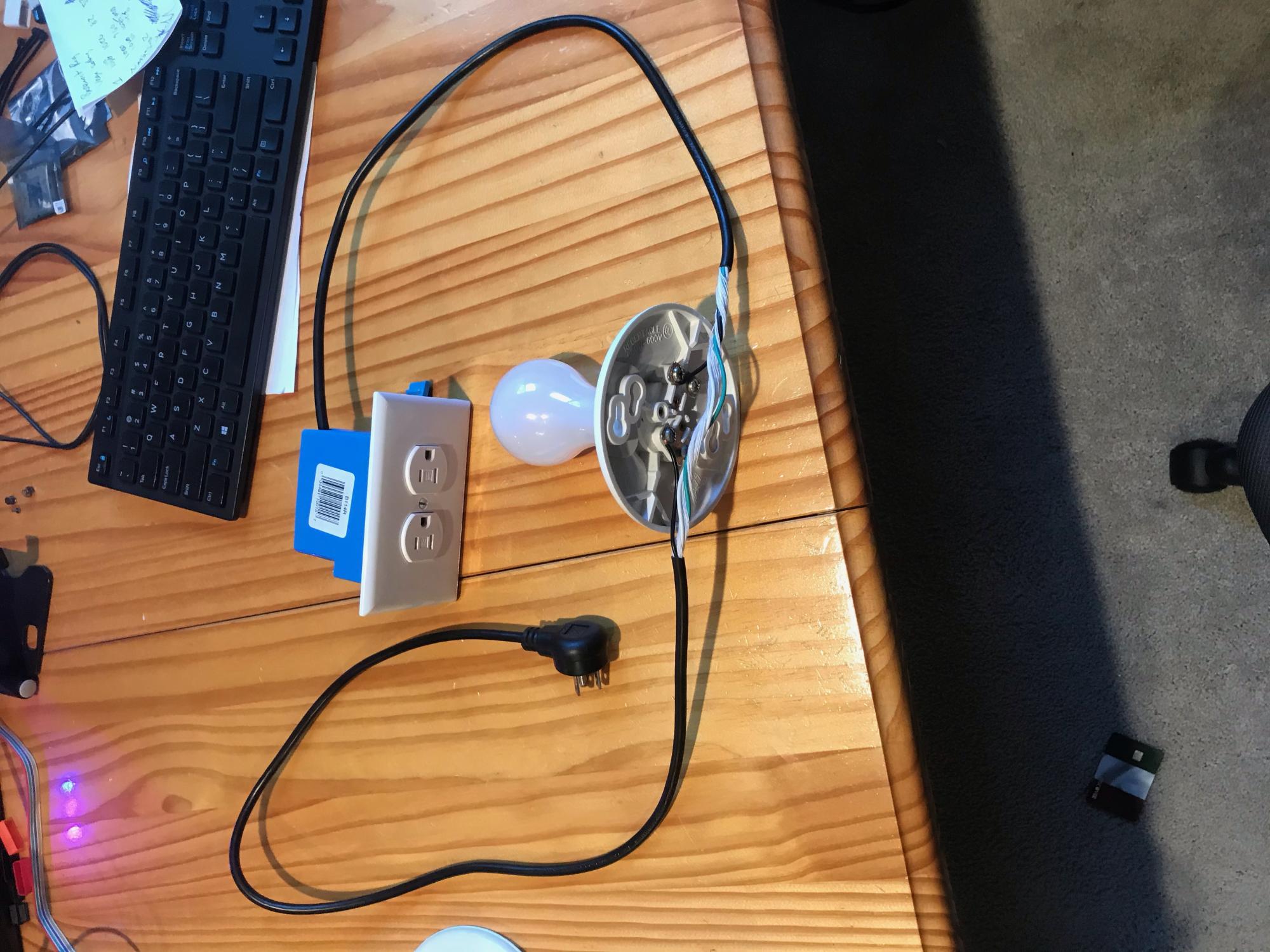

                            Well parts came in. PSU is all back together!
                            i really wish i had a solder sucker! getting solder out of the holes with just solder wick can be a pain.
                            Anyways
                            I just need to find a bulb socket.
                            basically i took an old power cord. cut the end and attached it to a typical electrical socket and wall box.
                            I removed a foot or so of shielding from the cord exposing the wires.
                            cut the black one, and plan is to attach them to the bulb socket and bam.
                            Sound about right??
                              and bam.
                              the lamp is to prevent that!
                                Welp here it is, i guess im going to see if i get 5VSB
                                I if you all dont hear back then im probably in heaven or hell
                                  i have 5VSB!
                                    that lamp looks surprisingly white, is it a real glass filament lamp??
                                      welp. i guess its a failure.
                                      i get the 5vSB but psu doesnt turn on.
                                      testing a spare 350W psu with the limiter i get all my voltages.
                                      Do you think the 1300W is too much for the limiter or something?
                                      im using a 72W bulb and bulb turns on and fades quickly when switching psu on.
                                      Any thoughts?
                                        yes i believe it is a standard incandescent bulb. its just frosted glass i suppose
