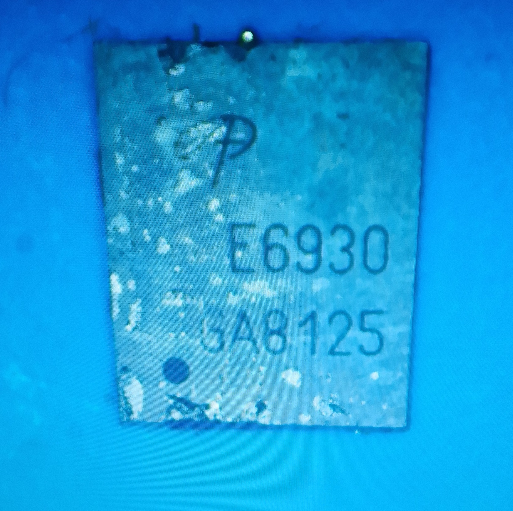

    Hello.
    I have a notebook with a shorted mosfet, it's a E6930 GA8125.
    It seems to be a 30V dual asymmetric N-channel AlphaMos.
    Luckily the notebook is working, so I just need to find a good replacement for this mosfet.
    And here is where I need help!
    It's the first time I have to replace this kind of mosfet, I checked on mouse and I found this: (mouser No) = 512-FDPC5030SG.
    I need your help to be sure is a good replacement or there is another with better compatibility, since I can't find the same exact (just from China).
    Thanks!

    These mosfets are for sale on ebay uk search.4pcs MOSFET AON E6930 IC 30V DUAL N-CHANNEL ALPHA & OMEGA SEMICONDUCTOR

      Thanks for your reply and help.
      I found the seller you were talking about, the condition though is "second hand". But there are 4 pieces, so I'm hoping they didn't burn them all while removing them from the board.
      I think I'll get it. Thanks again 👍🏻

        I think it's AOE6930. Maybe try Digikey

          you can also use AON
          P6994
          P6982
          P6984
          P6992
          P6996
          P6998
          as long as it is 30V Dual Asymmetric N-Channel
          there are lot of options.
