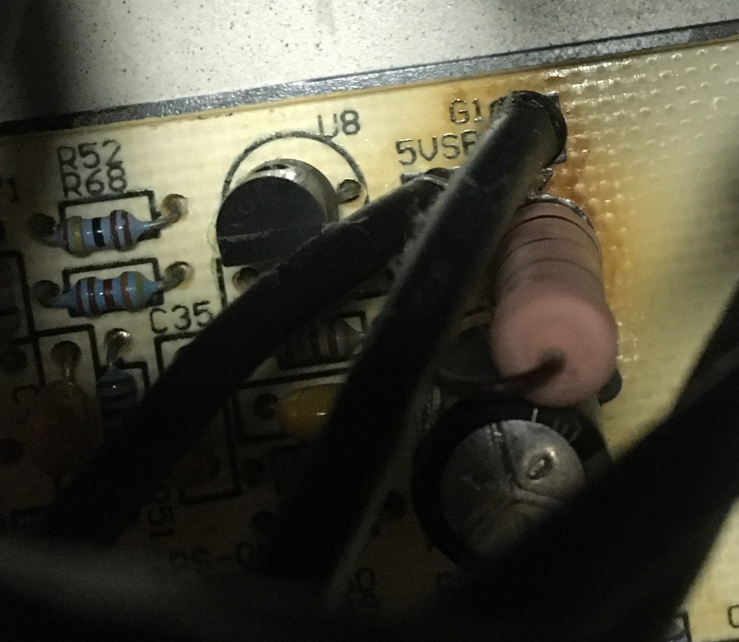

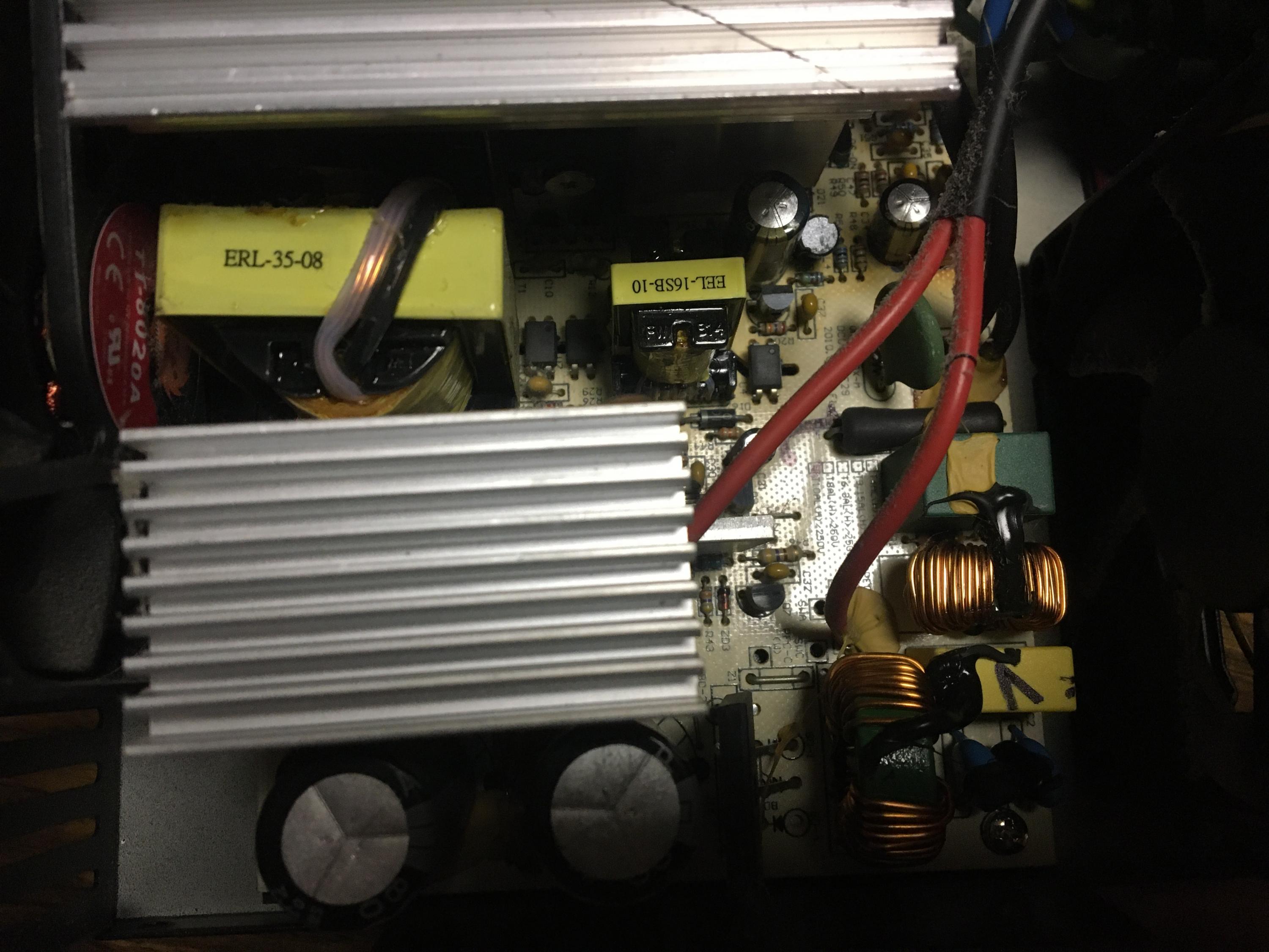

    I have an older Thermaltake PSU that has a squealing noise whenever it's plugged in, even when totally disconnected from everything else. It automatically powers on the 5V and 12V rails with full voltage, but the +5VSB circuit only has 0.9V on it. I would assume this is my first place to start troubleshooting?
    There is nothing obviously burnt/leaking that I can identify.

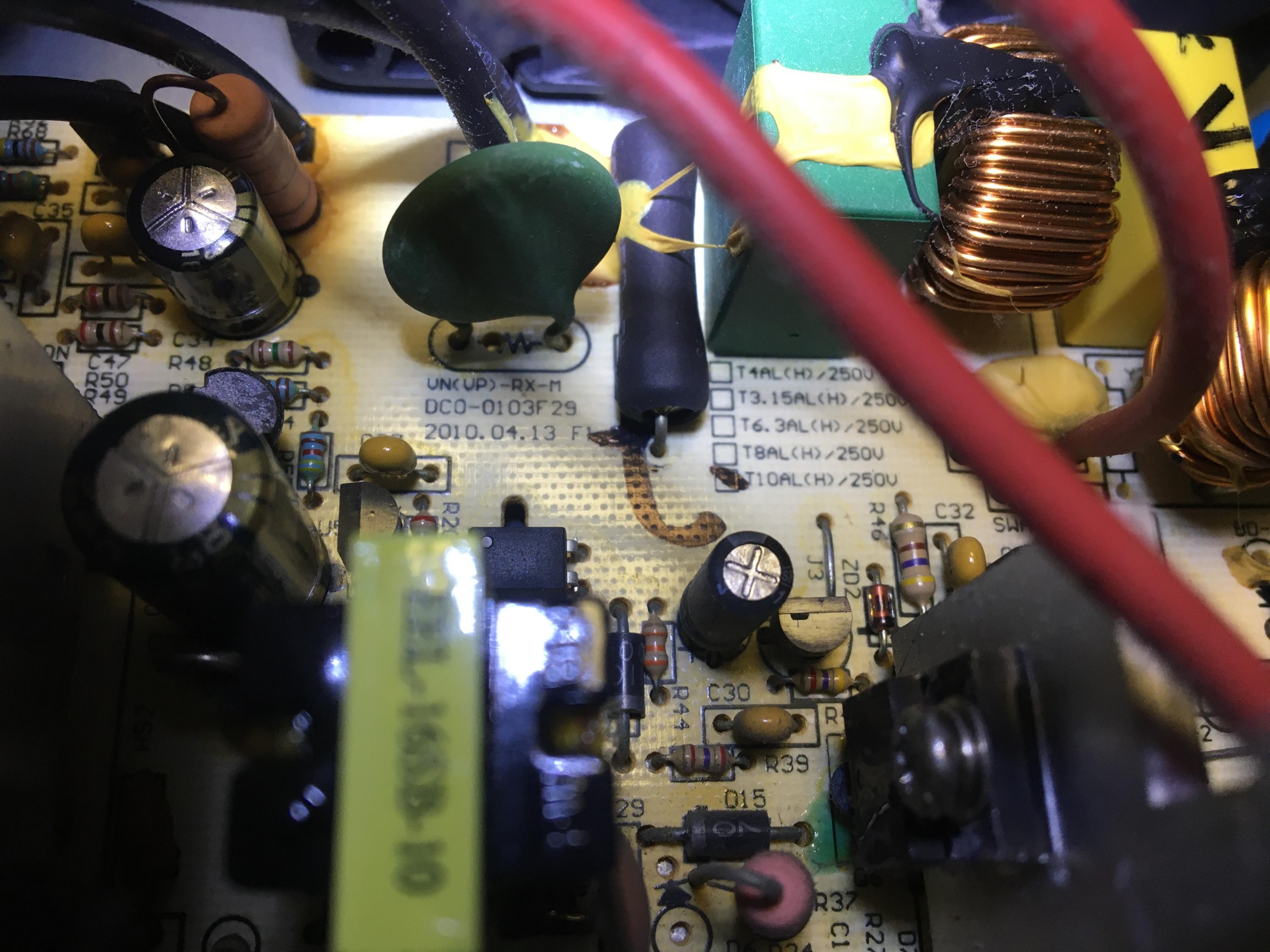

    I've tried to take some decent photos of the 5VSB area. Components of notes:
    • U8 at the back is marked AZ431
    • C38 is 102
    • C47 is 104
    • C34 is a Teapo 330uF 16V (I think all the cylindrical caps are Teapo)

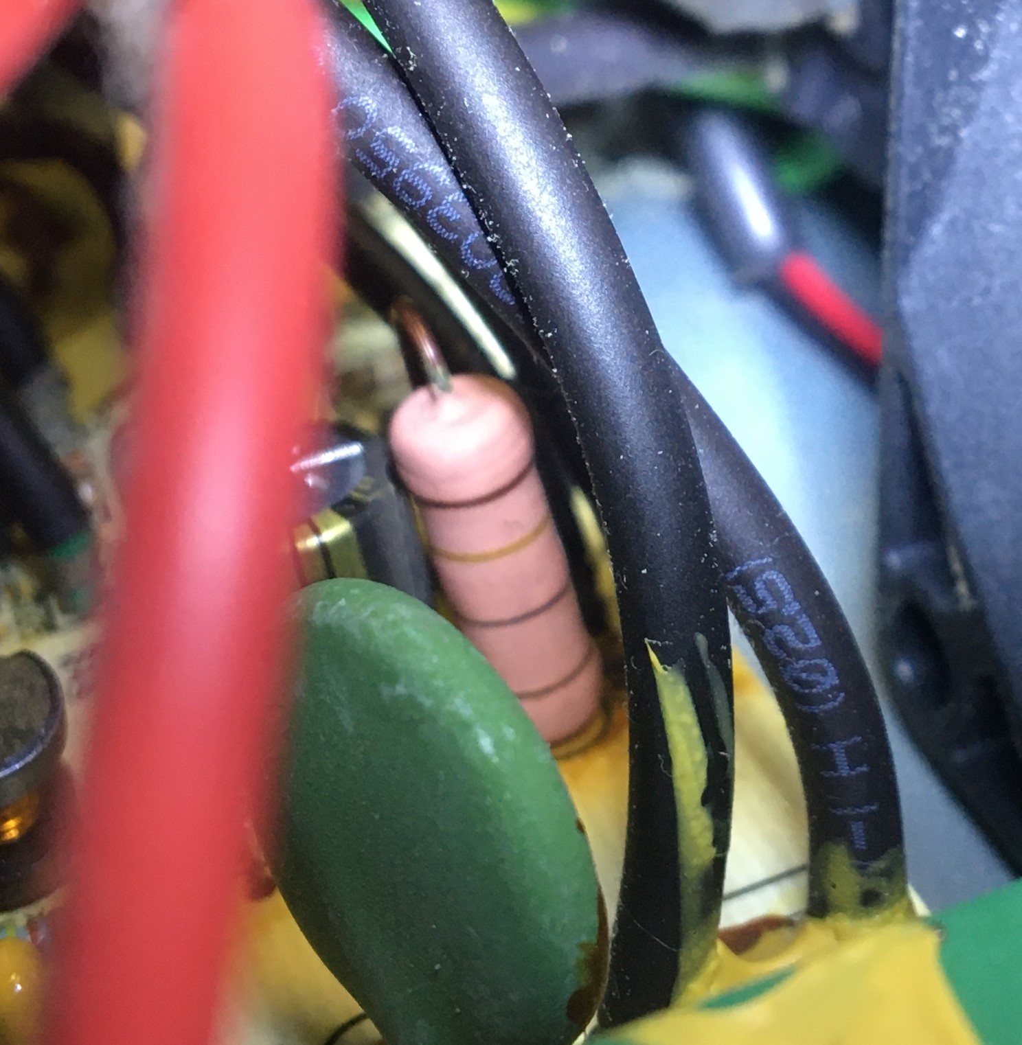

    • Big pink resistor appears to be brown, yellow, violet, gold but I'm not totally sure.
    I'd be thankful for any pointers on what to replace or if there's another area I should be looking at that could impact the 5VSB circuit.

    the 2 output caps on the 5v standby are bad - specially the smaller one.
    probably got cooked by the load resistor!
    if you can put heatshrink or fiberglass sleeving over that resistor before fitting the new caps it will help!

      Thank you for the quick response--I can definitely heatshrink that load resistor. Please forgive my ignorance: the little 102 and 104 caps are the output caps? And you think that 330uF one is OK even with as close as it is to the resistor? I have the two little ones on hand; would have to order the big one though.

        c34 and the larger one behind it closer to the heatsink.
        you need something low esr.
        like panasonic FR or FK series.

          Easy enough--thank you! I have some equivalent FR-series for both from DigiKey in my cart. Should this also take care of the auto-turn-on issue, or is there anything else I should look at before ordering?

              Re: Thermaltake ATX TR2-430 Turns on by itself, squeals, & has 0.9V on +5VSB
              Maybe or maybe not.
              When the caps on that 5VSB circuit go bad, the 5VSB will start to oscillate with crazy voltages, and that can take components with it - both inside your PSU and in your computer.
              So indeed the first step is to recap the 5VSB - that means also replace that one small 10 uF 50V capacitor on the primary side. You can see it on this picture of yours:
              https://www.badcaps.net/forum/attach...7&d=1613063363
              After this and replacing the output caps, make sure the 5VSB is stable at 5V +/-5% on the voltage (i.e. anywhere from 4.75 to 5.25V is acceptable for the 5VSB.) Though if I recall, on these PSUs it usually sits closer to 5.15V. With that, the PSU should no longer turn On by itself anymore. If it does, there may be more troubleshooting to do... but worry not - these units are fairly simple to work on.
              On that matter, if you do encounter any further issues on the 5VSB that need troubleshooting, you can refer to the schematic here:
              https://www.badcaps.net/forum/showpo...postcount=3058
              That aside, I suggest that you DON'T recap just the few failed capacitors. Instead, since you have the whole PSU already out for servicing now, you might as well DO a FULL recap.

              Heat-shrinking that resistor will *not* help it or the surrounding caps, so there's no point to doing that. The main problem is that resistor is just dissipating too much heat and will continue to cook even your new caps.
              I can't tell its value from your picture - the color of the bands appear off. But the one in my PSU was 27 Ohms, which on the 5V of the 5VSB gives about 1 Watt of heat... which is why it runs so hot. Try replacing it with 33 Ohms or 47 Ohms @ 2 Watts rating, and leave it with long leads so you can position it further from the caps. Alternatively, you can just solder longer leads/wires to this resistor and place it somewhere else in the PSU where it can get better cooling and where it won't cook any nearby caps.
              I didn't do that on my PSU, since I only use it for testing and I keep it disconnected from wall power most of the time. But over long-term deployment, I suggest to do something about that hot resistor. Again, heat shrinking it alone will not really do anything. Either needs to be moved or replaced with a slightly higher value.

                if the resistor had longer wires i would mount it under the board on the track-side
                      That still wouldn't help it run cooler or heat the nearby circuitry less. It just has to do with the power dissipated: any 3-Watt or smaller resistor dissipating more than 1 Watts (which is the case here) will tend to run hot - at least when the fan is not running (which it isn't when the PSU is in soft-off mode and the 5VSB circuit is always running.) So in cases like that, where active cooling is not used or very limited, then it's best to keep power dissipation on resistors under 1 Watt. 0.5-0.7 Watts on a 2-3 Watt -rated resistor is just about the max you should do if you want that resistor to run at less than 50-60C.
