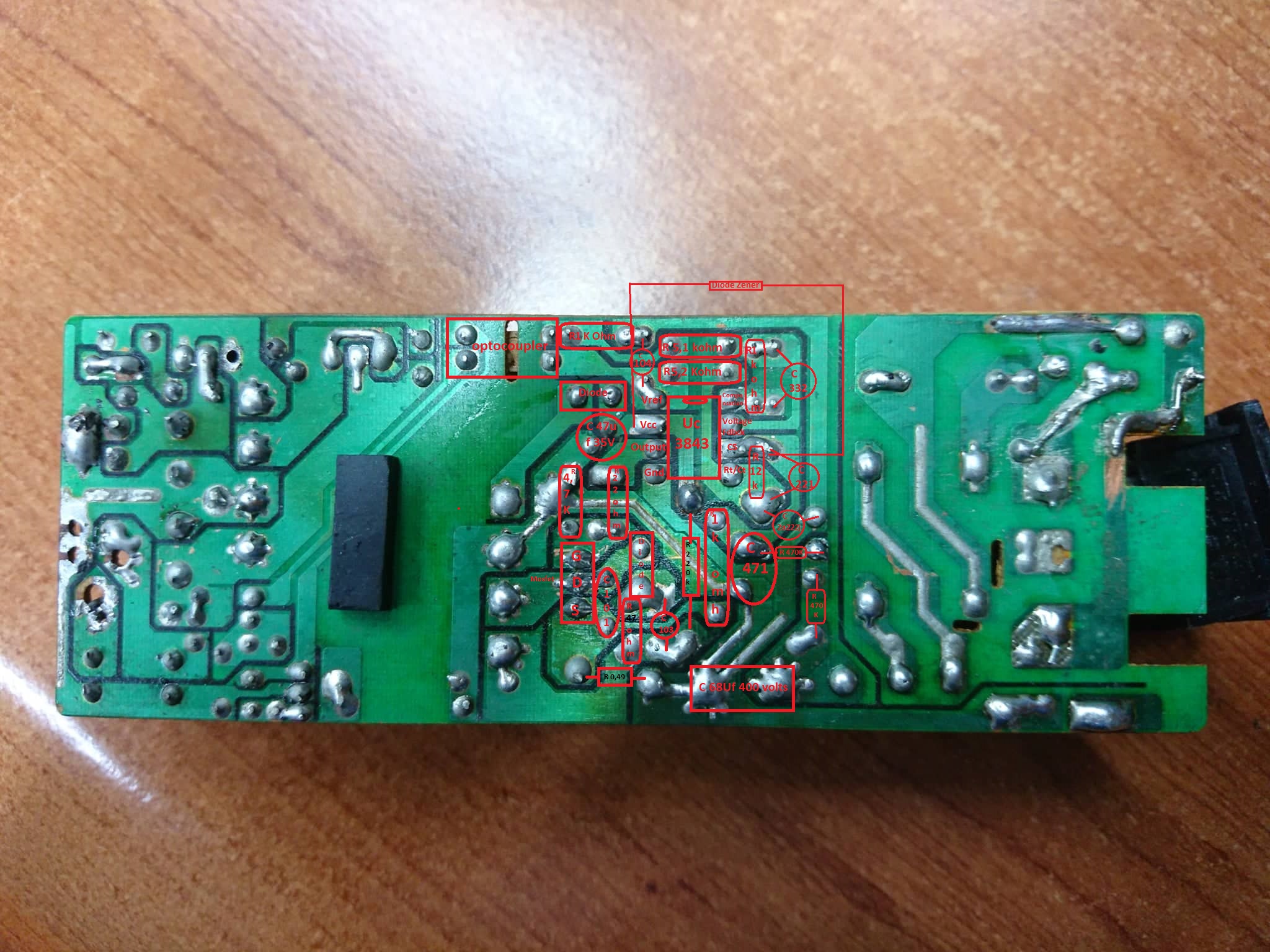

Dual output power supply 5 and 12 volts (no output)

    Re: Dual output power supply 5 and 12 volts (no output)
    Originally posted by eccerr0r
    Fuse would have blew if the insulation wasn't there anyway?
    Looks like there's a pull up to shut down if the resistor blew (incidentally it seems like I see two resistors in parallel there I think, this should be the 0.49Ω resistor? Which should be a fusable resistor? And it looks like a 100Ω resistor there in parallel with something else that I can't see underneath?)
    Hmm...
    the fuse in all this is not blown, see just for the resistors, because I did not find the 0.49 one and I put two 1 ohm in parallel
      Check the VCC voltage across the small electrolytic next to the ic. Post what this voltage is.
          i've 8,2 volts, the capacitor is 47uf-35 volts
                If this is a td3843 the startup threshold is min 7.8v so the ic should be starting. It could be that it is not seeing the current sense pulse as I still don't know if that @#$% resistor is good or bad.
                You also need to check the resistor between pin6 (output) of the ic and the GATE of the mosfet, it could also be open.
                however the resistors have all been replaced, except the smallest ones that look good to the eye
                  which resistor are you talking about? in the previous message some strange symbols appeared however the ic is now a uc3843, the original was a Td3843

                    #29
                    if you are talking about the resistor you were talking about, which must be connected between the cs of the ic and the source of the mosfet, help me to understand what it could be, I am available, if you want I can make a diagram, on the part of the circuit where there is are the welds to try to understand better

                      #30
                      If you can't trace one resistor between the CS pin and the fet, I can't help you. Go back and see post #13. It is the one in the yellow square.

                        #31
                        ok tomorrow I will try to bring the component diagram on the part of the welds graphically so let's see if you can understand better, in the meantime thanks

                          #32
                          I hope I have done a decent job

                            #33
                            I tested the 1kohm and 22ohm resistors, the first seems dead, the second gives me a lower value about 16.9 ohm
