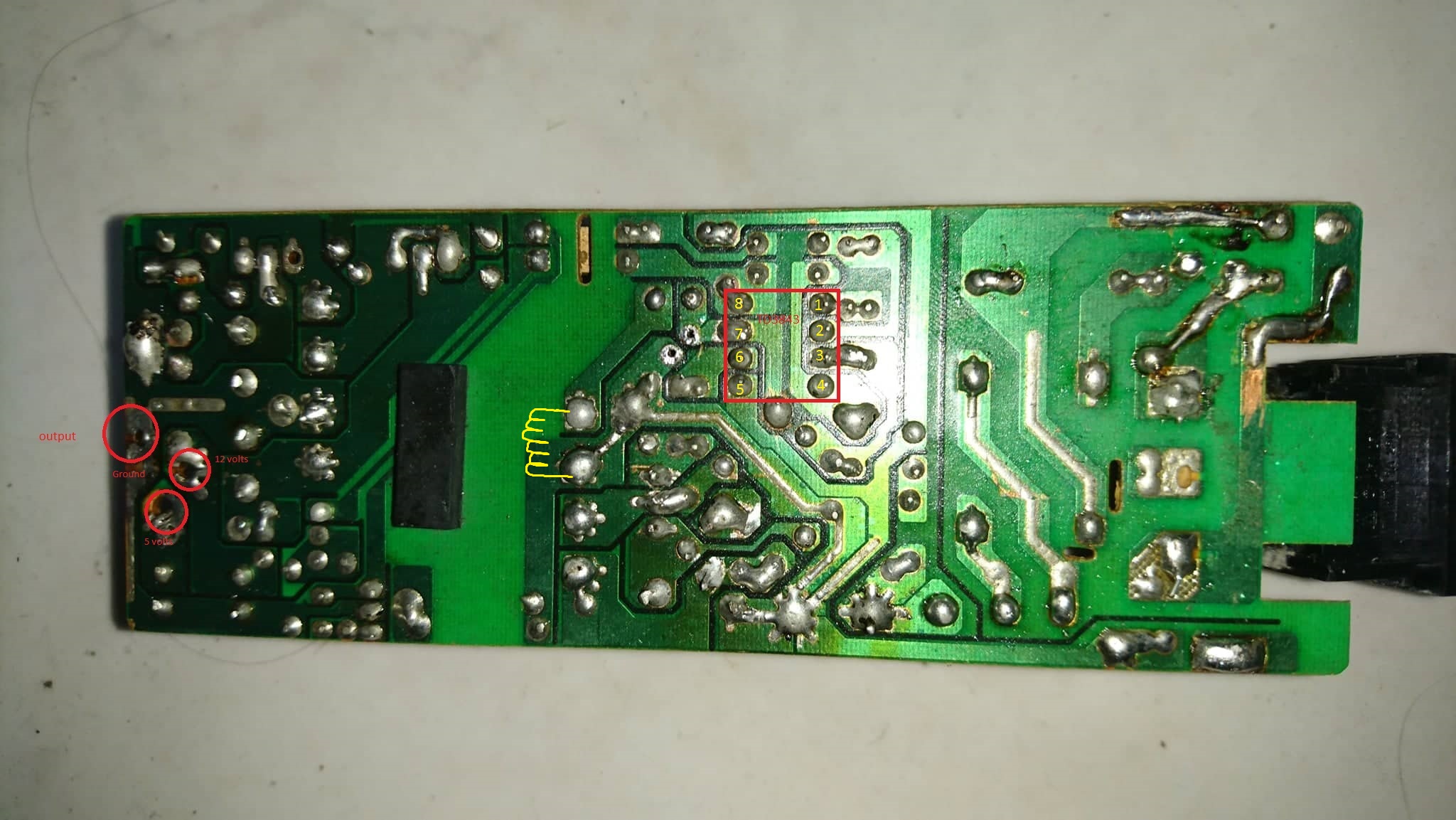

      I first have to check the voltage between the negative of the big capacitor and the drain of the mosfet right? Then should I put the negative probe on the ground of the IC and test all the other pins with the positive probe?
      • R_J
        • Jun 2012
        • 9606
        #43
        Re: Dual output power supply 5 and 12 volts (no output)
        You can use the negative lead on the big capacitor for all the tests, that is what is called HOT ground.
        Check that there is voltage on the drain of the mosfet (that is the center pin) be careful not to short to any other pin. the voltage on the drain should be around 325VDC
        Then leave the negative probe on the cap negative and check EACH of the ic pins
        Pin1=
        pin2=
        pin3=
        pin4=
        pin5=
        pin6=
        pin7=
        pin8=
              voltage between capacitor and drain 315 volts
              Pin1 = 0
              Pin2 = 0
              Pin3 = 0
              Pin4 = 0
              Pin5 = 0
              Pin6 = 0.08
              Pin7 = 0
              Pin8 = 0

                  forgive me I had left the tester set to test the big capacitor with the drain, here are the updated results
                  Pin1=0,47
                  Pin2=0,18
                  Pin3=0,35
                  Pin4=0,58
                  Pin5=0,87
                  Pin6=8,20
                  Pin7=0,03
                  Pin8=0

                        Your pin voltages are wrong. are you sure pin 6 has 8.2v and not pin7?

                          yes there is an error I inverted the pins, working with the ic on the contrary I made a bit of a mess ...
                          Pin5=0
                          Pin6=0,03
                          Pin7=8,20
                          Pin8=0,87
                          others are right

                            Check the resistance of pin8 (ref) to pin5(ground) Pin 8 should have +5 volts if the ic is working, If the pin is not shorted or very low resistance to ground, check the output pins of the optocoupler to see if they are shorted. if not I suspect the ic is bad.
                            If you look at the datasheet you will see that the VCC pin supplies the 5v reference, so with 8.x volts on the vcc pin, the ref should be there as well.
                            Also check the winding of the transformer (marked in yellow) it should read less than 1Ω

                              so in summary, I have to test if between pin 5 and pin 8 of the IC there are 5volts, I had already tested the optocoupler, I tested the output as a diode test, but it didn't mark anything, is it right or did I have to have some value? and then the transformer

                                I did the tests you asked me, between pins 5 and 8 I have 0,89 volts, the winding of the transformer that I tested without power is 0.01ohm

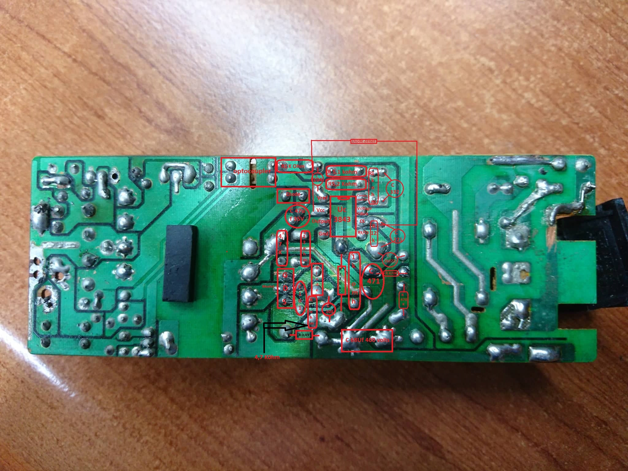

                                      I noticed a big mistake, the resistance marked on the photo, originally was 4.7Kohm and not 47ohm, could it affect?
                                        That would likely not effect the ic's operation, it would cause a problem once the power supply started and would likely just blow the 47Ω resistor.
                                          That's not what I asked. I said check the resistance between the pins not the voltage, I already no the voltage is .8v . If nothing is shorting pin 8 to ground, then the ic is bad and not producing the 5 volt reference.
                                          It could be possible that zener diode connected to the vcc line is bad. It could check like a regular diode but be zenering at too low a voltage.
                                          Since you have another power supply, compare the resistance of the ic pins to ground and see id there is a difference
