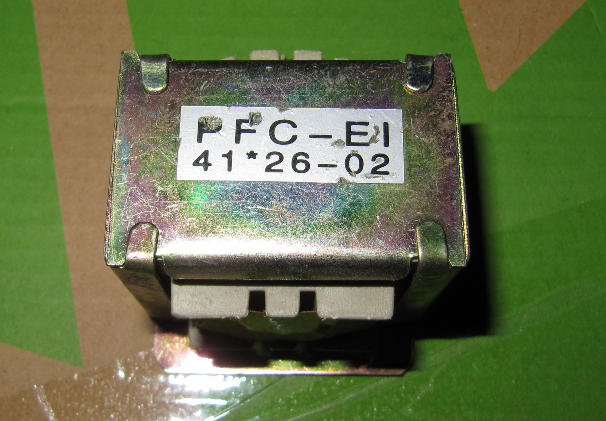

                          And now a quiz:
                          https://www.badcaps.net/forum/attach...1&d=1598208551
                          Is this passive pfc fake or not?
                          • Per Hansson
                            • Jul 2005
                            • 5895
                            • Sweden
                            #1653
                            Re: the gutless, bloated, and fried power supply hall of shame
                            Originally posted by goodpsusearch
                            And now a quiz:
                            I vote for real PFC, not fake.
                            If it's fake they are just being silly putting so much effort into it!
                              I'm with Per on that one - looks real to me.
                              It indeed would be silly to give that PPFC choke a proper steel EE core and even wind a few turns of wire just to make it look real. If they reached that point, why not fully wind the rest of the inductor and actually have a compliant PPFC? But then again, Copper is expensive, so there's still a small chance it's fake. I'd be really disappointed if it was, though.

                                    • goodpsusearch

                                        #1659
                                        WOW! What a gyp!
                                        Looking back at the first picture you posted...
                                        https://www.badcaps.net/forum/attach...3&d=1598208547
                                        ... I should have guessed that it was fake. I see now that the copper wire loops around the outside of the laminated steel "core". If this was a proper PFC choke (or any transformer with EE core for that matter), then wire should be wound around the middle section element of the EE core.
                                        *Sigh*
                                        This is such a waste of materials and resources.
