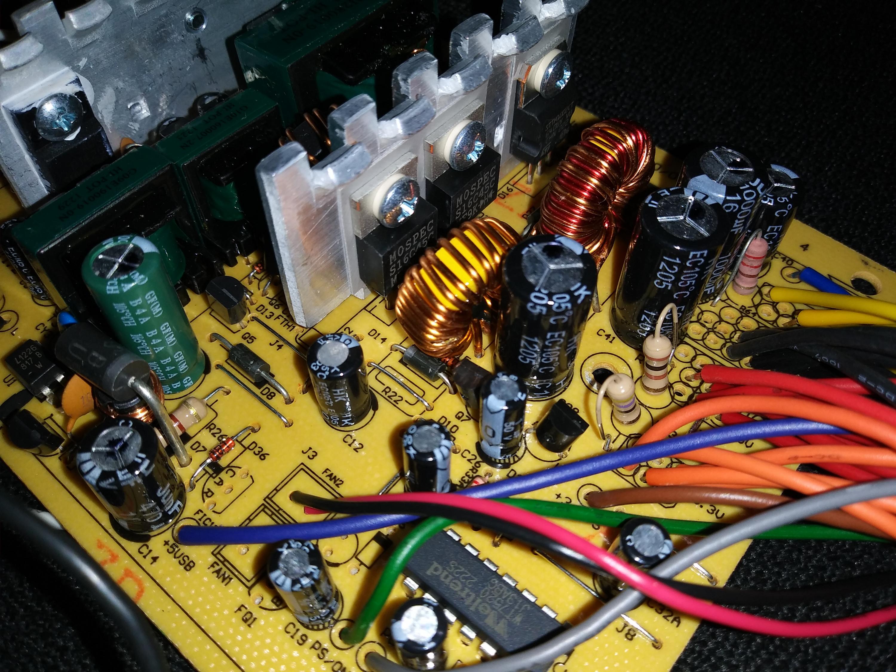

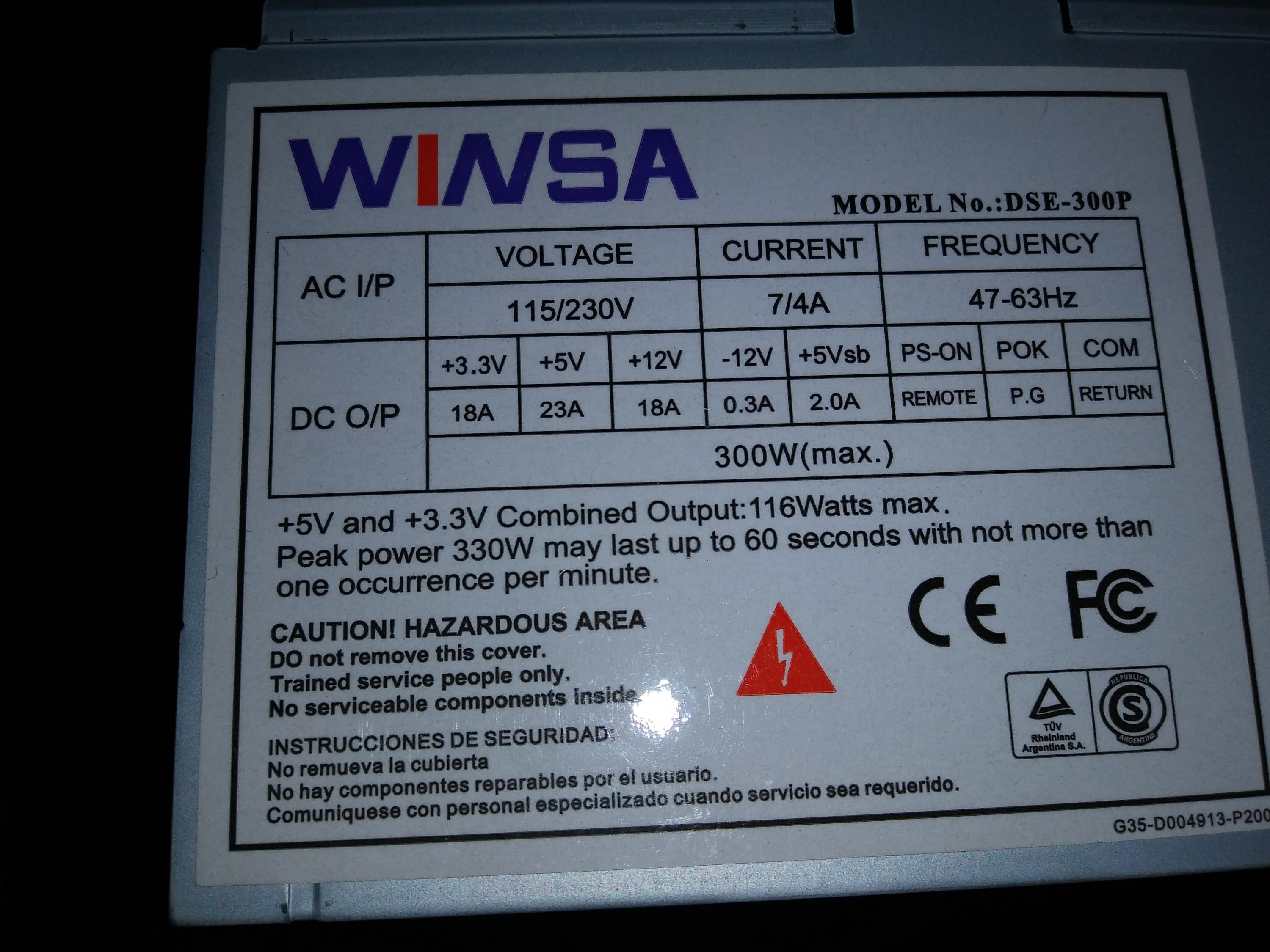

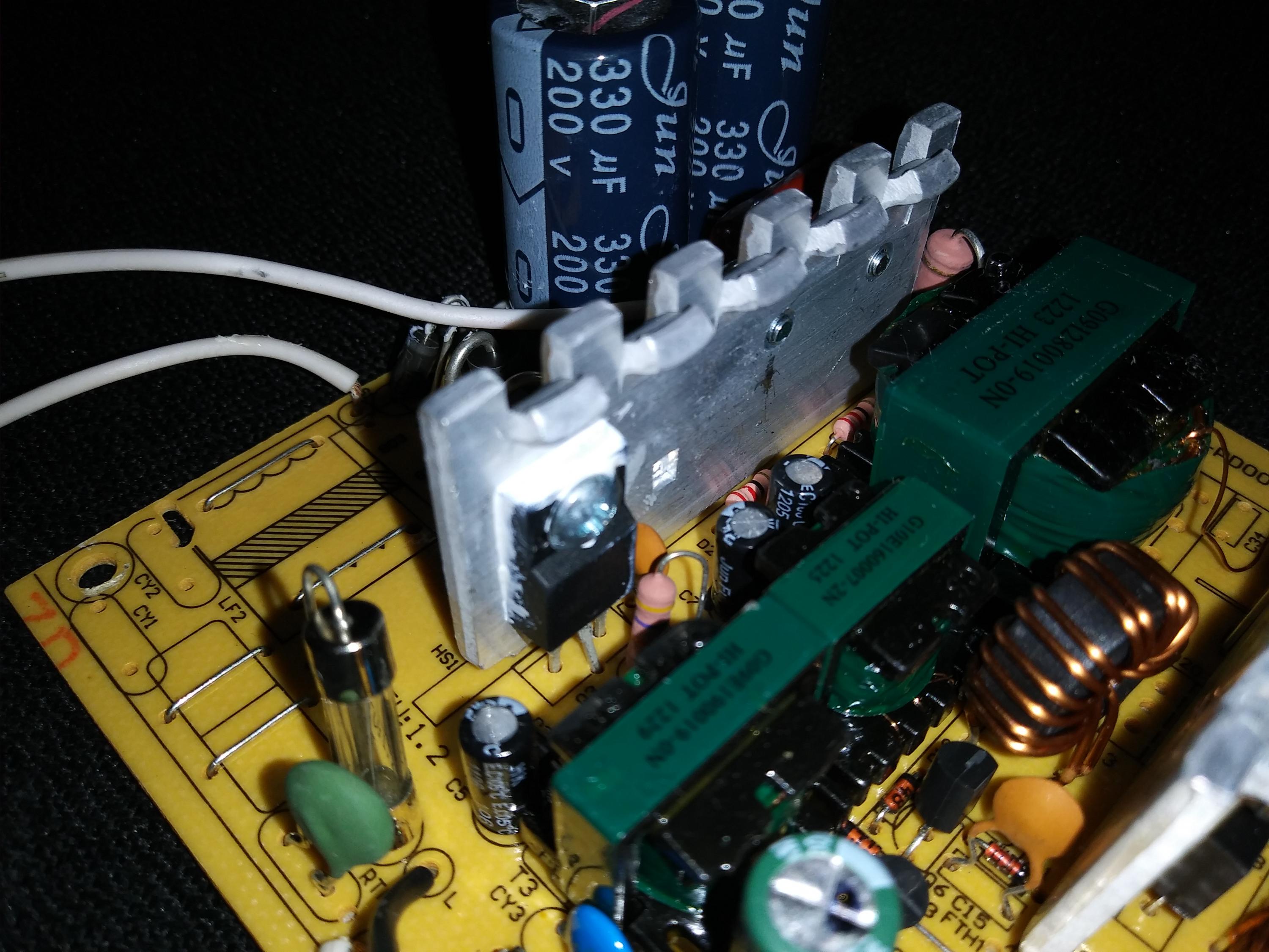

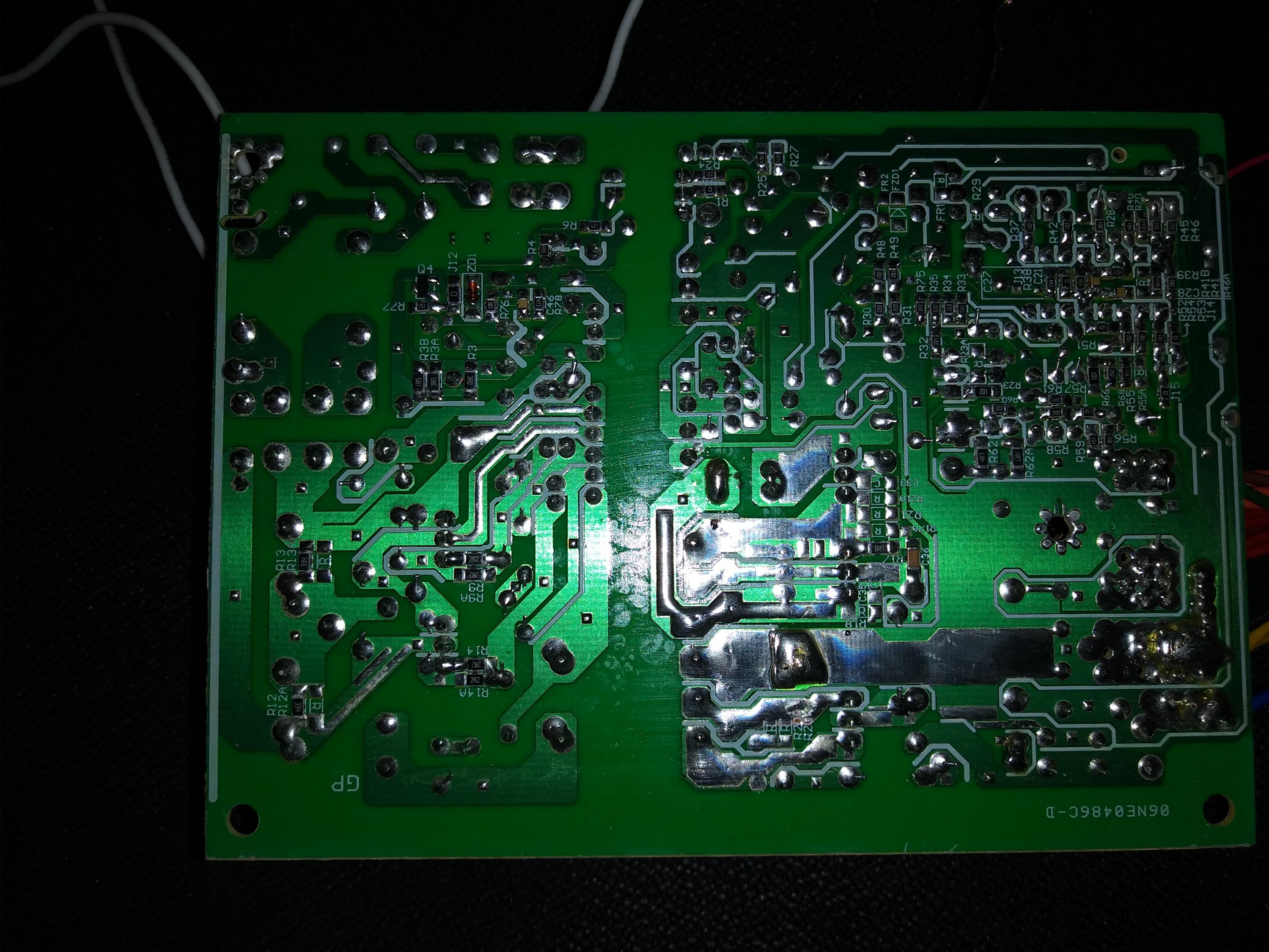

            Winsa PSU, Model: DSE-300P. 300w PC Power Supply.
            Another cheap PSU to add to this thread.
            Label........
            Looks pretty normal for a cheap PSU.
            Top Side................
            Looks pretty cheap.
            Bottom side............................
            Soldering is not the best but it is better than others i've seen.
            Primary Side.....................................
            There are no X-Class or Y-Class capacitors.
            There is no Common mode choke or PF coil.
            The rectifier consists of 2 1N5406 diodes and 2 RL205 diodes.
            The primary caps are 2 gun RM 330uf 200v.
            The switching transistors are 2 KSH13007A's.
            The 5VSB Mosfet is an SMK0260.
            Secondary Side...........................................................
            The 3.3v and 5v rails use 1 S16C45C while the 12v rail uses 1 STTH1002CT.
            The 3.3v, 5v and 12v rails all use 1 Junfu HK 1000uf 16v capacitor with no PI coils.
            The -12v rail use 1 Junfu HK 470uf 16v capacitor with no PI coil.
            The 5VSB rail uses 1 Samxon GF 1000uf 10v and 1 Junfu HK 470uf 10v capacitor with a coil between them.
            The 5VSB rail uses 1 SB340 diode as a rectifier.

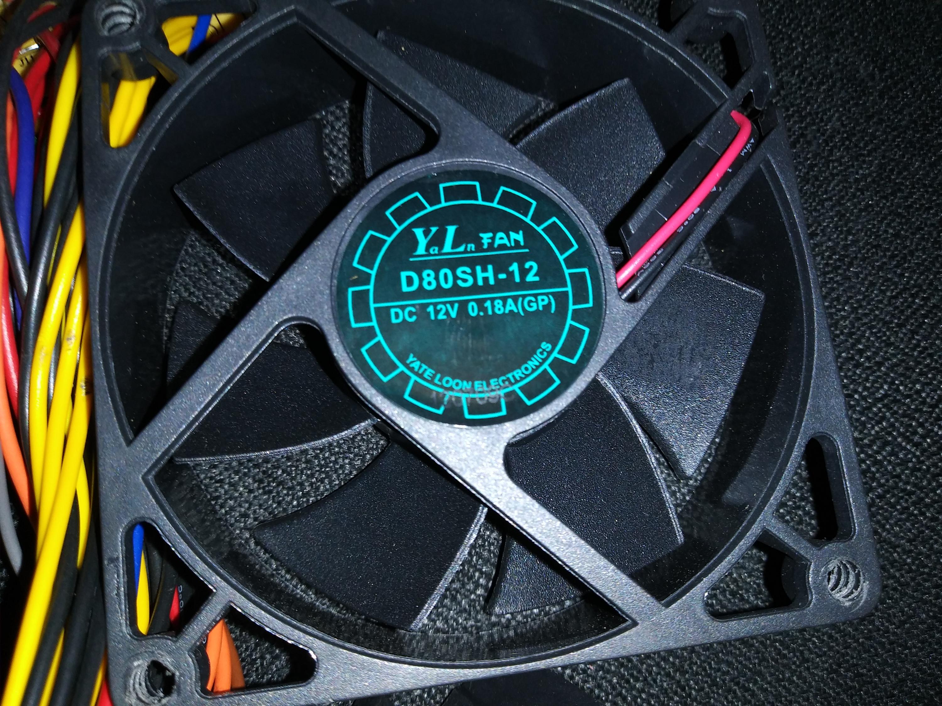

            The Fan..............................................................................................
            I'm not sure if this fan is a clone/knock-off as i can't really find any info about this type and the model number is in use by another fan that looks very different from this one.
            Overall, this PSU is pretty mich a peice of trash.

                #1507
                Re: the gutless, bloated, and fried power supply hall of shame
                Oh my
                I kinda wish you didn't upload those pics now - this thing is scary!!!
                300W??
                - Not a chance in frozen hell. Even 30W is pushing it too far.
                Funny how the label says peak 330W for 60 seconds once per minute
                I mean, doesn't 1 minute have 60 seconds?? In that case, the PSU should be able to do 330W all the time, right?
                Oh man, this thing is frustrating to look at. The soldering and overall build in terms of how things are put together doesn't look that bad. But why such crap undersized components? Just look at that output toroid, for example - it's the tiniest I have ever seen in an "ATX-capable" power supply ever. This thing wasn't made with just cost-cutting techniques in mind. It was purposefully made to be a useless POS from day one.
                Perhaps the name of those primary caps suggest what you should use to destroy this POS. (Or if you were me, desolder the output wires and disable the main PSU section so no one can reuse it, then save the PCB for reusing components out of it for small GP projects.)
                      Originally posted by ruky con
                      peak power 330w may last up to 60 seconds with not more than one occurence per minute
                      thank you rukycon for posting this. i was looking for a joke of the day and that made my day for the joke of the day! hahaha!

                                • RukyCon
                                  A Fake Rubycon
                                  • Jan 2017
                                  • 816
                                  #1516
                                  That means, in theory, this thing should be able to output 330W all the time (which is impossible due to the poor design).
                                  When i first opened this thing up, i thought maybe it could have been OEMed by CWT based off the green transformers and the Junfu capacitors (both things i've seen in CWT units) but i'm not sure how much CWT wants to have their name next to brands like L&C and Allied so chances are, it might be made by someone else.
                                  Very true, My Rhino "450W" PSU looks beefy in comparison.
                                  Looking at it now, i think the Rhino and Winsa PSUs were made in the same plant.
                                  I think i'll have to go with using this thing for parts as that's what i do with a lot of my electronics.

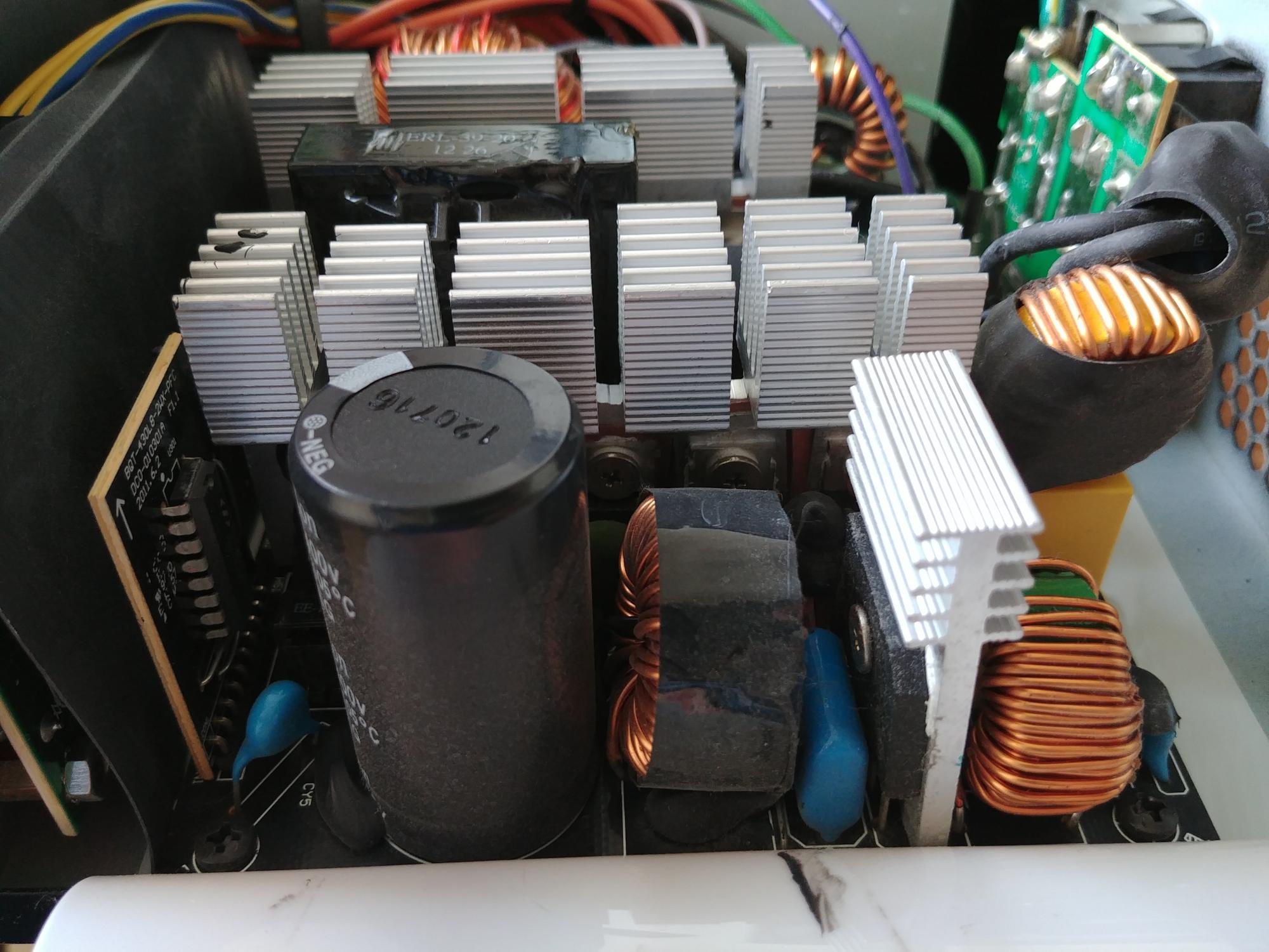

                                          #1520

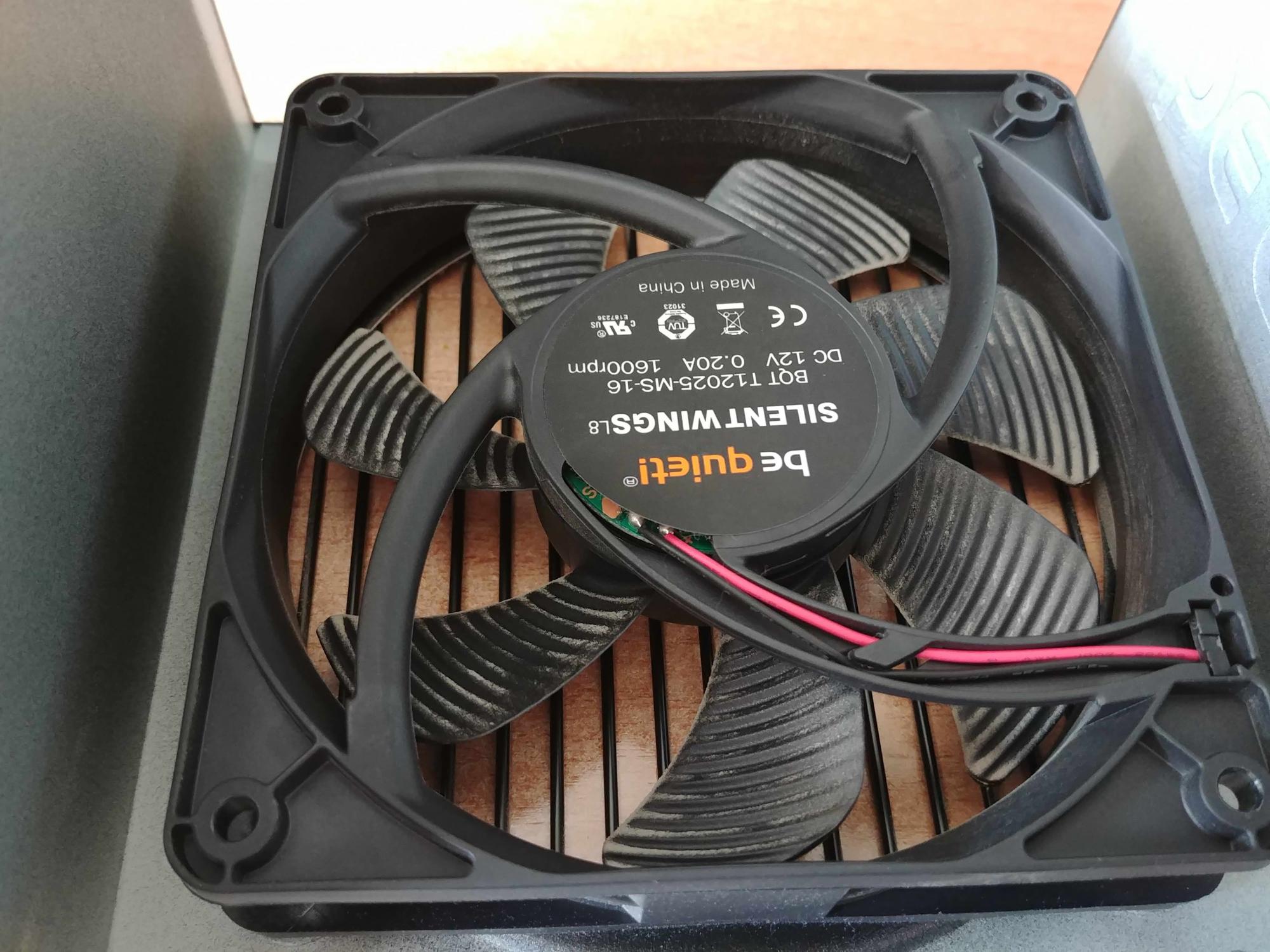

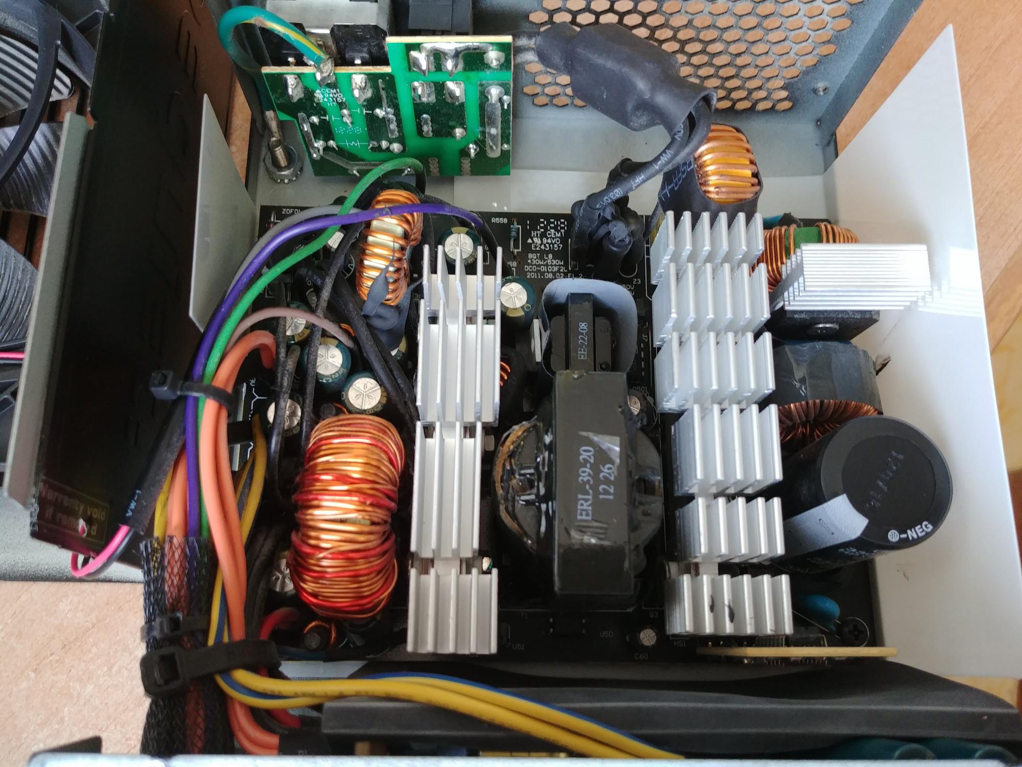

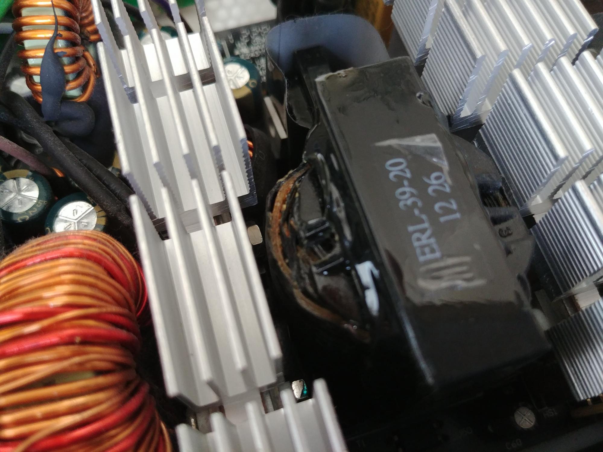

                                          Hello, I share these photos of this PSU Be Quiet Pure Power L8-CM-530W 80Plus Bronze, which I took from a Spanish forum, the photos belongs to bmdm (he granted me permission to publish his photos), I do not say the name of the forum to avoid spamming.
                                          The fact is that this source ERL39 burned the coil, how is this possible? I had never seen anything like it.
                                          Its owner, began to realize that the source began making strange noises, after a while the system was turned off, and came a moment that began to give errors on the HDD, and eventually stopped working.
