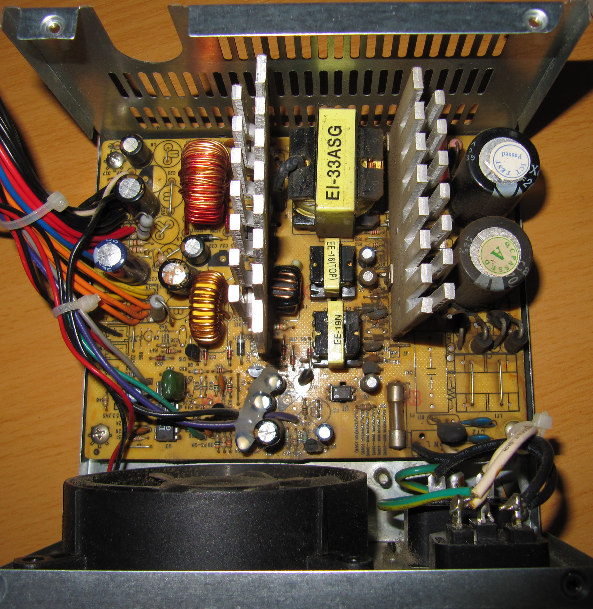

      Allied Premier DR-B350ATX (MAX 350W)
      First, I thought someone tried to recap this thing and he used a mix of different capacitor brands (Samxon, Suscon, Chemicon KY and more).
      But when I looked at the solder side of the PCB, I couldn't find any difference in the soldering technique of the caps and other parts, so I can't offer any explanation..
      Btw the psu uses 2x TT2146, similar to 13007, it has 2 diodes on a bracket for 12V and the same output voltage filtering with the previous L&C power supply.
      And it's dead: 5vsb only
      The fan is the typical 80mm Sleeve bearing Globe fan.
          Is it just me, or has that "2003" control IC gone poof?
          -Ben
          P.S. Looks like you struck gold ... er, brown, crispy gold.
          Those cheapo PSUs are probably good for 200W max, and even then that is pushing it, especially if you are drawing more than 5 or so amps on the 12V. (For the 2-diodes-on-a-bracket type)
          As for the one with the bloated primary caps ... you should possibly check the leakage current, and the balancing resistors. It's possible that one cap failed with high leakage current, and then over-volted the other cap, causing both to fail. Or, it might just be the usual crappy caps.

            Same goes for the Allied Premier DR-B350ATX. At least both of these units have better heatsinks, enough output cap spots, and better output toroids (more turns, at least).
            Still, is it worth it?
            I doubt it. Though many years back when I first started visiting Badcaps.net, there were a lot more people fixing up these crappy PSUs that now. Nowadays, the price of a new (good) PSUs isn't that high anymore. Moreover, the market for used OEM PSUs (like Delta, HiPro, and LiteOn) has been flooded, thanks to many offices and schools changing their PCs every 3-4 years (if even that many).
            Unless you repurpose them for old retro machines or simply for the fun of fixing them.
            And for the record, the Allied above isn't worth it. The heatsinks on that one are MUCH MUCH thinner than the JNC. I know that because I have an PCB exactly like that, and not only a few EXTRA spots for inductors (for example the L2 inductor near 5vSB) but the heatsinks are paper thin.
                    -Ben
                    Good call! Yes, that PWM controller definitely looks toast. Perhaps the 5VSB goes wonky with a load? Or the main supply did and sent overvoltage to the PWM.
                    Yeah, I saw that.
                    But the heatsink thickness isn't as important as the surface area. The JNC and the Allied above are the only ones that have fairly tall heatsinks. All the other units have laughable heatsinks.

                                Speaking of Deers, here's a unit I've worked on. Transformers aren't the original ones, they came from another Premier (LC-B400ATX, 400W) that surprisingly had beefy transformers (look at the sizes!) but the rest was paper thin. And yes, I can 100% confirm the main transformer in the pics is a ERL-35 transformer.
                                Critical cap was replaced with a Nichicon (don't know the series yet but it's a low ESR cap from a Delta PSU that I killed) from 2009. If needed, I can open up the PSU up again and check the cap, and the capacitance. Main primary caps are 470uF 200v Fuhjyyu LP (though I might replace them with some big Saturn 470uF caps) and 5vsb uses 2 Panasonic FL 1000uF 16v caps.
                                Might get some D209L switching transistors, find some good parts for the secondary, maybe a good Xinruilliam or Jamicon fan ( those are pretty good and besides, I'm not going to waste a Sunon leafblower for it.) and be done with it.
                                How many watts would you think it can output in this state? (given I install D209L switching transistors)

                                  300W max.
                                  If you install 680uF 200V capacitors, maybe it could do 350W, but I don't think it is worth it.

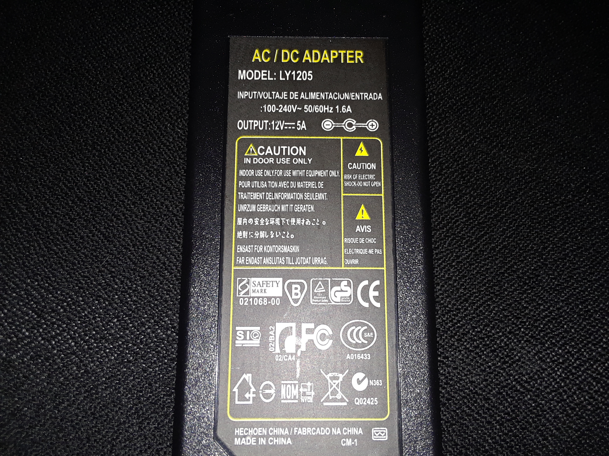

                                    I was given a 12v 5a power supply to repair and i was not going to post it here until i saw a major design flaw on the secondary side which made me want to post it.
                                    Label...
                                    Not promising.
                                    Top side...
                                    Does not look that bad but it's definitely not 5 amps.
                                    under side...
                                    Looks okayish.
                                    Primary side...
                                    Not bad, at least it has some filtering on the input and a real fuse.
                                    The primary capacitor is a Taicon AS 47uf 400v.
                                    The bootstrap capacitor is a Taicon HW 33uf 50v.
                                    The switching mosfet is a CS2N60F mounted on a paper thin "heatsink".
                                    Secondary side...
                                    At least it has some output filtering.
                                    The diode package is STPS3045C mounted on another paper thin heatsink. (if you can even call it that)
                                    The three capacitors are Taicon HK 1000uf 10V! (Not, that is not a typo, these are 10v capacitors on a 12v supply )
                                    That's it, i don't think i'm going to repair this thing as it's a piece of crap.

                                      looks like a resistor was tacked on to adjust for 12v.
                                      you might be surprised to see how long it lasts. if the caps were decent they may reform ok to 12v.

                                        The resistor is for the LED and the output voltage is extremely unstable making this power supply almost useless.
                                        I'm not a expert, I'm just doing my best.
