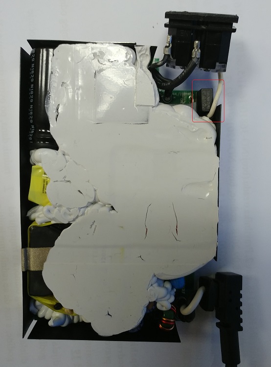

    Hello electronics experts,
    My lenovo 135W charger ADL135SCC3A failed days after the warranty is expired. With some effort I open the adapter without breaking the plastic and found that first input fuse T4A 250V is blown. This is the first components at the charger grid input and there is a good chance that it protected the rest of the circuit from the external overvoltage. Input is 100-240Vac, 2.5A, output is 20V, 6.75Adc.
    Replacing the fuse is trivial, but I wonder if there are some other components I need to check just in case that the fuse is blown due to some malfunction inside the adapter.
    Most of the components are covered with some kind of rubber/silicone material and it is very hard to approach them.
    Did you have any similar experience?
    Any advice is welcomed.
    Thank you!
    P.S. Notebook is Ok and the battery is charging normally with another adapter. This charger was needed because of the Dock station.
    Maybe I made mistake, most of the time adapter was plugged to the power grid even when not used.
    Maybe I should have kept it unplugged when not used.

    Are there any swollen capacitors, post some pictures .

        Check the primary side 450v capacitor, it could be bad:

          Hello guys and thank you for the replies. It's really hard to make any useful picture. Practically the only component I had access to was bad.
          The lower part has metal casing that is soldered into PCB board. I need to remove this first to check for the big capacitor.
          I don't know what is the English word for this white material that is used to cover the components. It is very hard to remove.

            In one AC adaptor I have handled, the X-class EMI filter capacitor has failed short circuit since the density of the capacitor was a bit too high for a particular manufacturing technique.

              It's not that easy to dig out components to measure, this would be more significant effort. The fuse is replaced but blown again immediately when power is connected. The replacement part is ordered. This one will end up in the garbage. They made it in such way to prevent any repair.

                Yeah this is generally called "potting material" and whether it's a thermoplastic or thermoset plastic/silicone rubber is the question, usually the latter for thermal stability.
                If it's soft, you can slowly pick at it; if it's hard, yeah, that's virtually EOL.
                Appears that Per Hansson got lucky with less potting, in your case you won the prize...
                So much for throwaway electronics. *sigh*

                  Usually when the fuse is blown probably the main mosfet has failed and also the main bridge rectifier is gone. The main cap can also be gone for age and heat.
