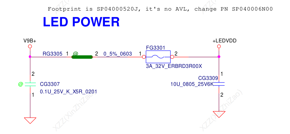

    Hello dears, On a laptop LENOVO IDEAPAD 5 15ITL05 there was a mistake,
    the screen flex came out without removing the battery first, resulting in the screen brightness being lost. Usually a fuse is off.
    the fuse FG3301 is off, does anyone care how many amperes it is, thank you very much
  • mon2
    • Dec 2019
    • 14634
    See attached.
    Panasonic part # ERBRD3R00X
    3A current; 32 volt in 0402 SMD size.
    ERB-RD3R00X Panasonic Electronic Components | Circuit Protection | DigiKey

      Thank you for your prompt response, mon2
      Yours sincerely
