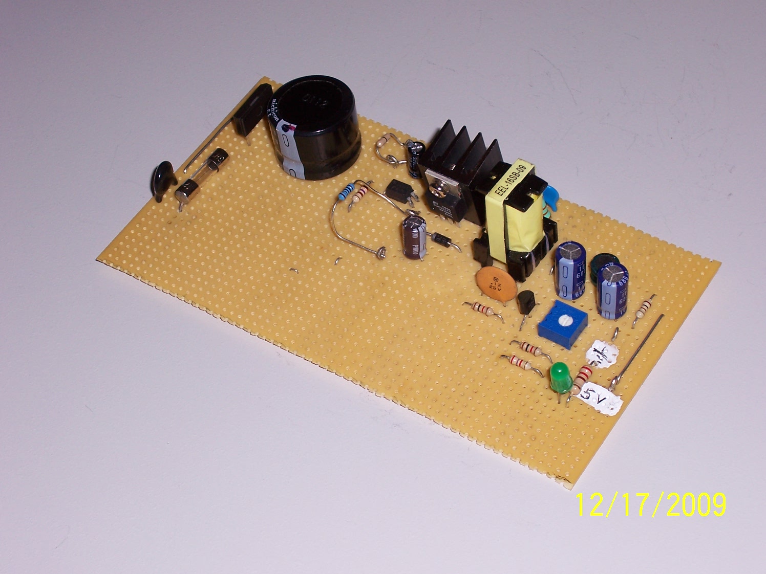

                          The reason I wanted to do ESR testing on the TOP-Switch TOP222 is because it looked like it had a "critical cap" like the two transistor design. Take a look at my drawing comparing the two transistor circuit to the TOP222.
                          The two transistor drawing shows only SOME of the basic components (taken from Bestec ATX-250 12E) and the TOP222 drawing shows SOME of the basic components (taken from the Enhance EHP-0735).
                          The critical cap in the two transistor circuit is C1. By inserting a resistor in series with this capacitor to simulate esr, you can see a definite increase in the 5vsb rail voltage - upwards to 17 volts or so. The capacitor in the TOP222 circuit which looks like it should be a critical capacitor is C4. I used resistor values of 6 ohms, 12 ohms, 25 ohms, 50 ohms, 100 ohms, and 150 ohms to simulate ESR. With each resistance value tried, the 5vsb stayed locked at 5.00 volts. Next, I simulated an open capacitor by removing the capacitor from the circuit. The 5vsb went up to 5.26 volts.
                          Next, I tried all of these resistor values as ESR in series with the capacitor C5 at the control pin. The circuit powered up and worked, locked at 5.00 volts. Only when I went to a 200 ohm resistor did it refuse to start.
                          In conclusion, the location of the C4 capacitor in the TOP222 looks like a "critical cap" which would cause problems with aging and esr, but test results showed otherwise. I could make the circuit stop, but I could not make it go overvoltage like the two transistor circuits do.
                          I still prefer the DM311 circuit, but I have nothing bad to say about the TOPswitch series of pwm chips for 5vsb circuits, and would not replace it as I would a two transistor circuit.

                            between dm311 and topswitch (for a 5vstby mod) i would pick the one that requires less external components...
                            i would think reliability and durability(and preotection form 5v going too high) is about the same, ie pretty good.
                            >I thought about modifying a psu by inserting a TopSwitch where the power transistor is installed. But......pin connections are such that I would have to do a lot of cutting out circuit traces and rewiring.
                            doesn't need to be connected there at all...i mean your dm311 addons are not pin compatible either...
                            <wink>
                            interesting experiment there with breadboard...keep us up to speed about the progress there...ie how much esr shuts it down....
                            btw. did you do the same test with dm311?
                            edit/ ough, that was fast...glad to see you proved topswitch is safe too...

                              Good evening i4004 - or at least it is evening here!
                              I did not do any esr testing on the DM311 circuit because it doesn't have a capacitor in the feedback circuit. Take a look at the schematic I posted earlier. The feedback hooks directly to the collector of the optocoupler and the emitter of the optocoupler goes to common (AC ground). The only aluminum electrolytic capacitor in the DM311 circuit is the filter for VCC. As regards VCC, it either works or doesn't. I have thought about using a tantalum capacitor in this location, but have not tried yet.
                              As for the TOP222, I was concerned that it might have the critical cap problem like the two transistor circuits. So far, that is not the case.
