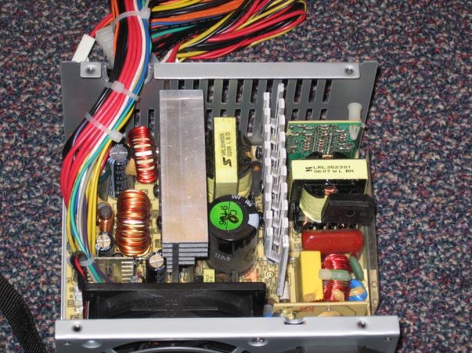

                  My bad, Toast. I just checked again and I think all of the ones you specified are available, though there are only two left of the EEUFM1A222 (10/2200). I see that I didn't find some of the ones you listed, such as the EEUFM1A332 (10/3300), because I originally specified diameter as 15 and a little above. With a smaller cap I'll have to bend the leads, I think -- it seems that 15 mm diameter and a little above usually have 7.50 mm lead spacing and the 12.5 mm diameter ones have 5.00 mm lead spacing. I was hoping to use caps in roughly the same size, though things are a bit tight in the PSU. Guess I'm just anal about such things, or perhaps neurotic.
                  I'm attaching a couple of "before" photos.

                    Re: Questions on recapping a Seasonic SS-300FS
                    give a direct overhead shot.
                    that thing may be punched out for 12.5mm
                    i did one os the ss series and 12.5 fit fine.

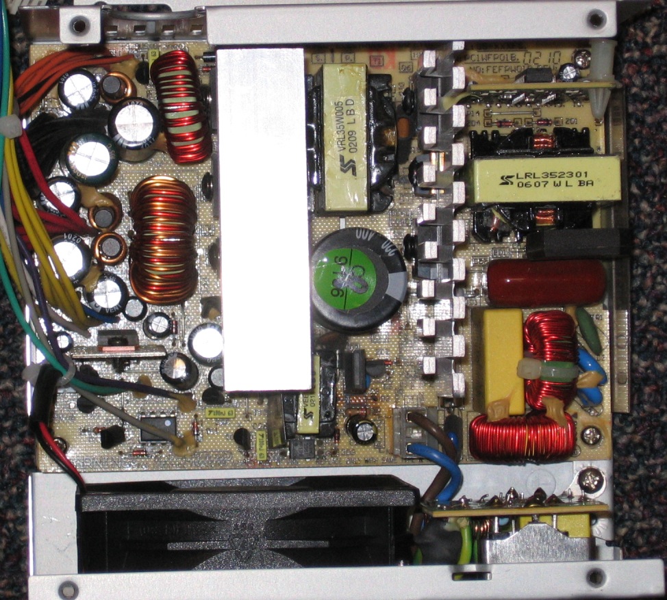

                      Once you get the caps out it might have holes drilled for the smaller pitch already. Sometimes the board maker does this so if they run out of one size they can switch easily to another. I'm also one to drill the board if I need to make a component (not just caps) fit.
                      Please take a shot of the area near the mains cap where the smaller transformer is? I want to see the 5vsb area and surrounding components.

                      • tj2
                        • Oct 2009
                        • 85
                        Here's an overhead shot and one from a more oblique angle. I notice that there is a missing diode near the OST cap in the middle of the board, where the 5 Vsb presumably is. The board is discolored there. This unit is supposed to be new (it was sold to me as new by hypermicrosystems), so if that's true it must have come from the factory this way. If that OST is in the 5 Vsb section, it must be more important to have a low ESR, high ripple cap there.

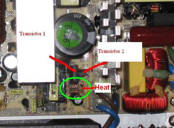

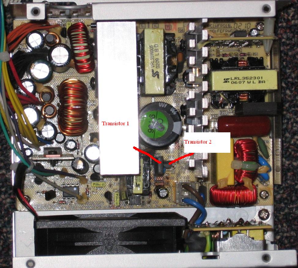

                            Is that the 2 transistor 5vsb!?!
                            I'm not the egghead on this. Where's Everell when you need him.
                            He's probably nodded off again. Ya gotta keep on the elderly...
                              I'm not too sure on this, but I think it is
                              • PCBONEZ
                                Grumpy Old Fart
                                • Aug 2005
                                • 10661
                                That should be right.
                                Note burnt PCB right there too.

                                • everell
                                  • Jan 2009
                                  • 1514
                                  I would have to agree with 370forlife - he has done a good job of pointing out the two transistors. On the left side of the left heat sink, there is what looks like a bulging capacitor next to the violet (5vsb) wire. I would therefore predict that the "critical" cap between the two heat sinks is high esr already.
                                    Yes, that burnt spot has me puzzled. This is supposed to be a NEW unit, so I didn't expect any bad signs other than possibly bad brands of caps. The spot where the burn is has silk screening for a diode and there are pointy wires coming up at that spot, but no diode. I'm going to have to go back to work to check whether that's a large transistor there. If this is the dreaded two transistor 5 Vsb circuit, I'm going to want to modify it further to remedy that circuit! Rats, I was thinking that the bulged cap was the only real problem!
                                      Everell does a mod to completely cut out the 2 transistor 5vsb circuit and add a better circuit, he can explain.
                                      That missing diode may have been a problem causer in the design, large quantities of these units may have been sent back via RMA to seasonic and they made the modification to remove said component and re-sell them as refurbished. I have a couple of newton psu's that have the "ripped off" resistors and such. Probably quick changes to save a few.
