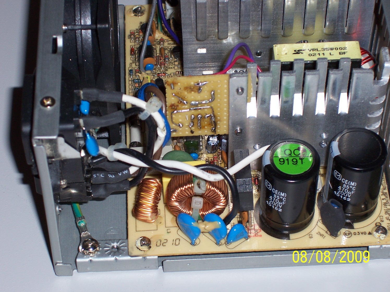

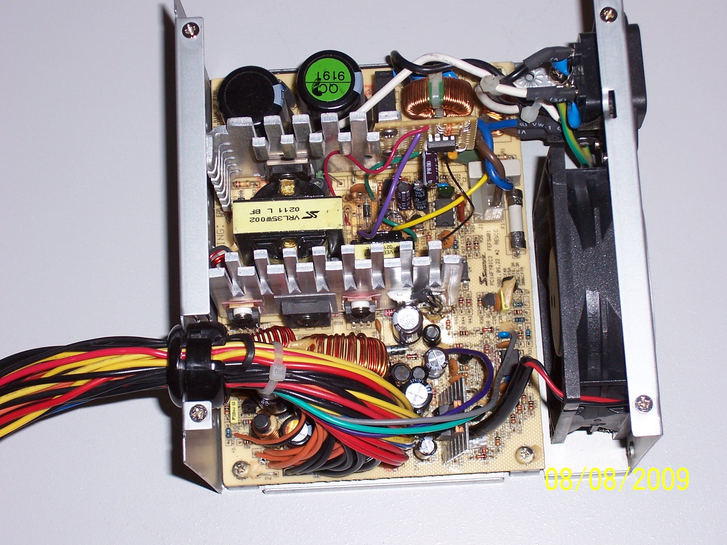

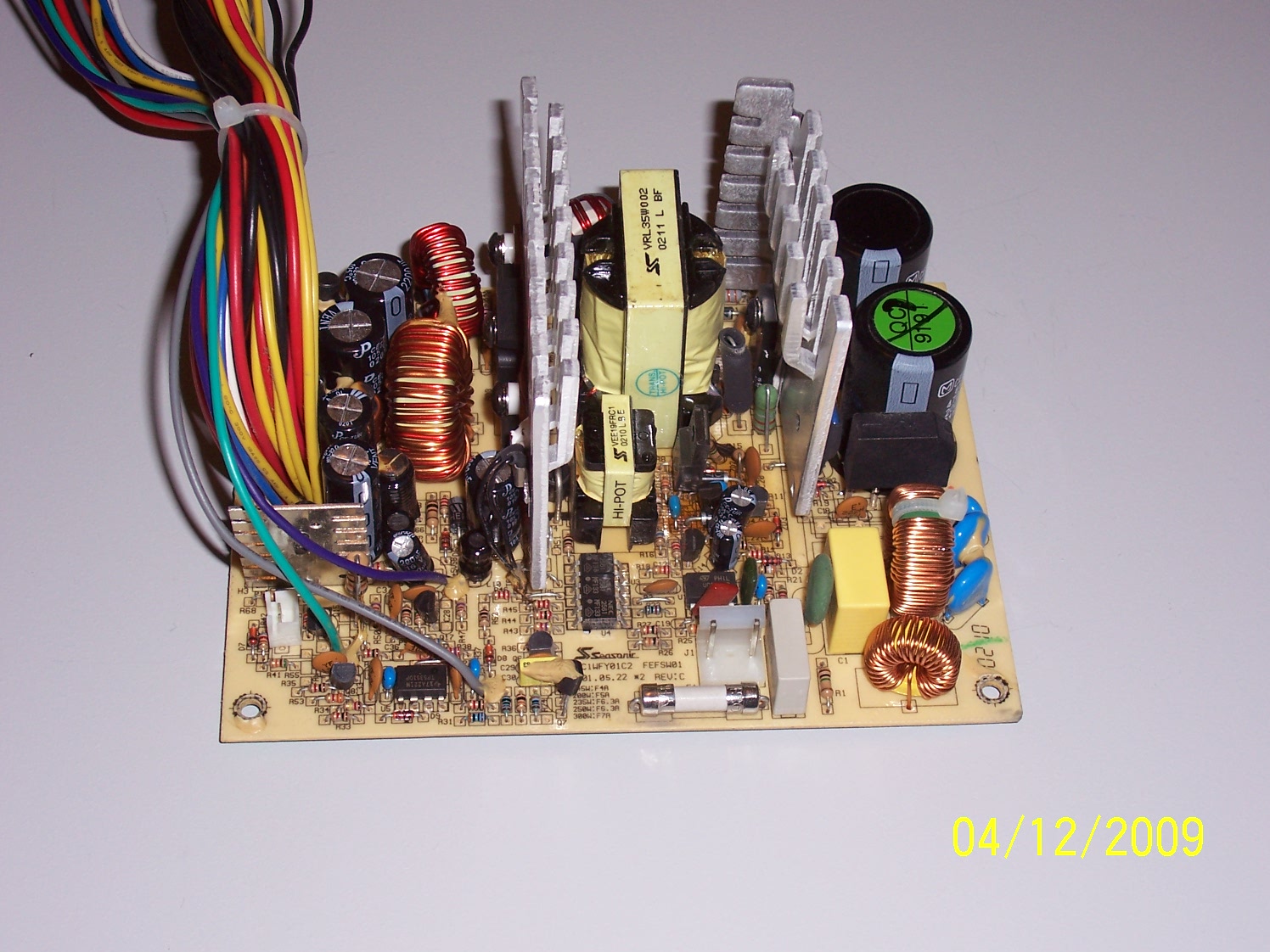

                                      This was my SeaSonic SS-250FS before modification. It does not have APFC. The 5vsb was measuring around 10 volts.
                                      Old proverb say.........If you shoot at nothing, you will hit nothing (George Henry 10-14-11)
                                        #39
                                        Re: Questions on recapping a Seasonic SS-300FS

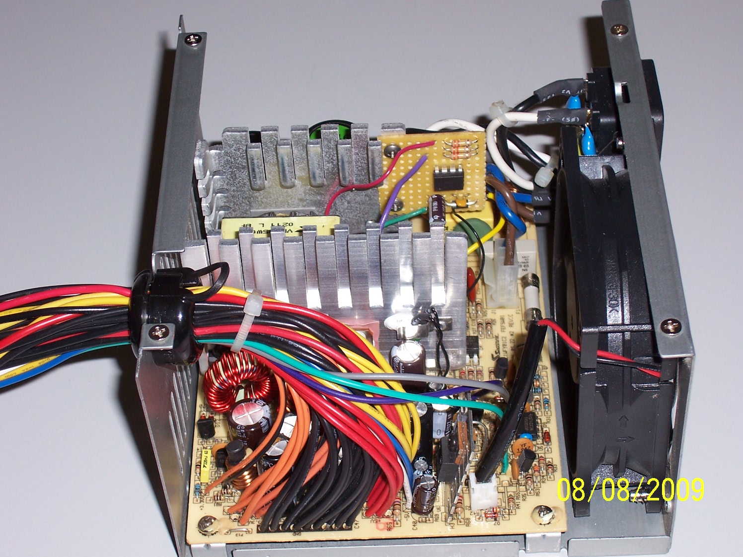

                                        Here it is after modification
                                          #40
                                          These are my notes on the modification
