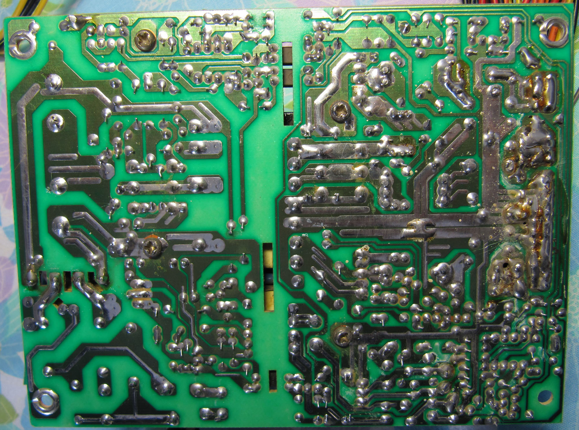

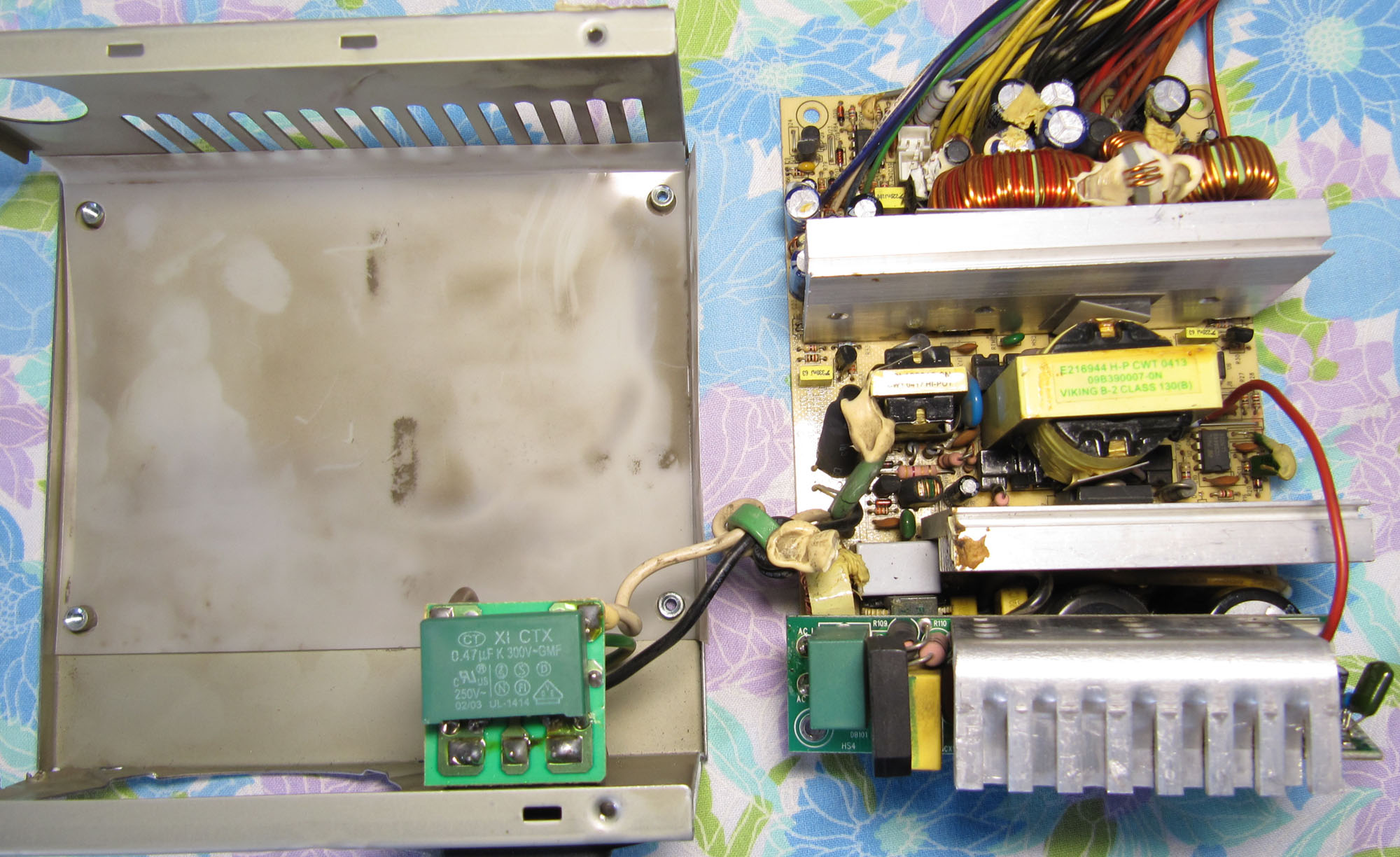

    Today I went at university storage department and I had there over 30 psus to check (and take whatever I liked). Among them there were 2 antec, clearly the best, theoretically at least...
    The 2 antecs were identically same: SL450P Smart Power 450watt output.
    The first one did not work at all, no output voltages or fan movement.
    The second one when connected to AC with the psu on sorted with ground, it exploded with a loud sound and sparks coming from inside.
    I got the first one home and opened it... Nothing seems to be bad. Crappy caps everywhere but noone bulged or leaked or exploded. Psu is brand new, has no dust in it... Maybe they got it dead on arrival.
    I upload some photos to see for yourselves. Do you know possible failure reasons?

    PSU has seem some use, not brand new. If you look carefully there's a very light coat of dust at various places, especially on the fan blades and the primary caps.

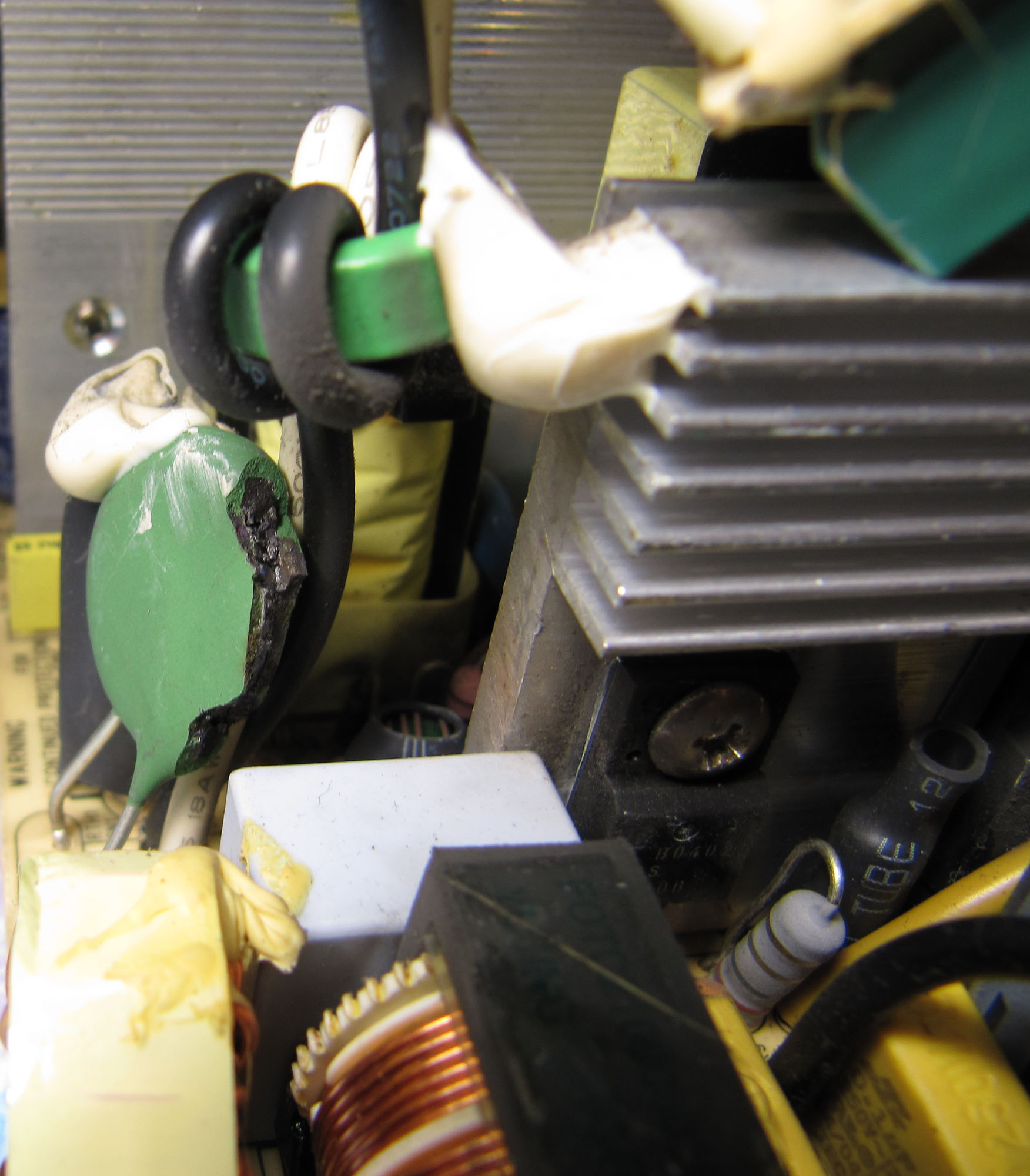

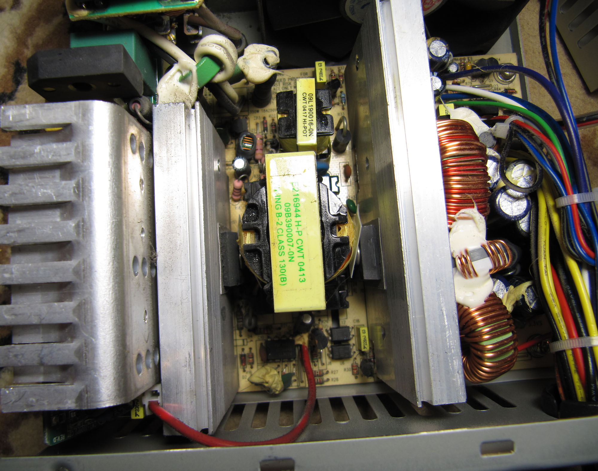

          weirdlookinguy you are absolutely right...
          I think I found why its dead. See the MOV...
          Also, are these traces of water in the backside of board?
          I guess I have no choice but return it.

            Not MOV, PTC current limiter. Probably shorted primary switchers or bad mains caps, or both.
            Not water. Flux residue from solder process.
              It's a NTC actually (resistance decreases with increased temperature).
              If fuse is intact, replace the burned NTC with one from a junk PSU. Sometimes those NTCs burn out for no reason. Replacing them usualy makes the PSU work fine again after that. If I remember correctly, etnietering here had a similar problem with a cheap Logisys PSU.
              If fuse is blown, don't bother with it (i.e. use for parts only).

                Yup, NTC. Thinking of TV degauss again... DOH!

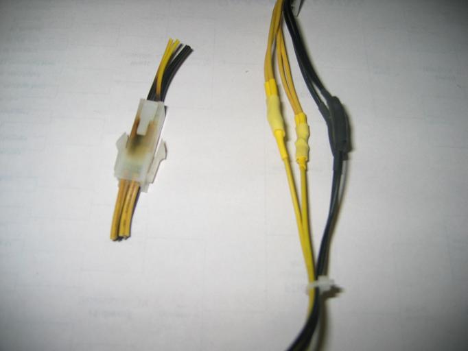

                    well, turns out I didn't get a picture of the blown CIL, but I did take pictures of the nicely toasted ATX12v -> EPS12v adapter...
                    and here is the adapter-ectomy I performed so that the computer would run again:

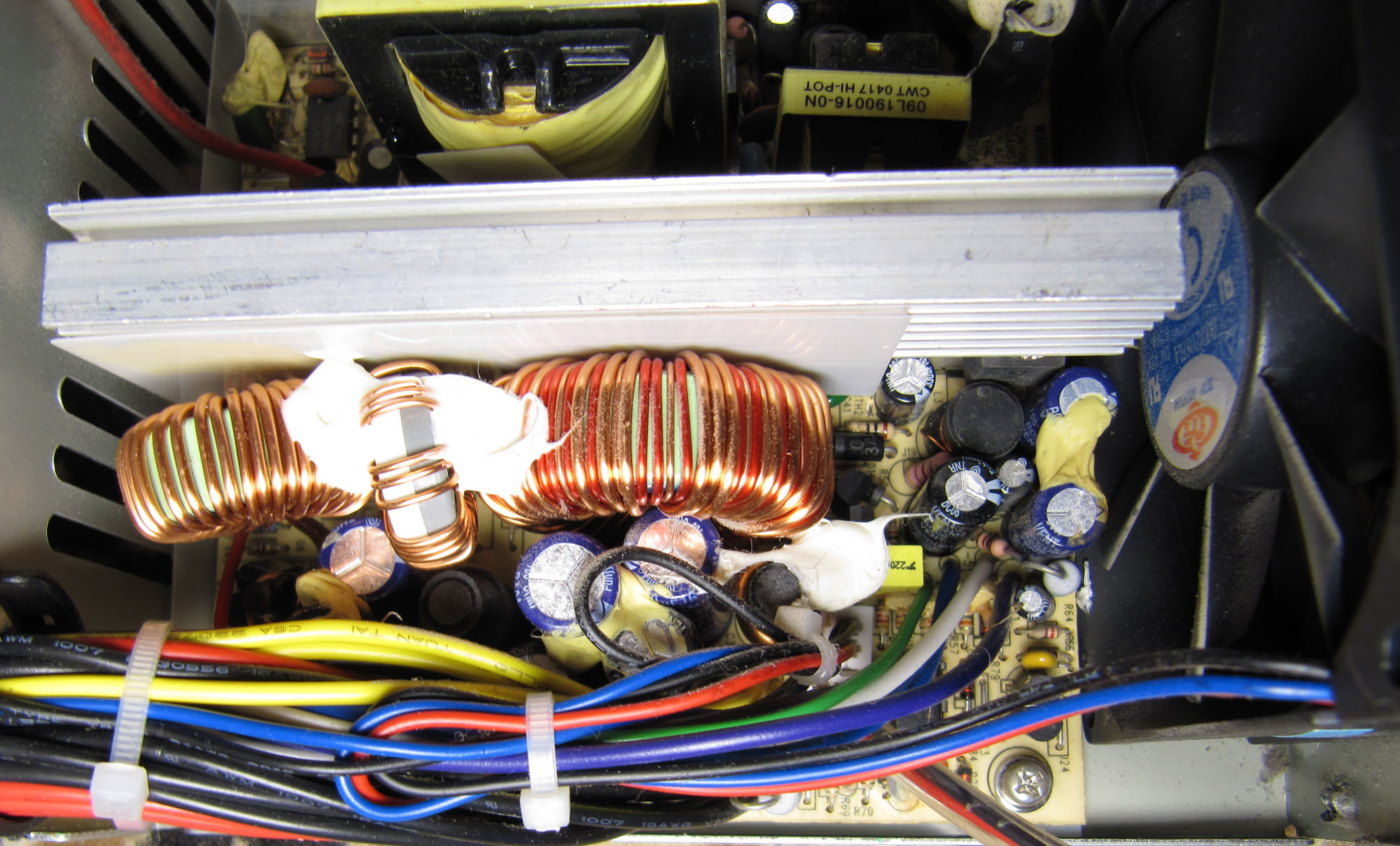

                              How did you determine the cap was shot? Also there are two caps on the primary of passive PFC switching supplies active PFCs only have one.
                              With a major short like that probably either the bridge rectifier (one of the internal diodes) or the switching FET is shorted.
                              You can't just replace a component plug it in and cross your fingers without checking the surrounding circuitry for the cause of failure or you could easily blow the parts you replaced.
                              I find it odd that the fuse didn't blow unless you've got a real sensitive circuit breaker reacting faster than the fuse or the fuse is faulty.

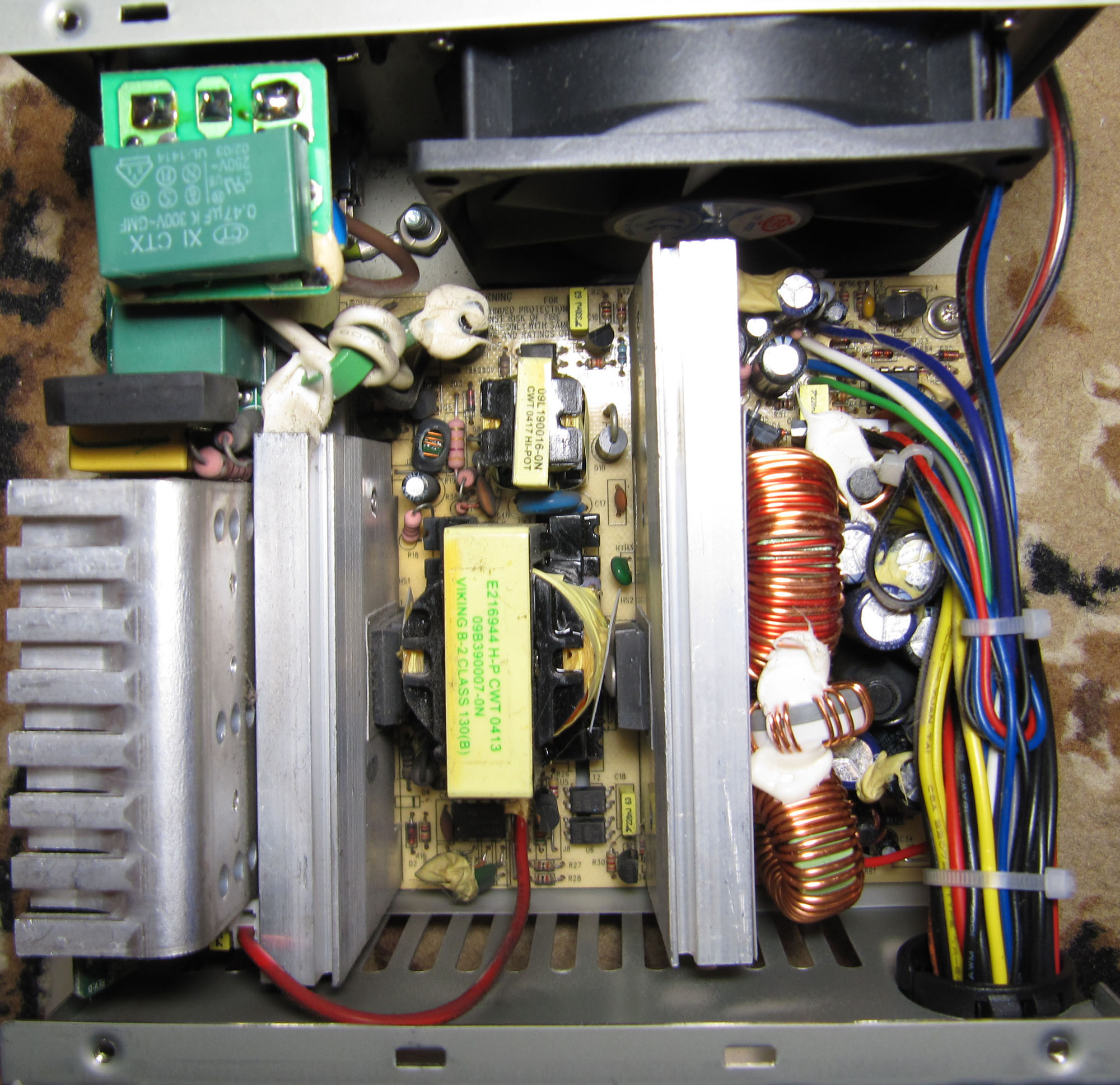

                                not in antecs
                                my TruePower 550EPS also has 2 200V input caps with an active PFC.
                                seems like antec just piggybacked an active PFC PCB on top of the area where the primary caps are and connected it to where the rectifier on a non-PFC model would be. probably went with an active one as there wasn't enough space for a passive one... poor antec couldn't cut corners here as they usually do (fuhjyyu anyone?)
                                makes me wonder if those PSUs weren't designed for the european market in the first place (PSU's without any PFC (active or passive) are banned in the EU)

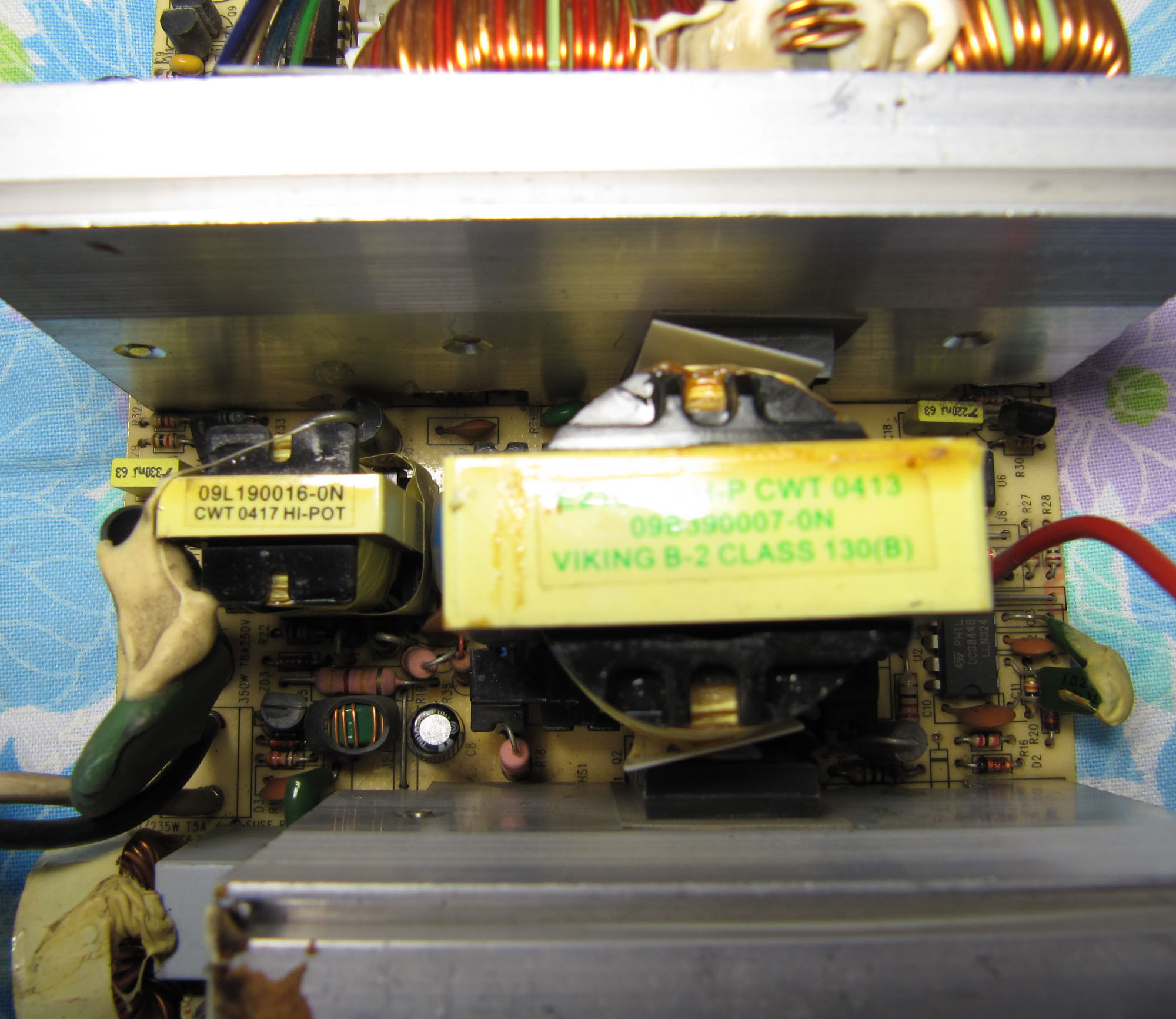

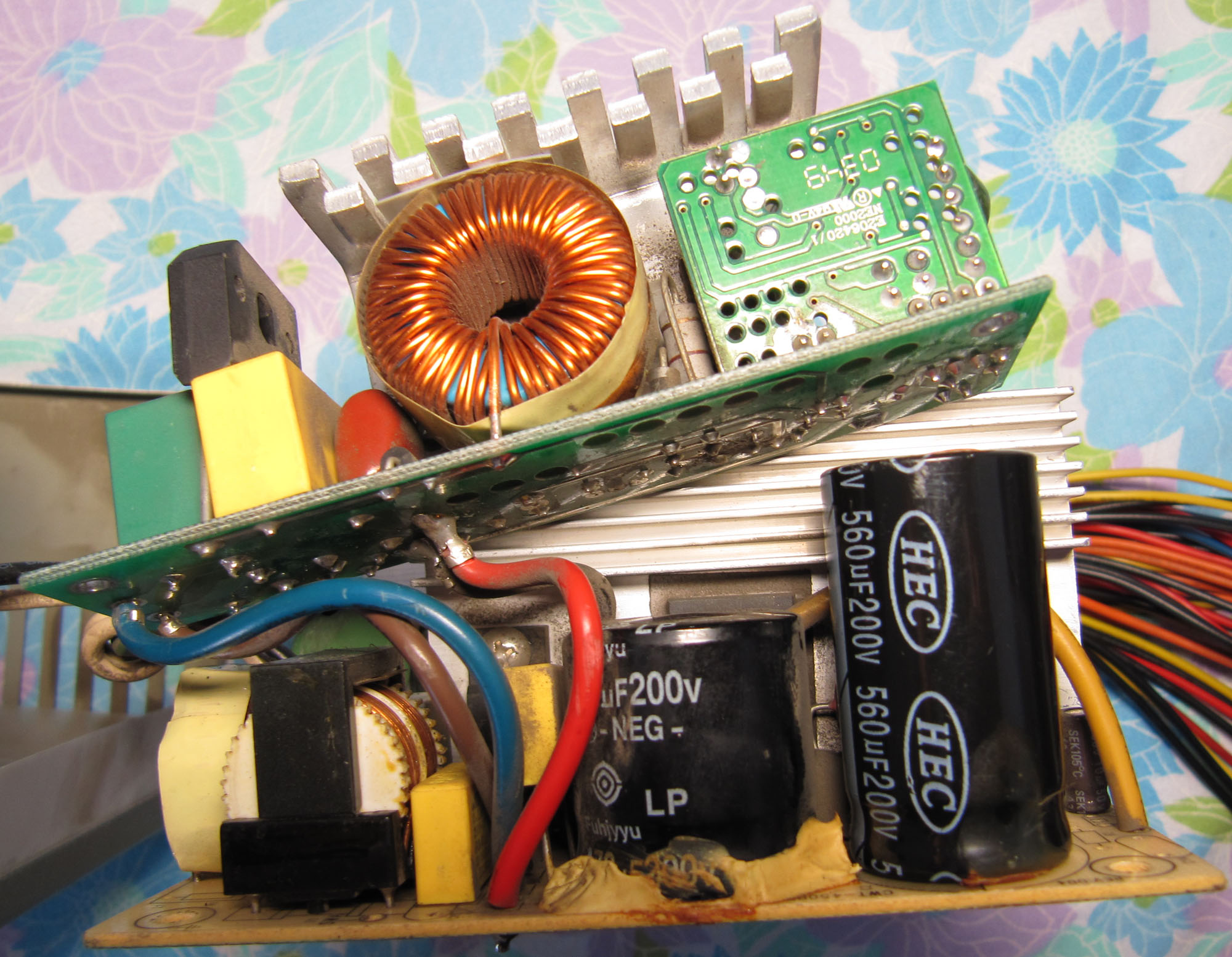

                                  I tested the cap with micro esr meter, and got esr:- (too high), capacitance: 0,1 when the other cap gave 420uF esr 0.12
                                  You can see in the photos attached that there are 2 main caps and an active pfc circuit above them.

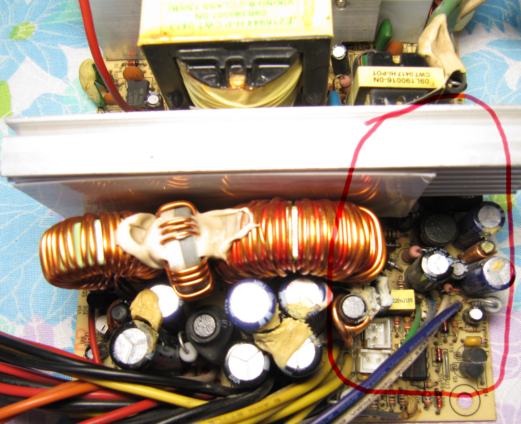

                                  Is there a way to check them with a multimeter and see if they are good or shorted?
                                  I am not sure, but I think the sparks came from the area marked in red in the photo.

                                    Yes, you can check FETs and diodes with a multimeter.
                                    To check a diode, measure the resistance across its terminals (or use diode check function), then reverse the probes and measure again. If you get a reading of a few Ohms or short circuit both ways, then the diode is shorted.
                                    For FETs, it's the same as diodes - check with multimeter between Source and Drain and see if there are any shorts.
                                    Keep in mind that if testing in-circuit, your readings may be inaccurate. For example, some PSUs have low-ohm resistors (I've seen as low as 4.7 Ohms) on some of the output rails. If you're testing an output schottky rectifier on a PSU like that, you will see this low-ohm reading between anode and cathode regardless of you measured it with your multimeter and you might conclude that the rectifier is shorted (when in reality, it might not be!)
                                    Therefore when testing diodes and FETs in-circuit, always check what the rest of the circuit does.
                                    *OR* if it's easier for you, just take the diode/FET out from the circuit and then check it.
                                    Like Krankshaft suggested, first check the bridge rectifier, then move in on the rest of the circuit (FETs, protection diodes, etc.). If the PSU is tripping your circuit breaker, it's more likely that there is something shorted on the primary side.

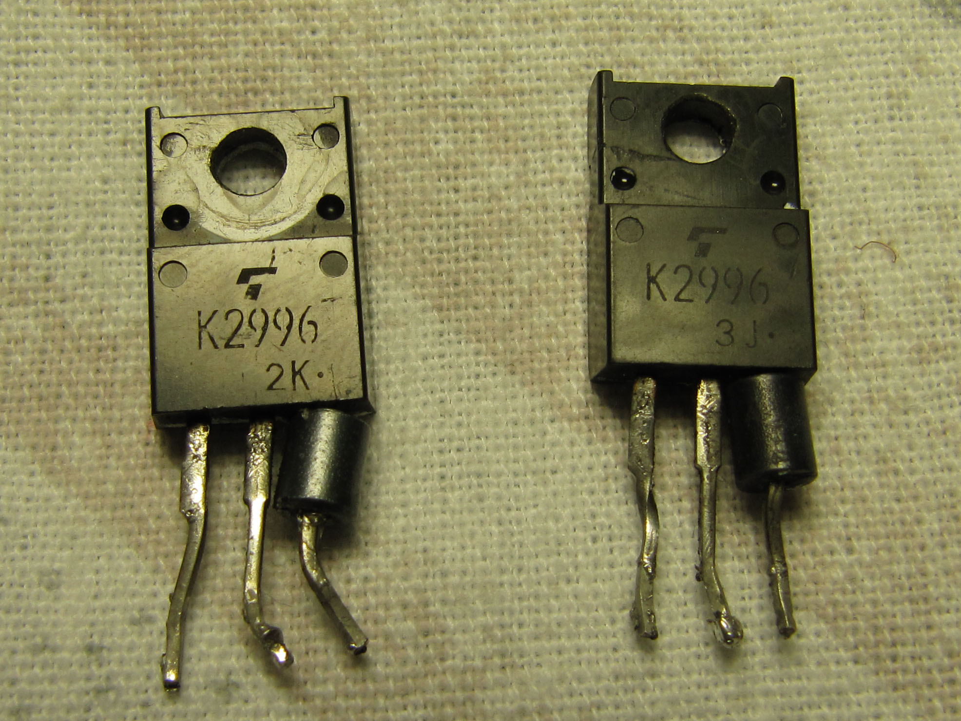

                                      I would check the APFC mosfet. I think it's quite a common failure in those psus. This is also what failed in my truepower 380w which has identical APFC board. I replaced it with another mosfet. When plugged in, +5vsb came on fine. When I shorted the ps-on with the ground the fuse immediately blew and replacement mosfet was shorted. Than i just replaced the wires that go to the PFC board with bridge rectifier. Psu worked fine. If you omit the PFC circuit like that, you would probably also need to increase primary caps capacitance.
                                      • goodpsusearch
                                        • Oct 2009
                                        • 2848
                                        • Greece
                                        Re: Antec SL450P Smart Power Exploded!
                                        Success
                                        I checked the fets and the bridge rectifier with my multimeter and found the apfc mosfet to be completely shorted!
                                        The mosfet is a 2SK2996 and I got 3 more of these that all came from the pfc circuit of 3 antec smart power 450w psus (or what have remained of them).
                                        Only 1 was found not shorted so I put that apfc on the psu I tried to repair and... the fan spins!
                                        All voltages were found ok, so I am going to make a recap list soon.
