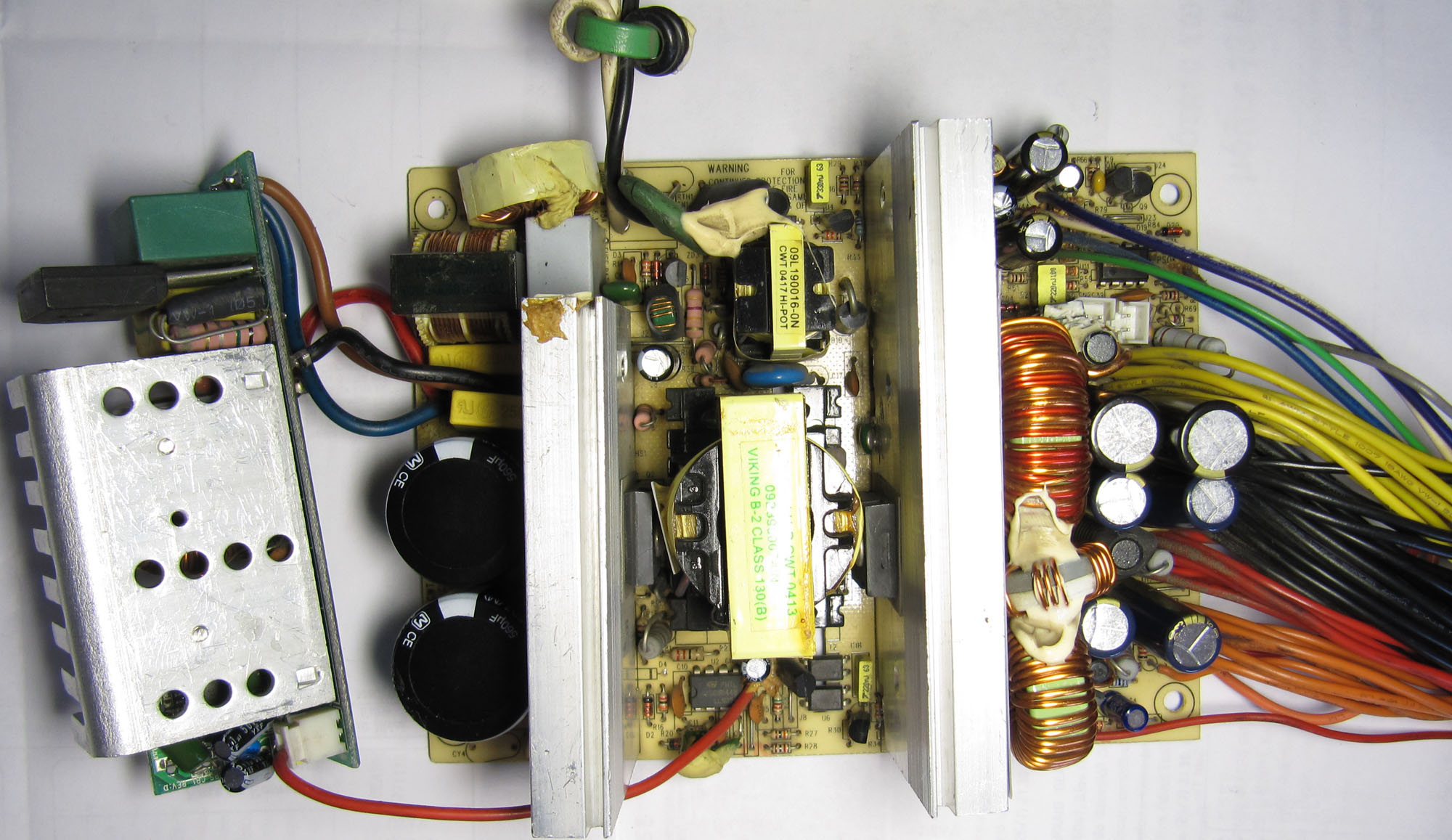

    Hello. I repaired and recapped 1 of 2 Antec Smart Power SL450P.
    I replaced every cap on it, including the 2 small caps of the pfc board.
    I was lucky enough to find 2x560uF 200V Panasonic caps to replace the "470uF" Fuhjyyu main caps. I also found a Panny bipolar 1uF cap that was needed by that psu.
    I added a 4 pin connector to make the psu compatible with 24 pin (20+4) motherboards.
    Last thing I did, I added 2 resistors in paraller with RTH2 to mod the fan controller so that the fans move faster. I tried 5.6 and 4.7kohm in parallel giving a ~2.5kohm total resistance.
    RTH3 seems to be an over temperature protection sensor.
    I attach photos of the psu.

      I tried to fix the second psu...
      I checked every single cap with esr/capacitance meter and replaced the bad ones, checked the schottky diodes and transistors for shorts and finally plugged it in, after putting a bridge rectifier in place of the pfc wires.
      5vsb should come up, but it didn't.
      I checked every component in the 5vsb area marked in the photo . Those with green are the ones that were tested and found ok. With orange are the ones that I was not sure if they were good, couldn't tell with my testing equipment and testing them on board. The bad part (marked with red) was a 4.7ohm resistor that was found open. I replaced it today and plugged the psu again...
      Sparks, loud noises and smoke worse than anytime before .... The room still smells burnt electronic parts..
      So, I don't think there is anything I could do for that power supply.
      The attached photos are for Toasty who wanted to see blown parts
      I am wondering what was the reason of that catastrophic failure...

        Re: Antec SL450P Smart Power Exploded!
        Was that opto blown before or after the "repair"? Huge chunk missing from the bottom.
        Thanks for the pics!!!
        EDIT:
        BTW: A low-ohm resistor is typically a "fuse" of sorts. Notice that the resistor you replaced is fed from the outside leg of the bridge rectifier. It's load is the transformer. That being blown is a clue as to a problem with either the trafo load exceeding the rating, or perhaps a shorted transformer winding.
          EDIT:
          The optocoupler was ok before the last attempt to power on, same as the other burnt parts...
          Maybe the 5vsb transistor was bad, even though it wasn't found shorted...
              I have had the same kind of experience when trying to fix those 2 transistor 5vsb circuits. You have to find and replace ALL bad components, or you end up putting pieces of transistor into orbit on the second power up! My secret is to gut the 5vsb circuit and replace it with a PWM IC (such as DM311) on an add-on board.
              I traced the circuit and drew what I had in my Antec SL400. Perhaps this will help you.
