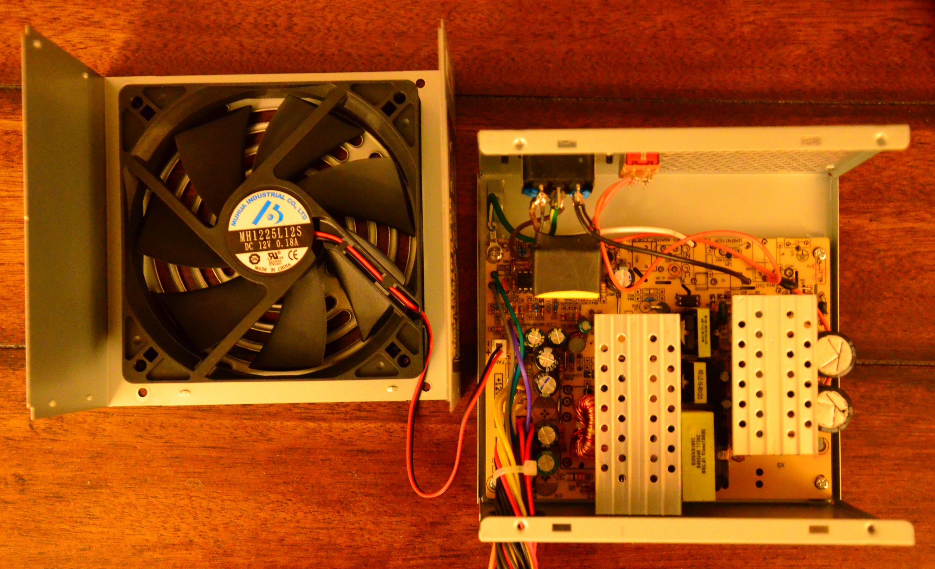

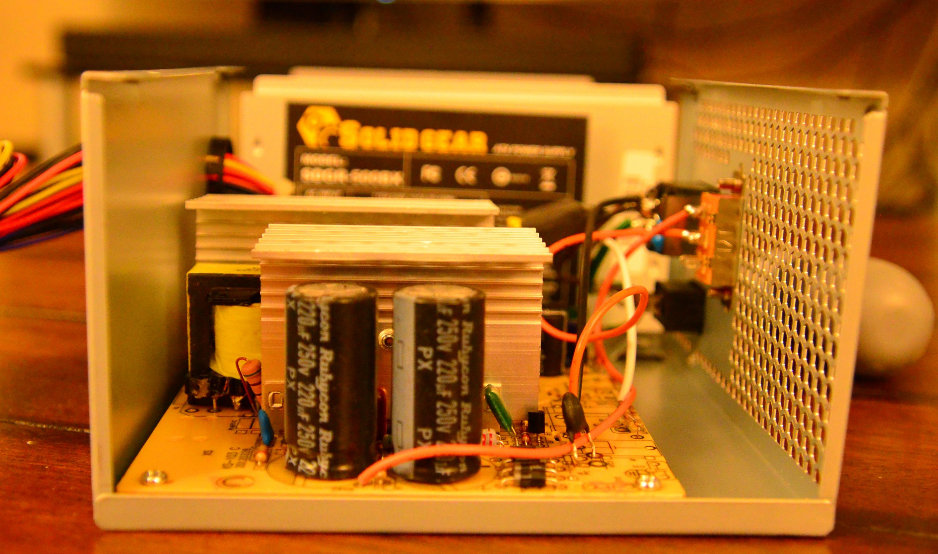

    Lets take a look inside. Oh boy, this isn't good:
    Primary has 2X "Rubycon" PX 220uf 250v caps (these caps look really old and dirty so they may be "recycled"), a pair of 13007 (8A 400V) transistors for the primary and a C3150 (50W 800V) on the standby. The input "filtering" (if you could call it that) consists of 1 x-cap and 2 y-caps directly on the mains connector. It is also using the 4 diodes treatment for the bridge rectifier.
    On the secondary side we have a Mospec F16C20C (16A 200V) ultra-fast diode on the 12V rail (hmm didn't the label claim 26A??), and MCC MBR2045CT (20A 45V) Schottky diodes for the 5V and 3.3V rails (and the label claimed 22A for these).
    Secondary Caps as follows:
    3x Jayi 1000uf 16v
    2x ZTLCon 1000uf 10v
    2x Jwco 470uf 16v

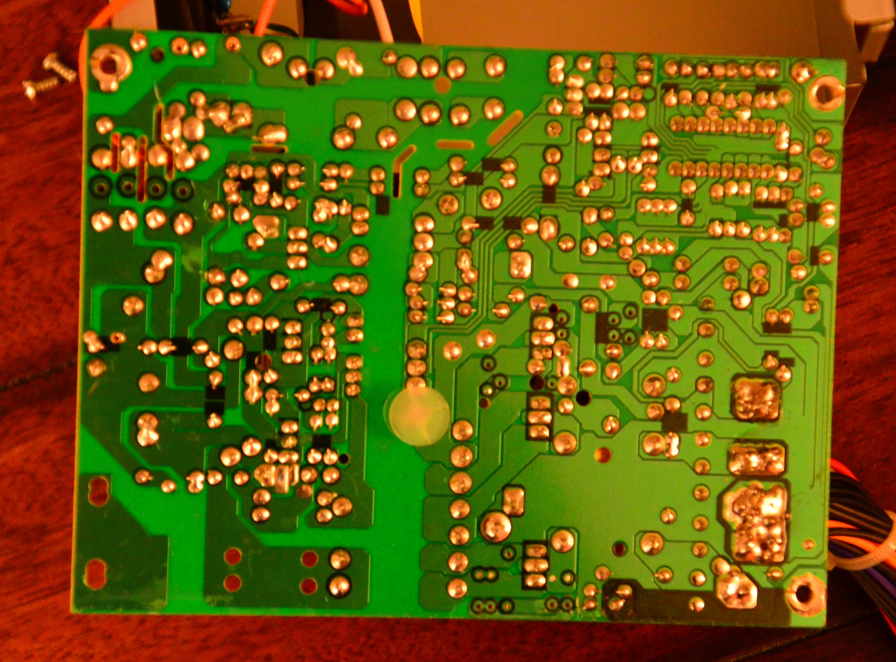

    Bottom of the board, not terrible for a cheap unit:

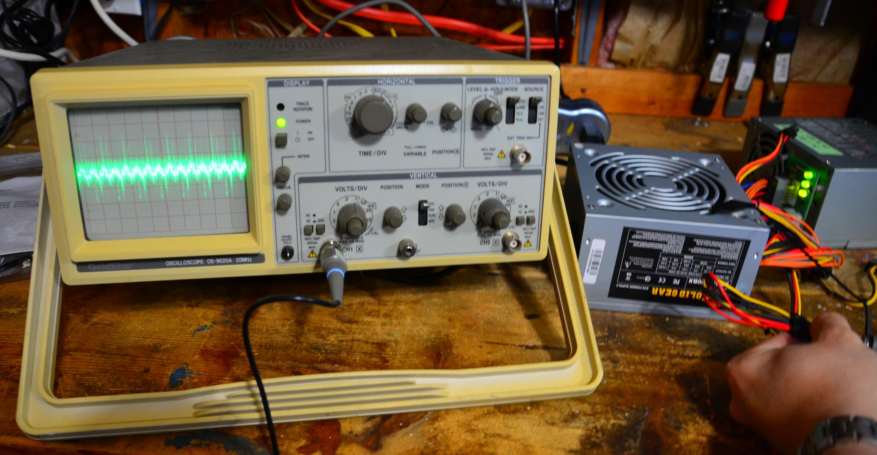

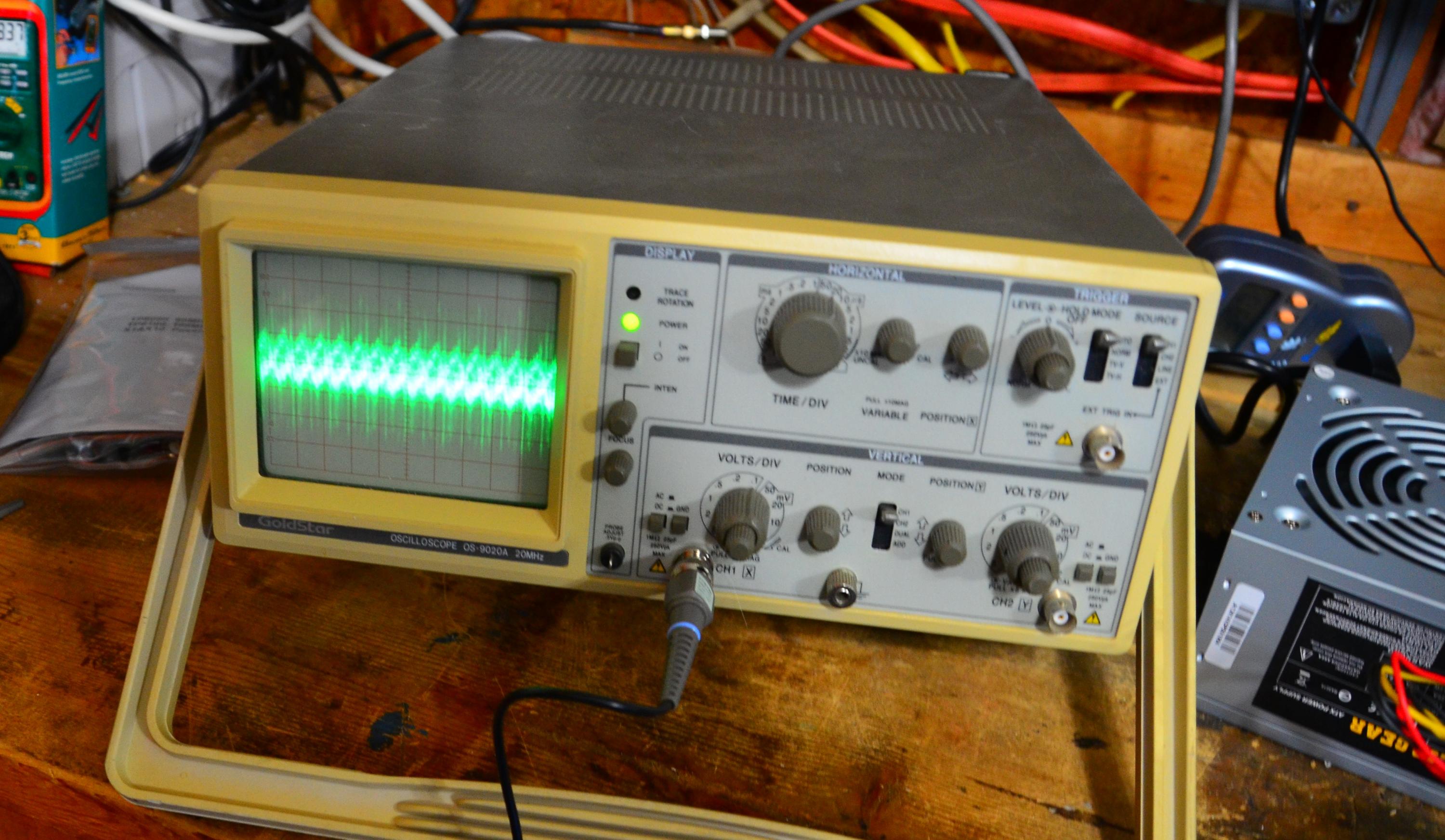

    Lets see how it handles some load:

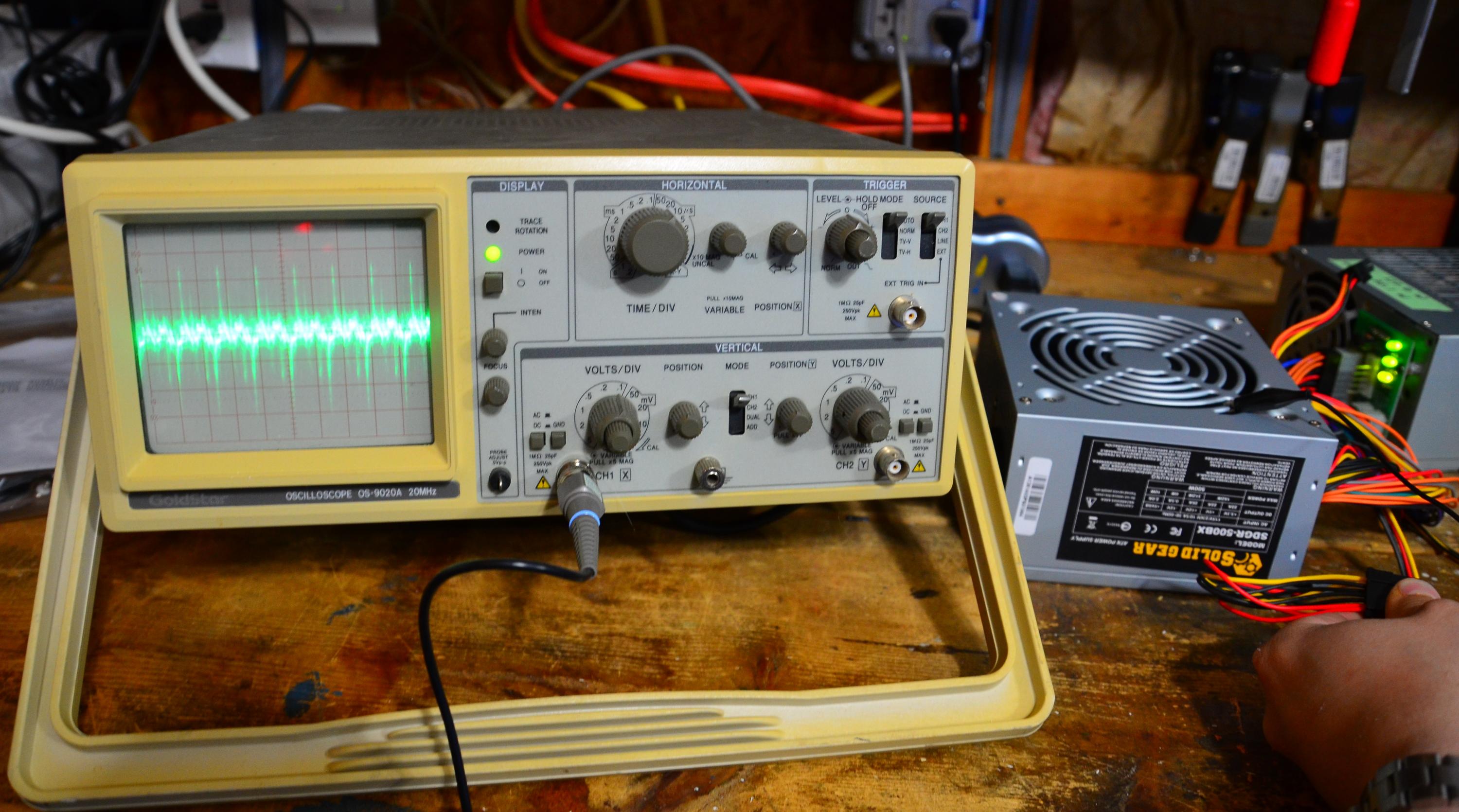

    Starting with the 137.6W load from my Seasonic power supply tester
    Note: the oscilloscope is set to the 100mV per division scale

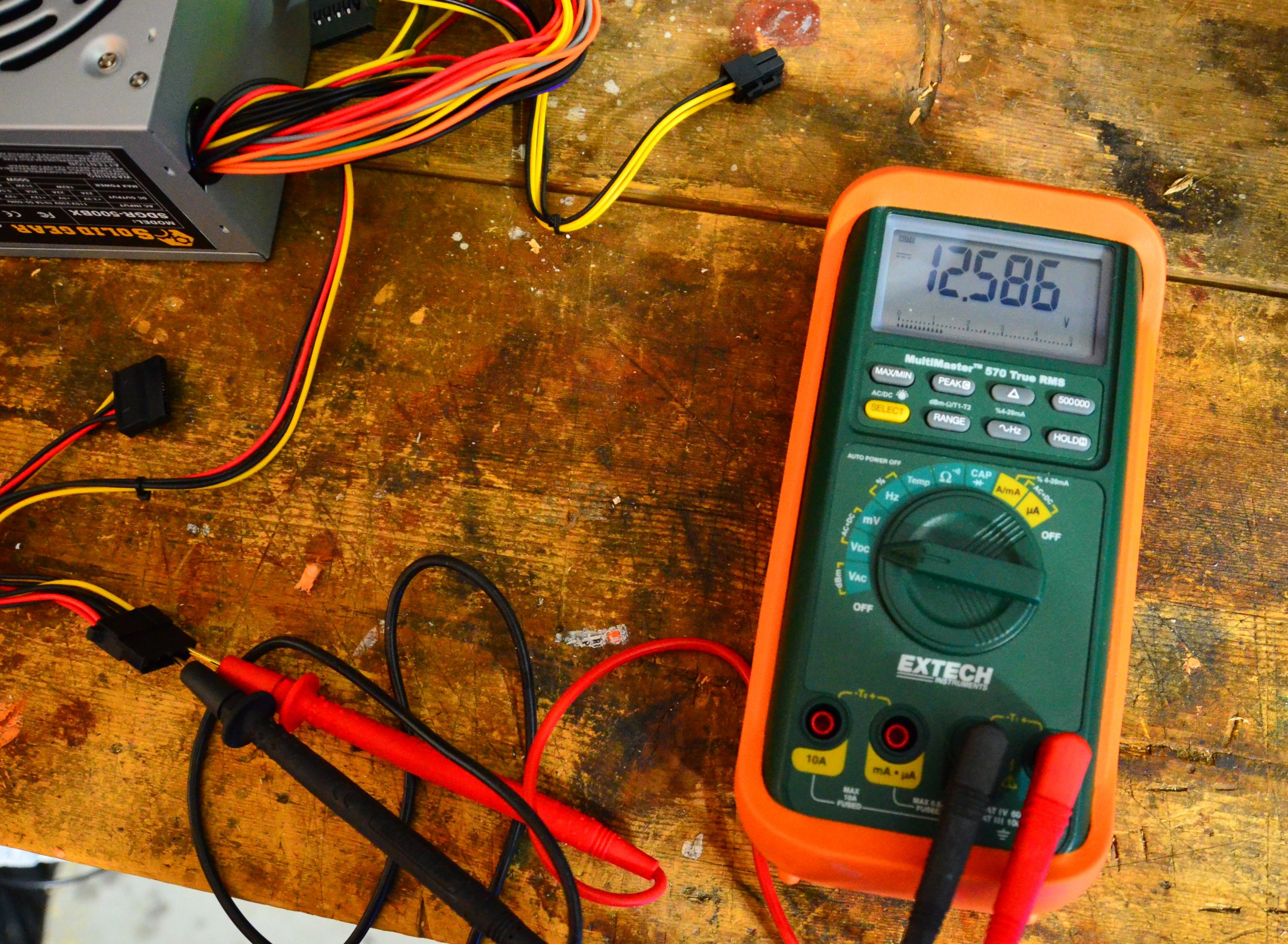

    12V:
    Voltage at 12.586V which is in spec, but the 250mV ripple isn't, so this thing fails even with a fairly light load.

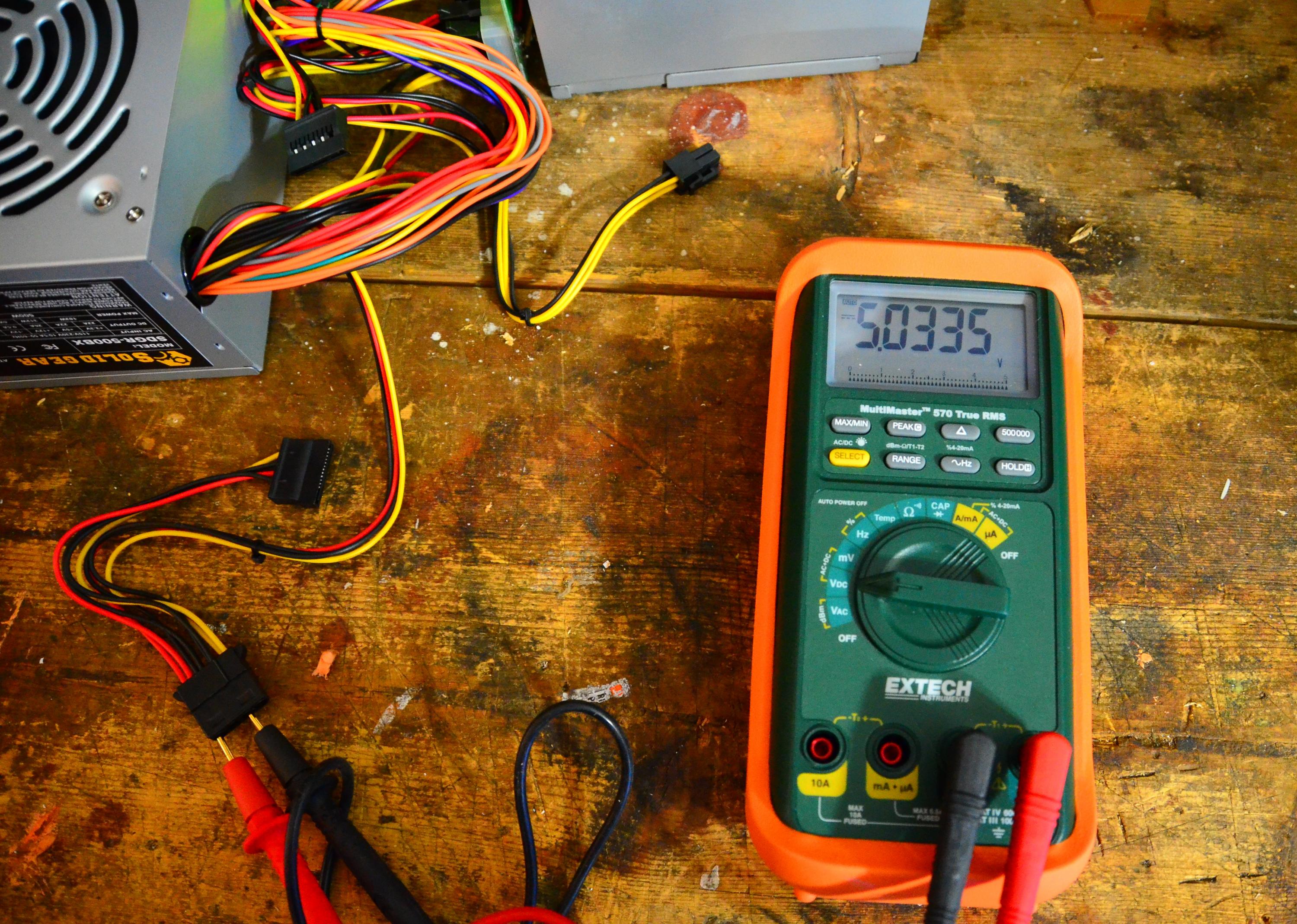

    5V:
    5.0335V, but 225 mV ripple again out of spec.

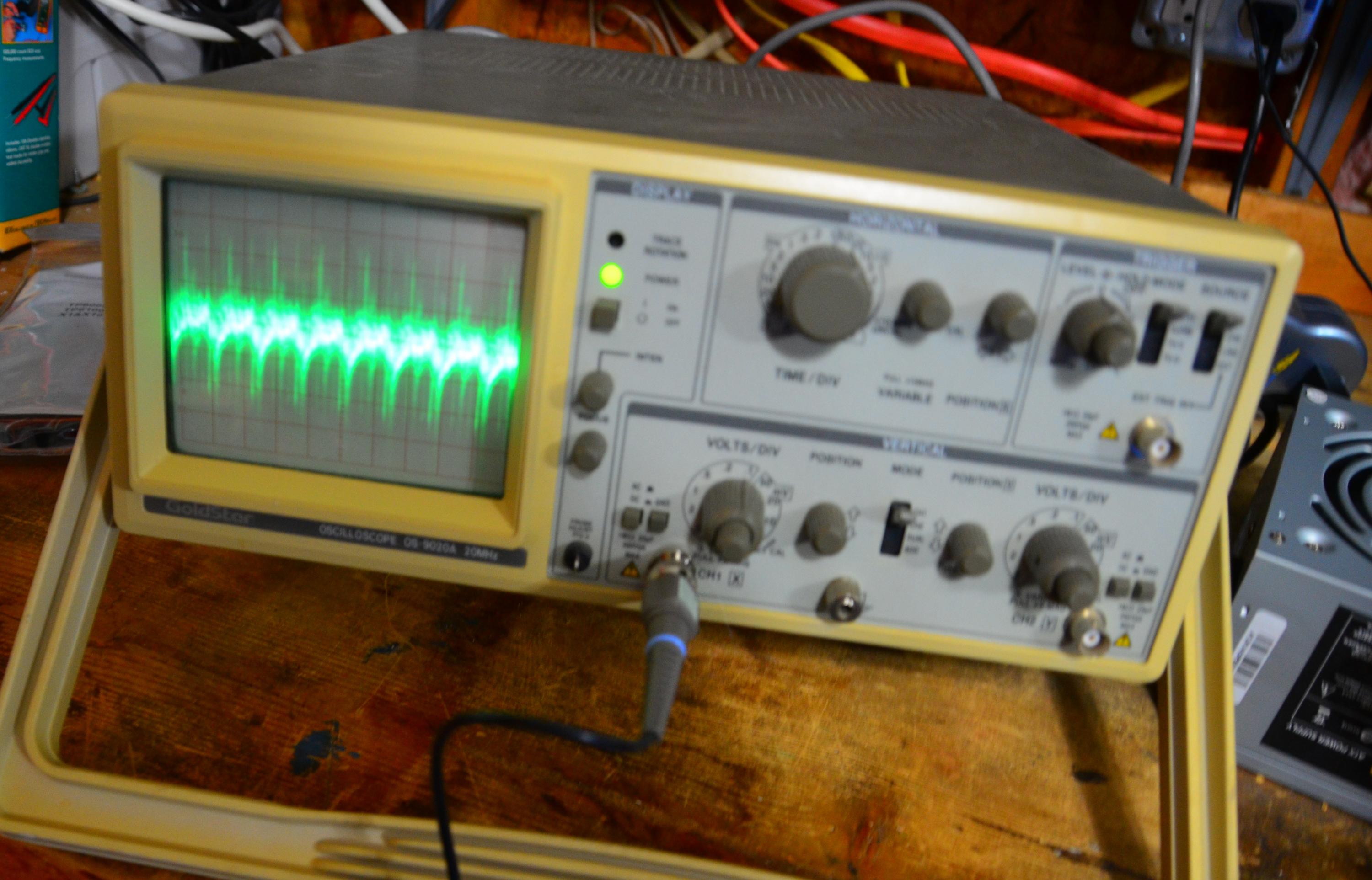

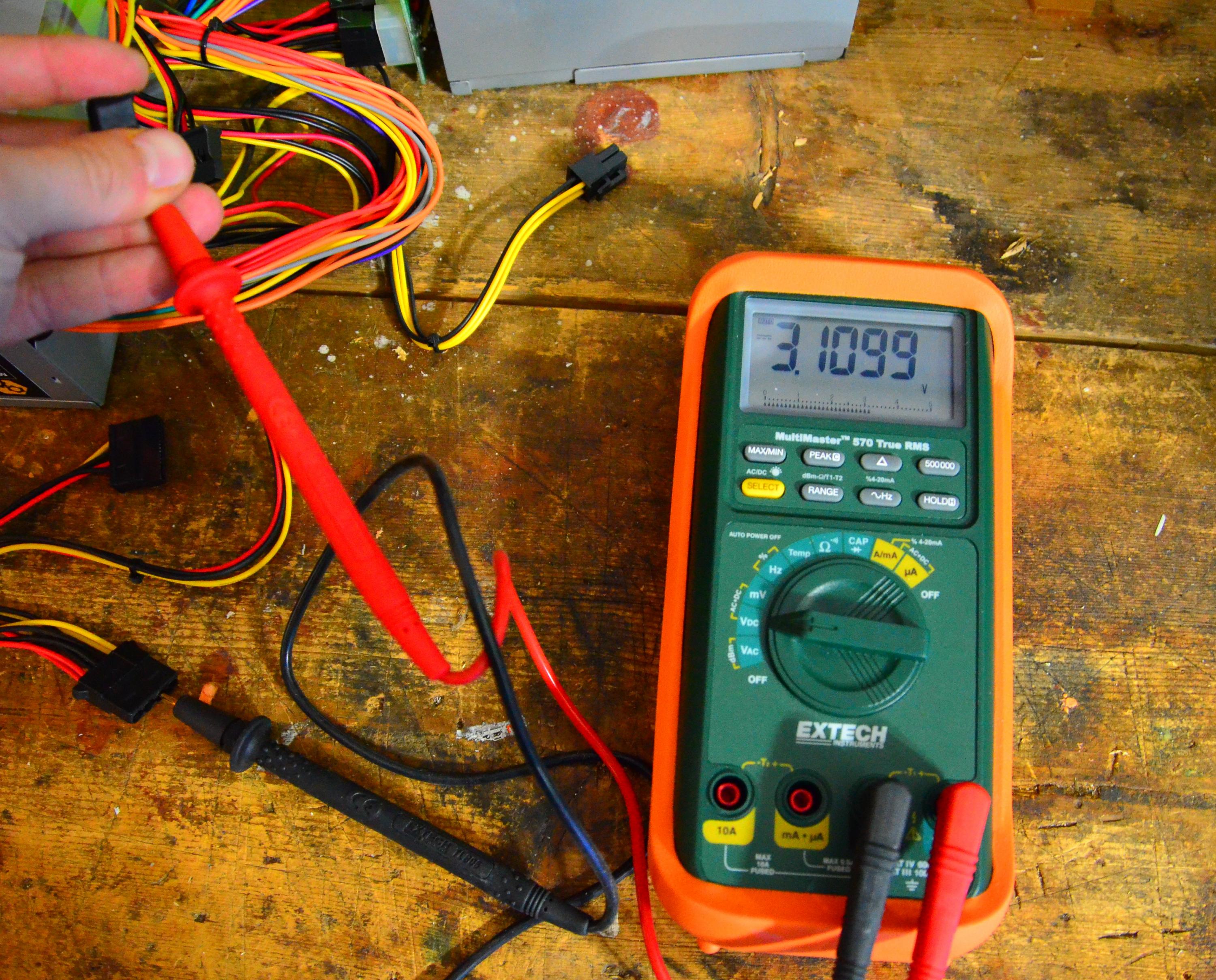

    3.3V
    3.1099V and 200 mV ripple out of spec on both counts here.

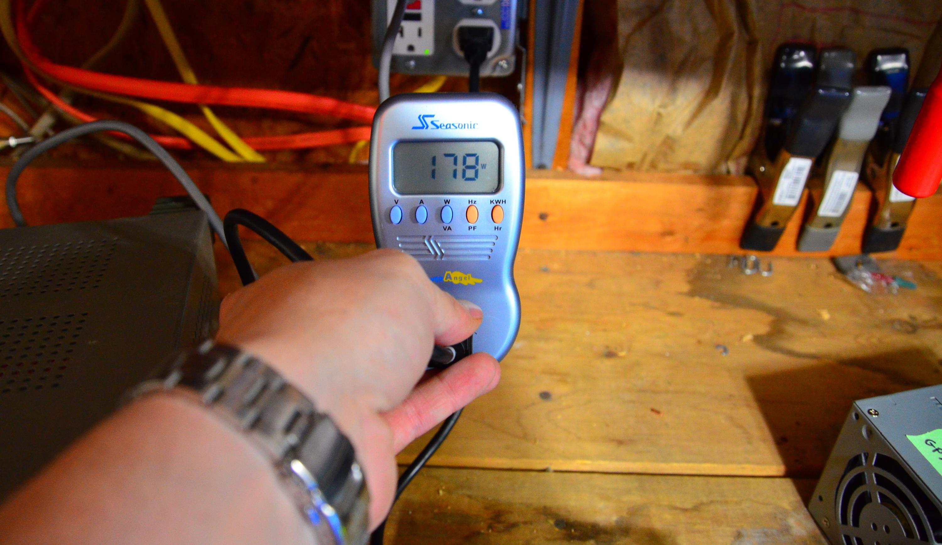

    Power draw:
    178W for a 77% efficiency.

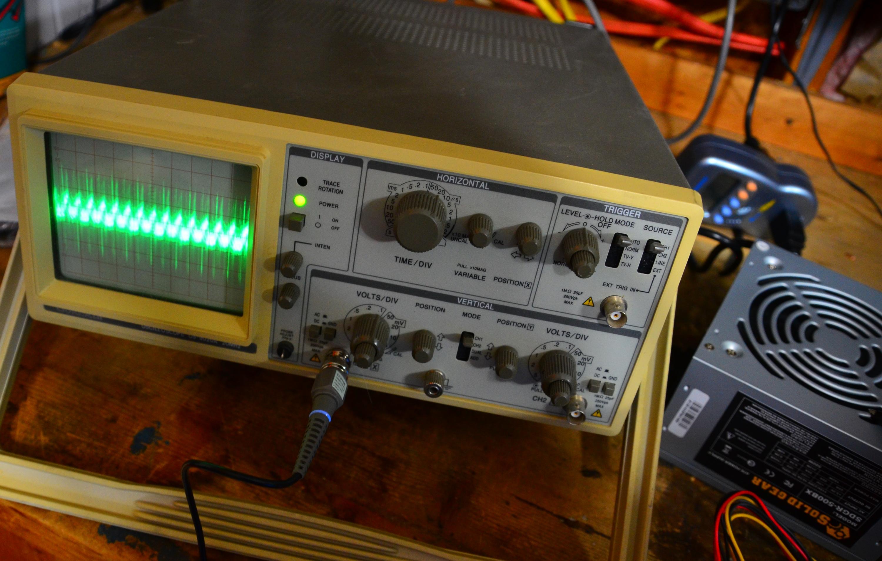

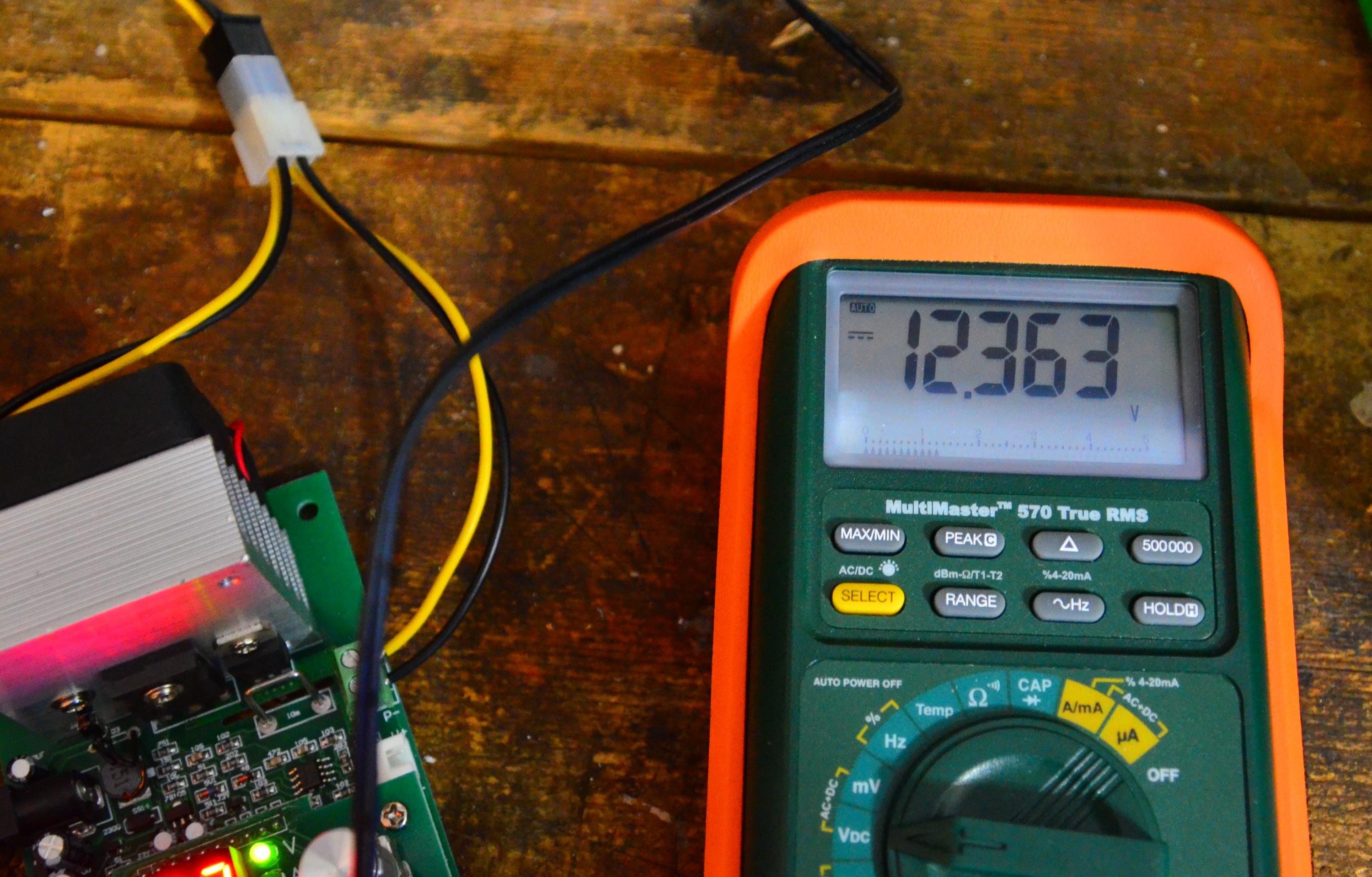

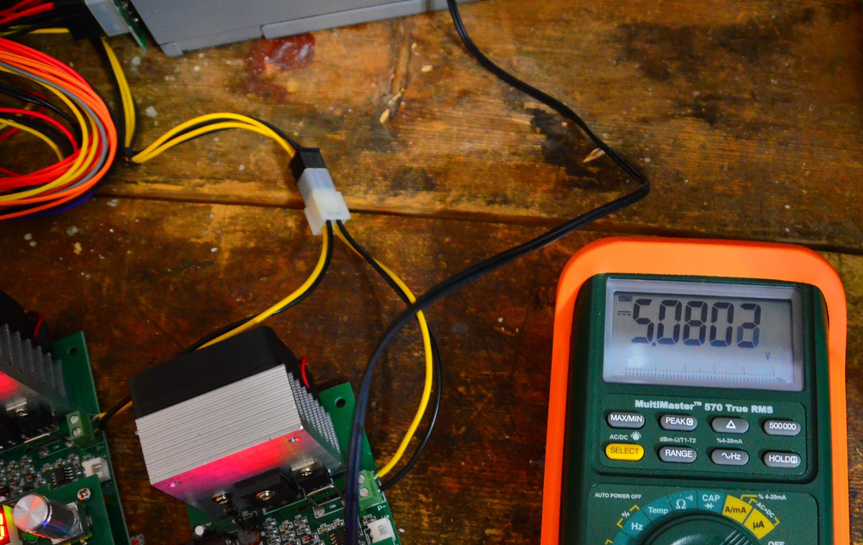

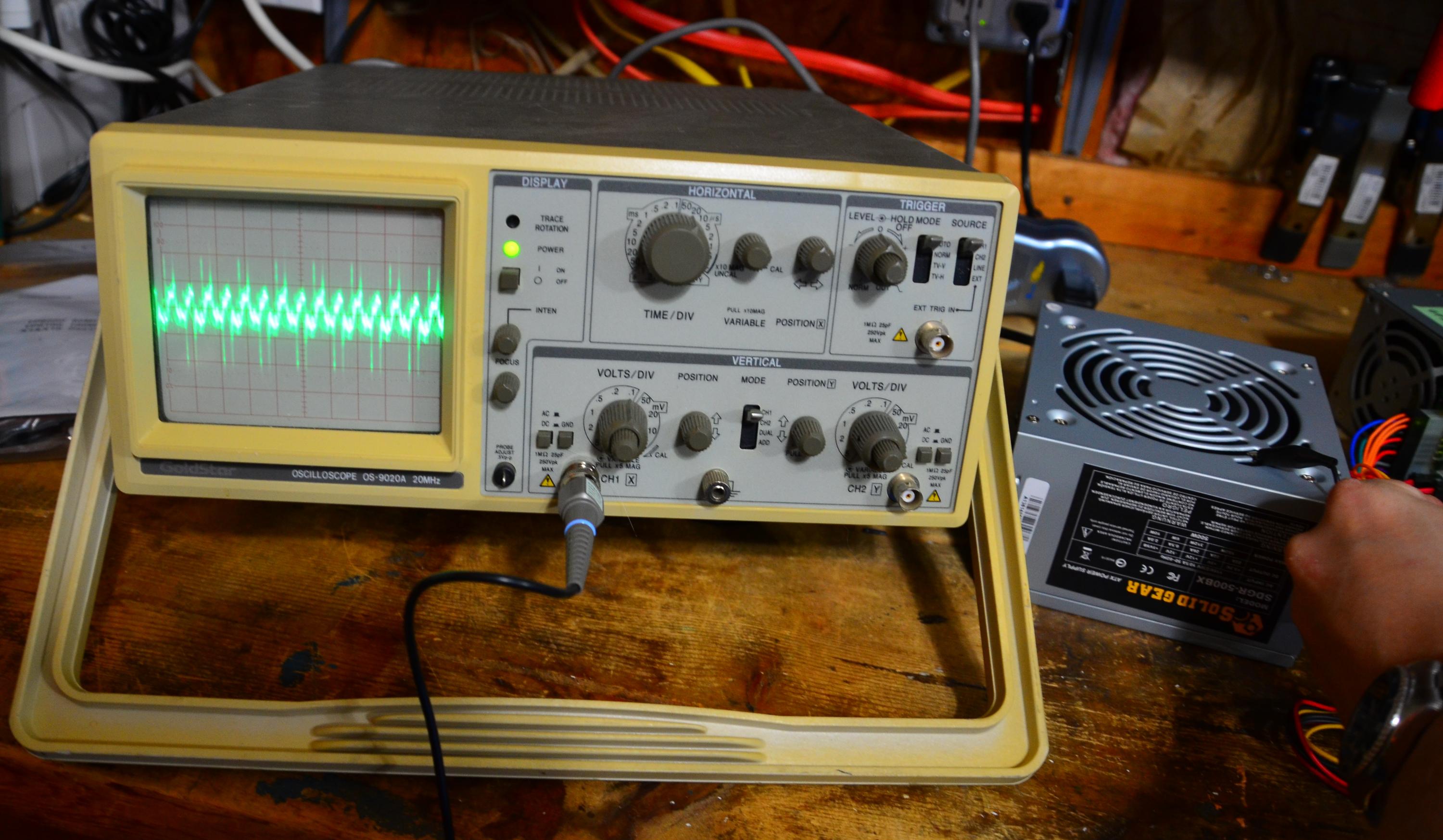

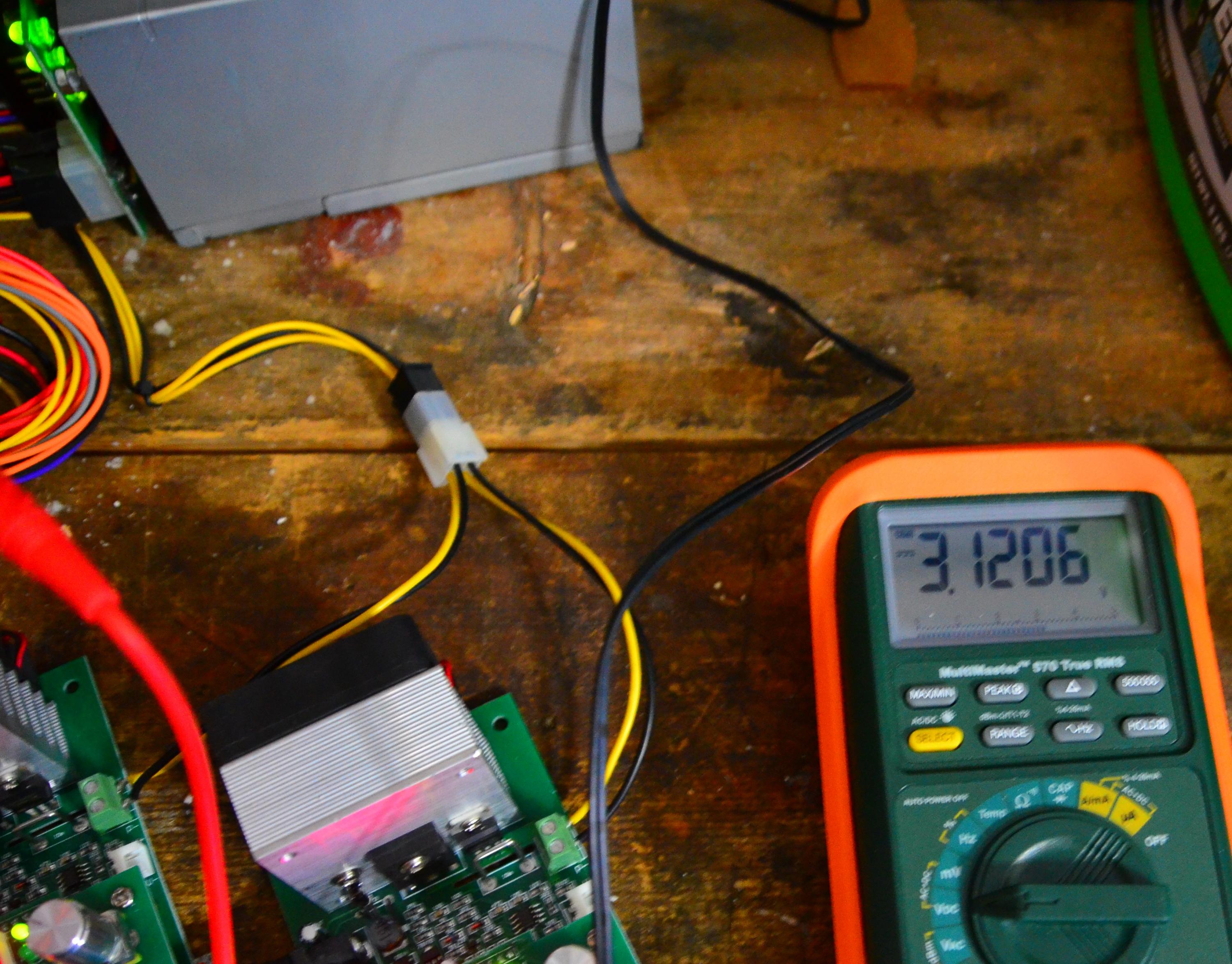

    Now lets add an additional 10A on the 12V rail to bump it up to 257.6W:
    12V:
    12.363V and over 300 mV ripple (and look at how ugly the ripple in the +/-100mV range is ).
    5V:
    5.082V with around 275 mV ripple
    3.3V
    3.1206V with around 225 mV ripple

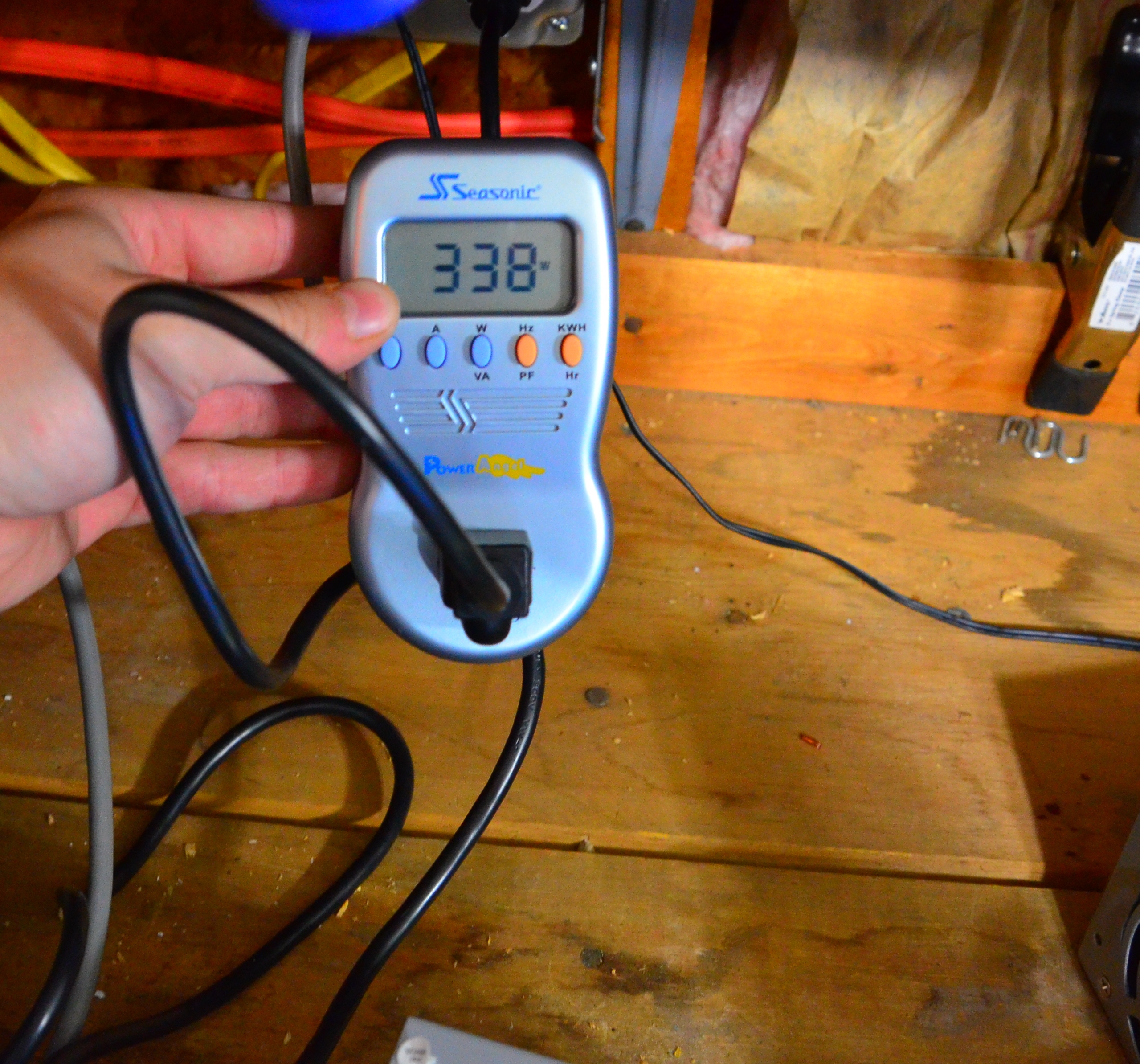

    Power draw:
    338W for a 76% efficiency.
    Well, it didn't blow up, though it did start to smell "bad" (like hot melt glue) in the second test so I doubt it would last very long under that load. The ripple is downright ugly though even under the lighter load so I wouldn't use this thing on any PC I cared about (or any PC for that matter).

    Re: $20 "500W" PSU From MicroCenter, how bad can it be?
    Keep on seeing that silly skinny extruded T heatsink... powmax?
    looks like 200W... if that much...
    KA7500/TL494 or what custom chip does it use?

      UTC7520D (looks like a knock off of a Weltrend WT7520):

          It couldn't even do the lower 137W in spec (granted that is an ancient PSU tester so it was very 3.3V/5V heavy, but that is also an ancient PSU design so it should actually handle that better than a 12V heavy load of a modern system), so as far as meeting ATX specs it looks like a <100W unit, granted it could probably handle 200W without blowing up, but it would be feeding your components a ton of ripple that would slowly destroy them.
          At the higher 257W load (the built in 137W from the PSU tester + 2 60W electronic loads on the 12V rail) it really did feel like it was on the verge of blowing up with the smell it was making and the amount of hot air coming off the exhaust.

            The heatsinks, 13007 BJTs, and main transformer look like ~200W, but those 220uF input lytics are more like 150W. I'm surprised it lasted long enough at 257W to get all the readings and w/f's without glowing and launching.

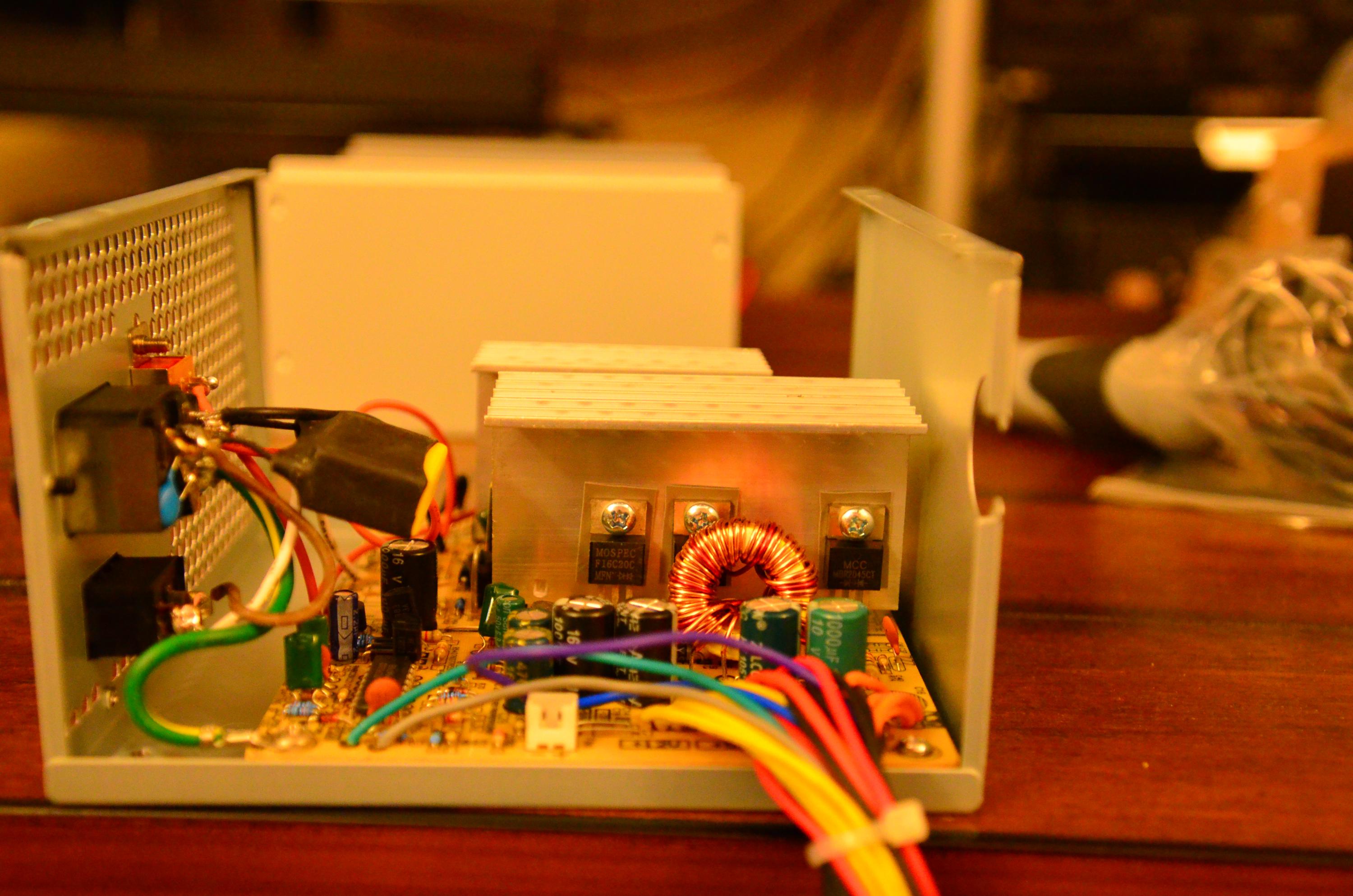

                Right off the bat, as soon as I saw the "500W" rating on the label, yet not even a single PCI-E power connector, I knew we'd be dealing with a crap PSU. Just how crap surprised me even more after you opened it.
                I think the worst thing about this SG PSU is the small output toroid inductor. Not only that, but notice there is only one output toroid inductor instead of two, like you would expect on most group-regulated PSUs. This suggests the 3.3V rail should then be linearly regulated. BUT! That would require a MOSFET or other linear device on the secondary heatsink, and there is none!! So what regulates the 3.3V rail down to 3.3V, then?
                Answer: NOTHING!
                This means the 3.3V rail is derived the same way as the 5V and 12V rails - i.e. through its own winding from the main transformer. This mean there is absolutely no addition regulation for the 3.3V rail, and it can vary as the other rails do.
                In other words, the 3.3V rail has an absolute garbage design. I've only seen this on an extremely gutless CWT-built ISO PSU posted here:

                Also, with the Seasonic load test @ 137 Watts and no additional loading on the 12V rail, I notice the 12V rail is quite high. I suspect SG or whoever manufactured this PSU for SG, added a few more windings on the 12V rain taps of the main transformer to get a higher voltage output on the 12V rail - most likely to account for 12V rail sag when loaded with a more modern 12V-based PC, like all PCs are nowadays. That's why it looks like both the 12V rail and 3.3V rail regulation improved quite a bit when an additional 10 Amps (120 Watts) load was added on the 12V rail.
                That noted, I am also very surprised that this PSU did not blow up when it was loaded past 200 Watts. The smell was probably a good indicator that it likely would go bang if left loaded like that for an extended period of time. I suspect the smell was coming from the output toroid and maybe parts getting cooked near the heatsinks (and it sure would have been interesting to add a thermocouple to the heatsinks to see how hot they got. )
                Lastly, I'm also surprised with the ripple and noise on the output with that load. Sure 200-300 mV is absolutely terrible. But with no more than one to two 1000 uF caps per rail and no PI coils, along with a tiny output inductor.... that's actually a decent result. However, even with all output filter cap spots populated and bigger capacity, I still don't think the ripple would be in spec past 150 Watts - mostly due to the lack of PI coils and small output toroid.

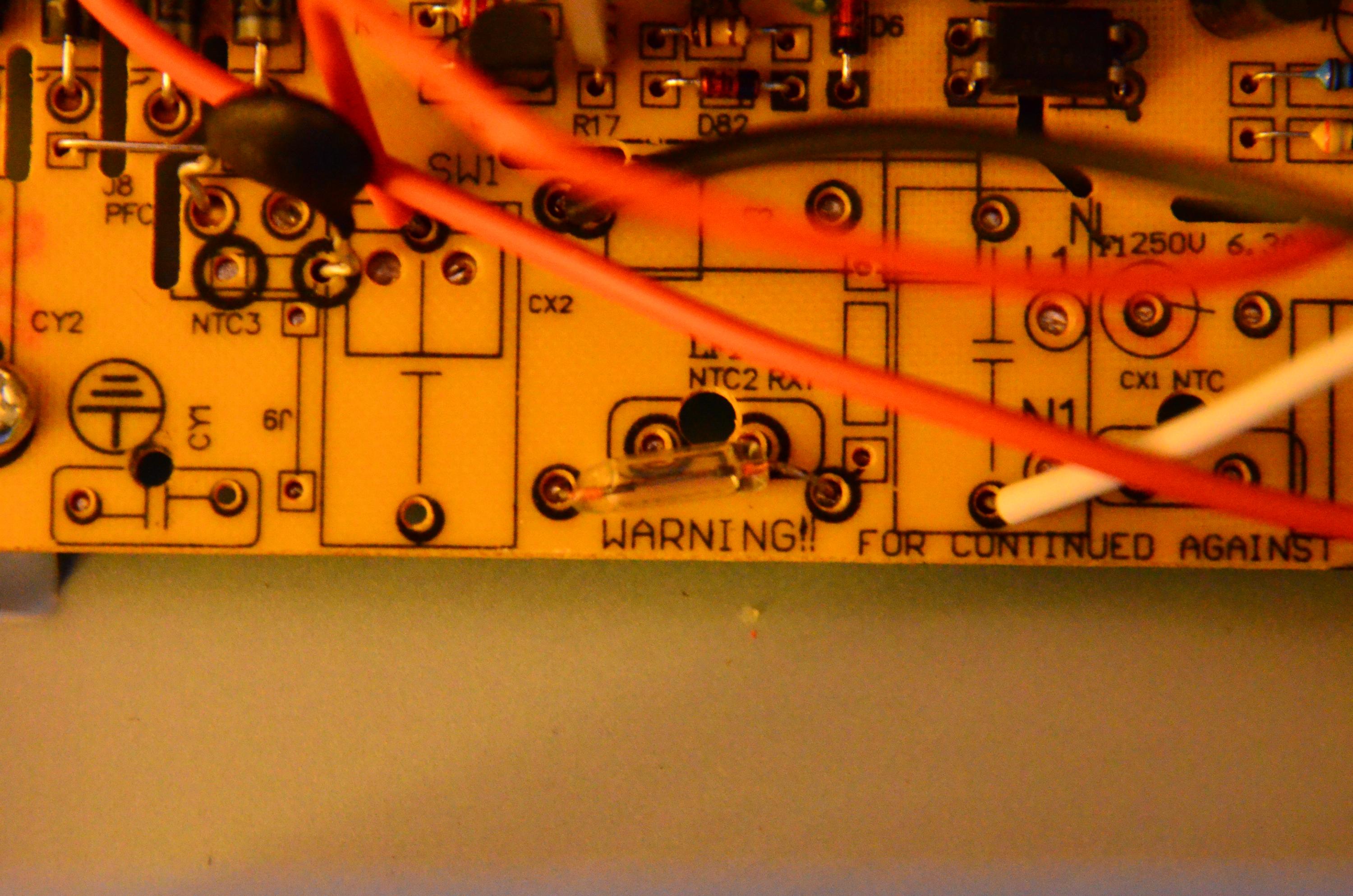

                              A question, the writing on the PCB does it say this?
                              WARNING: For protection against fire we recommend that you install a fuse on PCB location "F1" that we have bypassed.
                                    I think there is one of those weird tiny fuses above the word "warning." It took me a while to find it because it's so small that it's hidden behind the wires.
                                      Yep, there is one of those little soldered in glass fuses:

                                        well that will be fun when it fails!!
                                        not because it's small, but because it's not ceramic.
