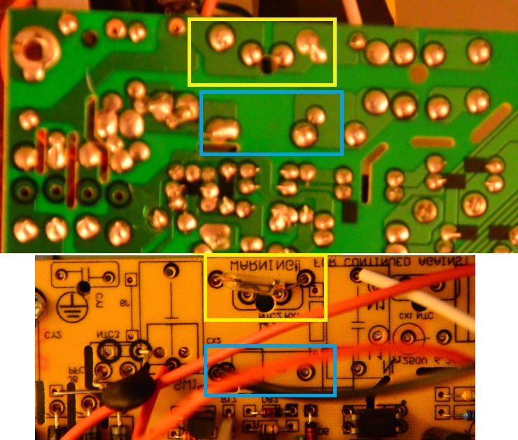

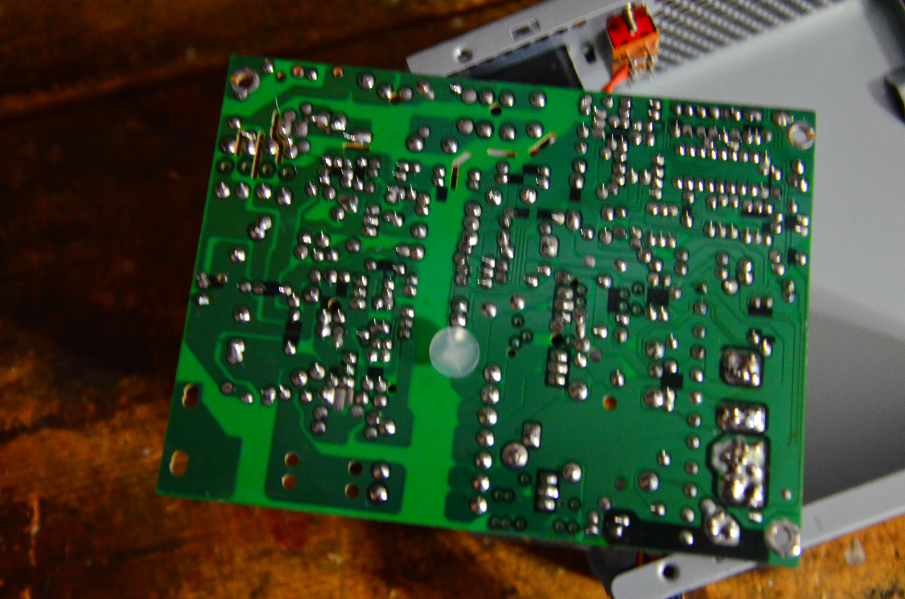

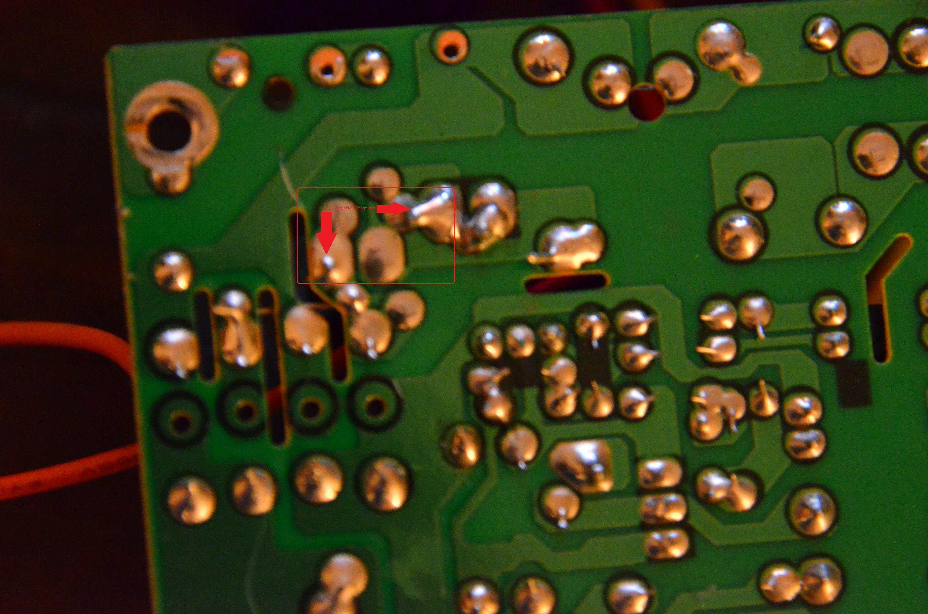

    Ahh ok, I did see there was something there, but could not imagine it was a fuse so small!
    Anyway it does not really matter: it is on the wrong location of the PCB.
    So even if it blows the arc will probably not be interrupted and the house will burn down.
    See attached photo for why, clearance, what is that for?
    (The yellow rectangle is the location of the fuse, and the blue rectangle is where it should have been).

      Re: $20 "500W" PSU From MicroCenter, how bad can it be?
      so they put it where the (missing) NTC inrush resistor should have been!
      • Per Hansson
        • Jul 2005
        • 5895
        • Sweden
        Yes, but they did put what looks like a NTC at PCB location NTC3.
        (Lower left corner in my picture above)
        However that looks to have even less clearance or even shorted out!
            https://www.badcaps.net/forum/attach...1&d=1594829484
            Good catch!
            And OUCH, that is seriously bad cost-cutting idiocy there.
            Fortunately, I don't think this can make the house wiring burn down. Look at the wires going to the voltage selector switch and also to the IEC plug - they look like AWG 22 at best. Most likely they would smoke and glow for a few seconds in the event of the fuse not working properly, but could eventually act as a secondary "fuse".
            That thing needs a shrapnel warning! And if it arcs for a while after opening up, the PCB under it will be odoriferous toasty badness!
            Mmmm. The smell of freshly burned PCB.
              Originally posted by momaka
              Good catch!
              ^This, between the thin wires from the mains connector to the PCB and those tiny little "bridge rectifier" diodes it is unlikely that this thing would be able to pull much current for very long.
              Also as long as the house wiring is up to code the circuit breaker (15A on a 14 AWG circuit or 20A on a 12AWG circuit) will trip to protect the wiring, so the only potential of fire should be inside of the unit itself.
                  Good catch!
                  What I inferred was that the burning PCB will catch fire, not the house wiring.
                  Incidentally the only thing that looks decent in that PSU is the ground wire from the IEC receptacle.
                  That is good for when the mains wires burns off the PCB due to the fuse fuckup:
                  When the wire then falls against the chassis the house fuse can do its job, or much better GFCI if present
                  Incidentally that ground cable looks so good that I wonder if the children scavenged not only the Rubycon primary caps but also that ground cable from a decent unit at the city dump.
                  EDIT: Since the fuse is in the wrong location the 115/230 voltage selector switch is unfused:
                  https://www.badcaps.net/forum/attach...1&d=1593987874

                    On the neutral=Immediate major violation!

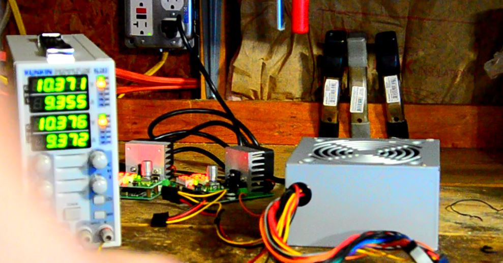

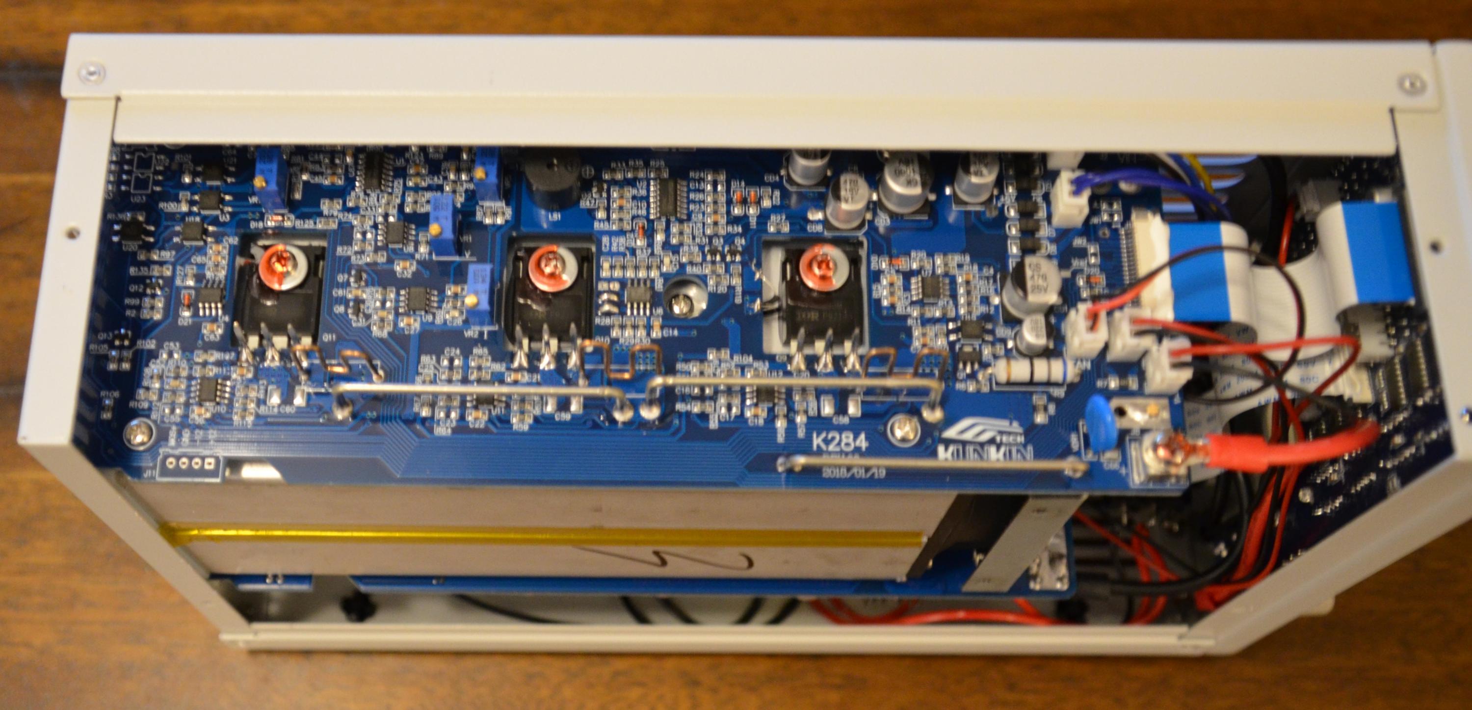

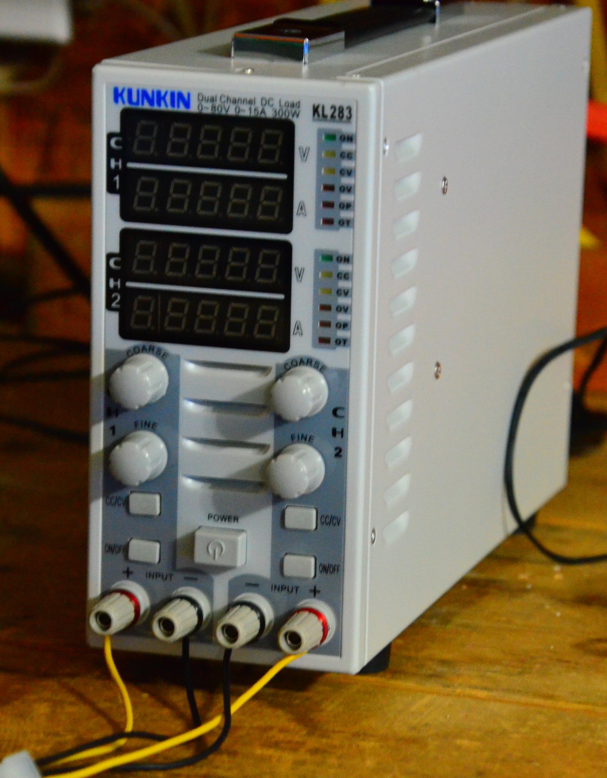

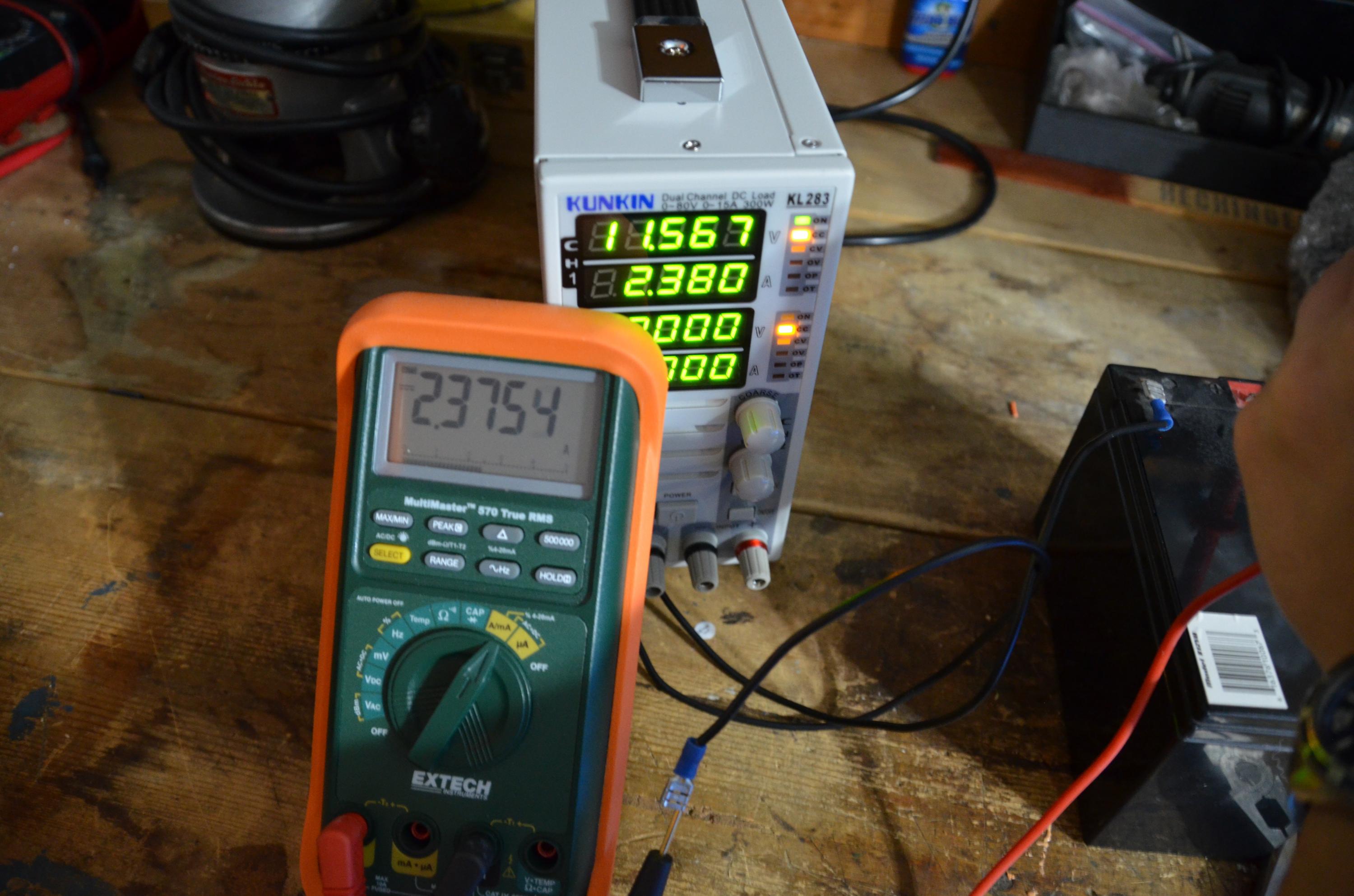

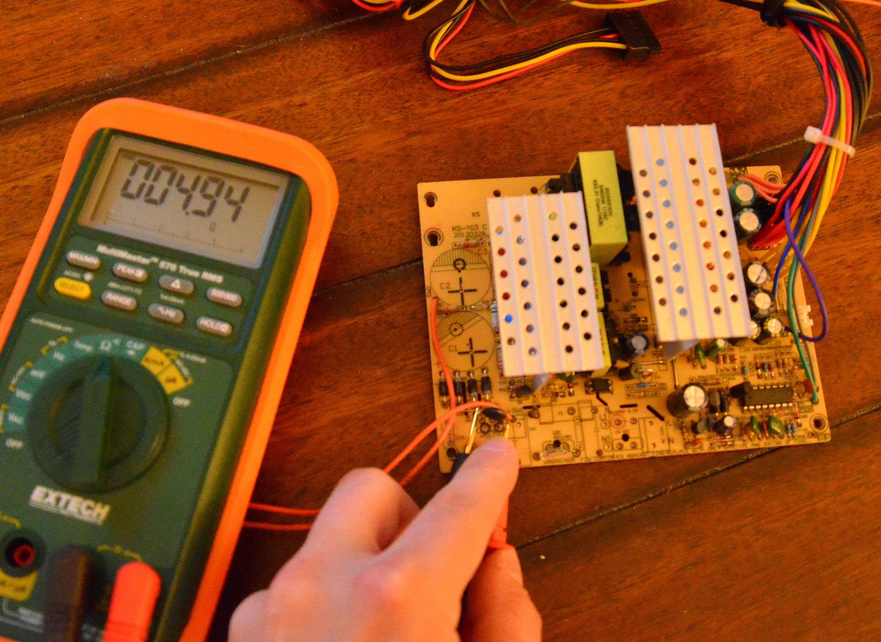

                          My new toy showed up early:
                          Sadly there were no fireworks this Solid gear PSU failed with a whimper rather than a bang.
                          Here is right before the failure, there is 18.7A of load on the 12V rail and 10A each on the 3.3 and 5V rail for a ~307W load. As you can see the 12V rail is around 10.4V, you can't see them in the pic (since the 2 smaller electronic loads are sitting flat on the bench) but the 5V was also below 4V and 3.3V below 2V, so way out of spec. A few seconds after this it shut down never to power up again.

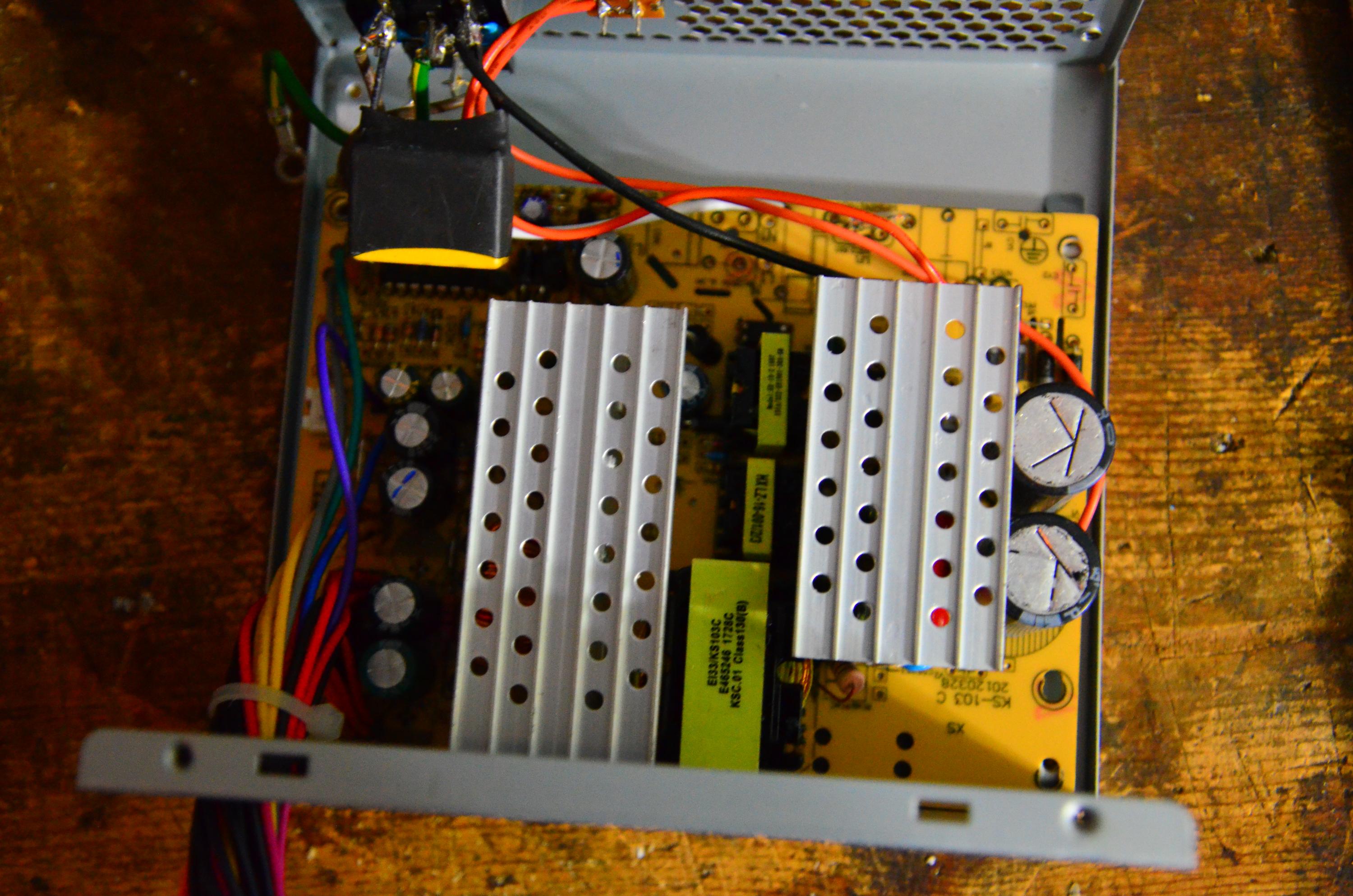

                          Analyzing the failure there are no burn marks and no blown up components. It looks like the failure point was the 4 diodes for the bridge rectifier with 2 showing completely open and one showing 2M ohms (so basically open).

                            So how do you like your new toy
                            How accurate is it and do you have any complaints about the quality of this product or use of this product
                            I might be interested in buying one for myself
                            I do have a question for you about the cv setting what does that function really do does it load it to keep it at a certain voltage

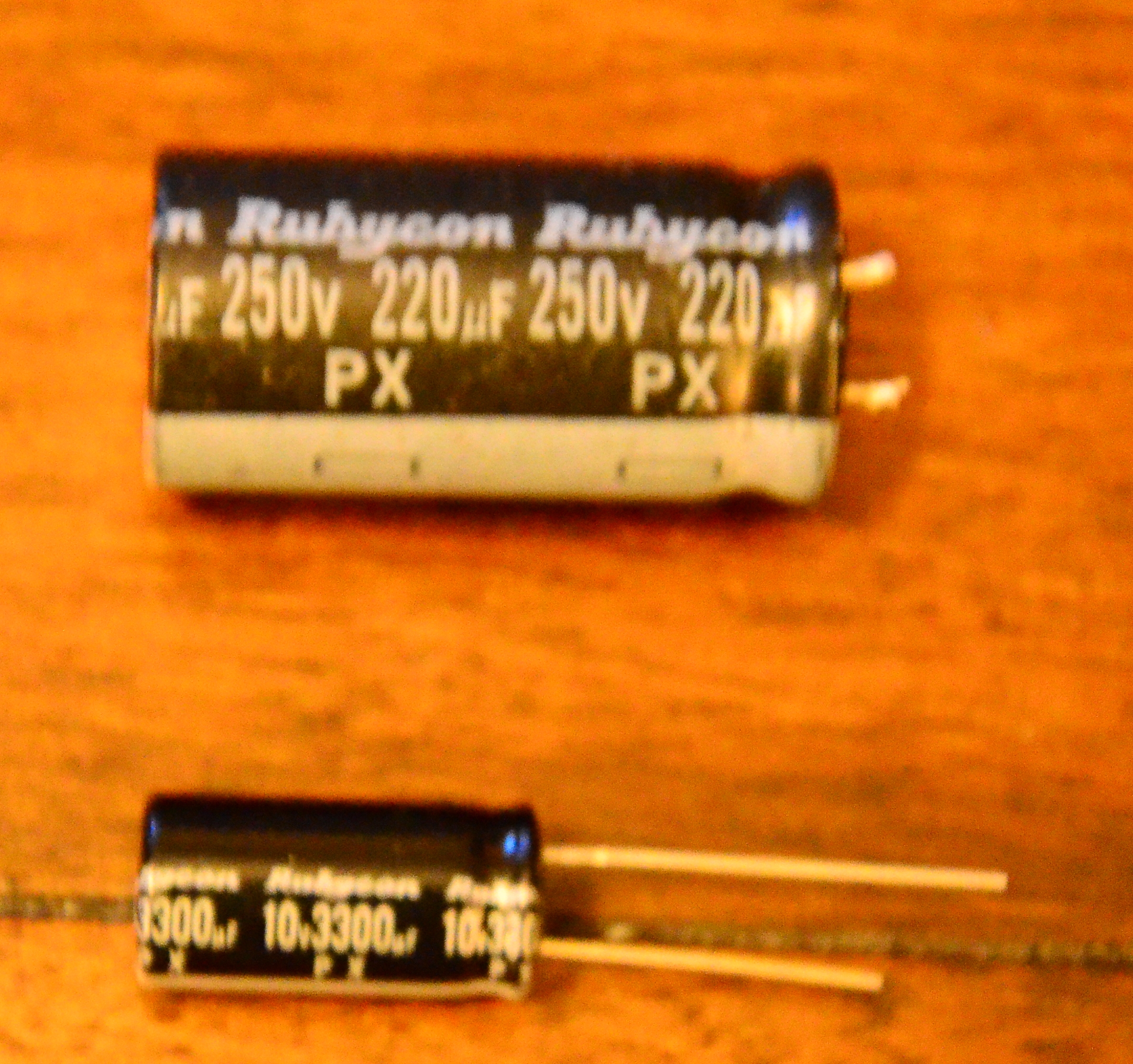

                              Cool, will you put in some new diodes and see if you can get another component failure?
                              (Or, as you're in 115v land just two are in use... Heck, the PCB even has provision for a FOOL BRIDGE RECTIFIER)
                              Also would be cool to know if that NTC is doing anything or if it is shorted out by the PCB as it looks.
                              And also if those primary Rubycon caps are real or not
                              Did you buy the DC load on Aliexpress? It looks quite nice!

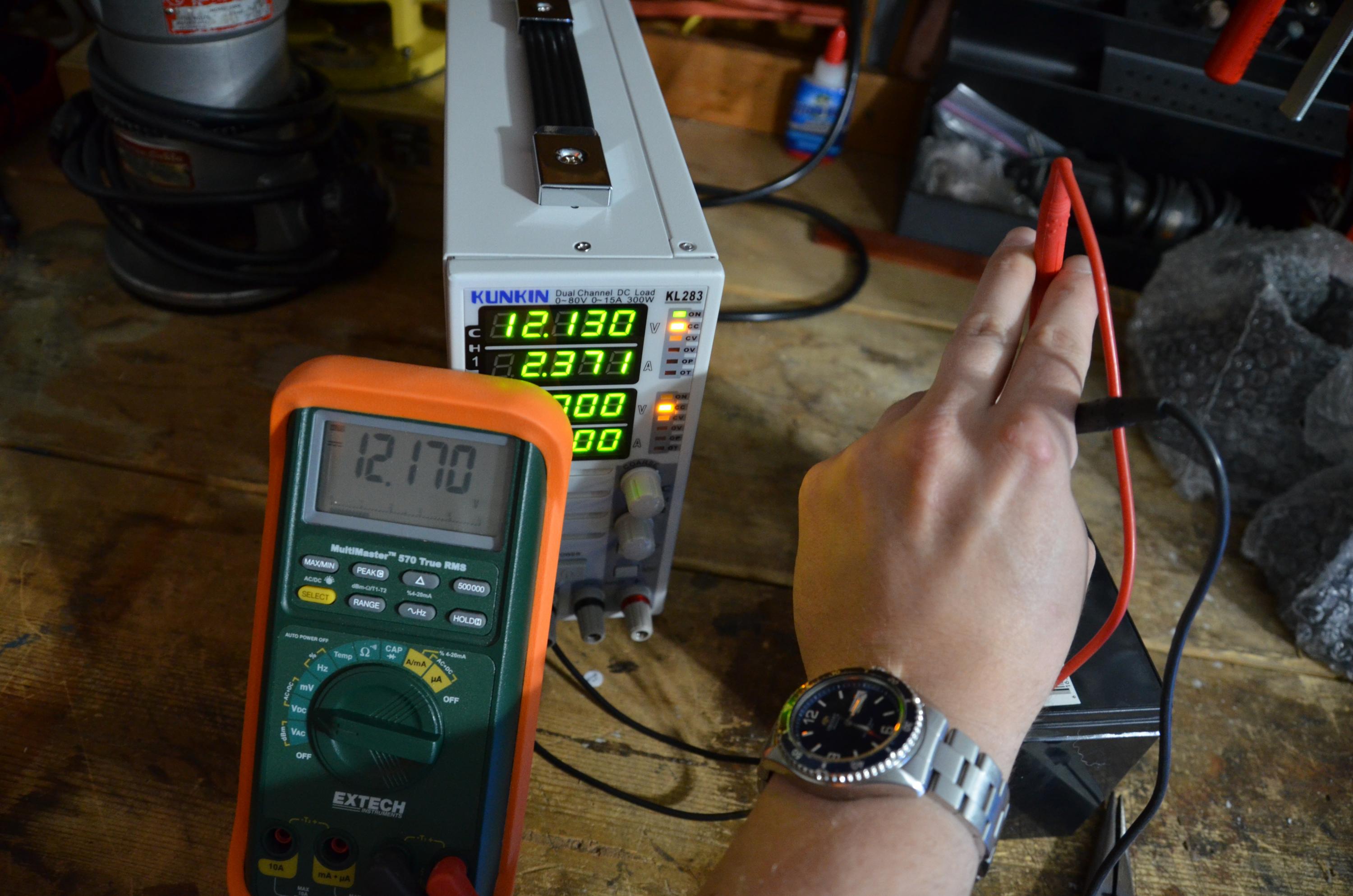

                                Yes, per the manual it looks like the CV mode is intended to be used with constant current power supplies, though of course there could be other uses (disregard the voltage reference at the top of the page looks like they use the same manual for all regions, I have a 115v unit).
                                The quality seems decent enough for a $145 piece of test equipment. You can definitely tell it isn't "high end", the case fitment isn't the greatest, and the buttons feel a little cheap, but it seems to work well enough.
                                Accuracy and internal construction appears to be pretty good considering the price point:
                                Of course since UPS just dropped it off this morning I can't comment on long term durability.
                                Ebay, here's the link to the listing I bought it from: https://www.ebay.com/itm/30A-Dual-Ch...53.m2749.l2649, but these are all over Ebay, Amazon, etc.

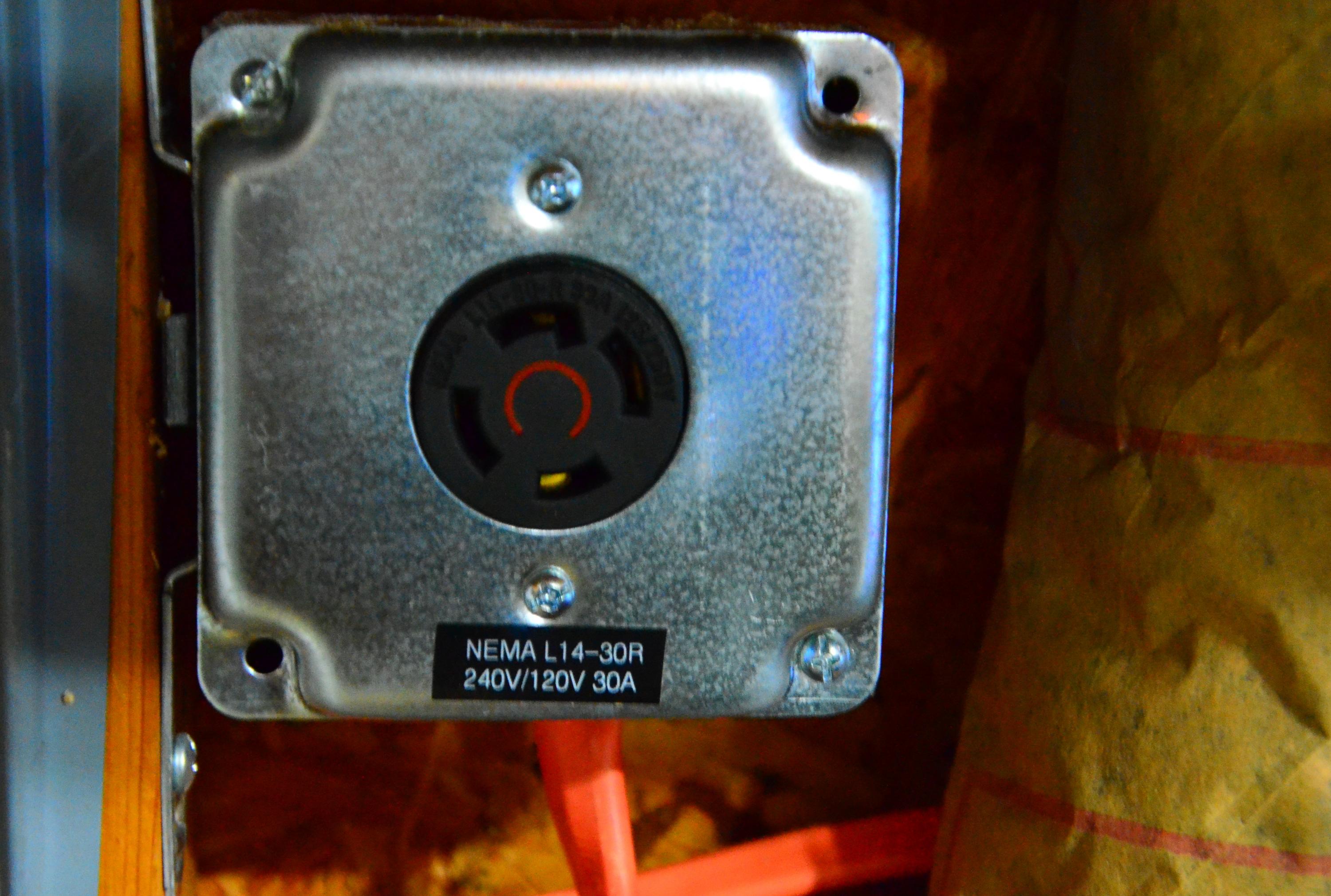

                                I do have 240V in my garage/shop in addition to the normal 120V outlets, if the PSU didn't fail on its own the plan was to leave it set to 115V and hook it up to the 240V but that didn't end up being necessary.

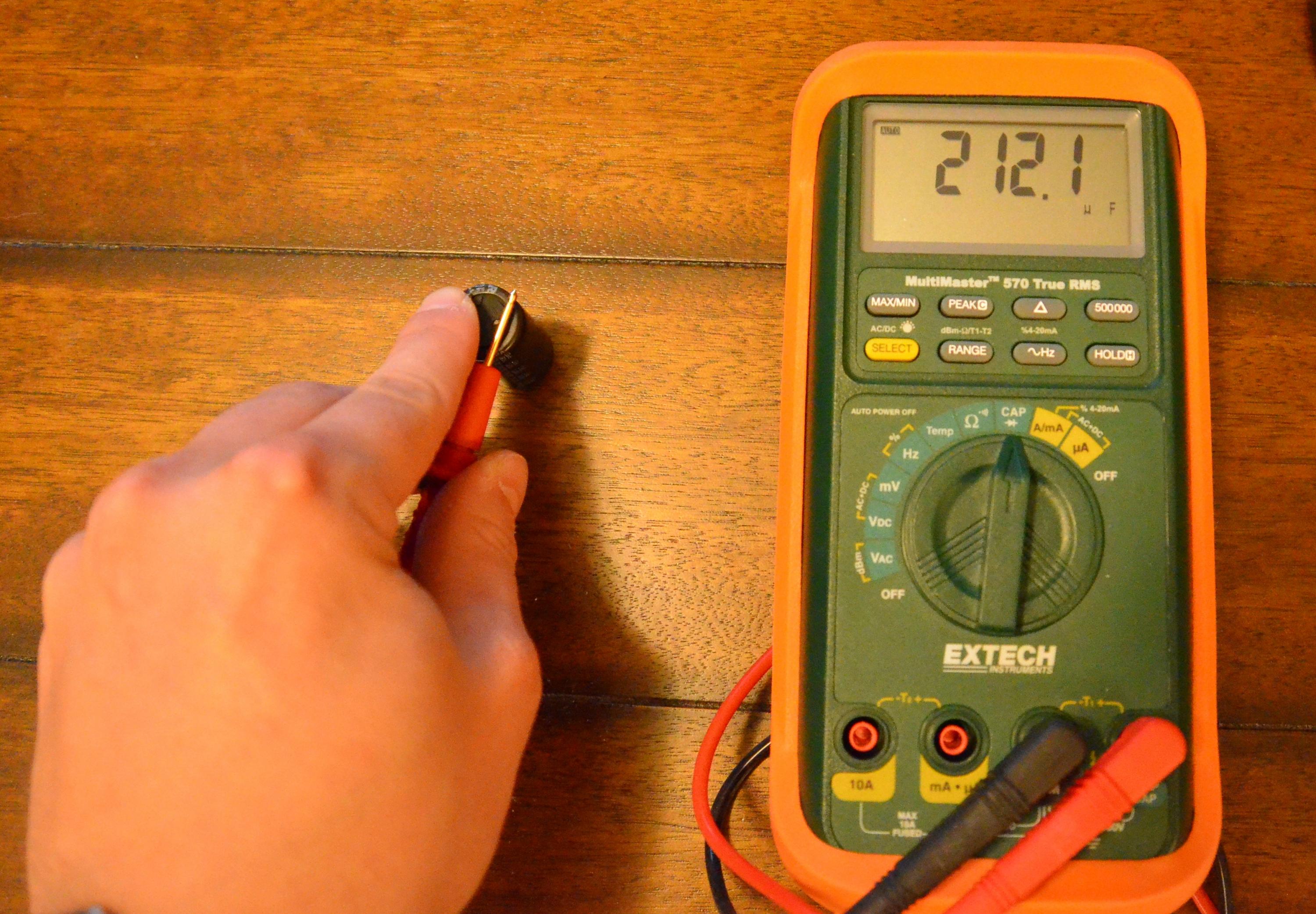

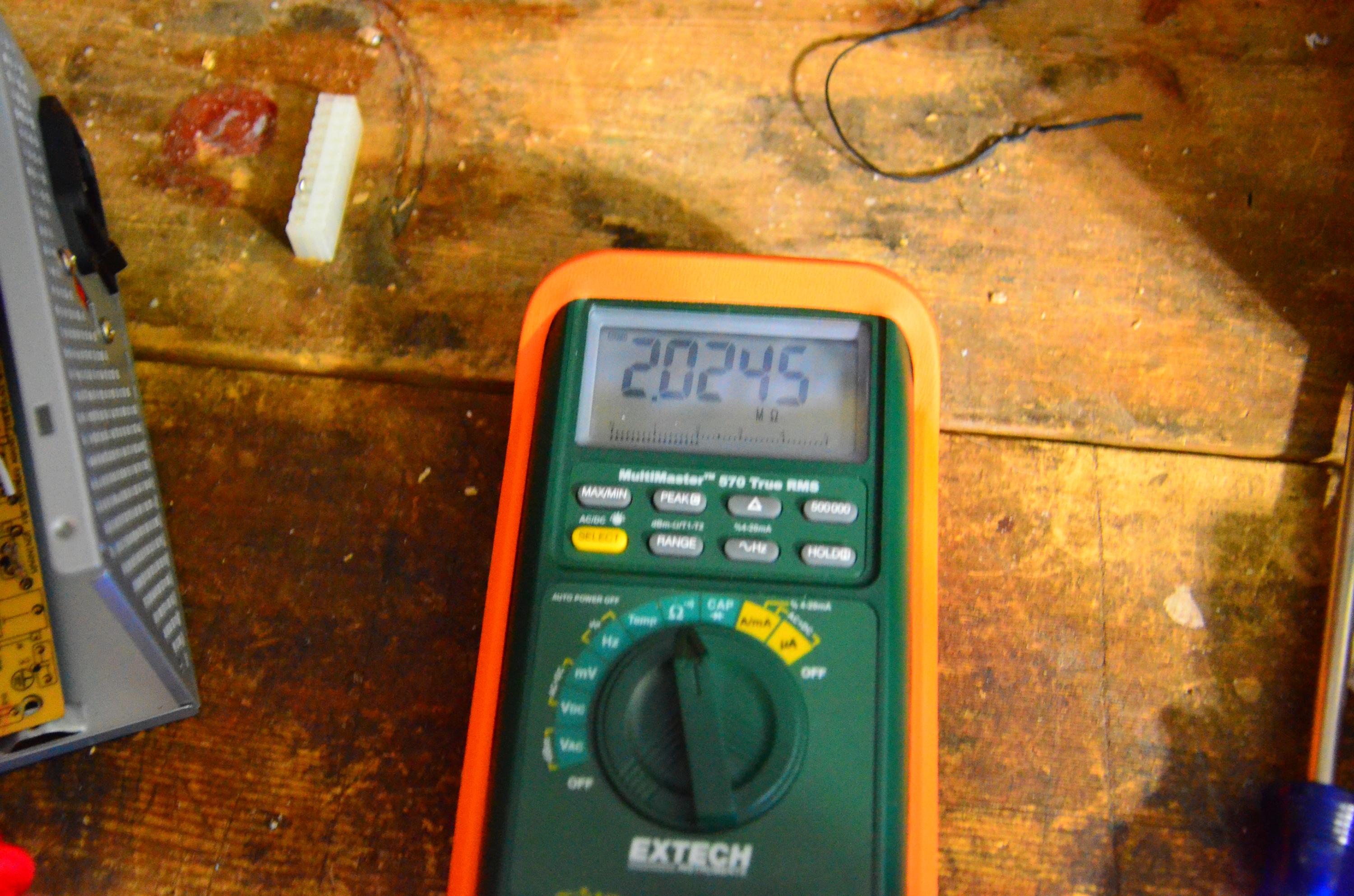

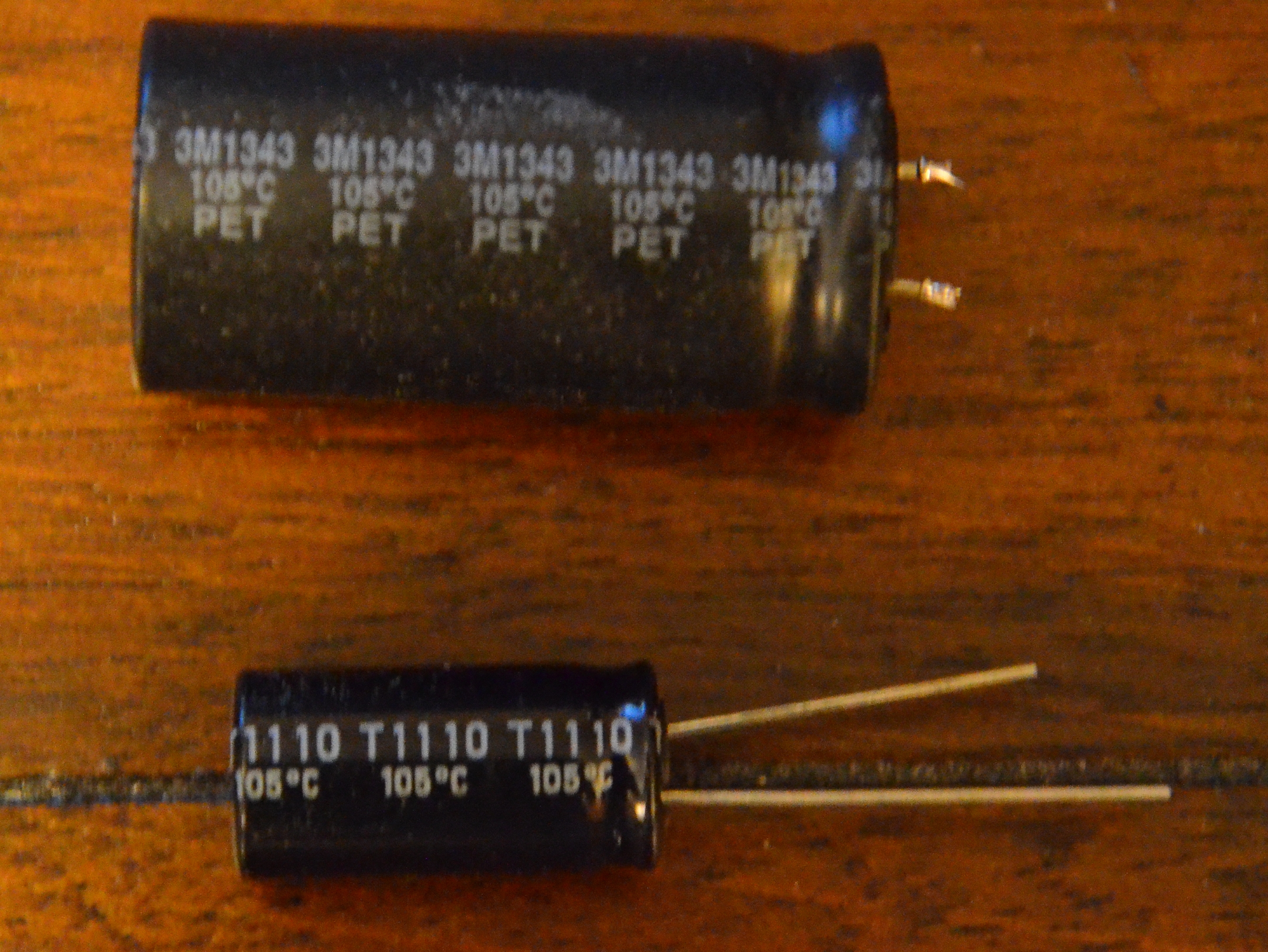

                                I think the "Rubycon" primary caps from that SolidGear PSU are fakes, the coloring/font seems "off".
                                They do appear to actually be 220uf though testing at 212uf:

                                  One note if you think are fake replace if feasible and not too hard to get two

                                      That Rubycon looks original to me, manufactured week 43 2013.
                                      I think the theory holds that it is a scavenged cap, how else would it be so dirty?
                                      Did you check if the thermistor was in circuit or it is bypassed by the crap PCB/soldering?
                                      Nice info about the DC load
                                      Oh and I'm glad you didn't kill it with 240v with the switch set to 115v, that would be cheating
                                      • dmill89
                                        • Dec 2011
                                        • 2531
                                        #39
                                        Yah, makes it hard to tell if they're fakes or just really faded/dirty with some of the text rubbed off from age. Either way they are either salvaged caps or phony, not good to find in a new PSU.
                                        Yes it is in circuit, the soldering while not great didn't bridge the pads:
                                        (The arrows point to the legs of the NTC Thermistor).
                                        • Per Hansson
                                          • Jul 2005
                                          • 5895
                                          • Sweden
                                          #40
                                          Wow, I wonder if they used human hair or cat whiskers when doing clearance checks?
                                          More seriously the soldering looks really good, the problem is the PCB routing/layout!
                                          It is also so bizarre because it has high voltage cutout slots.
                                          But then these clearance mistakes that makes you wonder if they thought they were designing for a 24VAC supply, not 240VAC!
