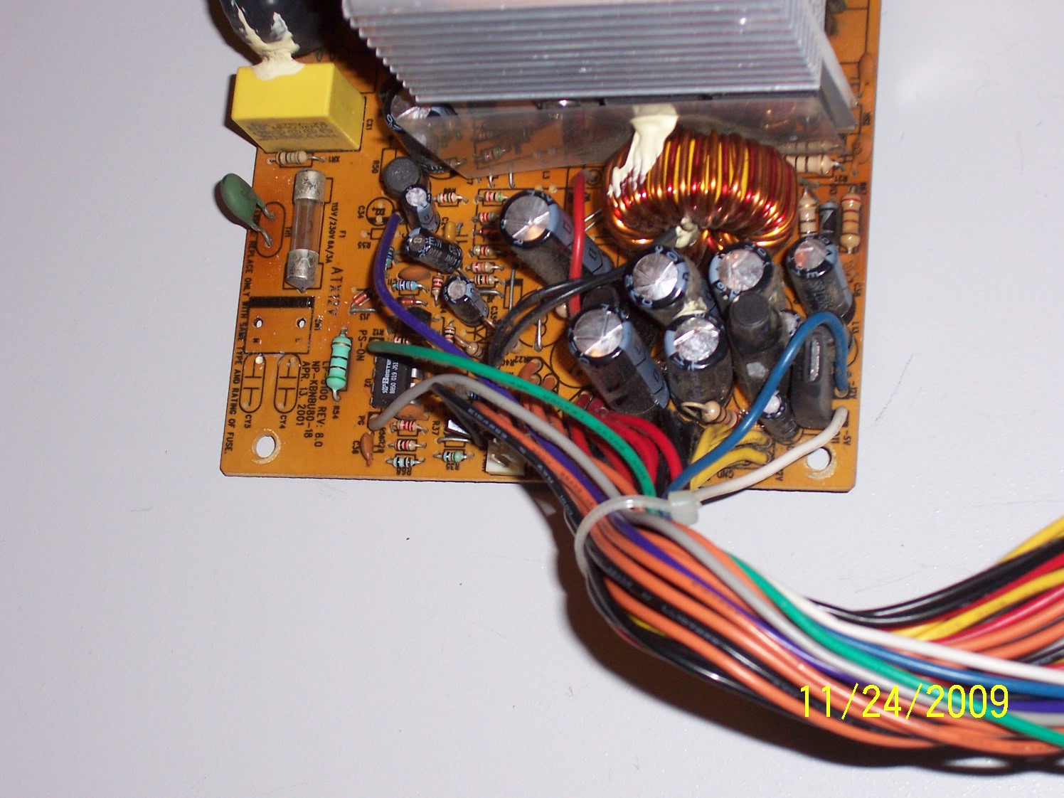

    COMPUSA 250 watt ATX power supply
    If my power supply goes bad, is it a good idea to go down to my local CompUSA store and buy a replacement? Here is a "used" CompUSA 250 watt ATX power supply which I have recently acquired.
    Looks like lots of bulging capacitors. So I applied power to see what the 5vsb was doing. It came up a little over 5 volts. Good start, but thought I would change the bulging output capacitors before proceeding. All were Rulycon brand. Here is what I found:
    2200 uF/10V 1.5 (esr)
    2200 uF/10V 2.0
    2200 uF/10V 1.7
    1000 uF/16V 2.8
    1000 uF/16V 3.5
    470 uF/16V 8.6
    1000 uF/10V 4.4 (5vsb filter)
    Since ALL of these output capacitors were obviously bad, do you think the non-bulging smaller caps are bad (same brand)? I thought Fuhjyyu were the worst brand of capacitors, but I have never seen a psu where ALL of the capacitors were bad.
    Main pwm chip is AP3843B and supervisor chip is marked Bestec B850. 5vsb switching transistors are K3067 and C945, common 2 transistor 5vsb circuit. Marking on 5vsb transformer is LP6100D. With no model number or OEM label, I wonder who made this psu....L&C, Bestec, or .........???
    With output caps replaced, power came up fine as follows:
    12V 12.03V
    5V 5.25V
    3.3V 3.38V
    5vsb 5.02V
    However, as I was monitoring and watching the 12 volt rail, the voltage varied from 12.02V to 12.73V, back and forth for a while. Finally seems to have settled at 12.03V. Maybe those little caps need replacement too!
    The 12V and 5V output rails have PI filters, but the 3.3V looks somewhat lacking.
    The QC label indicates this psu was manufactured July 2001. Overall, I would not have trusted it as a replacement. Would you?

    It's a leadman LP6100, the old version.
    Looks like there is room on the 3.3v for another cap, pi coil, and a choke.

      Replace all caps on this unit. Rulycon is a Rubycon knock-off brand so I wouldn't trust any of those caps, not even the smallest ones.
      As far as the voltage fluctuation, check the primaries. Mine had JEEs and after they bulged, the voltages started to fluctuate a lot too.
      It might also be a good idea to put a heatsink on the main 5vsb transistor - it really does get hot, along with few resistors around it. That 5vsb critical cap (25v 47uF) probably gets cooked pretty well because it's positioned right in that area.
      There's a few other odd things I noticed about the 5vsb as well and this is consistent with my LP6100 - 5vsb circuit is missing components ZD1, R50, C34, and R35. Also look at the glass diode next to J13 - doesn't really correspond to what's written on the PCB. Any idea why? To me it looks like this was originally some kind of dedicated circuit for powering the supervisory chip, but I guess they removed it to save valuable cents.
      I say this one is a good candidate for the 5vsb mod .
      Other than that, this PSU is okay. It doesn't seem overrated either. I had mine (CompUSA, '500w' model) for close to 5 years (was used only 4-6 hours a day, though) and didn't have a problem until the capacitors bulged.
      By the way, what's that burn mark in the first picture? It looks like something arced.

                  I usually try to find something good to say about even the worst power supply. For this one, I am in agreement with ratdude747, it is a POS. As somewhat of a joke, I replaced those Rulycon capacitors with pullout Fuhjjyu capacitors, ones that tested good on Blue ESR meter. The power supply works so much better now! I doubt this power supply will ever again provide power to a computer - at least not one of mine!!!
                  I4004 - I totally agree with your opinion - totally untrustworthy power supply. I enjoyed your opinion - the shortest response I have ever seen you make.....just one word. I'm sure pcbones will be proud of you.
                  On to more serious stuff - I have a Antec Smart Power SP400 that I am recapping. It had lots of Fuhjjyu caps. Most disappointing, the primary caps are 820 uF/200 volt Fuhjjyu caps. It also has the 5vsb two transistor circuit ... will have to do my special add on DM311 board.
                  As for the CompUSA 250 watt psu, there is NOTHING in it I can see as having any value, even for parts.
                    The heatsinks are alright - about as thick as any other decent PSU in that watt range. They're held with screws too so they can be removed pretty easily. I've seen better-built PSUs with crappier heatsinks, and this could definitely be an upgrade for one of them.
                    But you're right, there's not much other than that.

                          The AP3843 is the main pwm chip - different manufacturer from the usual U3843 pwm chip. The pwm is on the primary side driving the main switchers. Notice that there is not a third transformer. Just one transformer for switcher output and one transformer for the 5vsb. The supervisory chip is the one marked "Bestec" probably same as the TPS3510 family. One of the isolator chips couples the feedback signal to the AP3843 chip. Not a bad design concept, just cheaply built from start to finish, especially with choice of capacitors.
                          Both transformers are very small. Even the Bestec series are better......larger transformers and better built. The Bestec can be improved upon.......but this one only has decent heat sinks. That just isn't enough to start with.
