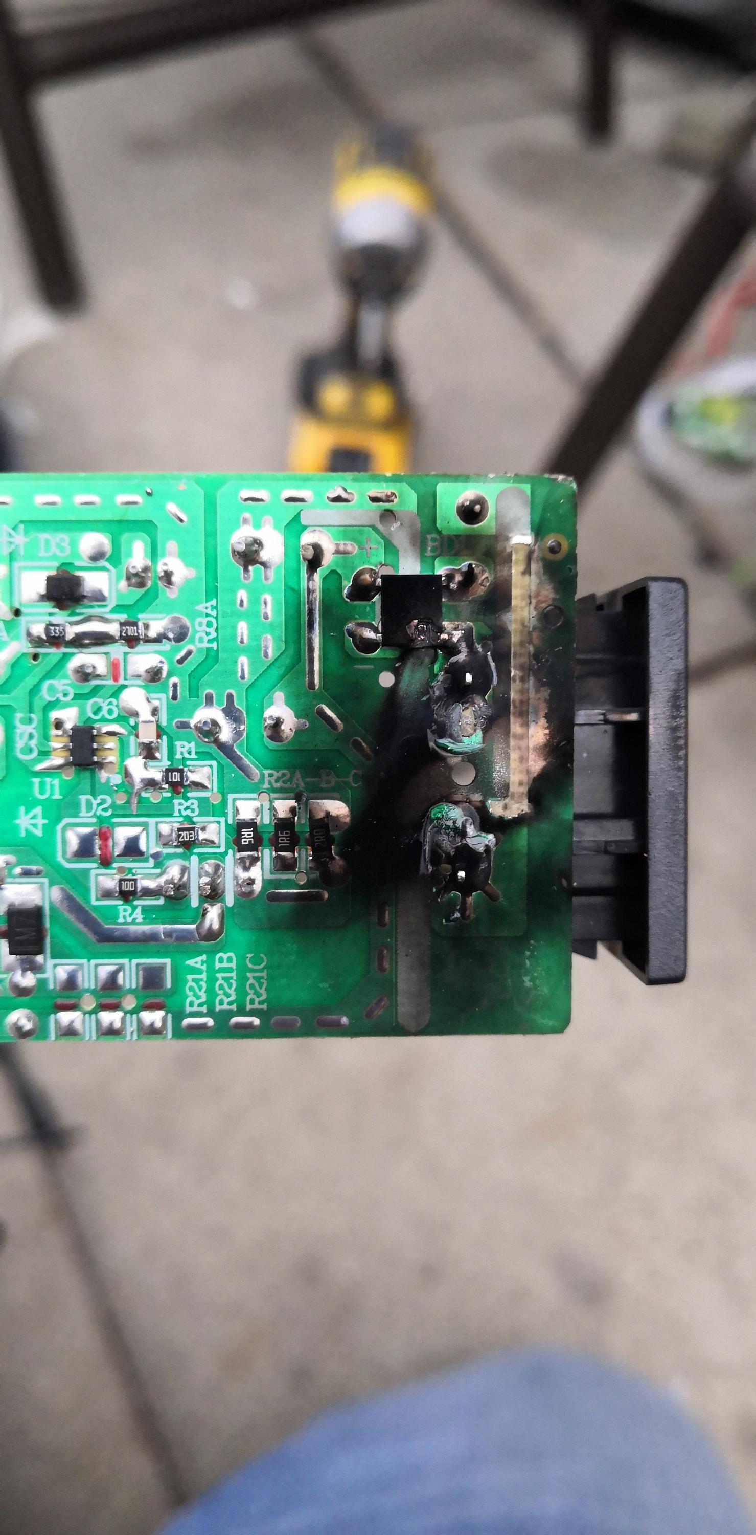

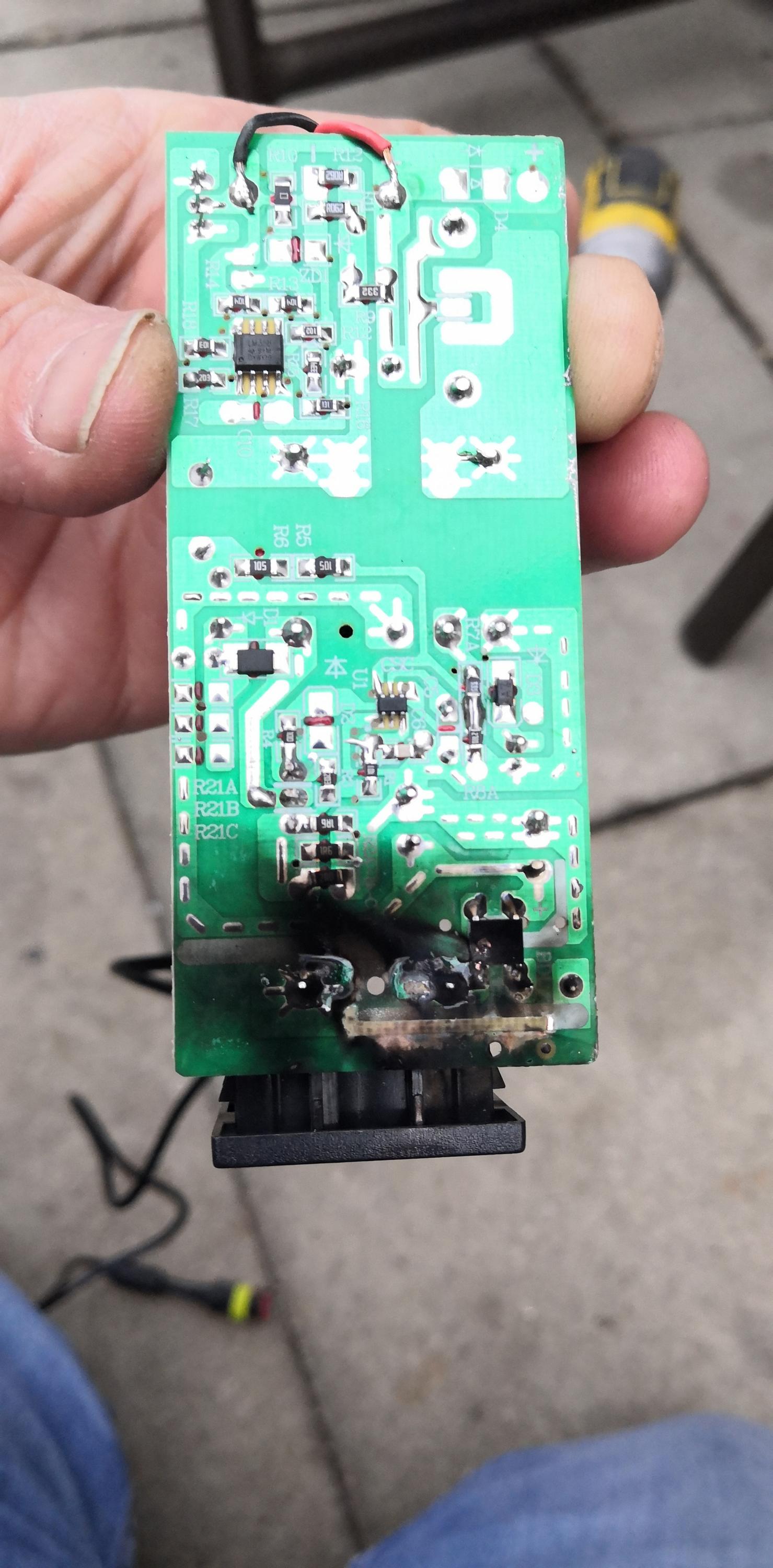

    This charger arrived today for my ebike.
    I had to wire a new bms into the battery pack first as the original giant bms wouldn't work with a generic charger.
    Anyhow I plugged in the charger after connecting the battery and it charged fine.

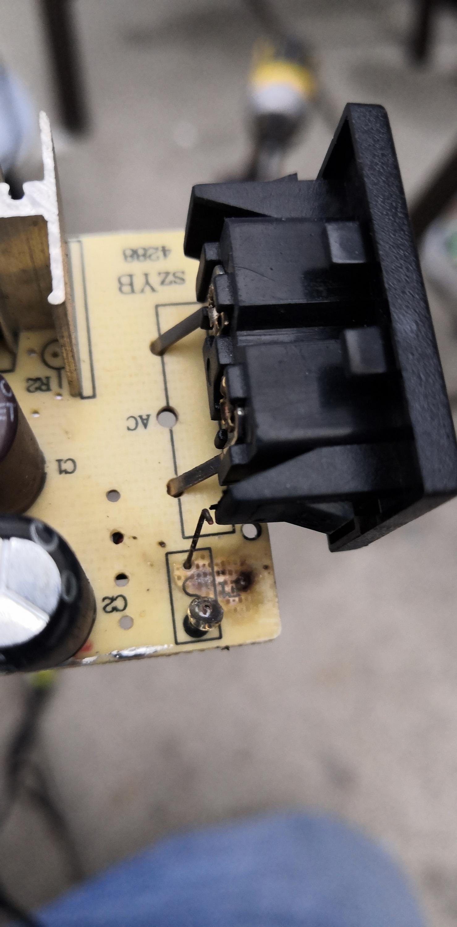

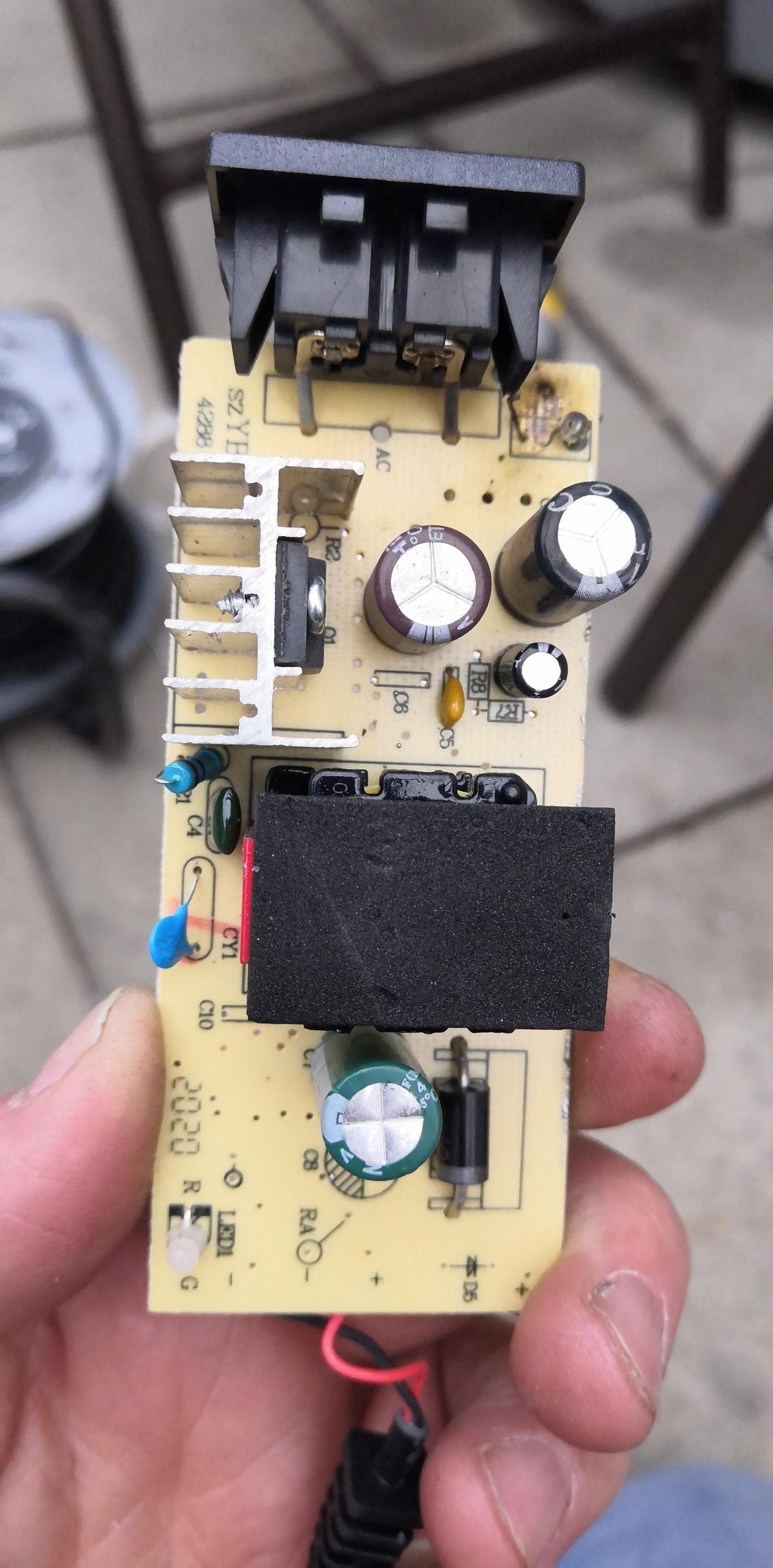

    I noticed that once it finished charging the the status led on the charger stayed lit green even when the mains power was disconnected.
    I connected it back the mains and there was a loud bang. Charger has blown up
    I've contacted the seller on ebay, I just want your thoughts on the charger in general and wether it would be worth accepting a replacement if the seller offers

      Looks like the solder blobs caused a short, WTF!

        Man! what kind of fuse did they installed in F1 location?

                i see what happened,
                the board is designed for a box-fuse and they fitted a tiny glass fuse.
                combined with a shorted bridge rectifier (happens),
                the fuse couldnt break the circuit fast enough and it arc'd under the board.

                    I would get the money back and buy something better.
                    BTW, can see the enclosure so we can see the make and model and the markings?
