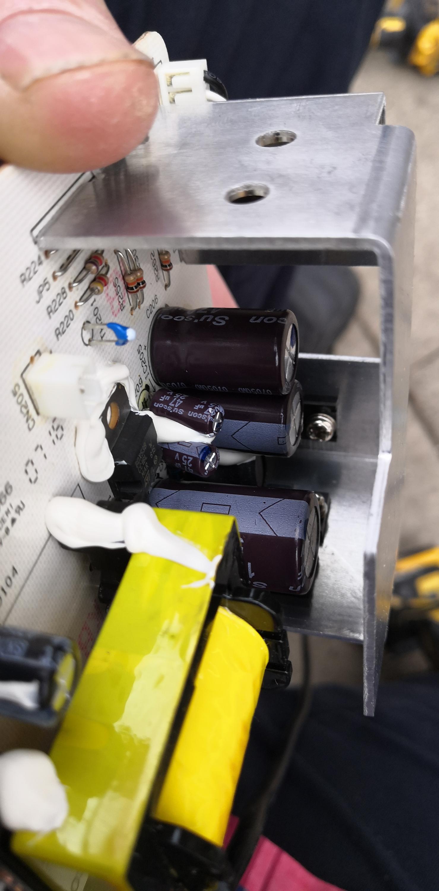

    Giant ebike li-ion charger

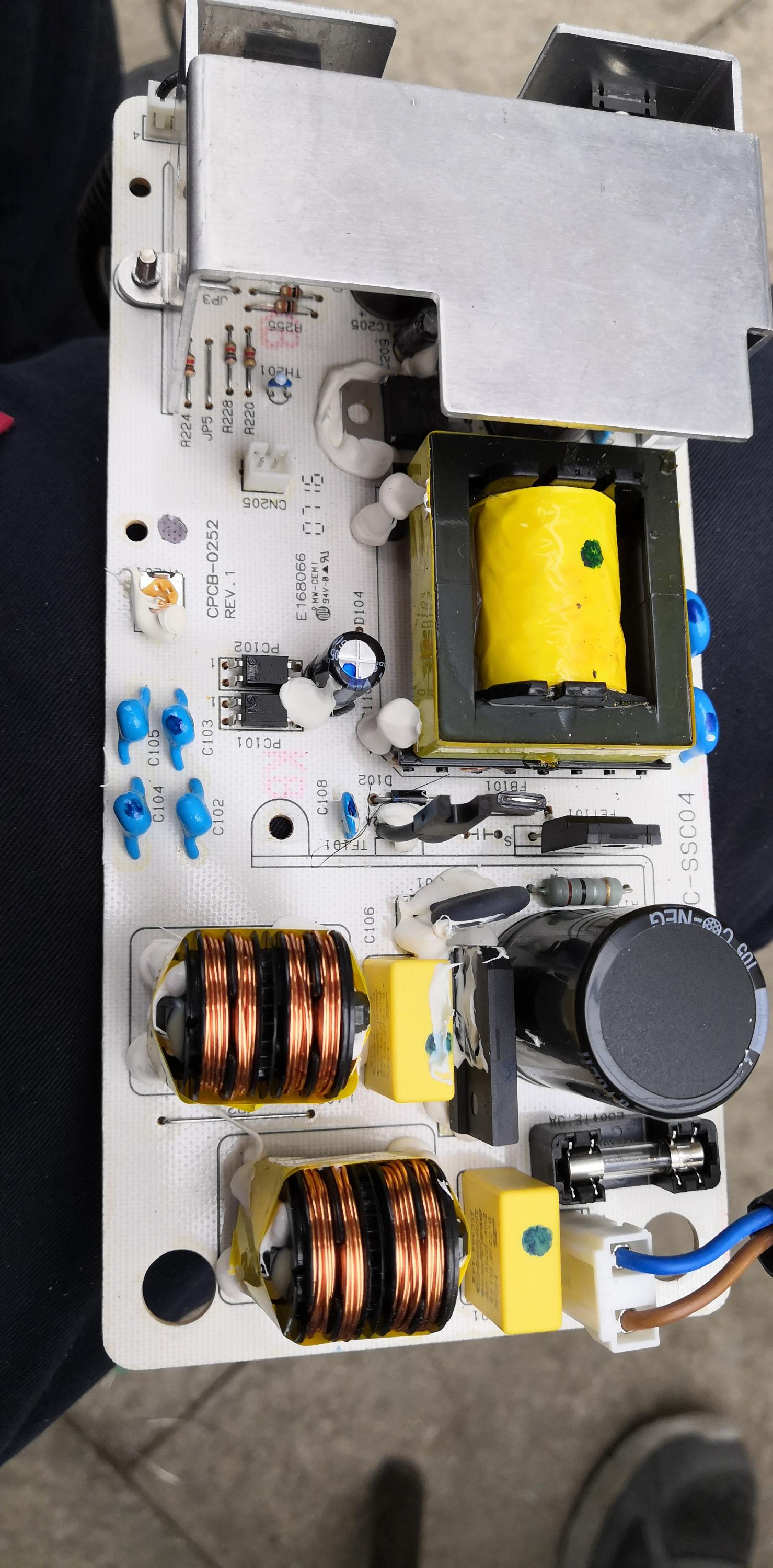

    29.2 volt li-ion charger
    Has mains input but no dc output
    2.5 glass fuse on primary side was blown
    I had to solder on a removable fuse holder
    Then installed a 2.a fuse to test but in instantly blew again.
    I've removed the heat sink so I could take a better picture.
    Any ideas what I should test?

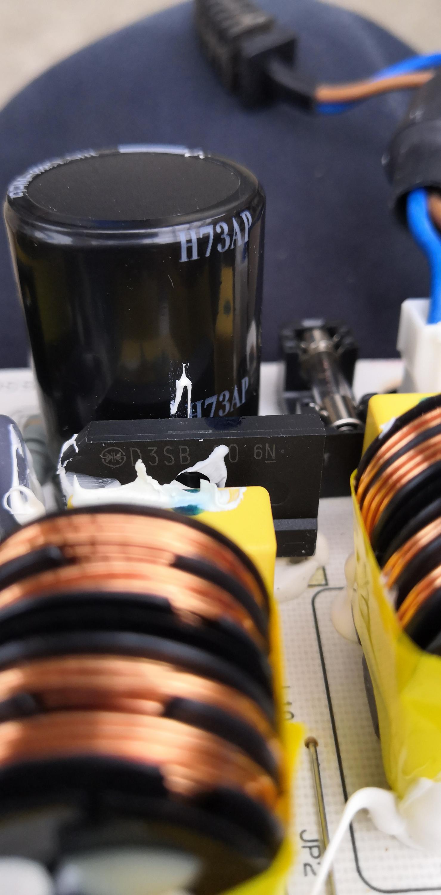

    Re: Giant ebike li-ion charger
    The bridge rectifier and the mosfet.

      Yes found the mosfet is shorted across all 3 terminals out of circuit. With it removed the fuse doesn't blow and I get 330v dx accros the big capacitor. I've ordered the mosfet and will give it a try.
        • 31161

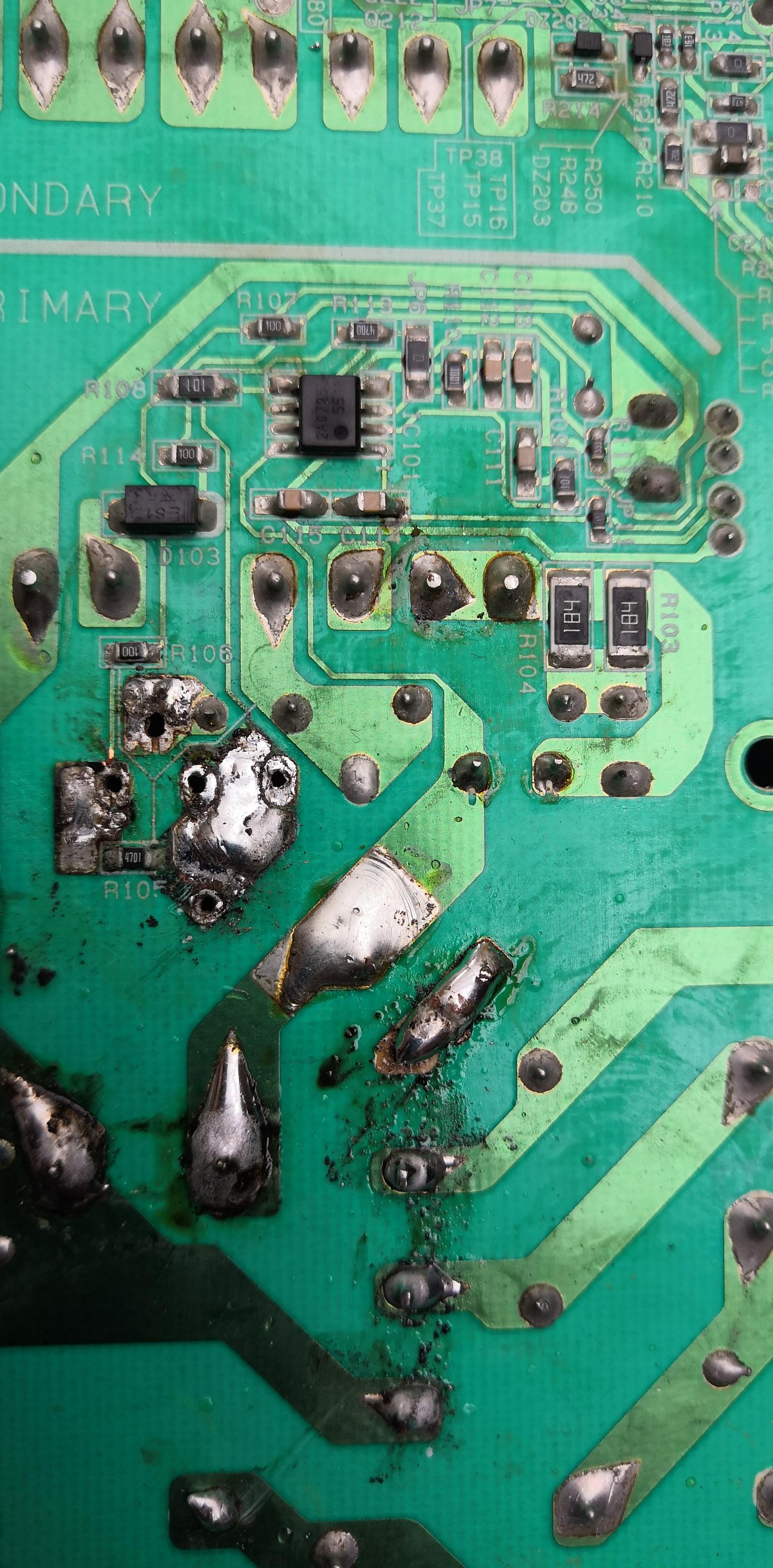

        if all 3 pins are shorted then it may have damaged the circuit connected to the gate pin
          SMPS IC101 in the Hot side probably is damaged too, you also need to check the low Ohm Source pin resistor (Brown/Black/Silver/Gold???) to gnd and also any parts connected between Gate and Drive output of the SMPS IC for damages.

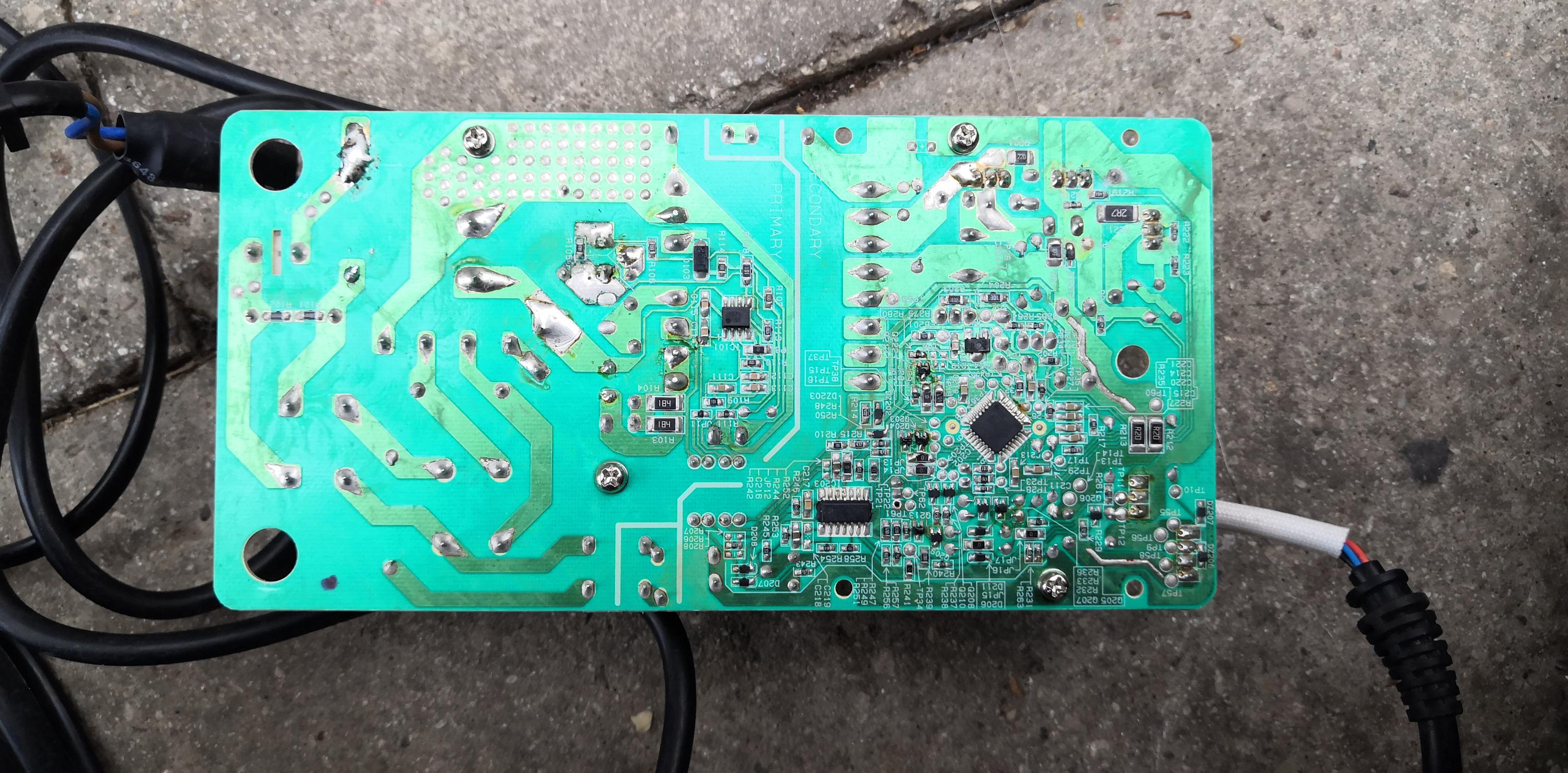

            I'm not sure how to test the ic101.
            I've tested
            R108 ok
            R106 ok
            R105 ok
            R103 and 104 ok
            D102 ok
            Not sure how to test the ferrite bead
            But measuring no resistance across the 2 pins
            Checking r112 it measures 0.5 ohms
            The calculator says it should either be 0.1 ohm or 0.2 ohm depending whether or not the first band is red or brown I think it is red personally but not 100% sure. Tolerance is stated as 5% so it should be between 0.19 and 0.21 do you think this is failed?

              ic101 is showing signs of being hot
                  I would replace the IC unless you want to take a chance of blowing up the new MOSFET. you cannot fully test the IC with the meter.

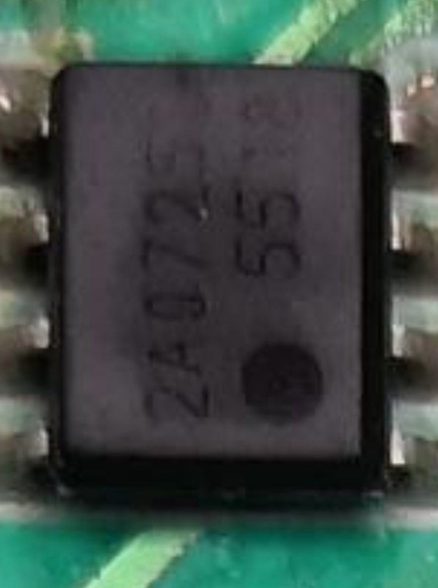

                      OK so new mosfet arrived.
                      It lasted approx 5 seconds and now I have a hole where ic 101 used to be.
                      I've been Trying to find one online but without success luckily I have a half decent photo of the part number but have been unable to find the exact part number so at the moment I'm stuck.
                      Does anyone have any ideas?
                        FUJI FA5518.
                        You must check all the component between the Gate of the MOSFET and this IC and other components connected to the IC.
                          I damaged the board while removing the chip so thanks for all the help I've ordered a new charger
