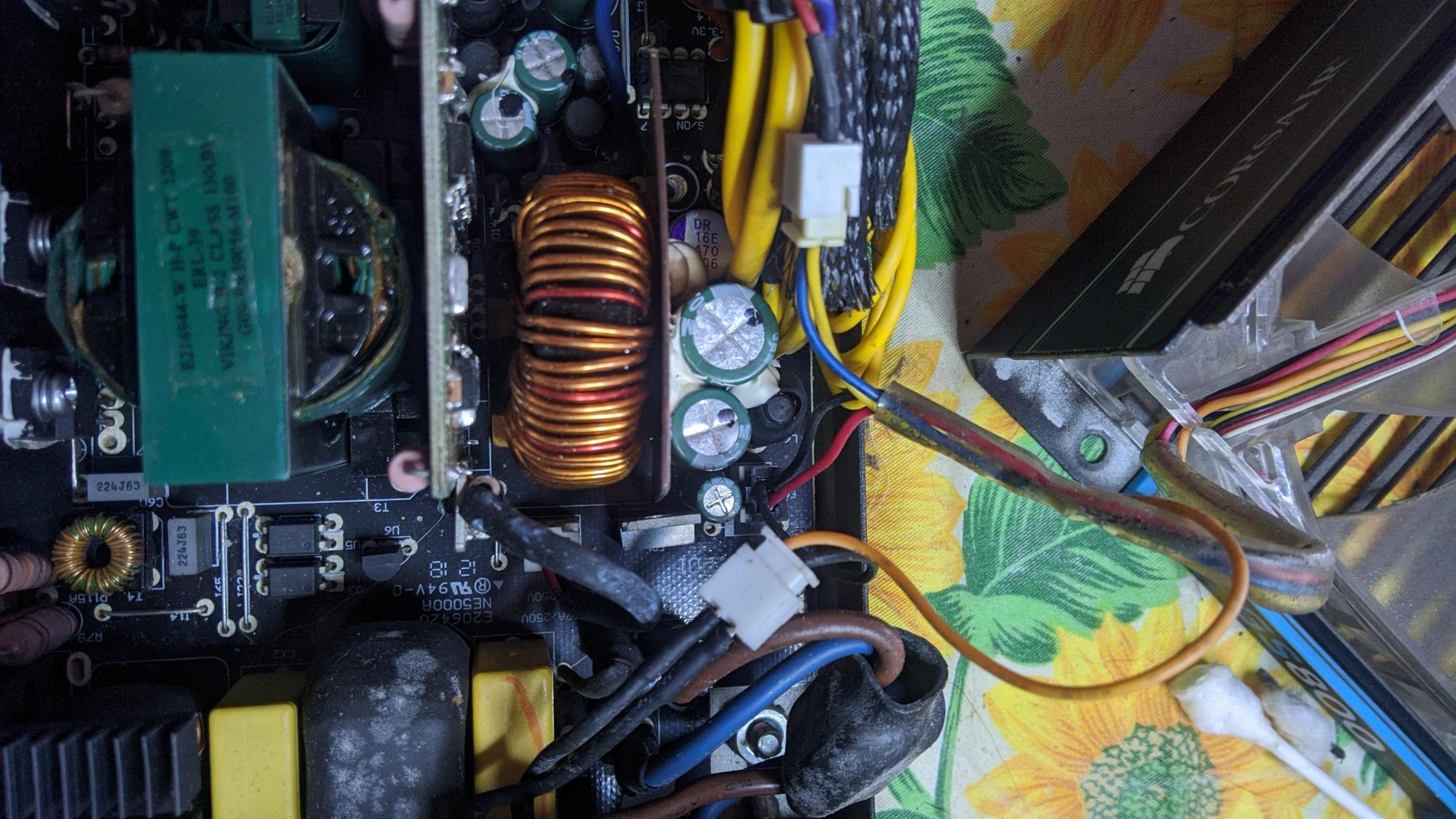

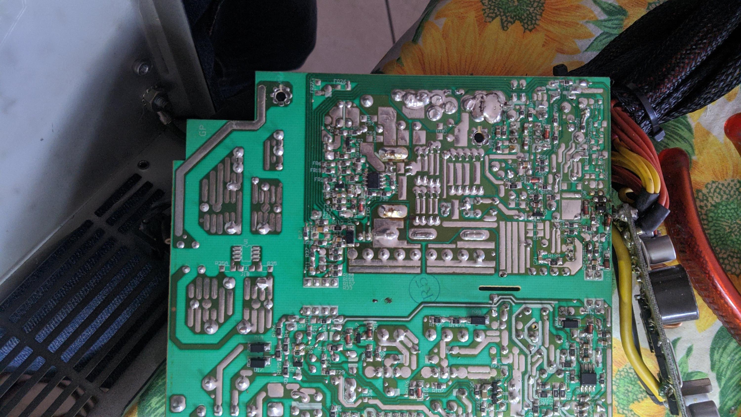

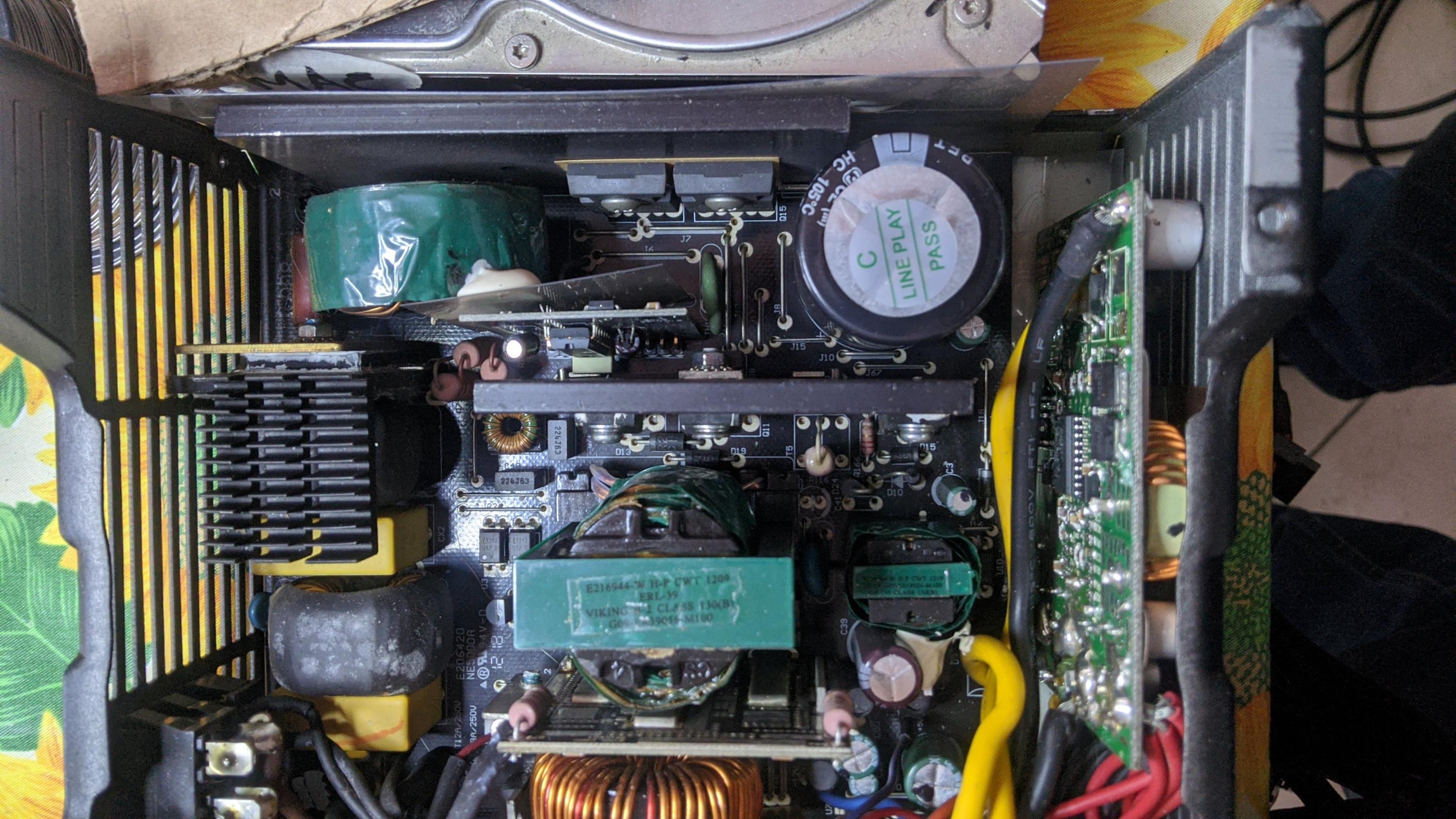

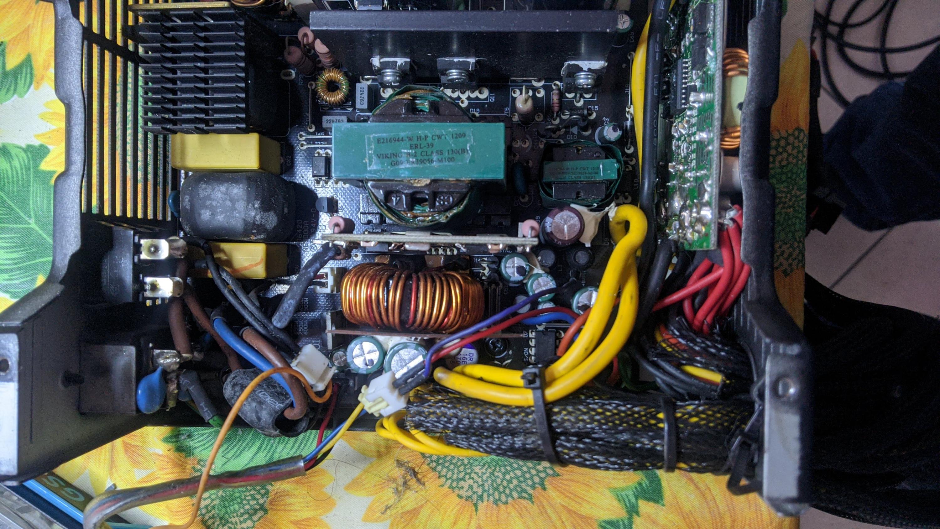

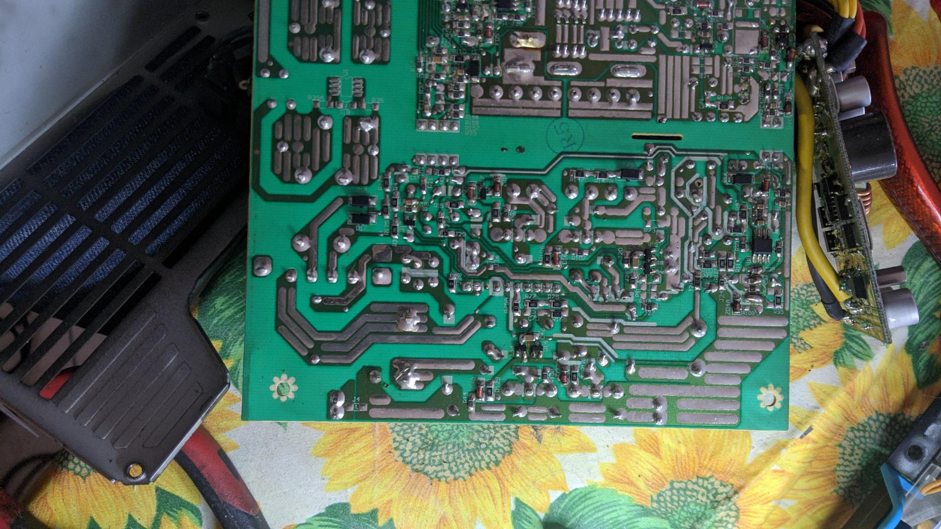

    Hi guys!
    I have this PSU that I've bought used.
    The fan spins at max when computer boots, then there's a very high frequency sound coming from PSU and the fan doesn't spin anymore, even if I try to push the computer using stress tests utility like PRIME95 or AIDA64.
    Sometimes the fan seems to try to start, but eventually it doesn't.
    I know this is a very common issue for this PSU, but I've found no fix for it (someone used a new fan controlled by mb header, but I'd like to know if it's fixable to be used as it is stock).
    Thanks in advance for the reply!
    • Jul 2011
    • 6039

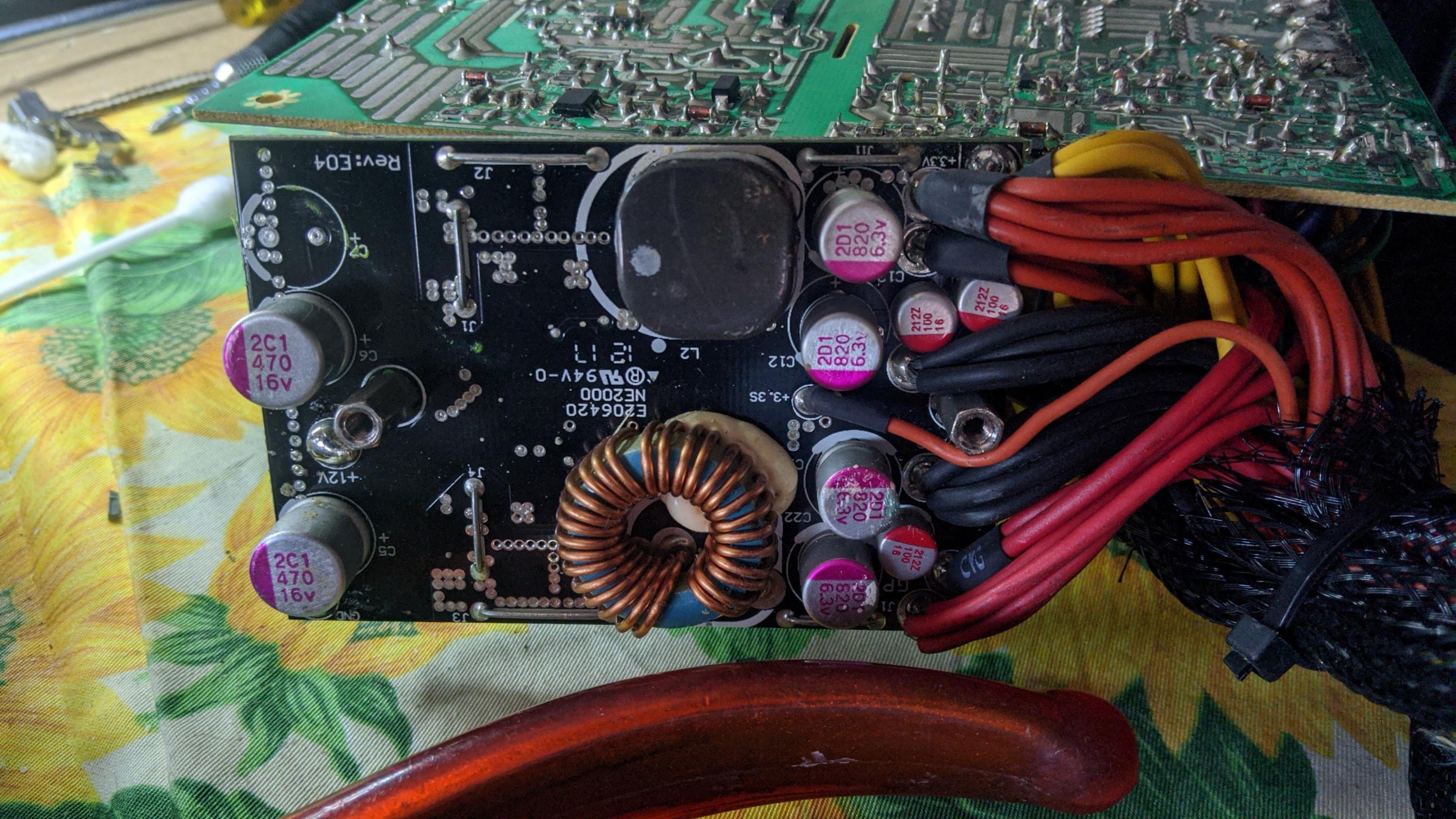

    Re: Corsair GS800 fan spinning only on boot
    Post some pictures of this power supply board front and back of the board
    • DS-1
      • Jun 2015
      • 82
      • Italy

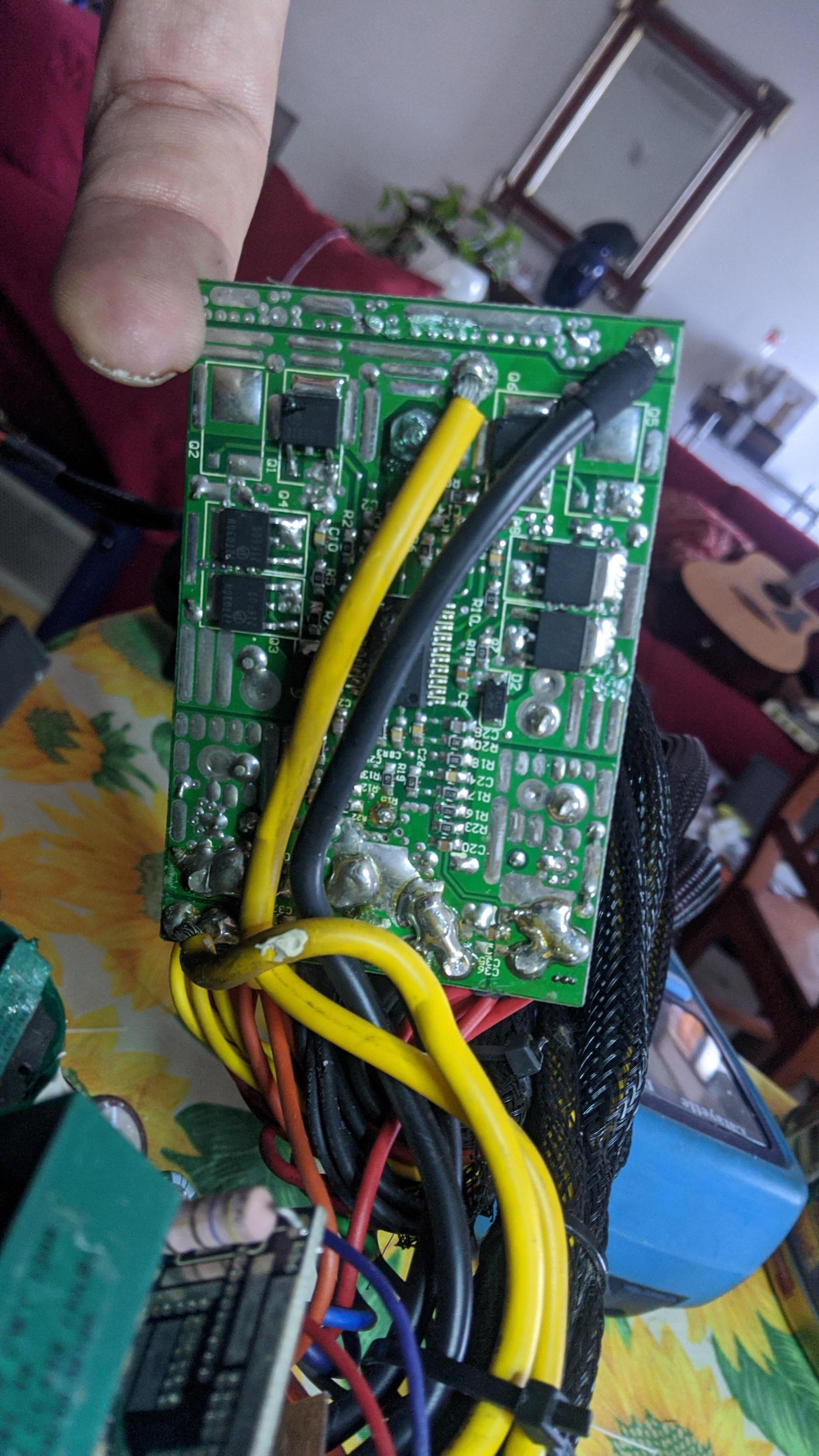

      Here are the pics:
      I've made also pics to the smaller board screwed on the panel.
                          This might be a silly question, but can the fan actually spin freely?
                          In other words, if you spin it by hand, does it take a while to come to a stop (and do a little "wobble" when it finally stops)? Or does it stop rather quickly? If it's the latter, the fan might need a bearing cleaning (if it's a sleeve bearing fan) or bearing replacement (if it uses a BB).
                          I also can't help but notice the PSU has green electrolytic caps on the output, which if I'm not mistaken would be either Taicon or Samxon. Whichever the case, those would be "2nd tier" caps, and I would suggest you modify the fan circuit in the PSU to have the fan run all the time. The easiest way to do that, if it's a 2-pin fan (most are) would be with two diodes on the positive (red) wire of the fan: one diode feeding the fan constant 5V when the PSU is on, and the other diode feeding power from the fan regulator circuit, so that if the PSU wants to run the fan at a higher speed for some reason, it can still do that.
                            Yes, fan can easily moves if I spin it by the hand, that's why I supposed there's something "wrong" in the automatic fan spinning circuit.
                            I could do the modify you suggested. I'll write here when I'll realize it!
