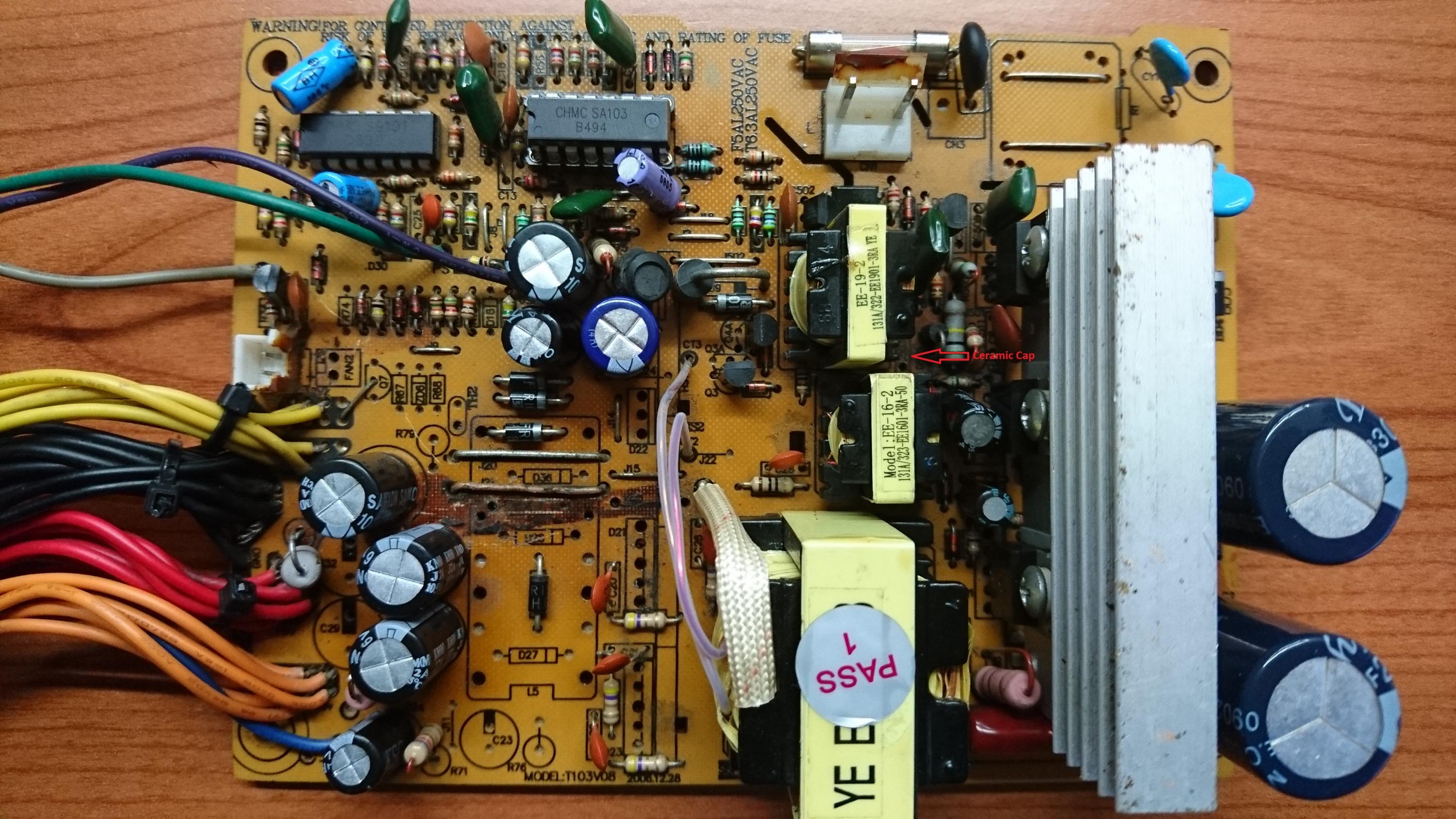

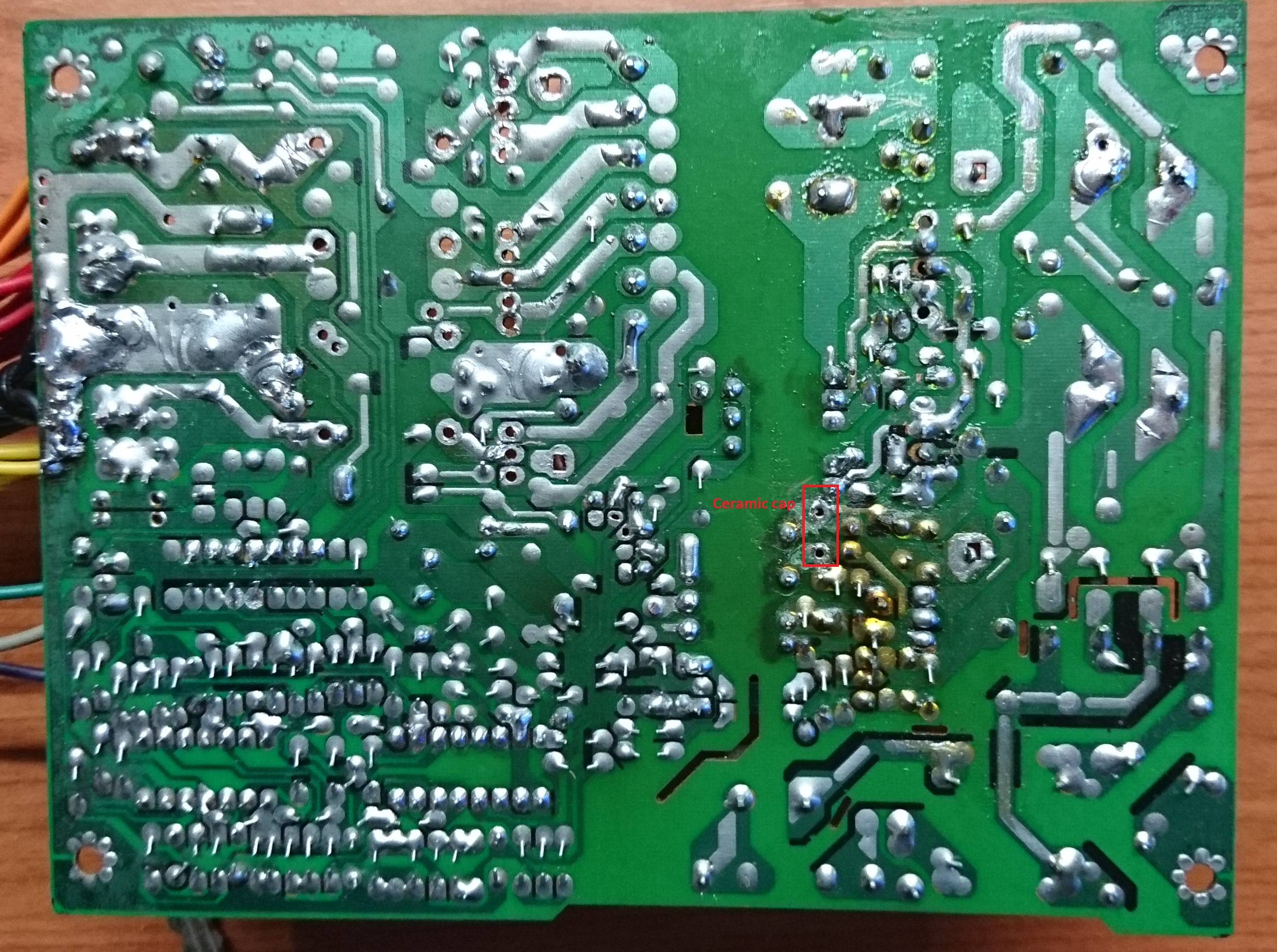

                                    Re: Itek Atx 500W does not turn on
                                    send a picture as the PSU is at the present time, top and bottom.
                                    • falcontech
                                      • Oct 2013
                                      • 484
                                      • italy
                                      #78
                                      ok
                                      • falcontech
                                        • Oct 2013
                                        • 484
                                        • italy
                                        #79
                                        here they are, I showed you where the broken ceramic capacitor was
                                        • falcontech
                                          • Oct 2013
                                          • 484
                                          • italy
                                          #80
                                          so what do you do?
