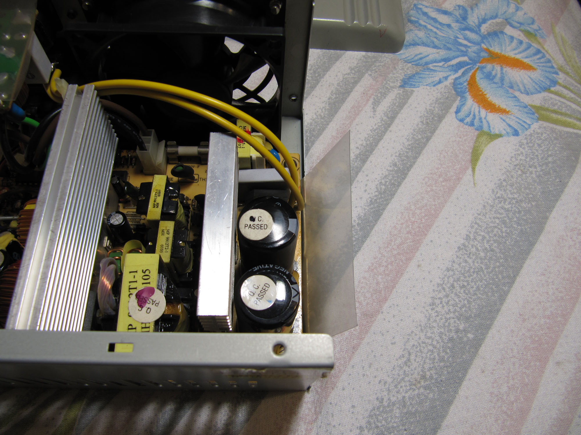

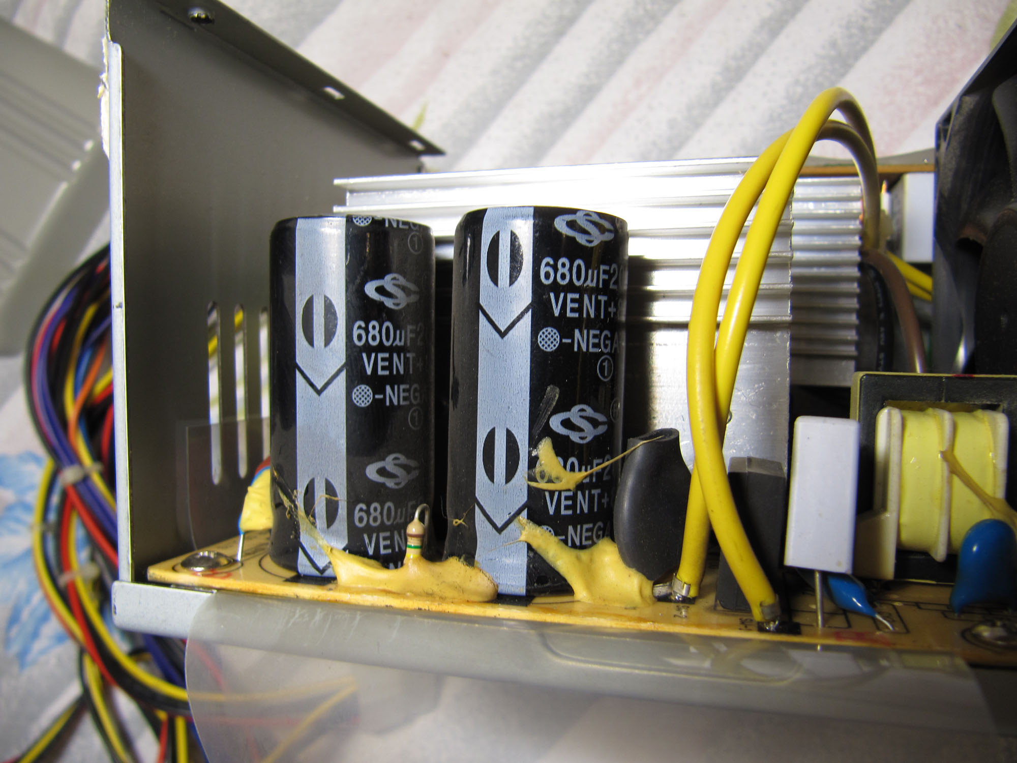

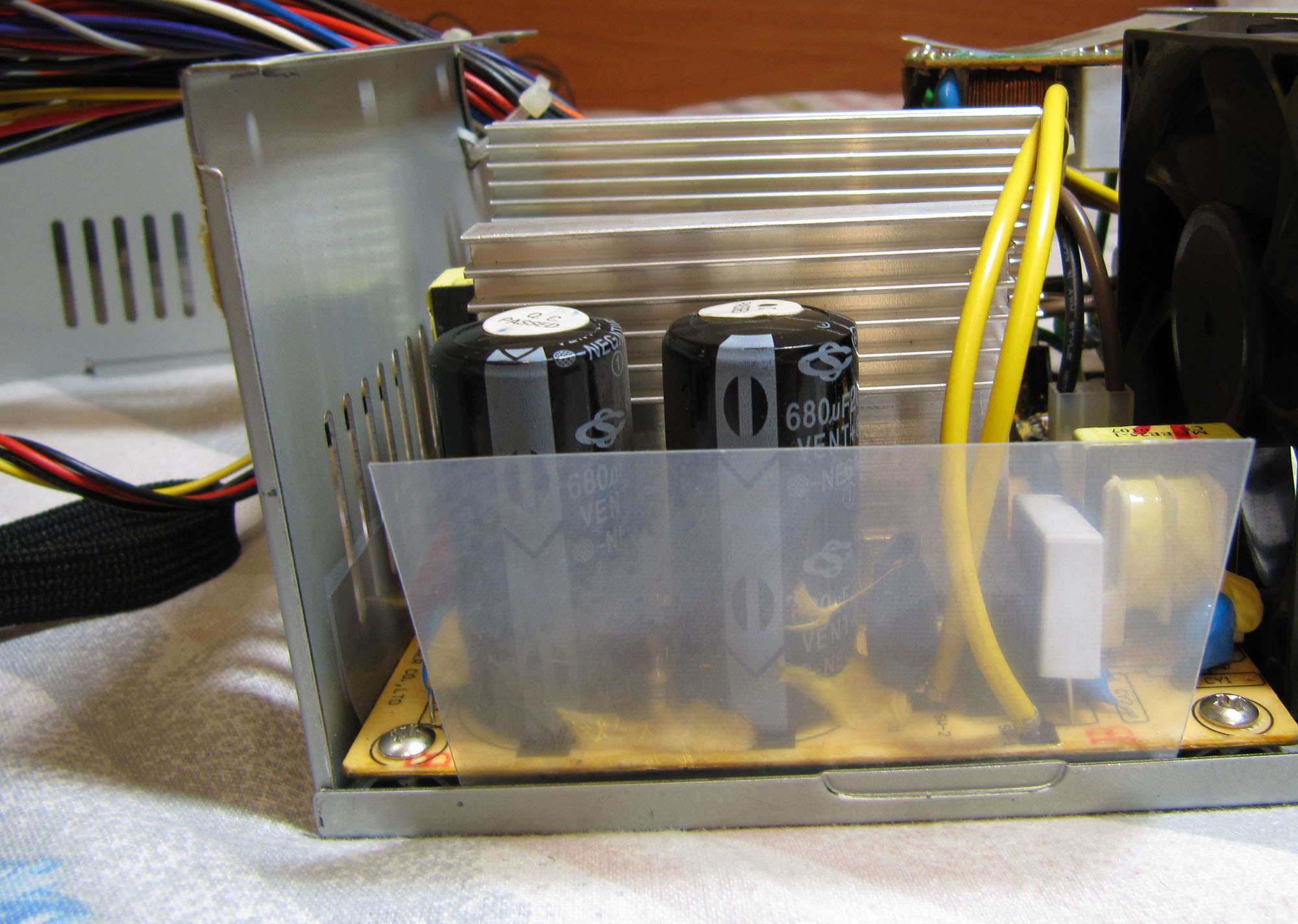

swollen or not? can you tell?
  • goodpsusearch
    • Oct 2009
    • 2850
    • Greece
    Hi! New to forum..
    I have a Macron Power psu MPT-301 and it seems to me that the primary caps are swollen. But before trying to recap them (I have no experience in this) I need to be sure that they need to be replaced.
  • Krankshaft
    • Jan 2007
    • 2328
    Re: swollen or not? can you tell?
    Looks like it's bulging no way I'd leave it in there in any case.
    I had a UCC counterfeit cap on a variable power supply that looked the same way when I removed the plastic cap it had some brown goop under it. The can didn't look bulged but I gutted the counterfeit anyways.
    • POM_MJ
      • Aug 2009
      • 228
      It's look similar to my Enlight VP-300 in this post ==> https://www.badcaps.net/forum/showpo...3&postcount=95
      same caps brand used, on my vp-300 secondary side caps had leakaged then caused very damage to other components.
      I'd recommended to replace caps on both primary and secondary side.
        I like the Y cap wedged under that X cap. Really good manufacturing processes there.
        • ratdude747
          Black Sheep
          • Nov 2008
          • 17136
          this psu is simply EPIC FAIL. dang, it takes effort to blow primaries, even bad ones.
            It's got a primary side choke though I'll give them credit for that.
              I've had a PSU line cap that looked like that. I pried off the plastic round bulging top, and saw the only thing bulging was the plastic. The bare aluminum top of the capacitor was oK. Needless to say, I left it there, didn't replace it. I have yet to see a Line capacitor go bad, even after 17 years of being in the computer hobby.
                Thanx for the replies
                It seems really difficult for me to change all the psu caps... I don't trust my hands :P
                If I knew anyone in my region who could do this I would have him recap them.
                The psu caps are cs (as the bulging primary caps) and 3xjp and 2 jee caps. None is bulging or leaking except primaries. The psu works fine in P3 system but can't boot a pentium 4 1,5GHZ, intel 845 motherboard with sdram support.
                Voltages are close to nominal values, only 12v is a bit low (11,7-11,8v).
                I was impressed by the high capacity of the primaries (680uf), all other psus I ve seen had 470uf or even 330uf.
                One more question please.. the primary caps specs are 680uF 200wv vent85c. What does Wv mean? Is it different from 200V? Sorry, if it is a stupid question...

                          • c_hegge
                            • Sep 2009
                            • 5219
                            see if you can push the plastic down pn top. if you can, the caps are probably OK, if you can't, they're toast. it's common for the plastic disc to dome but the top of the cap to be flat.
                            • goodpsusearch
                              • Oct 2009
                              • 2850
                              • Greece
                              I did push it with fingers,nails etc but it didn't move at all. remained bulged... So I guess I have no option but try and change them. Wish me good luck!
