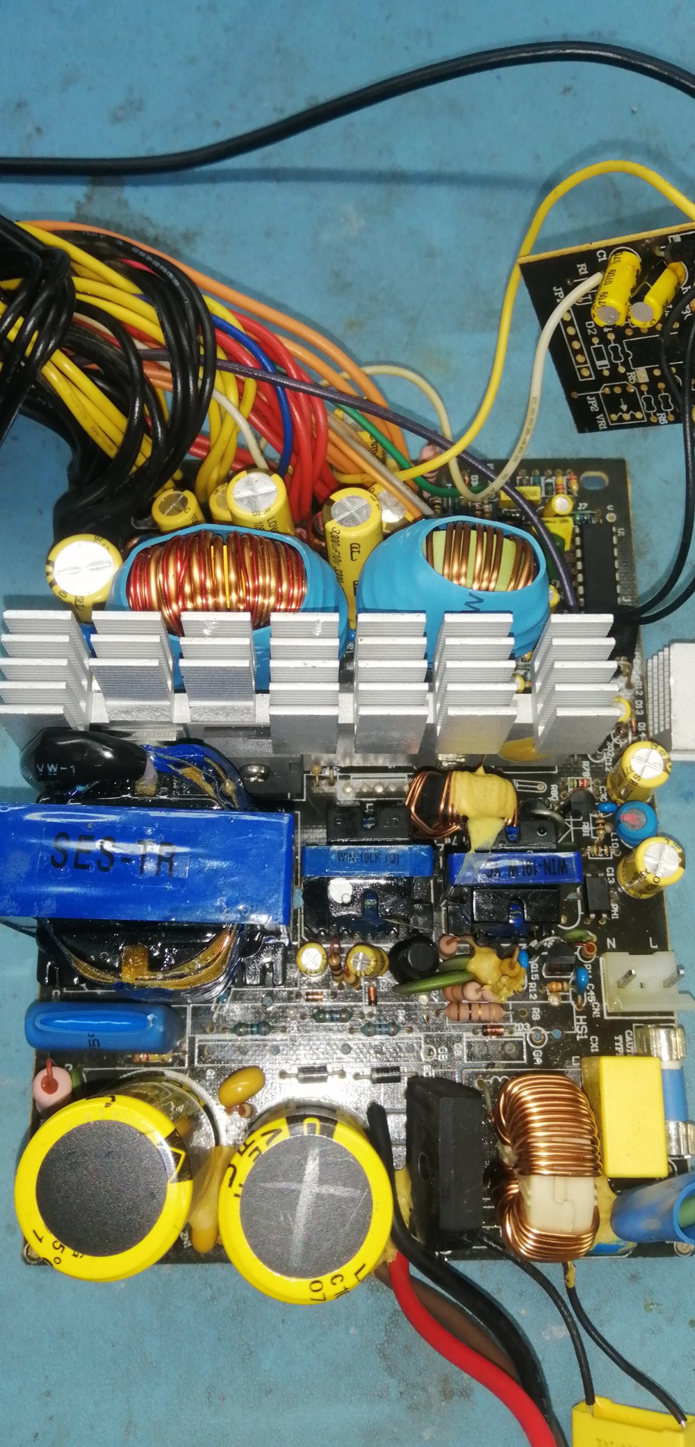

    Hi guys
    I have a faulty Xilence ATX PSU here

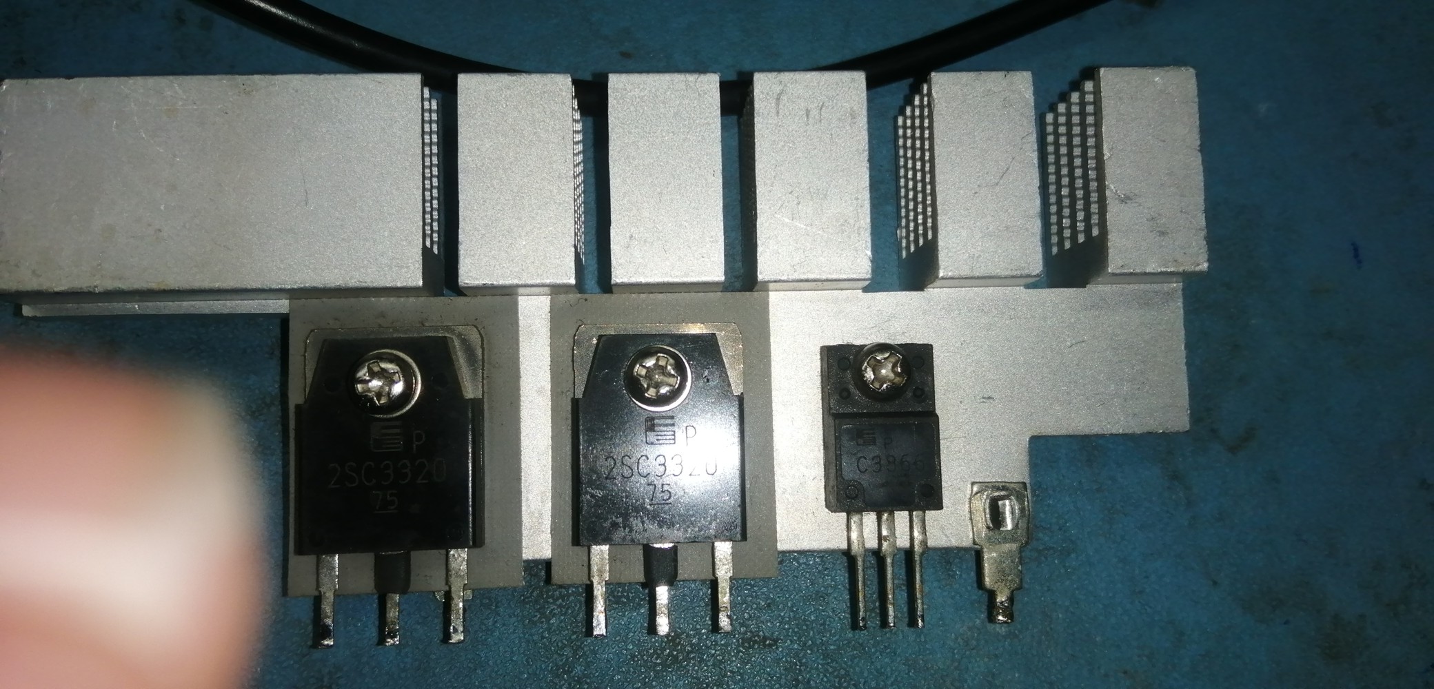

    The fault basically is I have two short circuit power transistors on the primary side of the large SMPS transformer - they are 2SC3320.
    There is another smaller transistor on the primary side C3866 which tests ok

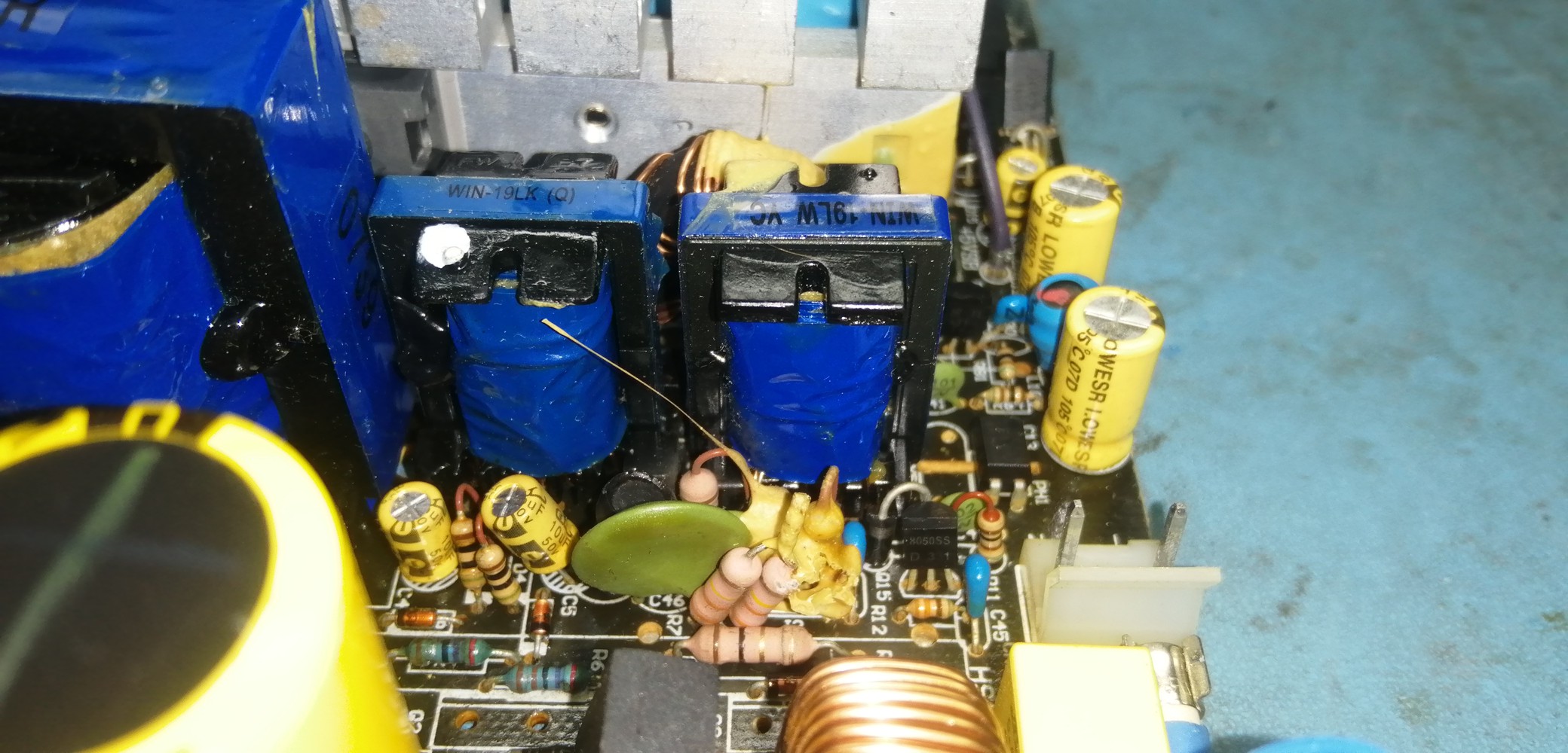

    The PSU has three transformers - it looks like the 2SC3320's drive the big one and the C3866 drives one of the small ones. There is a separate PFC PCB with it's own controller and MoSFETS
    There is also a short on the 3.3V output and a near short on 5V - I suspect this probably blew the two 2SC3320
    However, What has me interested (not for the repair but for increasing my own knowledge) is how this PSU actually works
    The only 'connection' between HV and LV sides are the three SMPS transformers and one opto isolator

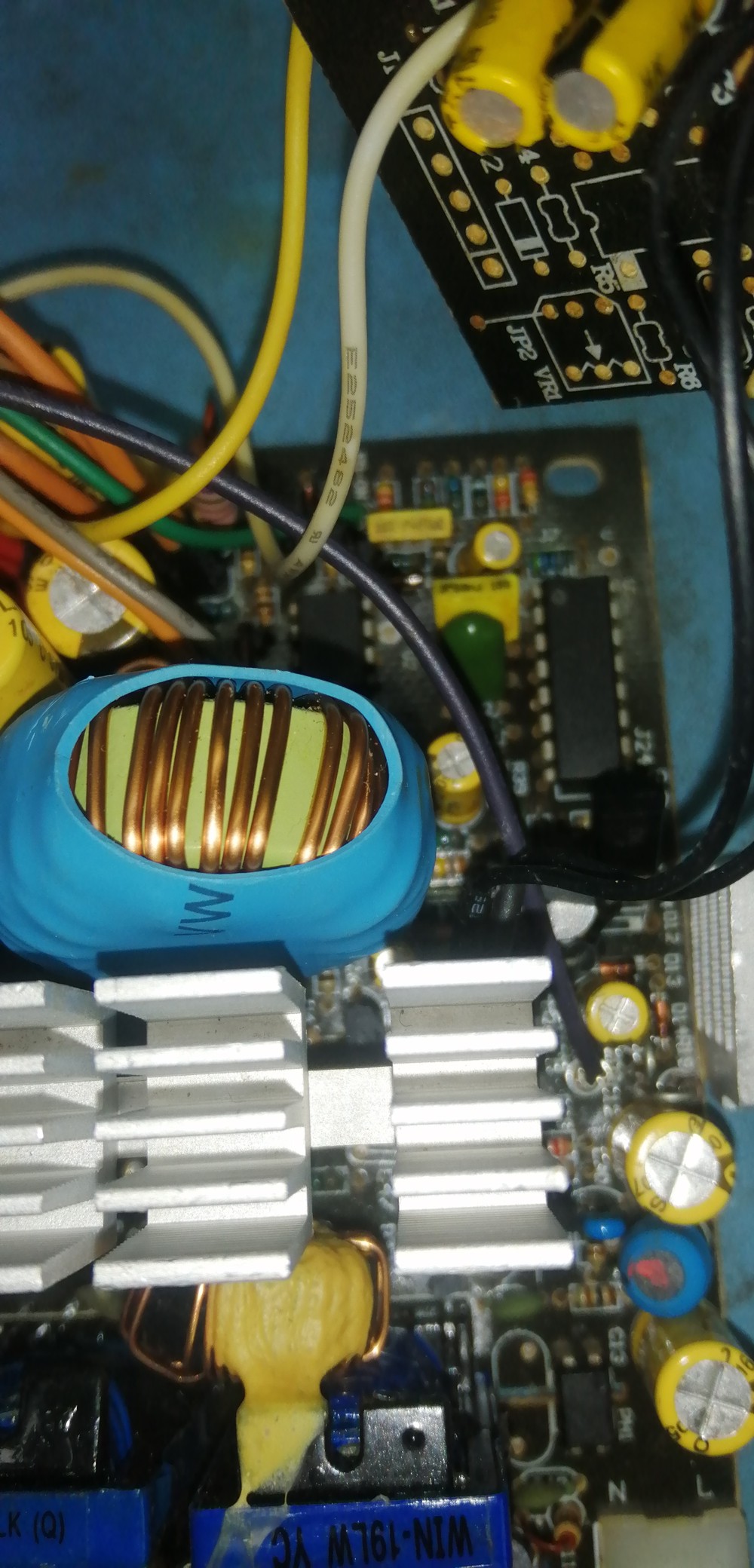

    There is no PWM controller on the primary side. Normally I would expect to find two - one for the 'big' transformer and another for 5VSTB

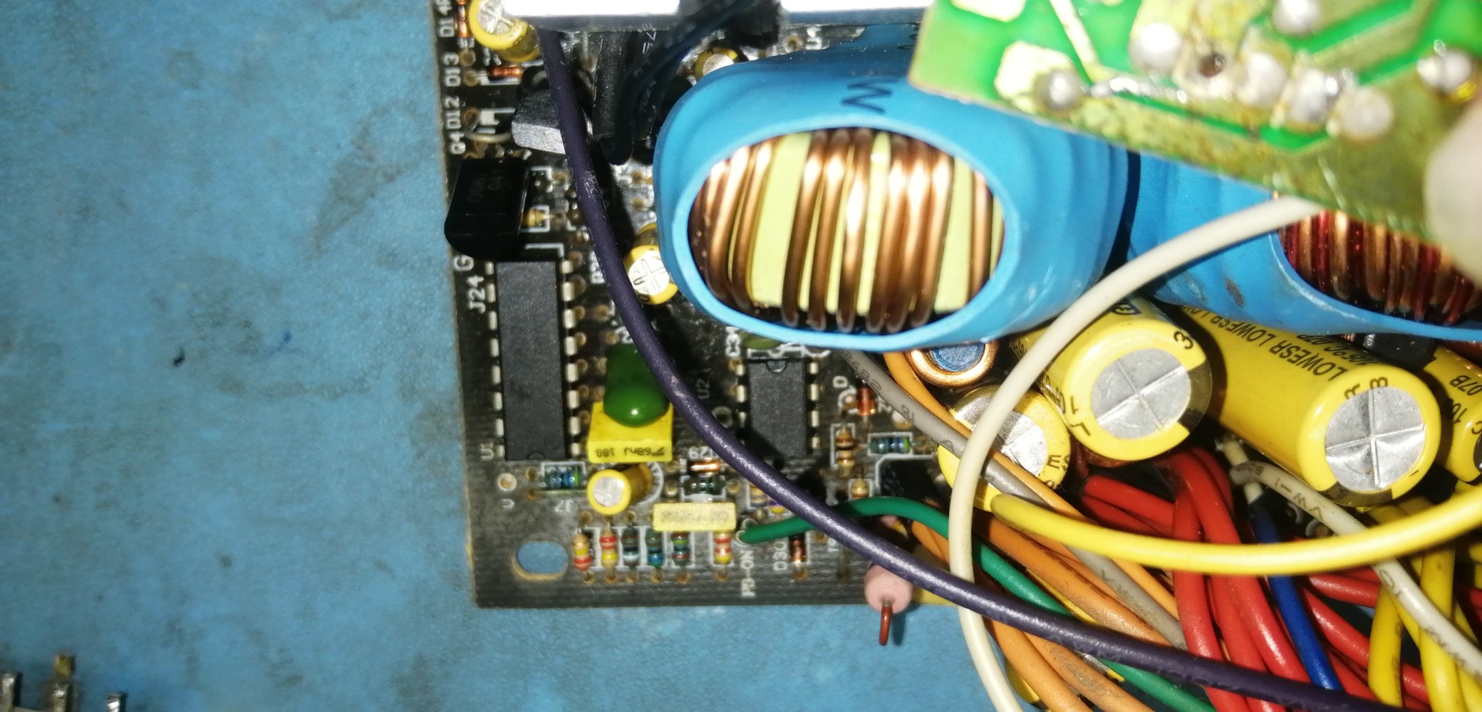

    The only PWM controller I can see is on the low voltage side KA7500C. There is another 8pin IC nearby, but the datasheet says this is a Diode array. SG6510D
    It is concievable (to me) that either the opto-isolator or one of the small transformers provides drive from the KA7500C to the 2SC3320 pair. In any case no feedback via an opto-isolator would be needed as the controller appears to be on the low voltage side
    And the other small transformer could provide 5VSB and also power the KA7500C - but this begs the question, where is the controller for that SMPS transformer? I did also check just to see if it is a small linear transformer connected to 220V input but that also appears not to be the case - it does appear to go to the C3866 but there is no IC driver here, just another small NPN transistor part 8055S and a few resistors/capacitors. The opto-isolator transistor also seems to connect into this area.
    So possibly I am quite wrong in my guess how it works - the main thing I would like to know is how does the PWM controller on the low voltage side get it's power and why is there nothing like a 'TNY' chip or similar to drive the Standby supply?
    See pics.

    A diode array wouldn`t have a notch on it ,might be this https://cdn.badcaps-static.com/pdfs/...2c03b8ed95.pdf

        The KA7500C is the PWM, basically a TL494 clone. You have three transformers. One is the main output transformer, one is the Standby transformer, and the third is probably the base drive transformer for the half bridge inverter transistors, the 2SC3320s. The "C3866" is probably actually a 2SC3866, probably for the Standby supply.
        The inverter base drive circuit may be self-oscillating, generating Vcc for the KA7500C, which when it comes up takes over control of base drive to the inverter transistors. Or the Standby circuit may provide Vcc for the KA7500C.

          These are called self-oscillating designs. Often they are implemented either with just one transistor on the primary side (and therefore no feedback, which will be evident by a lack of an optocoupler) or with 2 transistors on the primary side (which usually does have feedback from an optocoupler). The latter is usually a lot more prevalent and we/I/me usually call it 2-transistor self-oscillating design, or just 2-transistor 5VSB for short.
          Both 1 and 2-transistor 5VSB designs are very crude in terms of protections - that is, they really don't have any! (Therefore, make sure to recap the 5VSB output caps and "startup cap" - if any - with good reliable brands, or the failure of the 5VSB can be catastrophic to both the PSU and attached PC hardware.) However, in the case of a 1-transistor design, it always uses some kind of a linear regulator (typically 7805 for 5VSB) on the secondary side, because it doesn't have feedback and cannot regulate the voltage by itself. In that regard, 1-transistor 5VSB circuit really does have a slightly better protection, as it will have whatever protection the linear regulator might offer. But in the case of 2-transistor 5VSB, there is none, aside from power self-limiting... which is often say way too high or not implemented at all. Thus, any kind of malfunction on the output of a 2-transistor 5VSB will eventually result in a meltdown.
          On the other hand, the one redeeming quality of self-oscillating designs is that they are built entirely from off-the-shelf parts. So even 20 years down the road, you should still be able to find parts for them. In contrast, 5VSB circuits done with PWM ICs or more often now PWM-FET combo ("offline switch") may become hard to find replacements after many years. Obviously, ones like the TNY- and TOP- family have been around for a while and probably still will be. But anything more "exotic" might not stick around for too long.
          Anyways... regardless of which self-oscillating design you have... for bridge topology main PS with a voltage control IC (such as KA7500, TL494, SG6105, SDC2921, ATX2005, AT2005b, and etc.), the 5VSB circuit's transformer will also have a secondary side auxiliary rail (or sec. aux., for short) that provides unregulated voltage to the PWM IC and any other logic ICs used for the protections and PS-ON signal.
          Both 1 and 2 -transistor 5VSB circuits will also have a primary side auxiliary rail (pri. aux., for short) that is used for driving OFF the main (big) switching 5VSB transistor.

          For bridge -type topologies (half-bridge, full bridge, push-pull) with BJTs, the controller will almost always be on the secondary side.
          If you're further interested on that topic, you can see a partial PSU schematic just of the driver circuit (for the main PS) that I did for the PSU in this thread (it's in post #8) while trying to fix it.
          That single optocoupler is for the 5VSB. If you trace the 5VSB output, you will see that it feedbacks through that optocoupler through a 431 shunt. On the other side of the opto (output / primary) will be driving a small transistor that drives the bigger transistor for the 5VSB (hence, 2-transistor 5VSB.)
